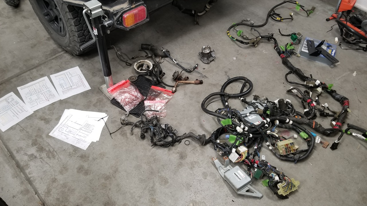

I've also been sorting and labeling wiring. I'll cut this harness up this week and only keep what I need. As complicated as wiring is, this is super basic compared to the 2UZ and 3UR I've been dealing with. It is very straight forward with minimal computers and sensors.

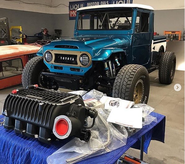

I've spent about 5 of my days off in the last couple months finishing the wiring on this thing. We had it running for SEMA, but it wouldn't shift correctly. We ended up adding a few things back in we didn't think we'd need, but it's a monster now. A superchager was installed last week, and now it's even faster. If this truck proves as driveable and reliable as my 2UZ was, I'll start looking for a wrecked Tundra 5.7 for this project and ditch the 1FZ.

Harrop has a new tvs supercharger for the 3ur. Not many people swap the 3ur.
We have one in the Cruiser Brothers warehouse, ready to ship to its new home. Georg Esterer @orangefj45 is having a hard time keeping his hands off it:)
Minus GST at 10% and AUD to USD today is .72 to 1... about $10.5K not including shipping.

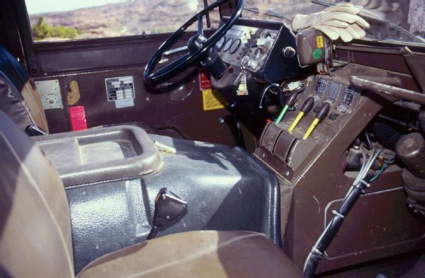

After riding in a friends Pinzgauer, I remember thinking how utilitarian it was. Everything seemed heavy duty and well made. I absolutely loved the 3 handles in the middle of the dash to engage the center, rear, and front lockers. I have decided to do something similar with this.
Here's a pic of the Pinzgauer dash setup-
Being that this 40 will be on OEM E-locked 80 series axles, I've decided to do manual (cable) conversion of them, as well as the center diff lock. I obtained 2 additional shift handles and mounted them next to the OEM handle. This is what the dash looks like now.
The left handle will shift from Low to High. The middle handle will engage rear locker. The right handle will engage front locker. I will be using the OEM "F.D" push/pull handle to mechanically actuate the center diff lock, rather than using the motor. I will mount that knob just to the left of these three levers.

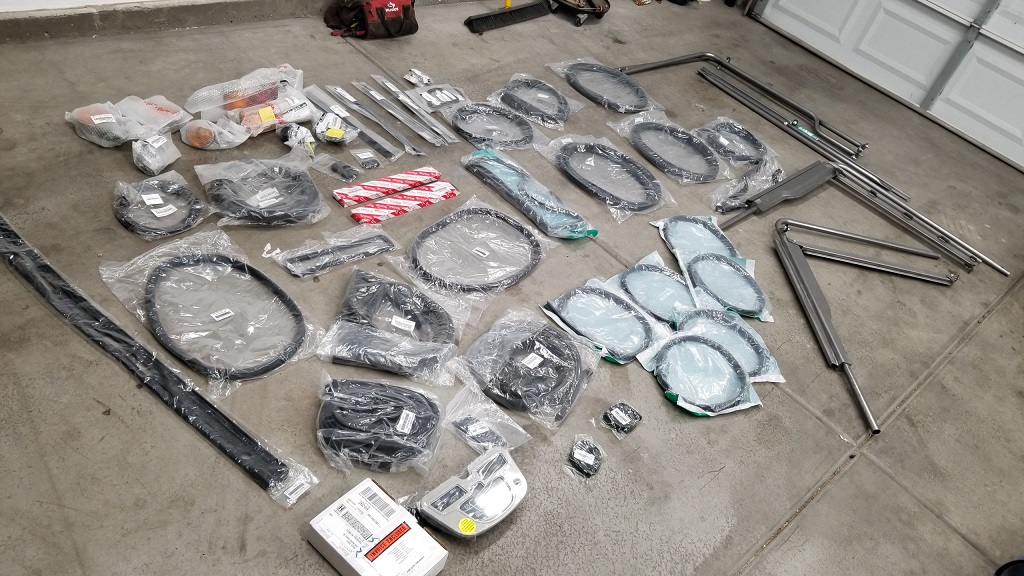

I also got a box full of goodies from cityracerLLC.... every piece of weatherstripping I'll need to reassemble this thing!

Taking inventory for parts collected so far:
Weatherstripping from cityracer
OEM turn signals, bib lights, and rear lights
Dakota Digital dash
Real Steel bows
OEM ignition
OEM turn signal switch
Front 80 series E locked axle
Not pictured:
Quick Hinges
A few other Real Steel pieces

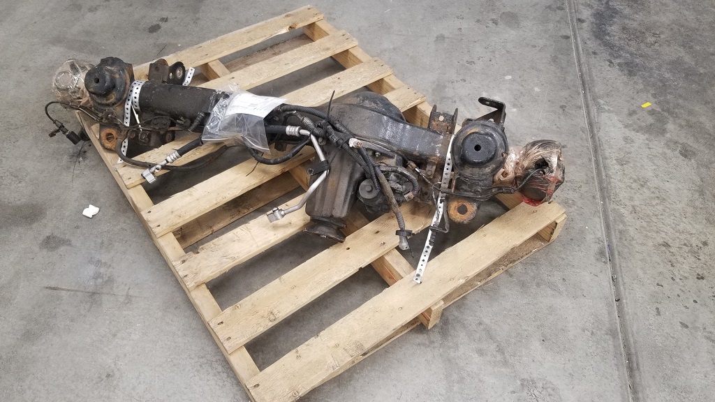

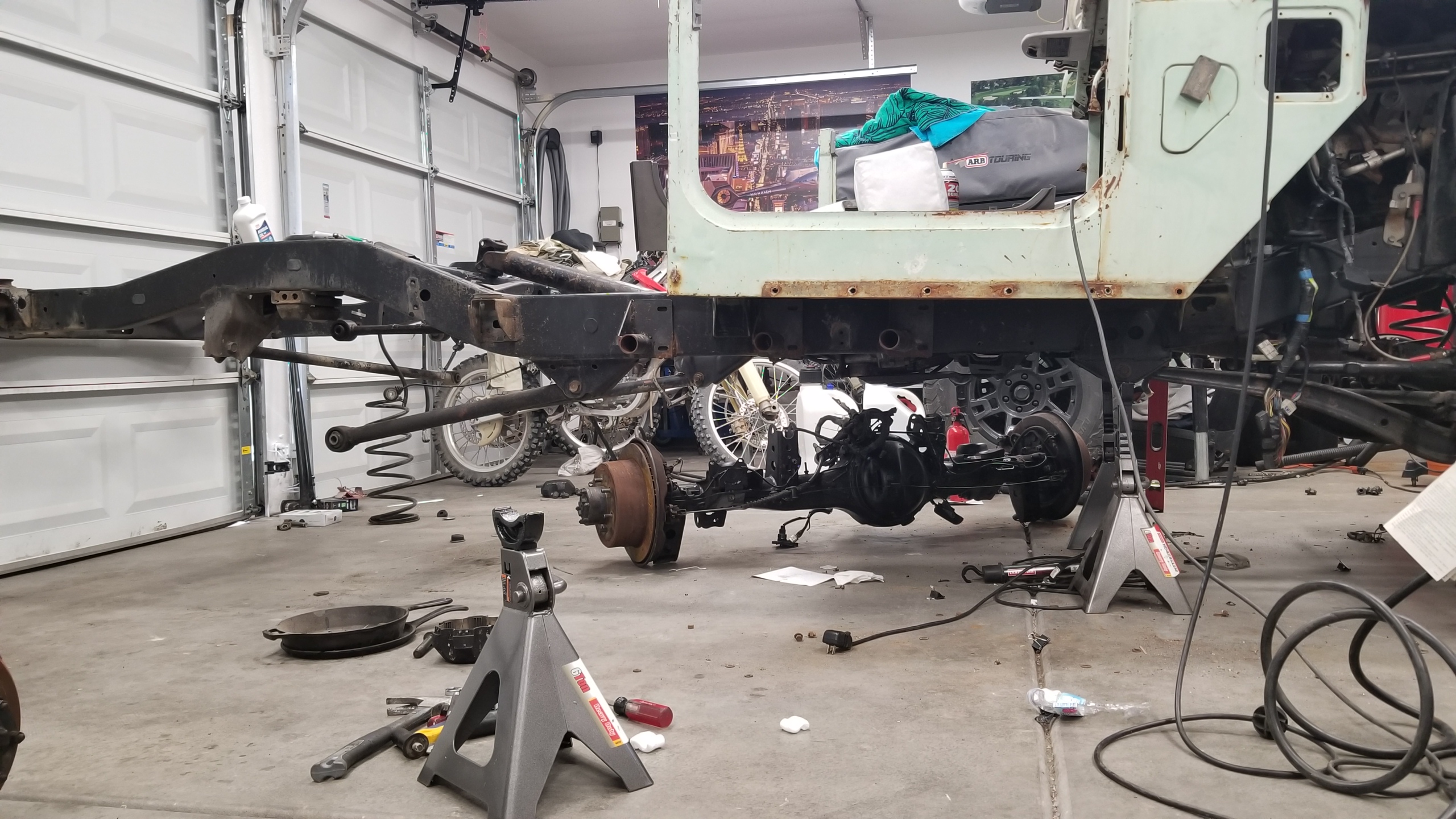

I really wanted to start on the body this weekend, but I'm tired of moving these axles around the garage. I knew I'd need to put them in sooner or later, so I knocked them out yesterday. Need to order a front knuckle kit from @cruiseroutfit on Monday.
Rear out
E Locked rear in, front out
And now she's Locked X3!!!

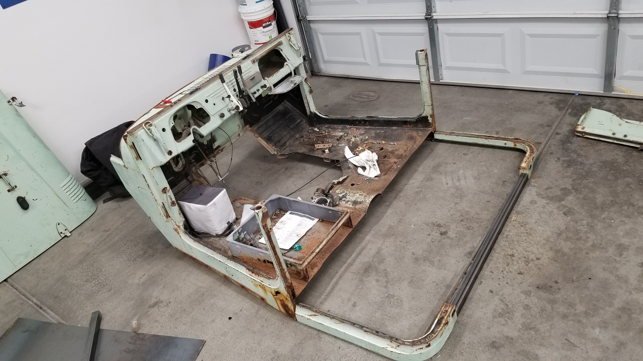

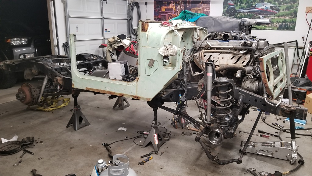

Been getting a lot done on FZJ45.4!
I cut the rear top rails to the final length. The cab will be a factoy FJ45 + 16". These are the outer dimensions of the cab-

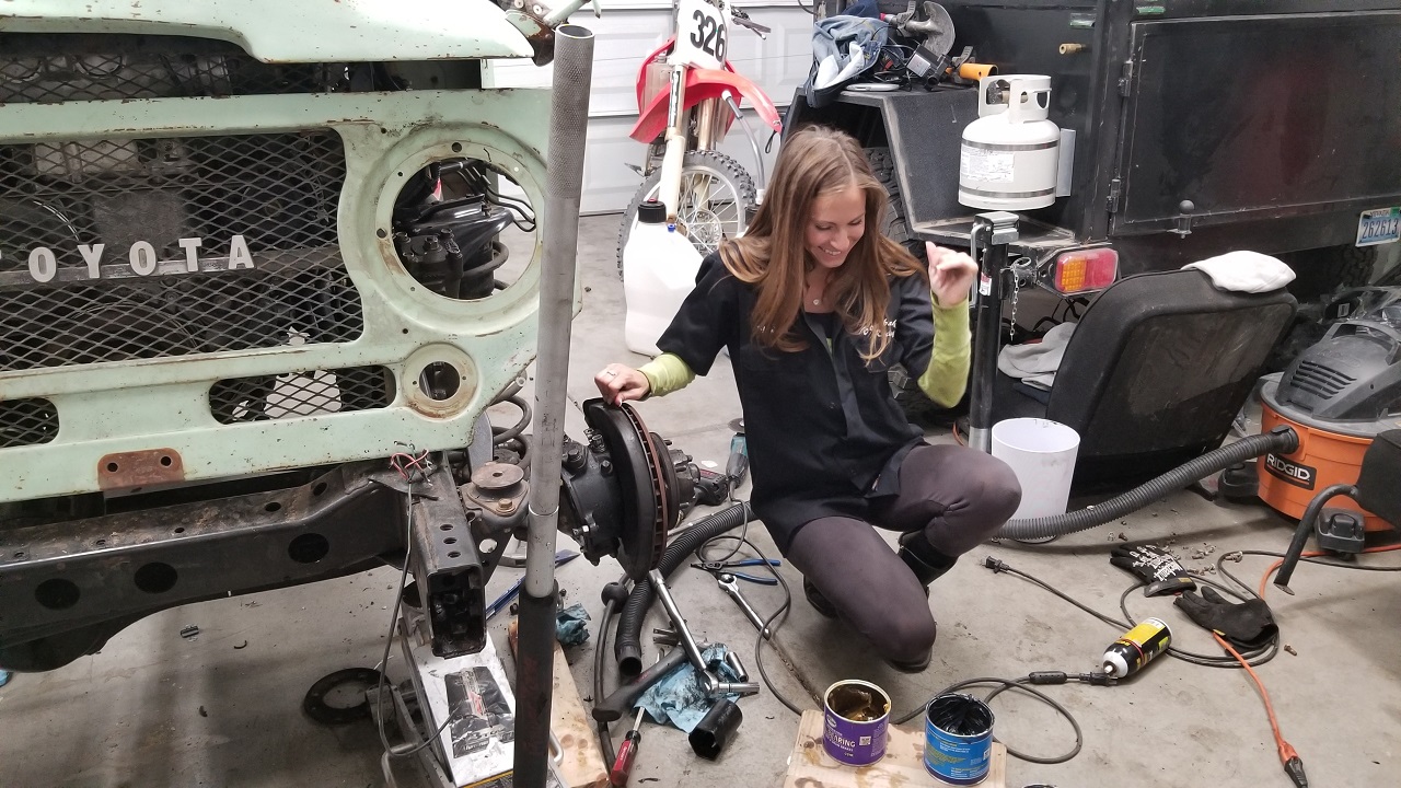

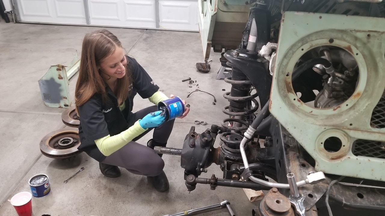

My wife retained the 'Best Wife in the World' title, after helping me rebuild the knuckles. I showed her how to do the passenger side, and she did the driver's side on her own.

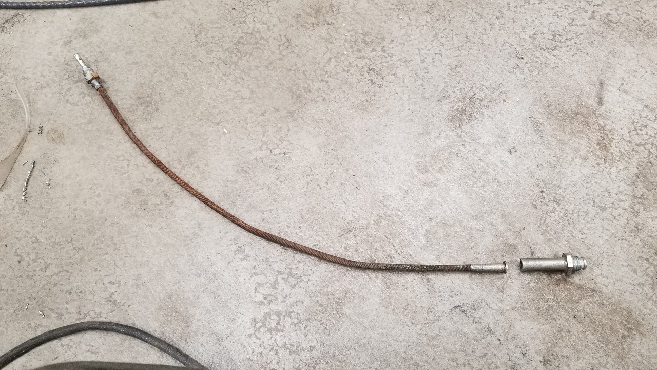

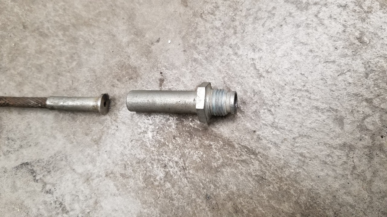

I ordered all of the push/pull cables that will actuate the diffs, CDL, high/low, and transmission

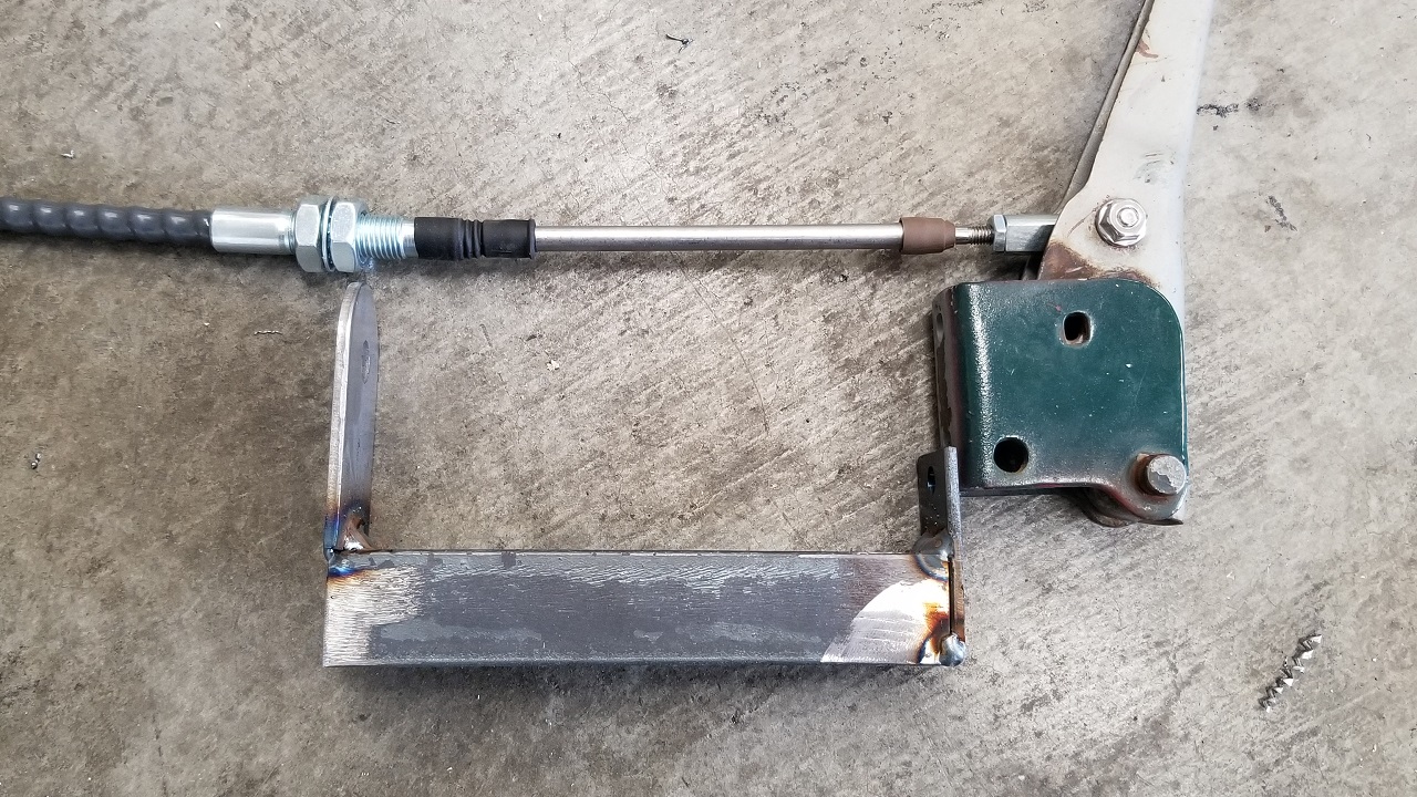

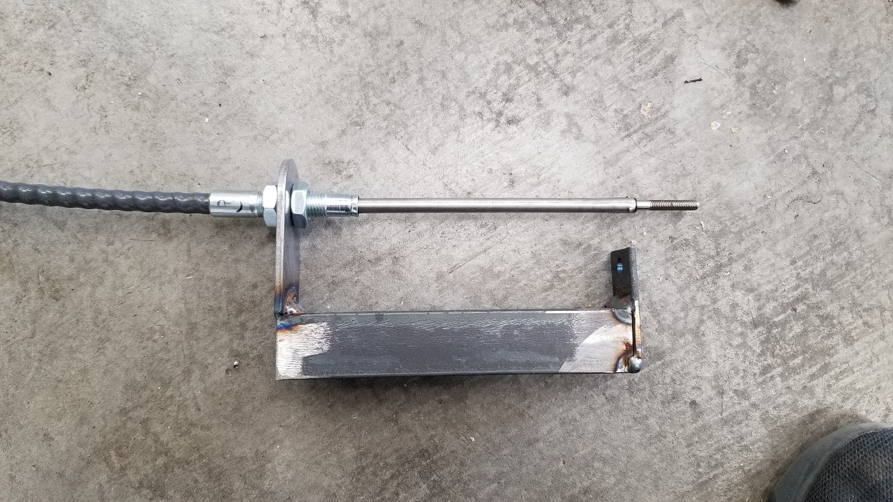

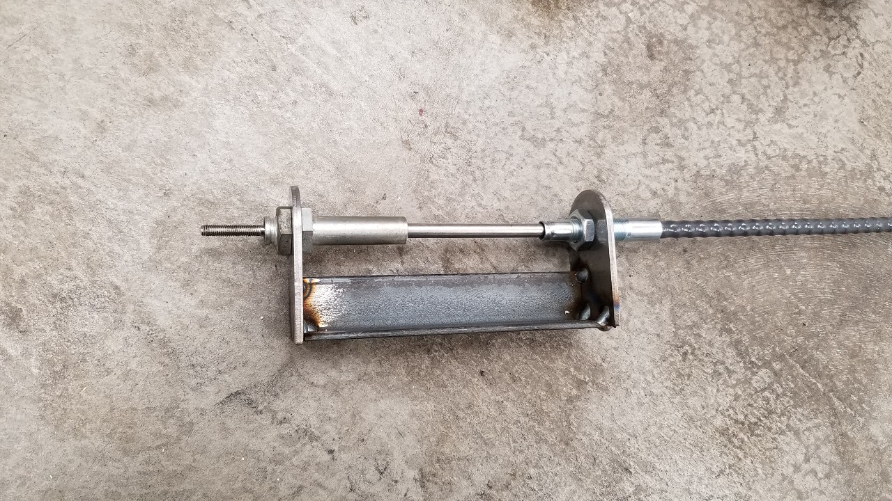

I need the cables to be hard mounted behind the dash, so I build 3 brackets for the levers. They use the same 2 mounting holes as the levers themselves, and go about 7" behind the dash to mount the cable housing.
Now that I know the travel each handle is capable of, I can build a suitable lever for each item that needs to be controlled.
I also used the factory F.D. knob housing to mount the cable for the center diff lock. Again, I had to make bracket for the cable housing, so it is hidden behind the dash using the factory nut. Turned out just as I was hoping!
