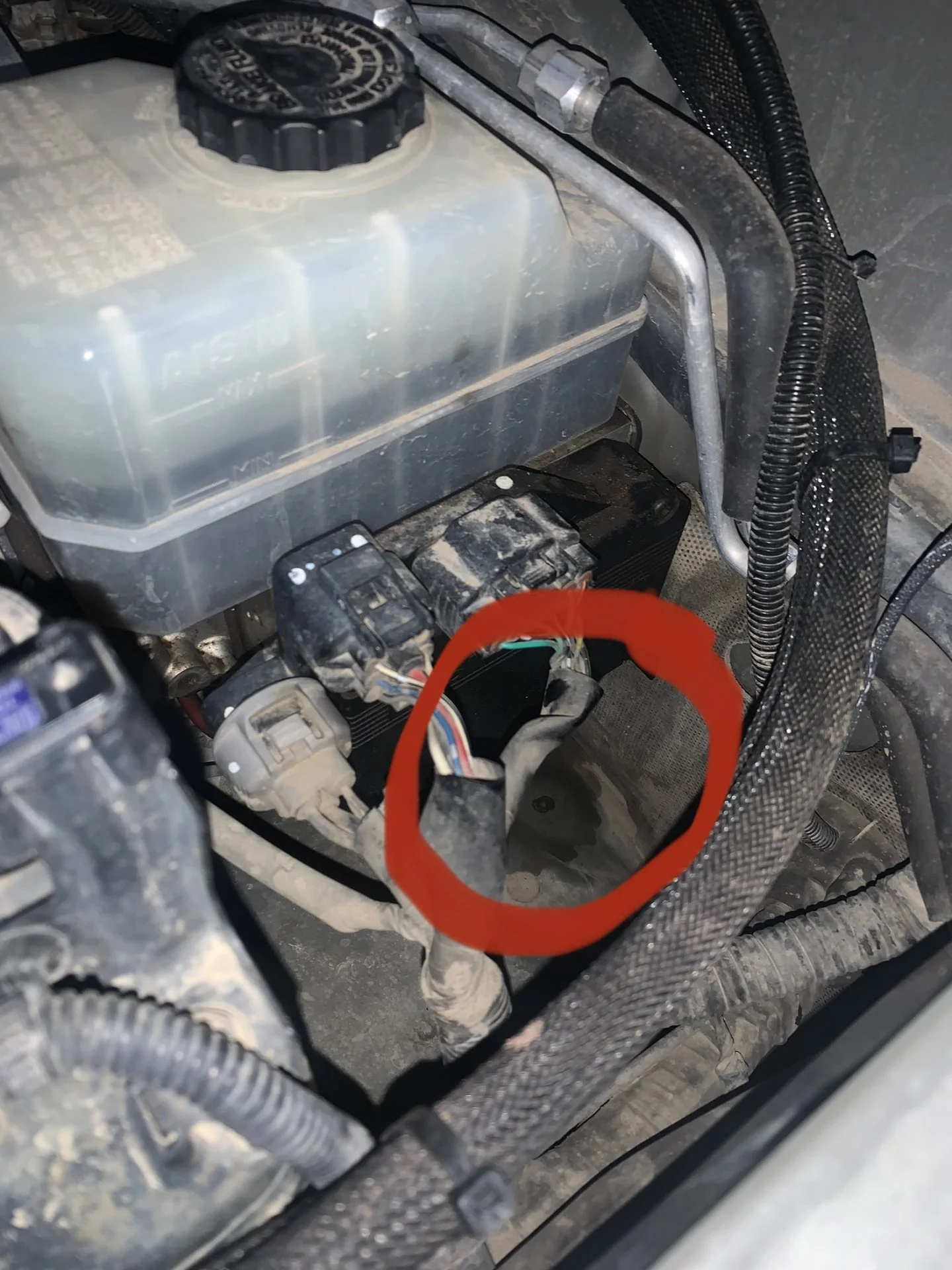

I appear to have some fluid weeping here...
Theres a black junction box with three main harness connections that has a metal tab and it’s wet but not dripping. Just weeping.
brake fluid level is in the middle range.
no codes on the scan gauge.

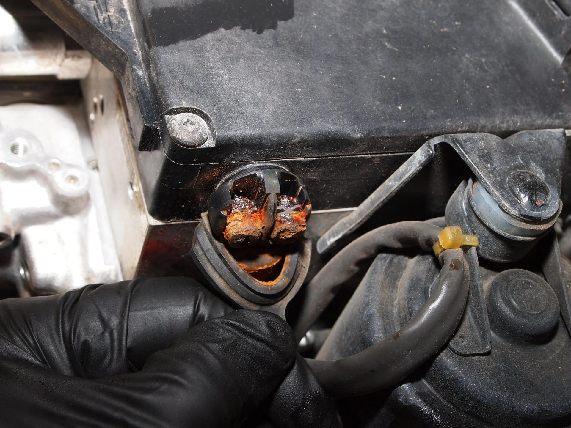

Suggest start here with this article by @2001LC
You guys need to stop driving them, now. The brakes will stop working almost completely, soon. They don't just get weak, they get GONE. With a full leg force, they barely do anything.
You can find rebuilt units on ebay, or just message Andy Le on FB. I got a rebuilt unit for $550 from him (rebuilt M/C, rebuilt motor, tested accumulator), and its beemn working fine for over a year now.
