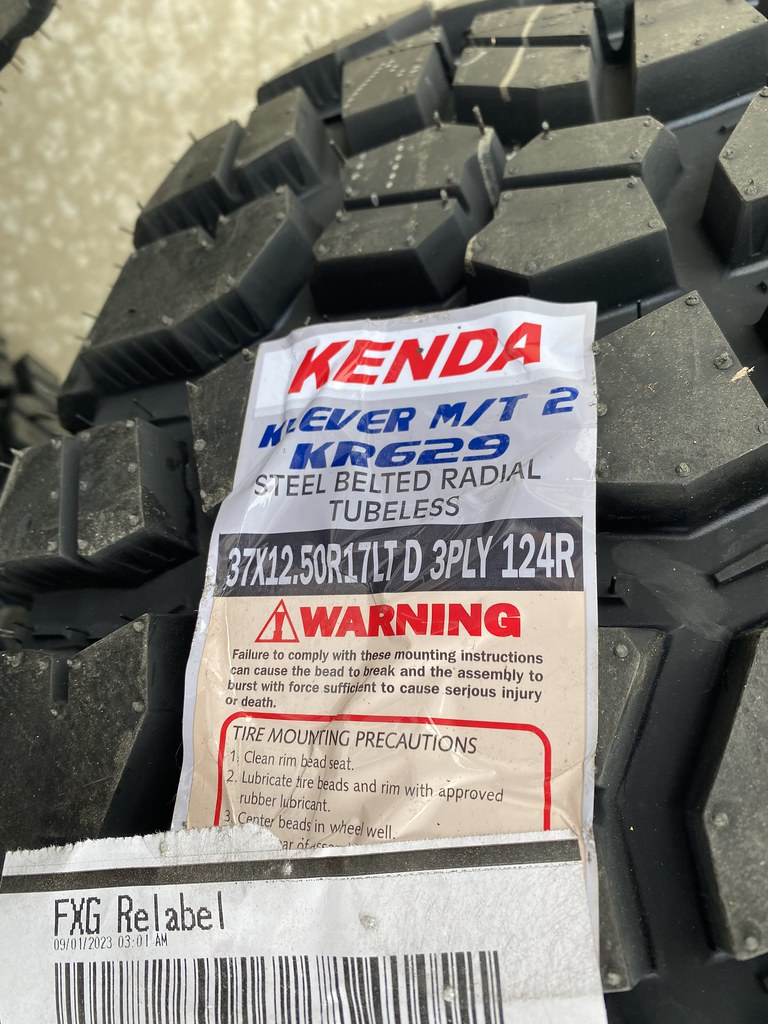

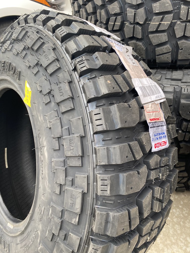

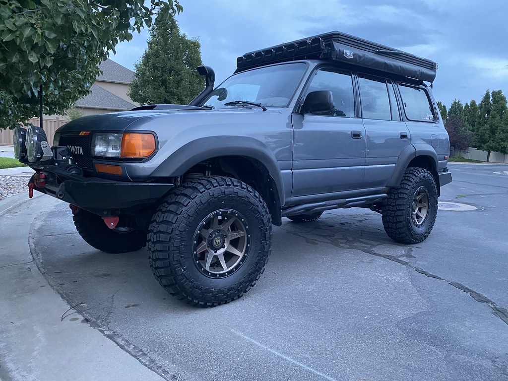

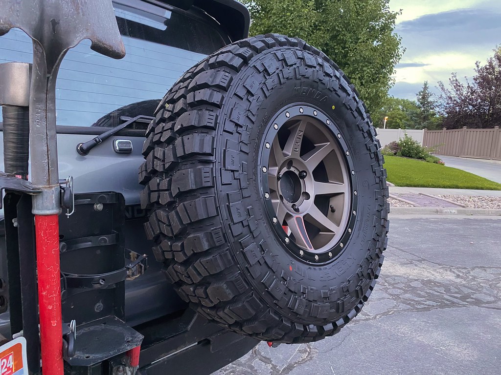

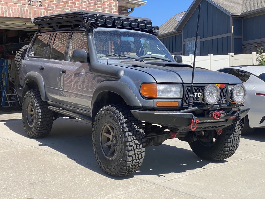

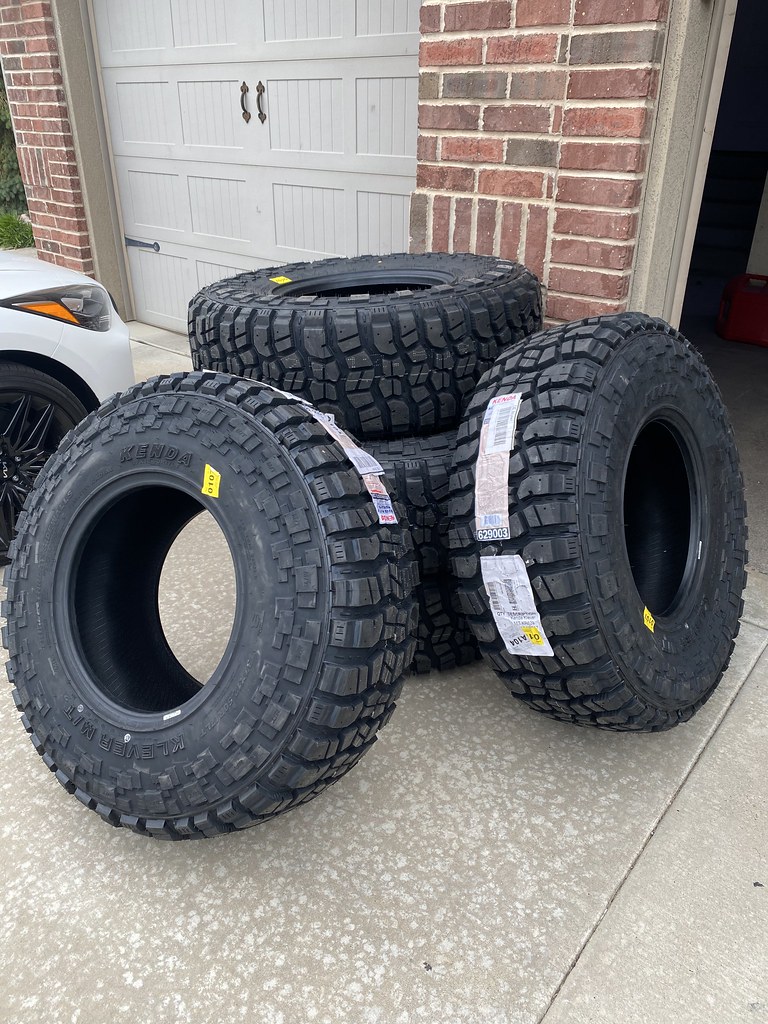

I recently got new tires on the cruiser. I've been extremely happy with the Toyo MT's that I've been running for the past few years. I have been through two sets of them and they are by far my favorite tire I've run. But, I also like to try different tires that look like they have potential. So I hesitantly decided to try something different from the Toyos that have been so good. I decided to try the new Kenda Klever MT2. The tread pattern has similarities to the BFG KM3 and they also have some interesting sidewall tread. Kenda doesn't offer a 37x13.50 like the Toyo so I got the 37x12.50's

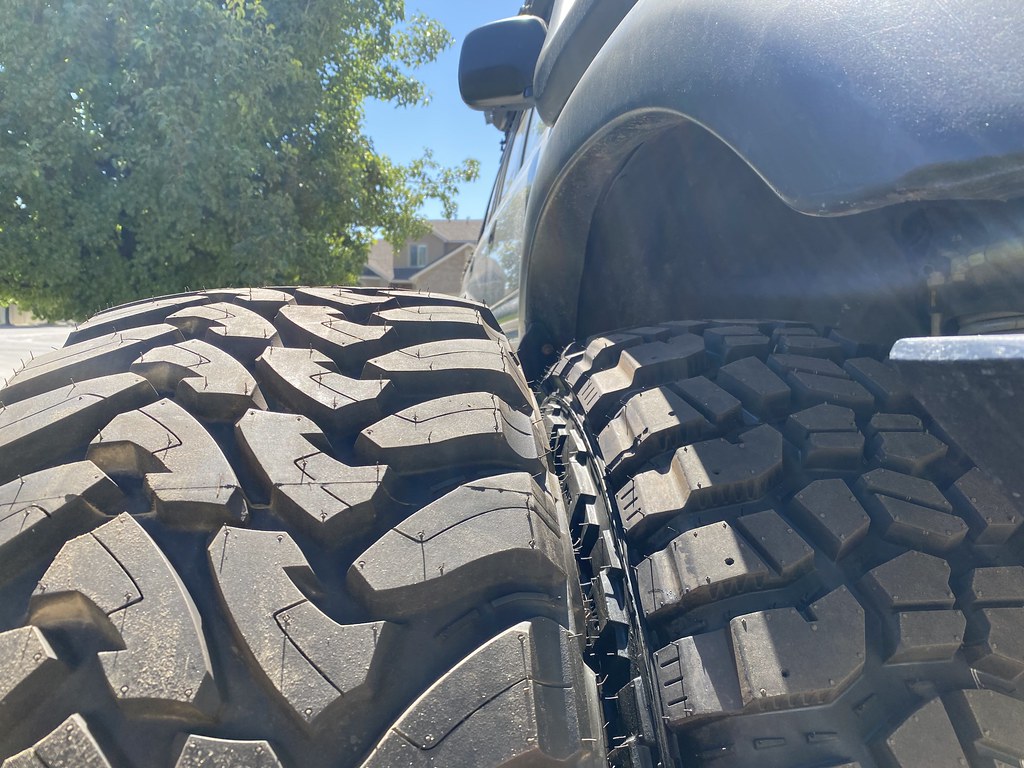

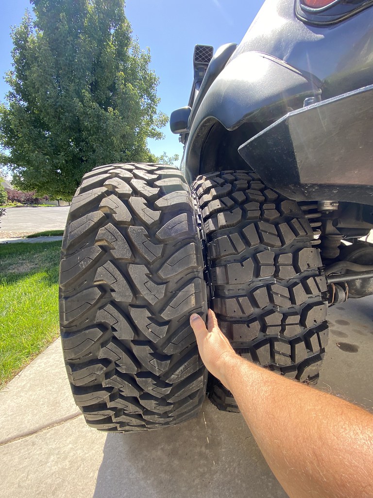

I was disappointed however that when compared to the Toyos the Kendas run quite small for a 37. The Toyos are a pretty true 37. But the Kenda measured 35.5"! That's nearly an inch shorter than the advertised diameter.
Here's a photo showing some of size difference compared to one of my Toyos. (Before someone says that the Toyo doesn't have any weight on it, I realize it doesn't in this photo but the measurements I took were of both tires mounted on the wheels and off the truck with no weight on them) The new Toyo (was my spare) measured just shy of 37" and the new Kenda measured 35.5" Frowny face. The difference in width is even more evident.
Untitled by Adam Tolman, on Flickr
Oh well, I like how they look and we'll see how they do offroad and on the road over the next several months.

That criminal, I can understand 1/4"-1/2" but 1.5" from the advertise size is unacceptable.
It's far enough off that I would try to return them. I sure my tire guy would exchange them but I have been going to same shop for 35 years.
JMHO The toyo's look way better !!
That criminal, I can under 1/4"-1/2" but 1.5" from the advertise size is unacceptable.
I know. I debated returning them but it's alright. I'll run them and see how they do. Just need to be aware they run small. If they're good and I get another set I'll just get the 38's. :)
Can't argue about the looks of the Toyos. They're sweet.

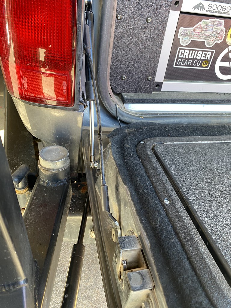

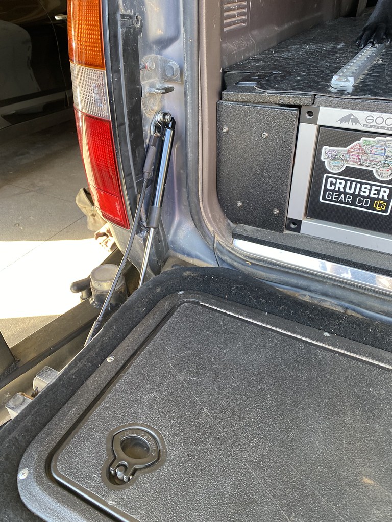

Just realized I forgot to add a post to this thread about the Delta tailgate storage I added a few months ago. I ditched my DIY tailgate storage and replaced it with the relatively new offering from Delta. As you'd expect from Delta, it's a quality piece and very sturdy. I've had a few months now and it's been nice. I'm thinking I may add some carpet to the top surface. The bare aluminum can get a little hot out in the sun and can also be blinding if the sun reflects into your eyes. But other than that, very happy with it.
