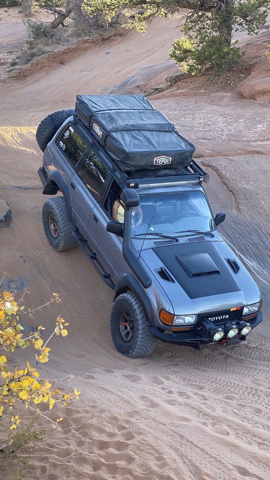

The next big thing I tackled was trying to hide some of the failing clearcoat on the paint. Decided to do it with vinyl for now until I decide I'm ready to repaint the truck. I kept some of the Moonglow visible on the doors but added the white to the main problem areas and some black on the rear purely for the aesthetic.

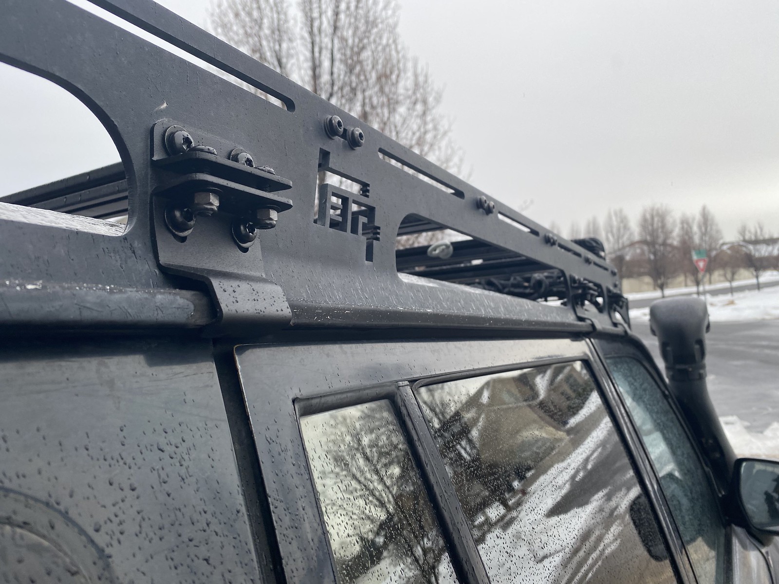

What did you change out the Prinsu gutter mounts too?
The ones in the post vinyl wrap photos look way beefier than the OE Prinsu gutter mounts.

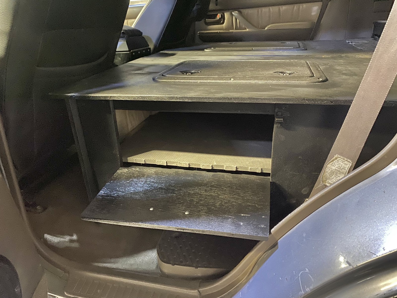

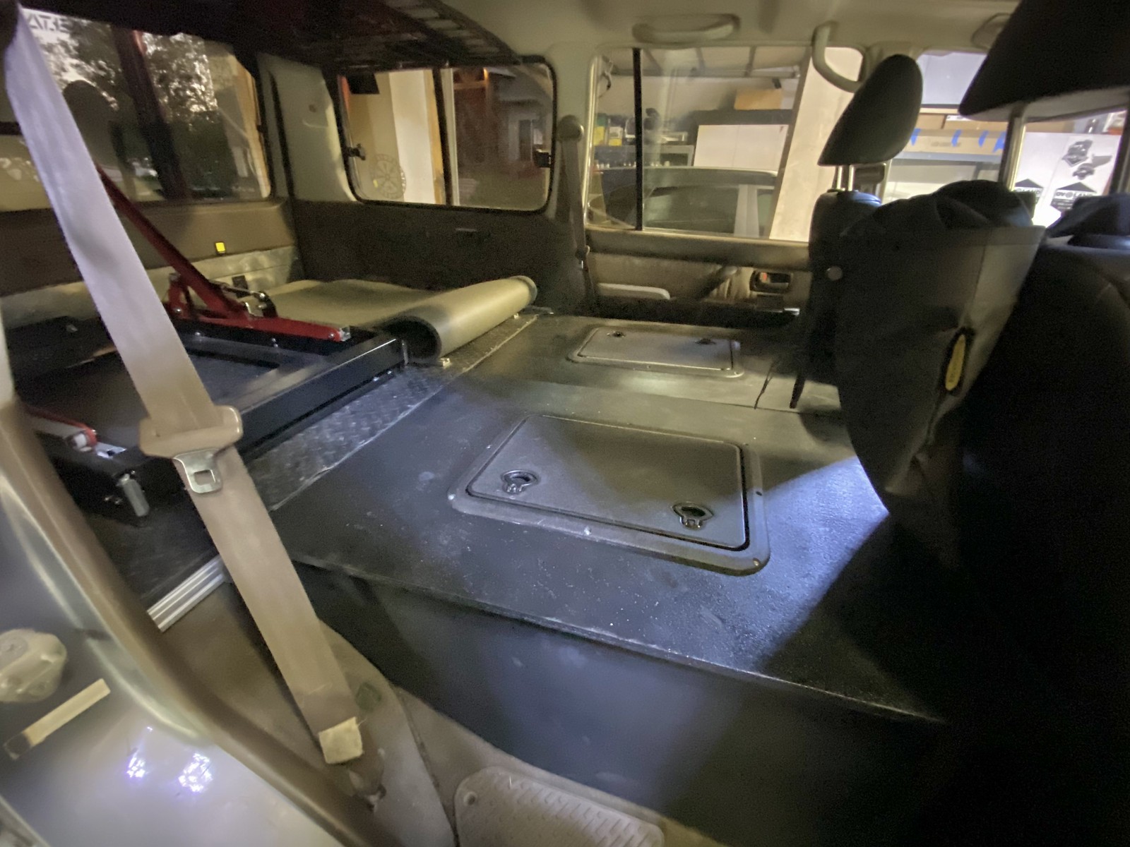

These aren't the best pics but I forgot to add these to my build thread. This was a quick project I did back in October before a week long trip in Idaho. I have had Goose Gear drawers in my 80 for years and the middle row seats are level with the drawers when the seat back is folded. This has worked (sort of) as a sleeping platform but would leave a gap between the front seats and the middle seats. So I've wanted to add a more purpose built platform to the middle row area. I built these as two pieces, one for each side, so that I can still use half of the middle row seat if needed and still have a platform to sleep on. The two sides clamp together and use the seat mounting to secure them to the floor. Each side has a access door on the top (repurposed by old tailgate storage hatches), and the driver side also has a side access door. The amount of storage that these provided was a nice surprise. Kept so much stuff out of the way and secure but also easy to get to. They worked much better as a sleeping platform too. Sprayed them with Raptor liner.
Now that our kids are older and the rear seats aren't needed as much these will probably live in the Cruiser semi-permanently. Really happy with them considering I built them in a rush the day before leaving on the trip in October.

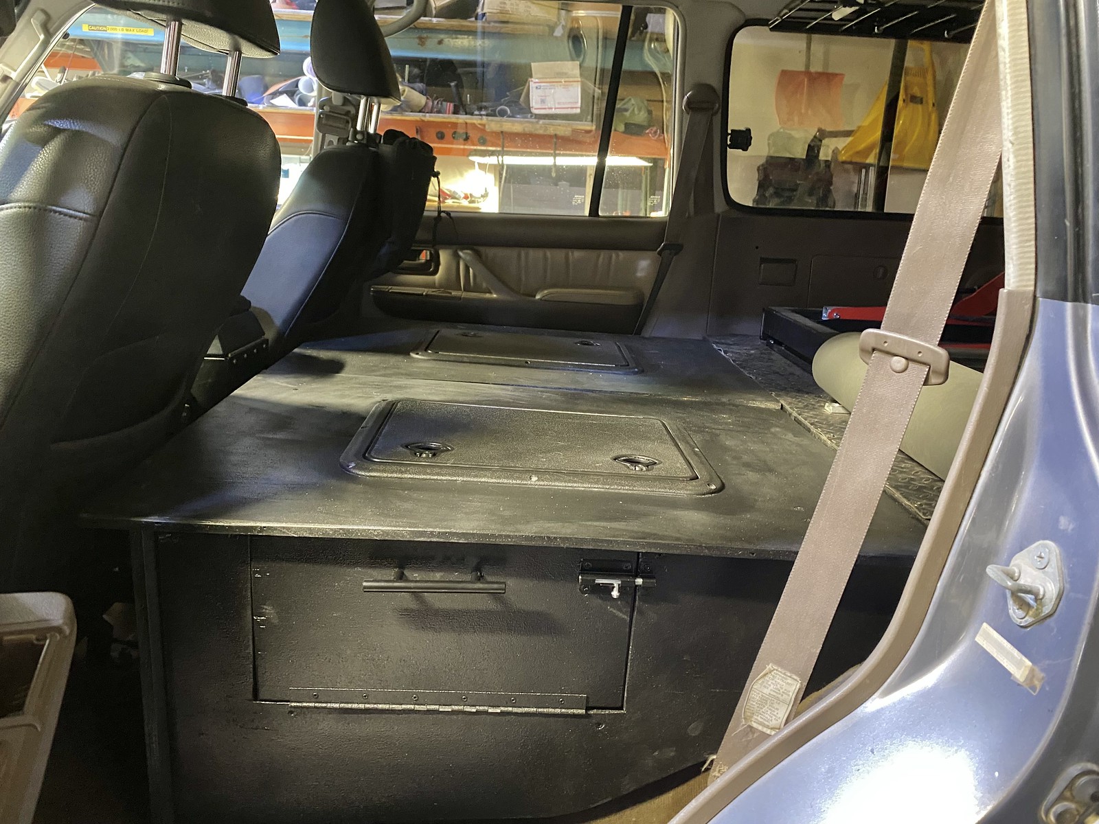

Good job not using 3/4 Plywood it's over kill and heavy !
