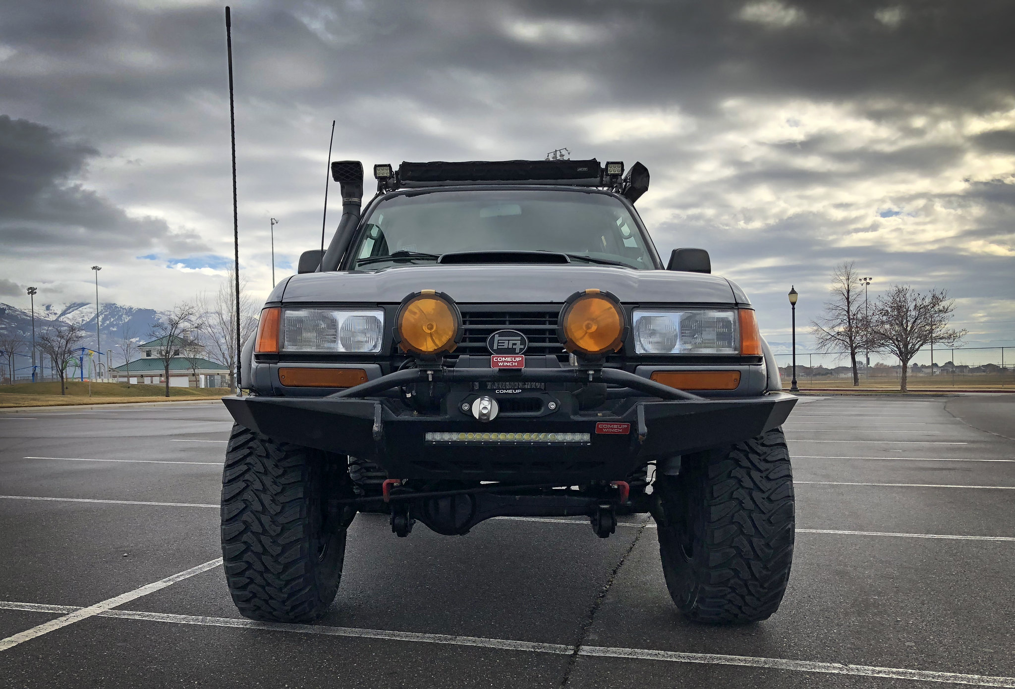

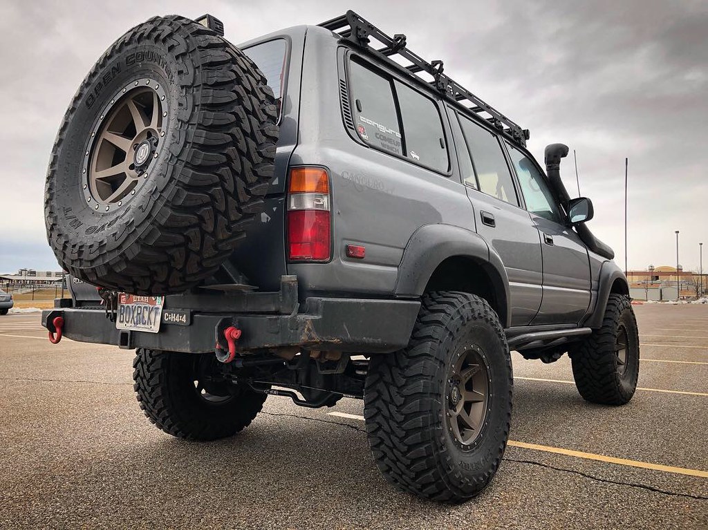

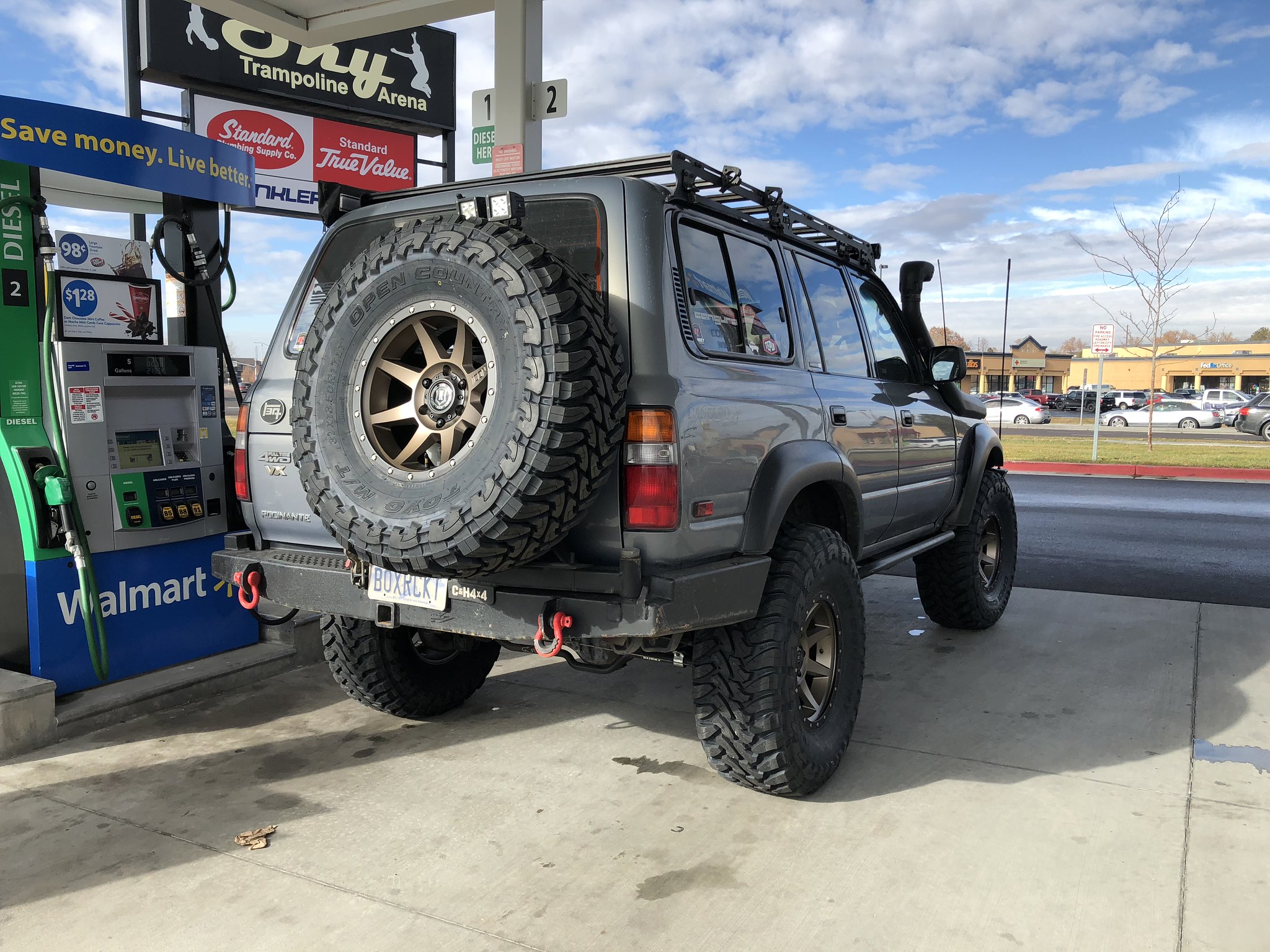

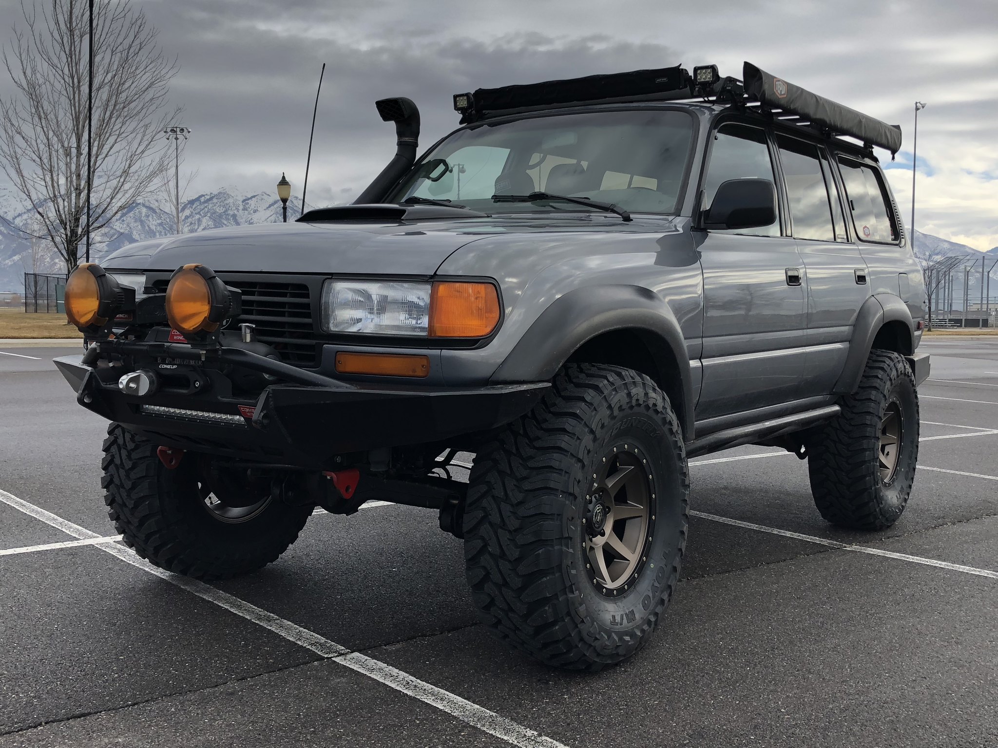

New wheels and tires this weekend. Made the jump to 37's and picked up a full set (5) of 37x13.50 Toyo Open Country MTs. True 37's with a total height of 37.05". Was planning to just get another set of 35's but was able to work out a deal on some 17" Icon wheels. There are very few tires options for 37's that fit a 16" wheel these days so since I had a lead on the 17's a pulled the trigger on the 37's.
Wheel are Icon Alloy Rebounds, 17x8.5, zero offset. I still have my 1.5" spidertrax spacers on. If you run these wheels without spacers then the centercaps will not fit. I thought about removing the spacers but I wanted to run the centercaps and I've also had no complaints or issues with the spacers so I left them alone.
Pictures don't do the Icon wheels justice. They look so good in person. I wasn't sure about the bronze color with my Moonglow paint before I ordered them but now that they're on, I love the combination!
I still need to add 1" to my bumpstops. I'm planning to add some f/r Timbren bumps in place of the frame mounted bumpstops to take care of that. Should have those in a couple weeks. The tires are pretty tight at the firewall and I've done a little trimming of the flares and took a little off the bottom of the inner fenders. That's working fine for normal driving but they'll still make minor contact when stuffed. So I might weld in some plates to relocate the front axle 1" forward and it should be good to go.

Here's some pics.
IconWheels and Toyos by Adam Tolman, on Flickr
Height difference of the new 37" Toyo next to a 50% worn 315 Cooper STT Pro.
This 315 has been my spare and it's a Goodyear MTR that only has about 10 miles on it. I wanted to compare the new ones next to a new actual 35.
Before and After. Top pic is the 315/75R16 Cooper STT Pro on the SCS SR8 wheels.
iPhone 80 by Adam Tolman, on Flickr
Little bit of poke with the wheel spacers
Had to cut the fuel can basket and hilift mount off the swingout so the 37 would fit. I'll figure out a solution for that soon.

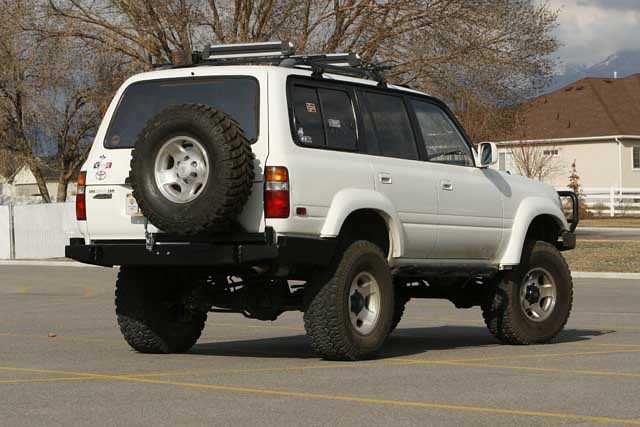

So I've seen a number of people posting photos this week that show a 10 year gap, or in otherwords, a photo or two from 10 years ago and another photo or two from recent days. Here's a few of mine. Interesting to go back to some photos from 10 years ago and realize all the things that have happened since then. Some things change others don't change much at all.
I was driving a different 80 ten years ago. My '93 that started my 80 obsession.
