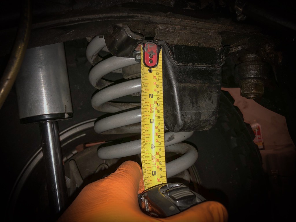

On the topic of 37's and proper fitment. I started to address the bumpstops this weekend. Different suspension setups might need a slightly different solution but this will work well for the 3" Slinky suspension. Just to review, a 3" Slinky kit with 35's is an excellent combination and doesn't require a few extra mods that are necessary to run 37's. With 35's, no front bumpstop modification is necessary. With 37's, you want to have an additional 1" of bumpstop. That could be just adding a spacer to the stock inside the coil bumpstop, but there's an easier solution that doesn't require removal of the coil. The Slinky kit already comes with a 1" taller bumpstop for the rear (it measures 3.5") that is used with 35's. I got another pair of these bumpstops from Kevin at Endless Horizon Outfitters and it was a simple bolt-on bumpstop to the front frame. These add the necessary additional 1" needed to keep 37's for jamming into the wheel arches, but still maximize travel.
Here's the taller bumpstop.
Slinky Parts by Adam Tolman, on Flickr
Bolted in place using the factory threaded holes on the frame. Note: I think '93-'94 US spec 80s have the holes but not the captured nuts in this location. the '95 and later trucks should have captured nuts. I haven't verified this 100% but this appears to be the case, so if someone with an earlier model wanted to use these bumpstops, a captured nut would need to be welded in or the bumpstop could be attached with two short welds.
3.5" total height.

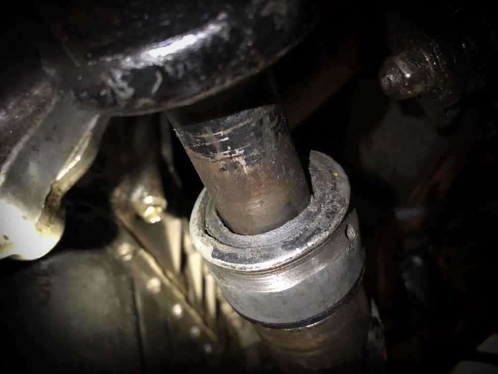

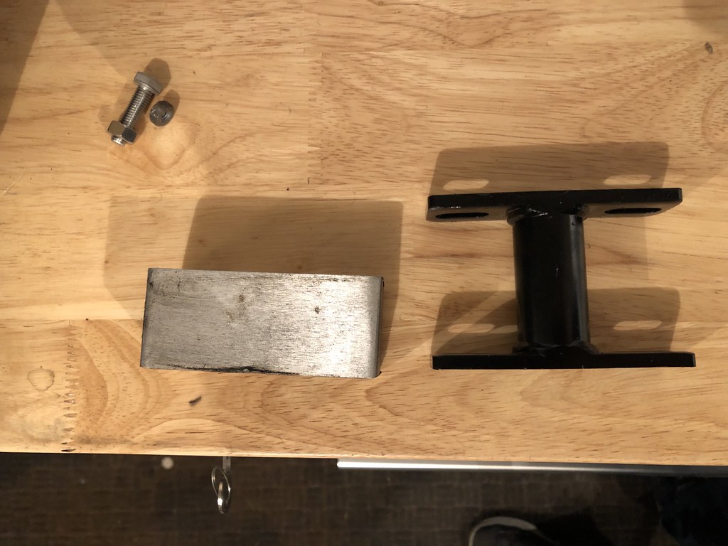

The other swaybar related thing I tackled this weekend was to replace the front swaybar spacers. I have been running a set of spacers that were on my last 80 with the OME kit. When I did the Slinky kit on my current truck it wasn't exactly purchased as the standard kit and I didn't get the f/r swaybar spacers since I already had them. The old front spacers were only 1.5" tall. They worked fine with my OME kit, but with the Slinky kit they have resulted in some contact with my DC front driveshaft at full droop. So I picked up a set of the spacers that are part of the Slinky kit to replace my old ones.
Old vs new.
where the swaybar has contacted the driveshaft. Not a big deal since it's just the dust cap but a good thing to take care of.

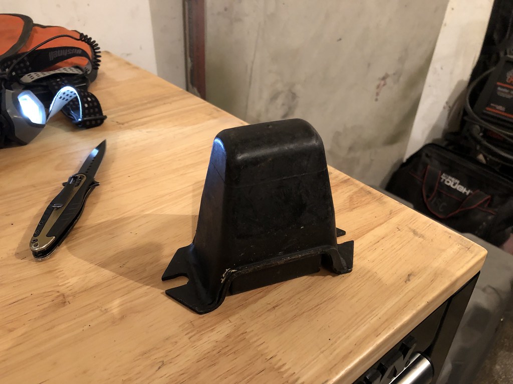

OK last piece of the puzzle regarding bumpstops. I got a full set of bumpstops from Timbren. I've heard good feedback from @woody and others who have Timbrens and since woody also has the Slinky suspension I was particularly interested in his opinion of them. He's a fan, so I got some to address the rear, but was also sent a pair for the front if I want to try them. Here's what I got from Timbren.
The short ones are the fronts. They would need to have the bracket trimmed a little so that they don't contact the coil during compression. But when compressed they should be the same height as the Slinky bumpstops I just installed so if I decide to use these they should work fairly easily.

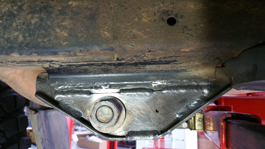

After the bumpstops are sorted, the last step will be to relocate the front axle ~1.5" forward. I plan to do this using the method Darren McRae has been using in Australia for some time now with the Slinky kits and factory radius arms. New plates are welded in to the frame bracket for the radius arms and new holes drilled farther forward. These will give better tire clearance at the firewall. Don't want to move it to far or there are clearance issues with the front panhard.
RadiusArmPlates by Adam Tolman, on Flickr
