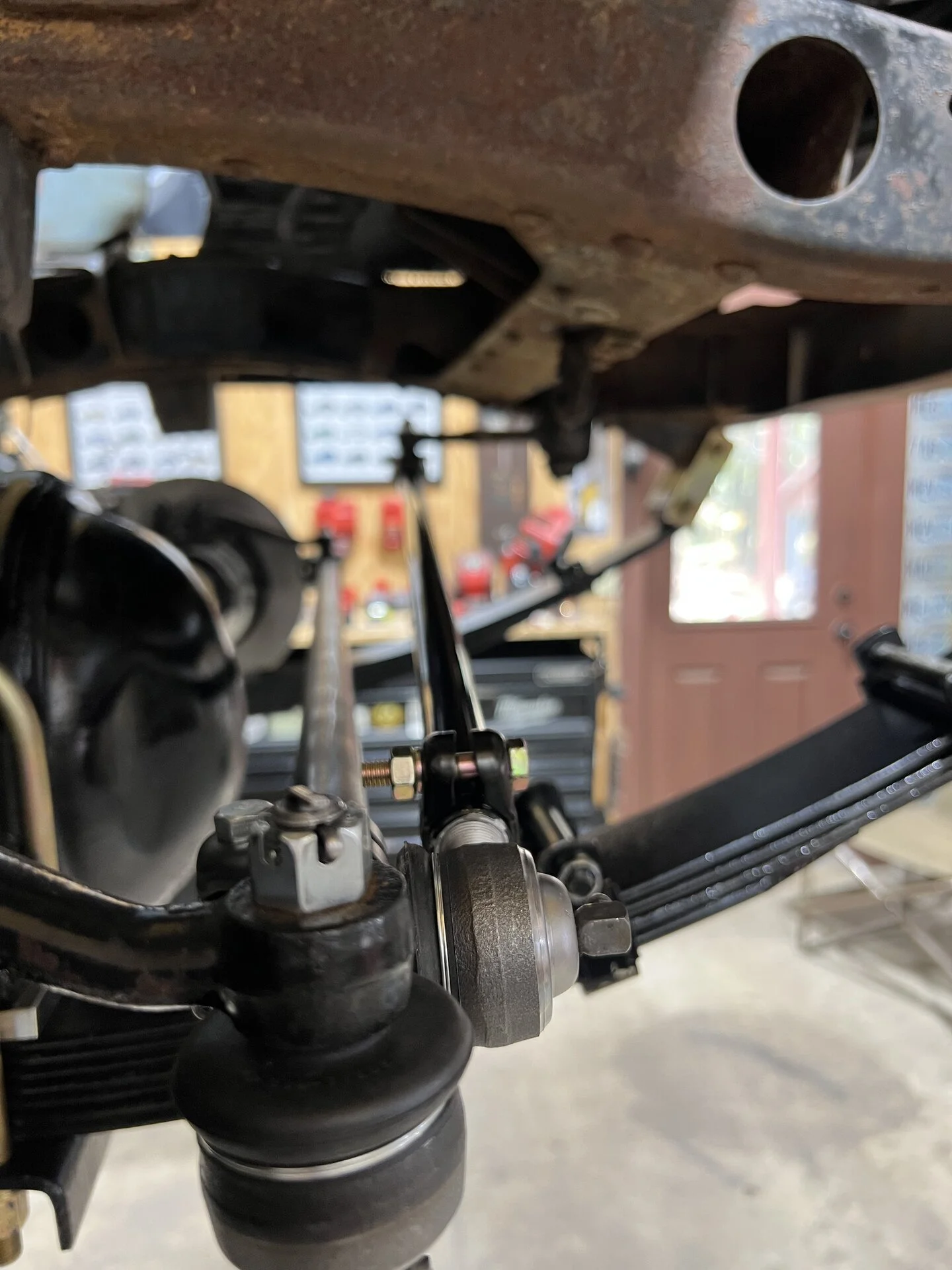

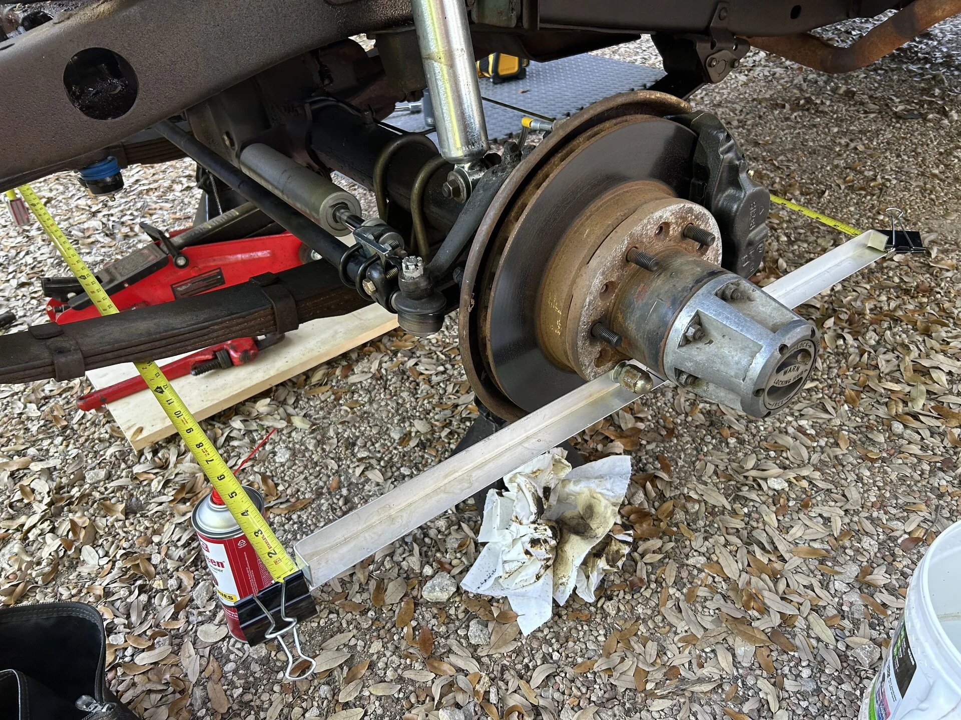

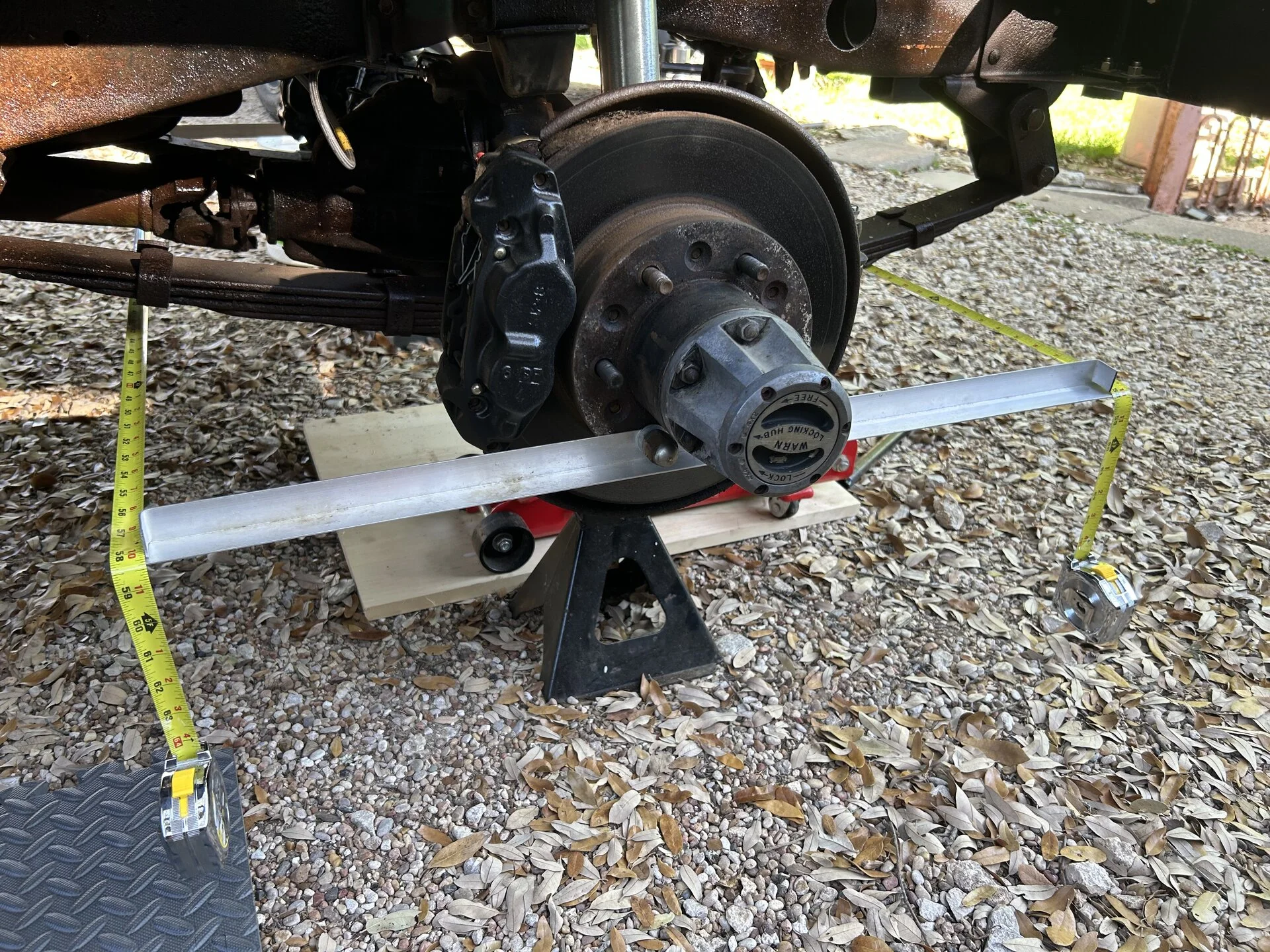

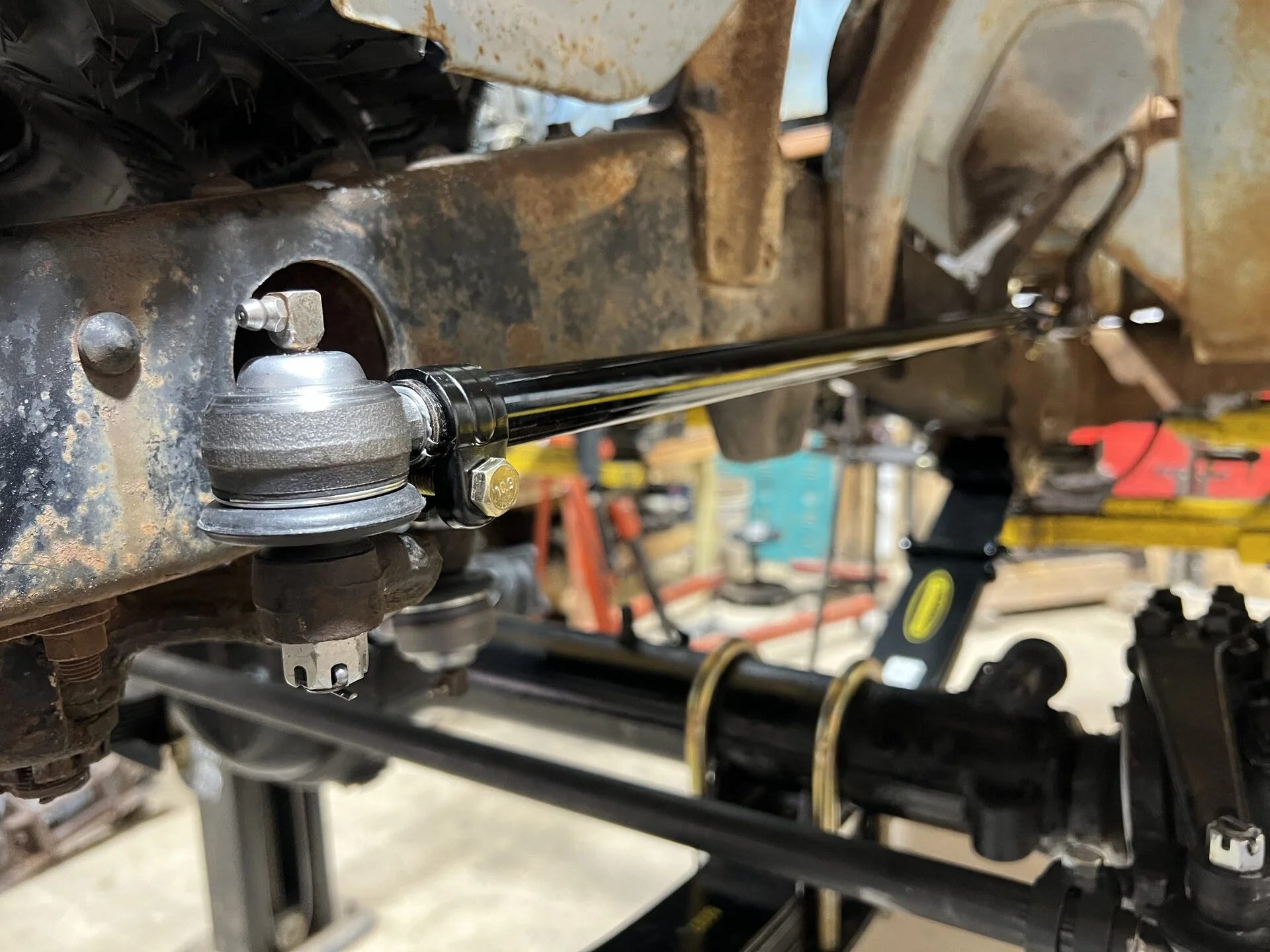

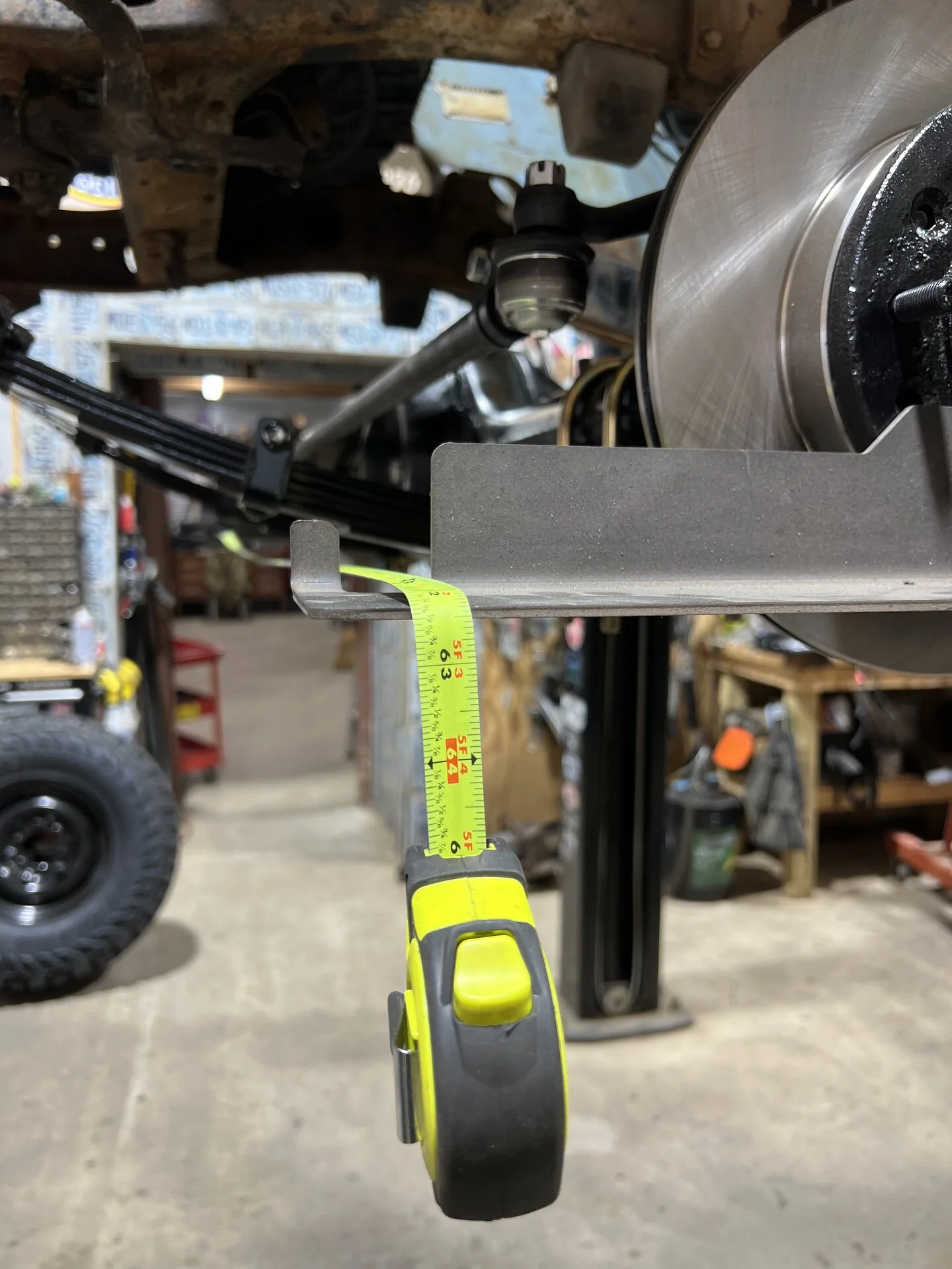

grabbed a burger local then went back to the 40. Got the new Tie Rods all in place. Toe set. Rods and ends painted. Stabilizer in place.
TMR makes them

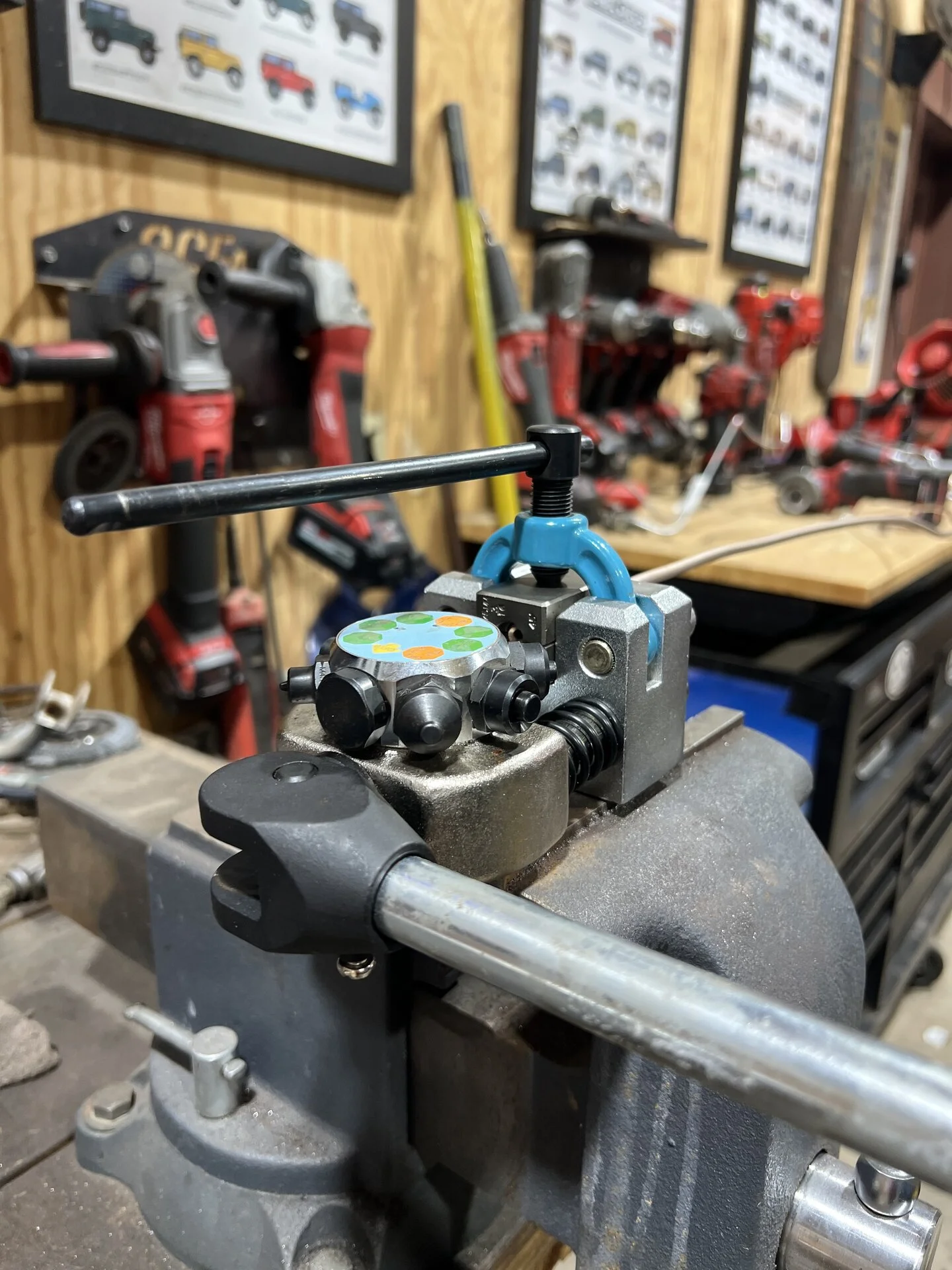

I made a Fischer Price version after seeing Nolan’s here. Works well for the random toe in I do…

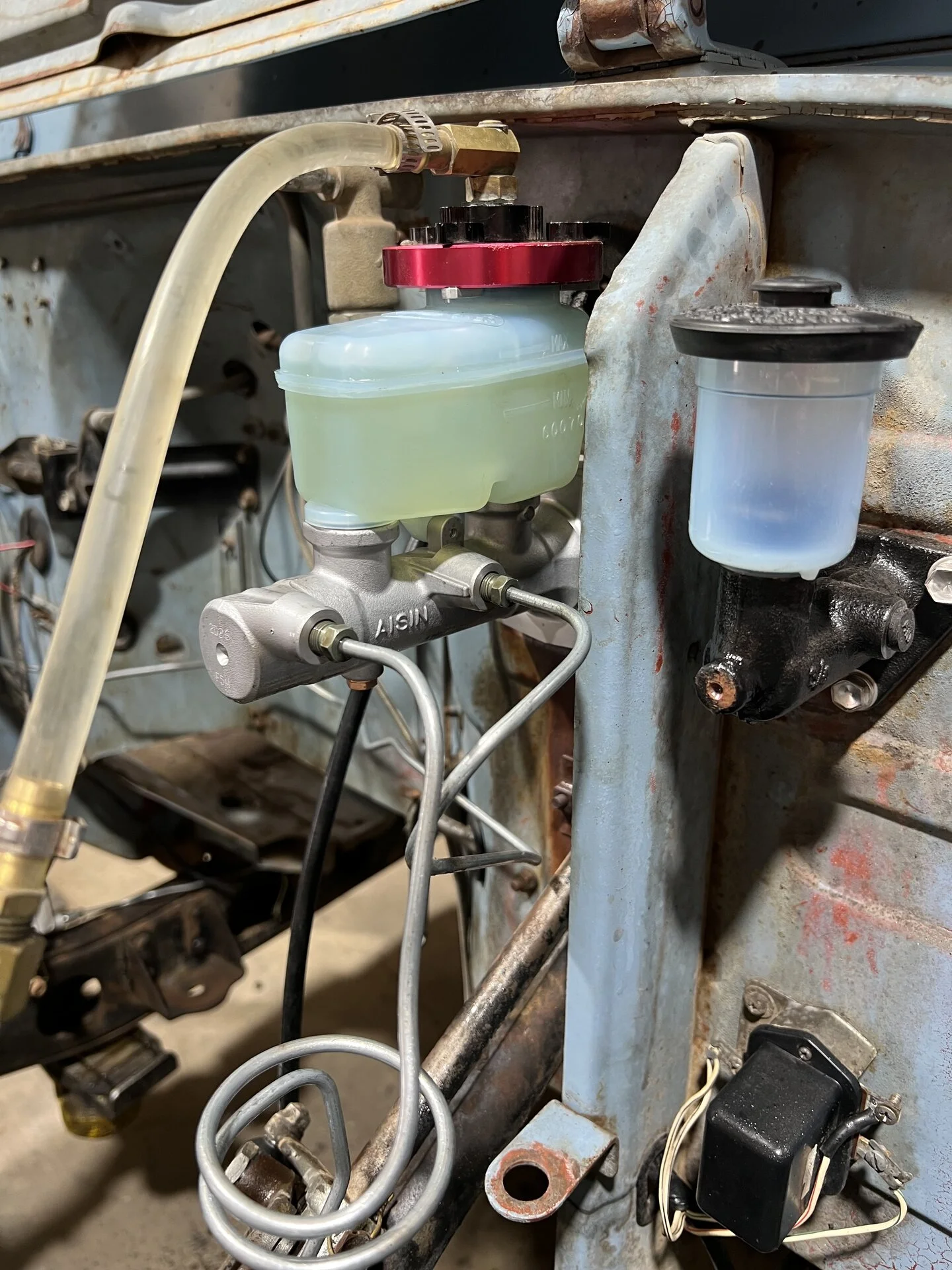

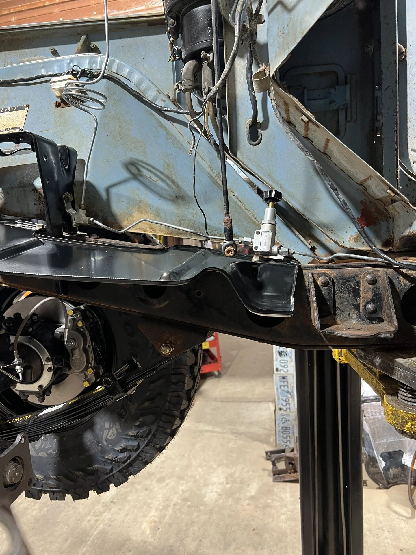

Spent the morning combo of using a SOR line kit and making lines to get the new 10mm lines all in the truck with a non ABS 80 master and a Wilwood proportion valve. Pressure pump makes it a one man job. No leaks. We are in business.

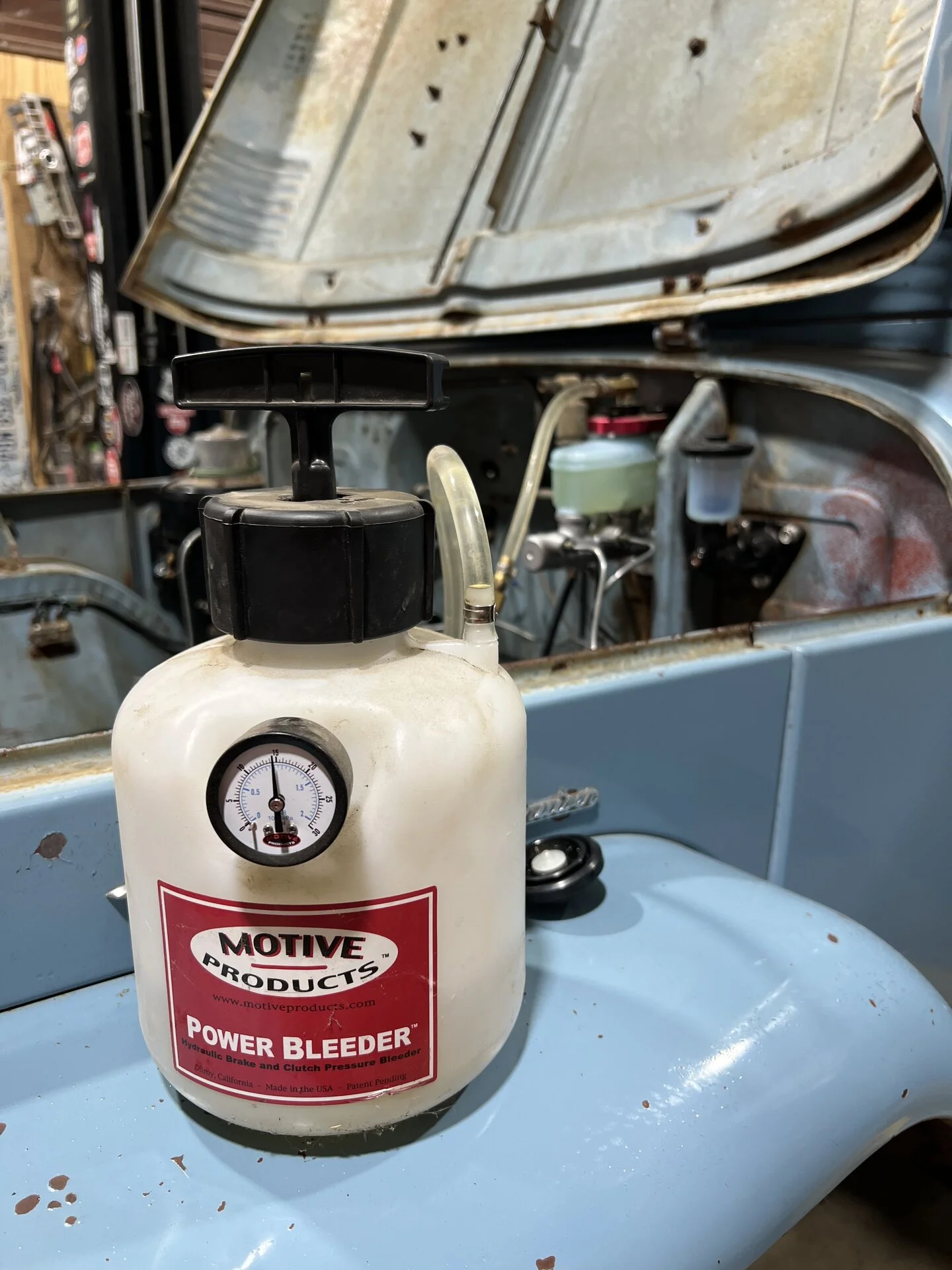

I have that power bleeder and get mixed results. The cap to resevoir is different than yours and uses a janky chain/wing nut setup to tighten it to the top.
How does yours (red one) fasten to the reservoir?
TIA
Ian

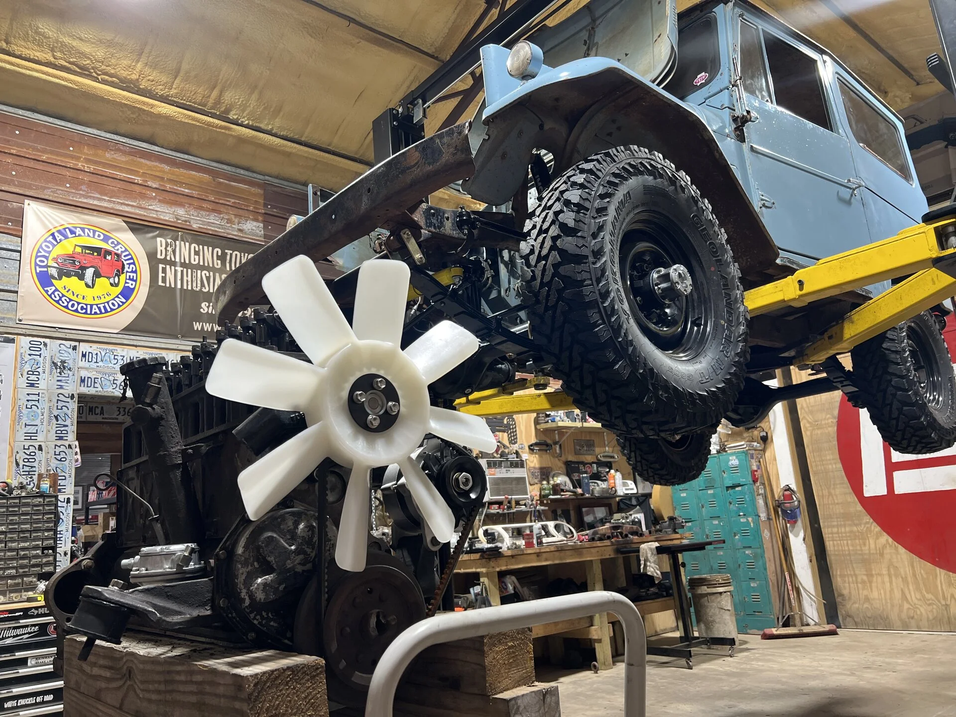

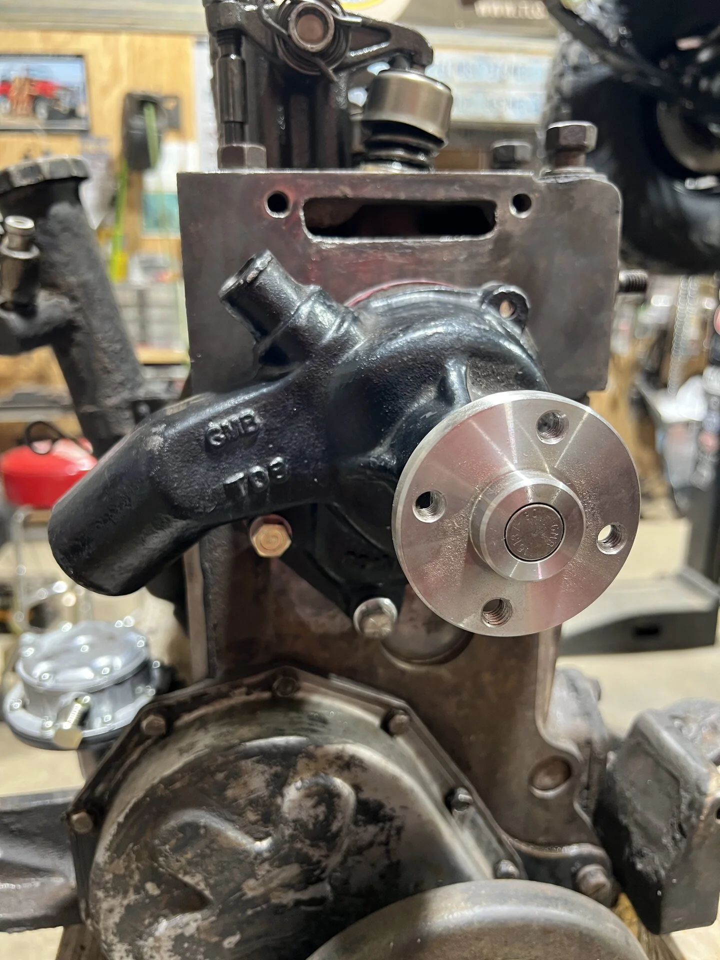

Rolled the F135 in.

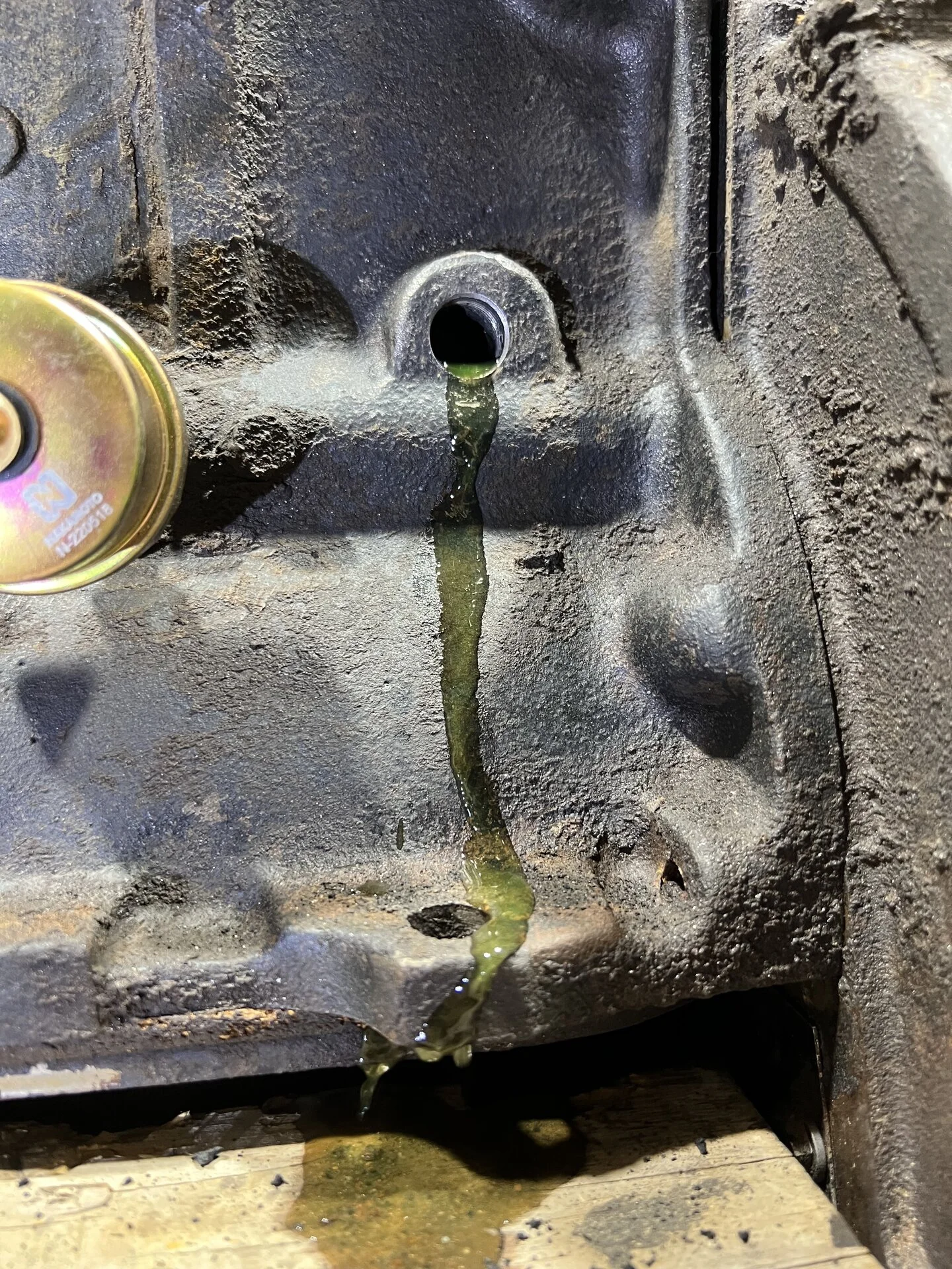

Coolant level was just under the water pump so when I pulled the rear drain and it was dry I knew it was clogged
About 20 minutes with a pick and an air hose and it is loose
New WP

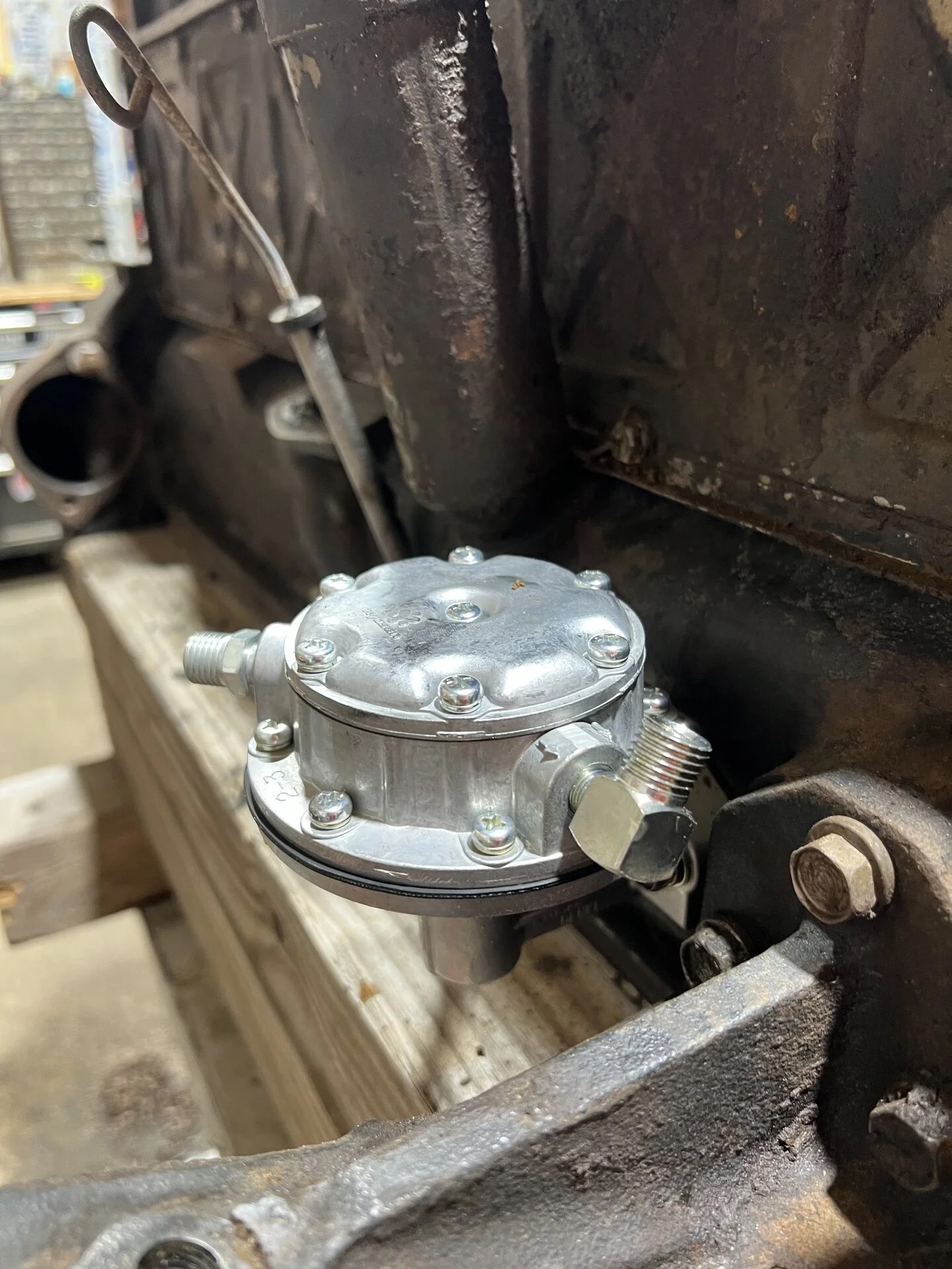

New FP
That’s it. One of the main reasons I take the dual res masters off. It seals perfect and makes it easy. Works on the clutch masters too
Yeah, want to do that on my 40. Even with the silly chain thing the 62 is so much easier.
Thanks for the reply and stuff.

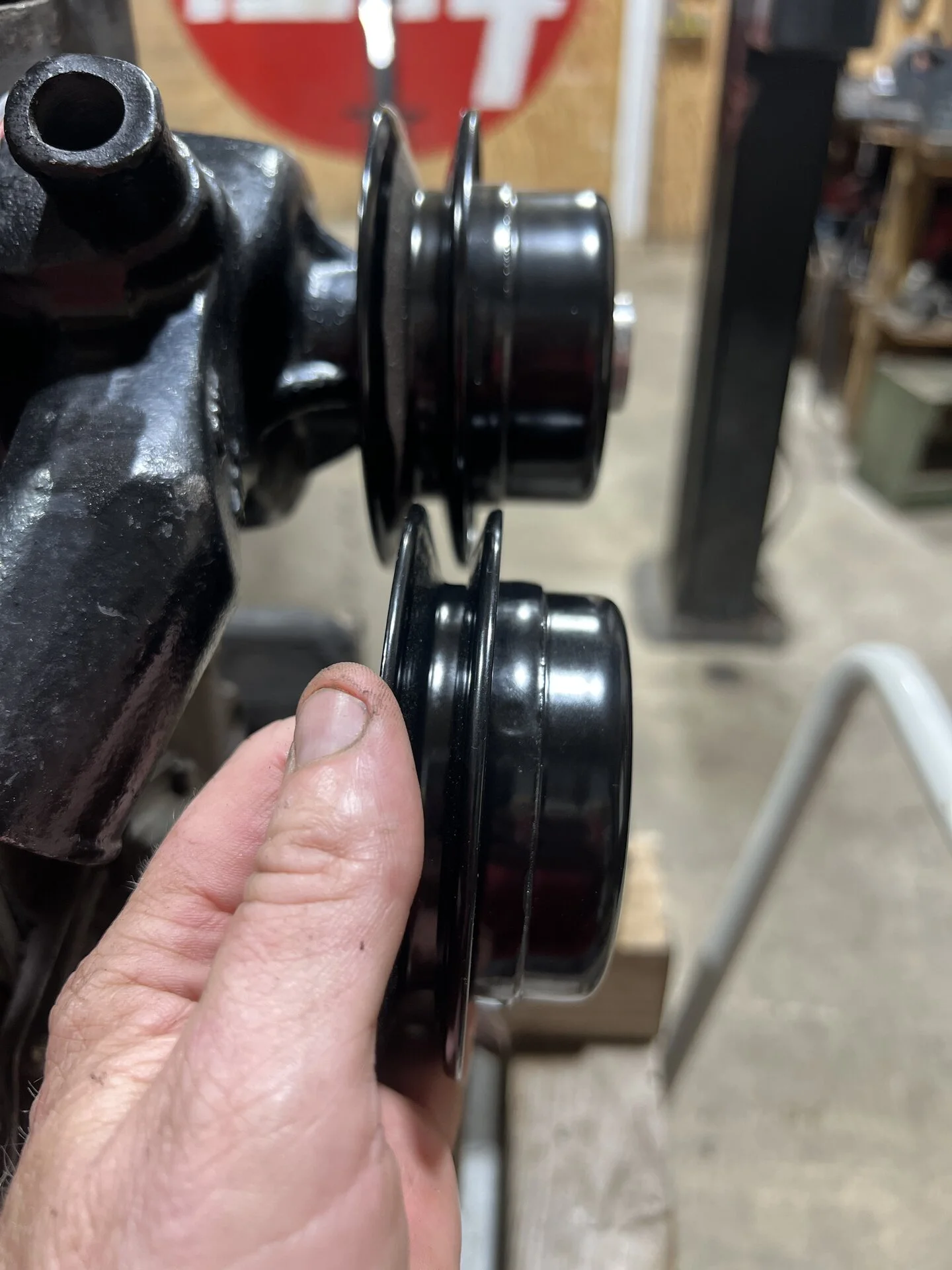

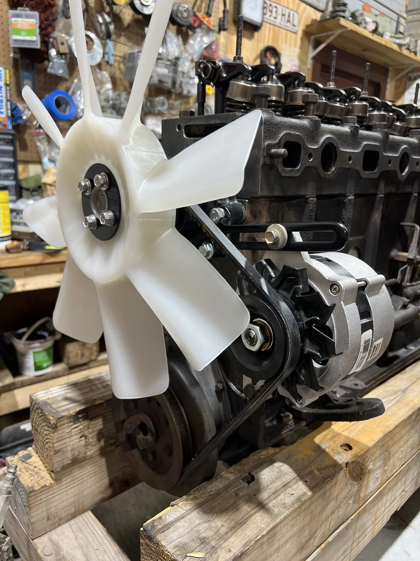

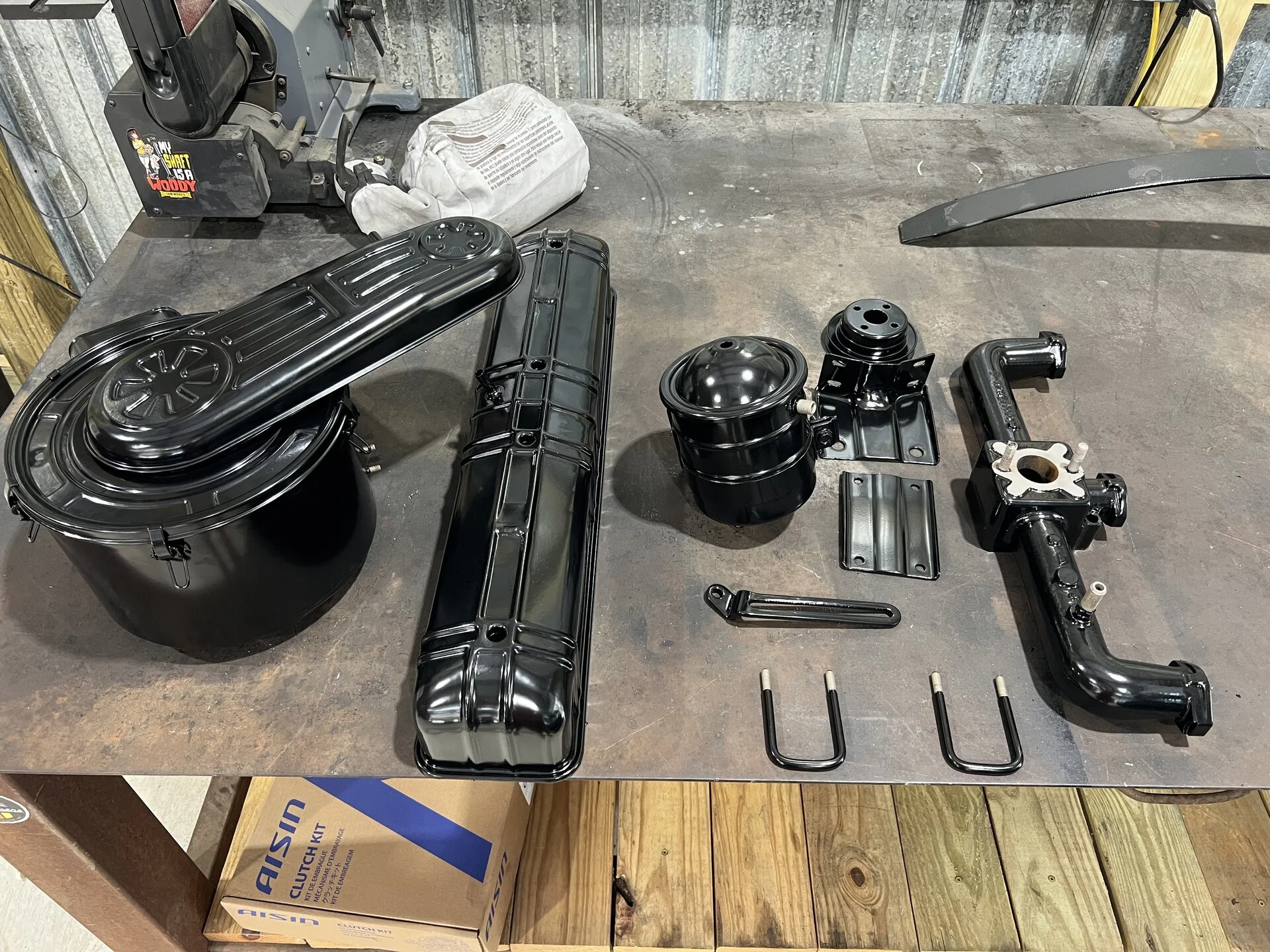

Had to swap pulley cups with the new pump. Super glad I had one.
Also had to swap pulleys on the alternator. Amazingly I had one of those too.

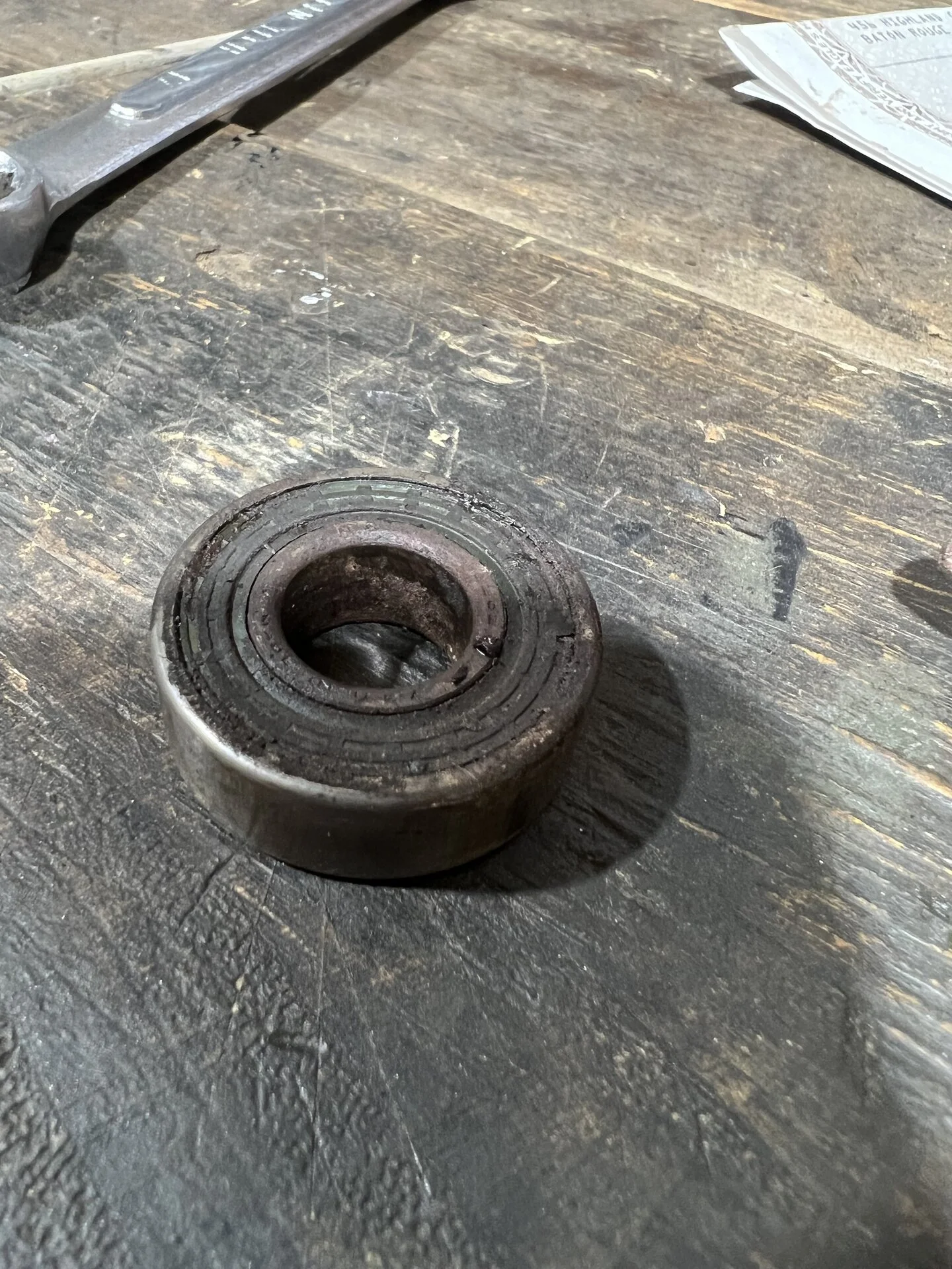

Pilot and throwout were both bad.

Throwout was fused to the bearing carrier

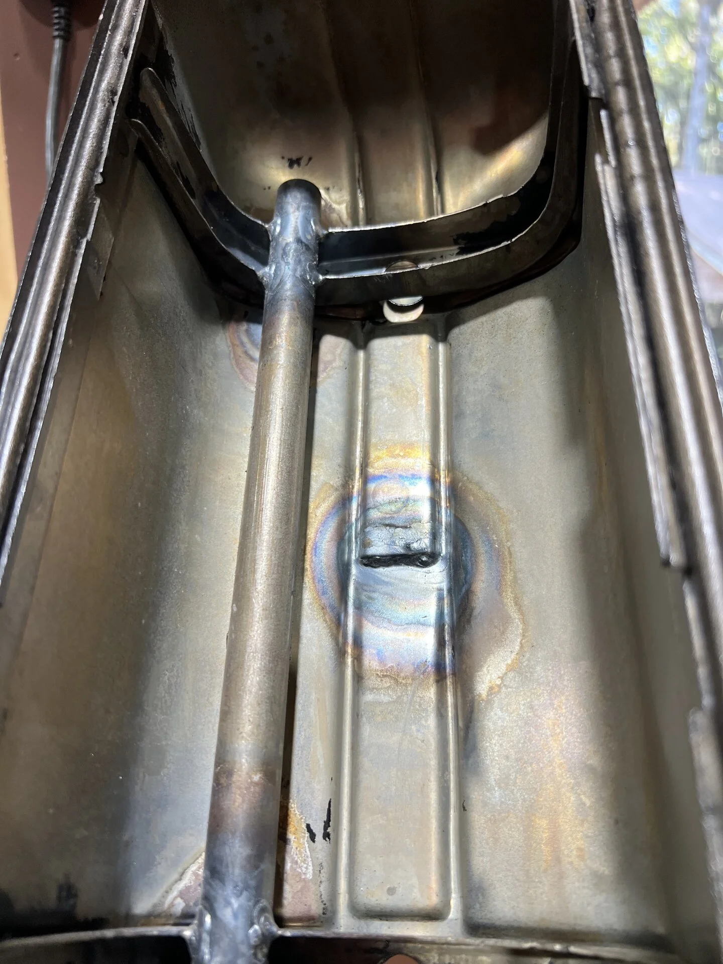

It’s all in. Check out how pretty the metal is on the inside of the valve cover
