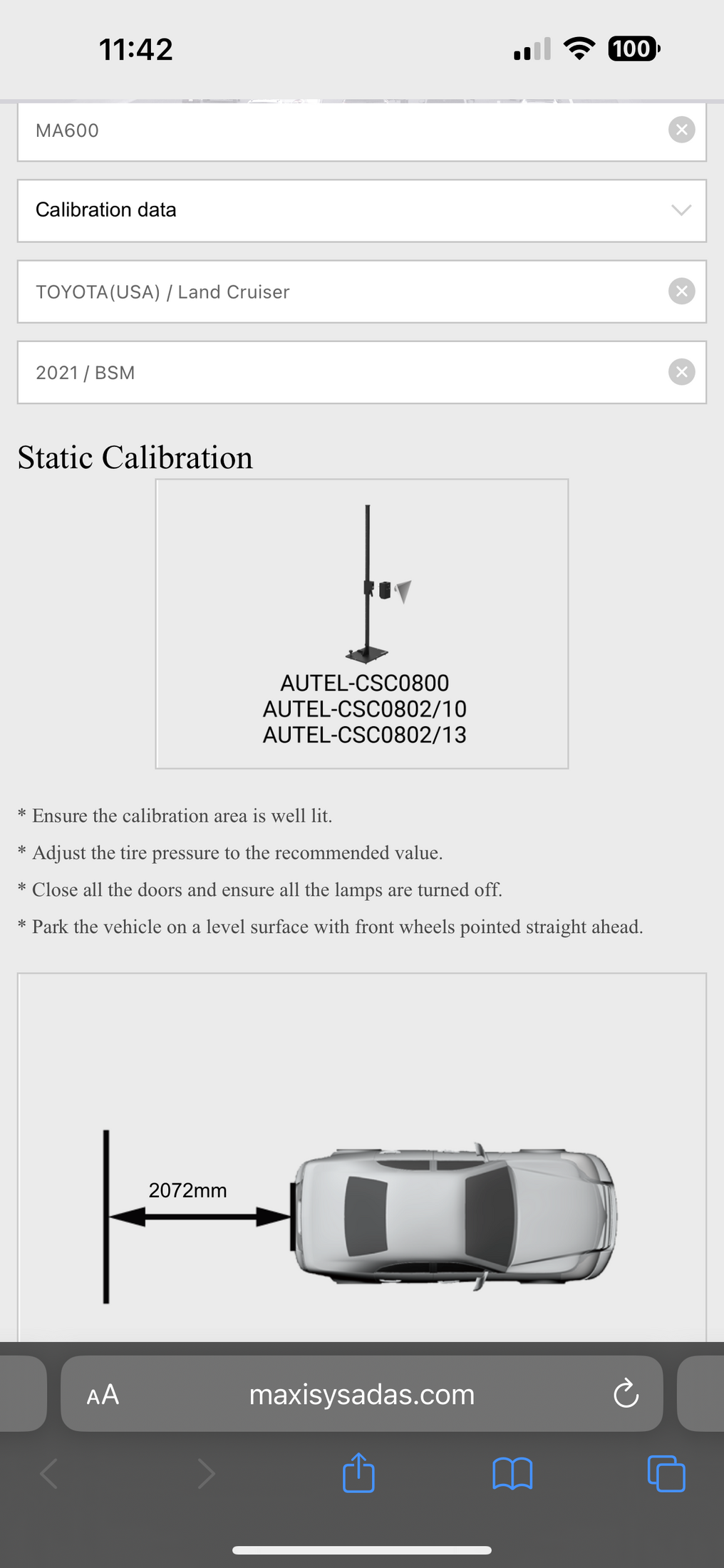

You do not need to remove the bumper to calibrate. I’ve done this many times with great success, UNLESS there is damage and the blind spot module angles are wrong.
I’m not saying this is a bad truck, but I am saying you may want to prepare yourself for hidden damage.
I’m wondering how much (or little) of a an impact it would take to knock one of them out of alignment?

I believe the variance with Toyota BSM is around 4 degrees from spec. Some models are 3 and some are almost 5. This variance is a +\- affair. Also the bracket on most Toyotas is only replaceable if you weld in an entirely new 1/4 panel and does not come with the Blind Spot Radar module. This is due to the bracket being welded on.
I have adjusted and calibrated BSM’s on Toyotas only for the body tech to install the bumper and knock it our of spec again and cause issues.
You can’t just clear these codes either. Once a “calibration DTC” is set you must fix the issue and recalibrate said module. This goes for the front radar/windshield camera and BSM’s. Parking sensors usually only require intervention when one is replaced.
