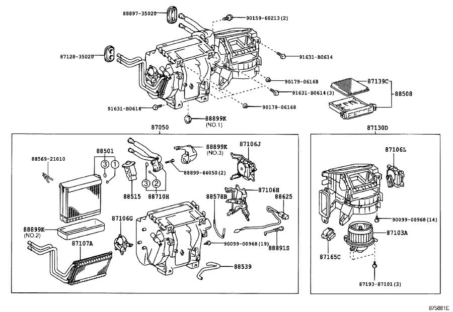

My daughter has taken over my gx and she has been telling me it makes a noise from front passenger side randomly. I wasn’t able to reproduce it driving, I assumed it was a tire scraping a fender liner or something.
Finally heard the noise yesterday, it sounds to me like behind dash. So I think it’s a blend door actuator after doing some searching. There are a few videos but I’m having trouble figuring out part numbers. On the attached diagram I see 4 actuators, which is the one on passenger side people replace? On diagram they are 87106G, 87106H, 87106J, 87106L. Any guidance?
Here are the four servos I replaced on my 2007 GX last winter. IMO, if one servo is bad, they probably are all getting close. I did all 4 as part of a dash replacement. They are a royal pain - a 90 degree ratcheting Icon screwdriver set made them possible. I got mine from Partsouq as they were about half the cost of my local dealer.
Toyota8710635170SERVO SUB-ASSY, DAMPER(FOR AIRMIX)197.44$97.44$
Toyota8710635180SERVO SUB-ASSY, DAMPER1108.71$108.71$
Toyota8710635120SERVO SUB-ASSY, DAMPER(FOR MODE)190.20$90.20$
Toyota8710635150SERVO SUB-ASSY, DAMPER197.44$97.44$
Thanks, I can get any of these, I’m asking which is the one near glovebox which can be replaced without removing dash. I’m not removing the dash, I’d rather sell the car or pay dealership. I will buy from rock auto, they have 4 different ones, and while I can usually sort out diagrams this one confuses me. Cheers.
