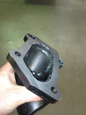

Exhaust flange I made at work from 16mm plate

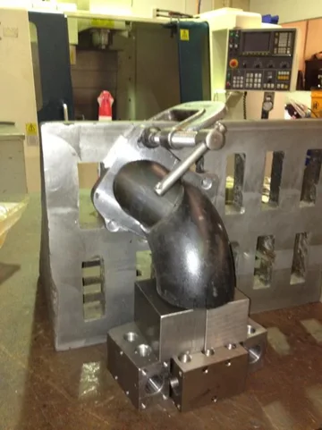

Copied the angle of the bolt pattern of the original dump pipe and welded a 21/2inch nominal bore elbow on, cutting a section out and welding a section in at the side to try an create better exhaust flow. Not sure how much difference it would make?
And then machined the back of it to make sure it was flat after it warped a little when welding.
