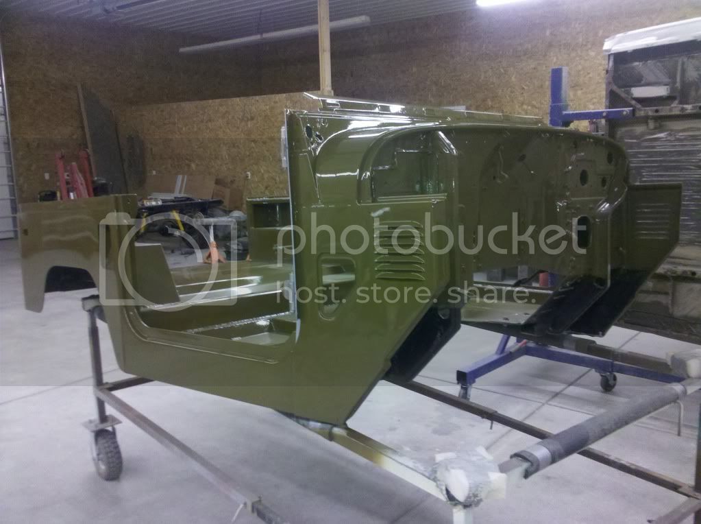

Finally got some pictures of the rest of the FJ in color. It looks really good. There will be some touch ups that need to be done and all the parts need to be wet sanded as well just to get the little blemmishes out. The fenders are really the only thing that I have left that needs color. Other then that she is ready to go back together.
Out side of the doors.
Back of tub.
Rear corner
Front
