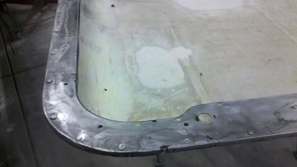

So this weekend I went out and checked on the progress of the roof and Clarence had to remove the mounting lip of the roof to not only replace some of the rivits holding it on but to also remove alot of rust that woas forming on the lip as well. So just a quick update of where we stand.

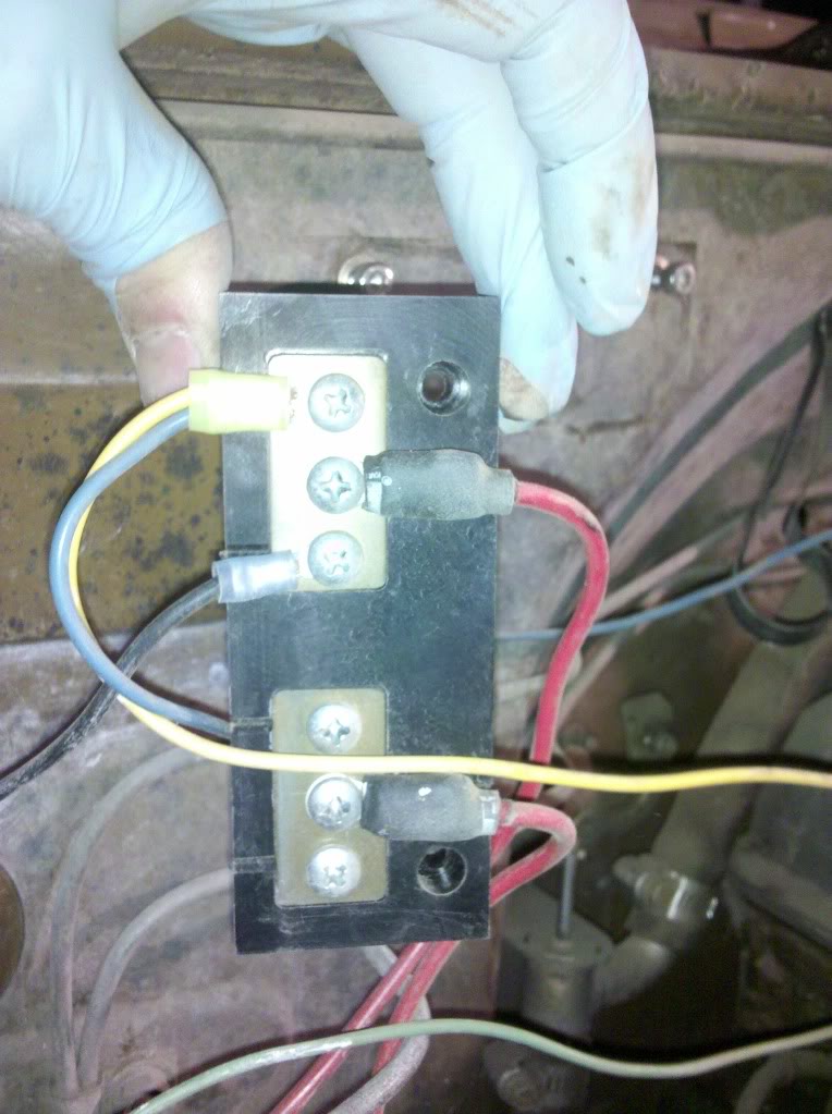

Ok guys getting into this electrical nightmare here and already have some questions. This was mounted onto the fire wall and im not sure if it is factory or not.....the way it is mounted looks factory how ever the part itself does not.....im guessing that it is also a regulater of some sort to????? Again thanks as always for the help.
Hi Big T,
Those wires...... where do they come from or go to?
How does the back looks?
Rudi
Looks like a +power connection block for 2 fuse circuits.
Hi Big T,
Rudi
Hey Rudi,
When I get home tonight I will shoot a picture of the back of it for you.....its just smooth.....I will have to look at were the wires ran to....im sure you can tell but that was a picture from back when I first started the build. Thanks again and I will get that info ASAP.
So is that a factory two fuse circuit or something the PO added?
Looks like a PO mod. It's just connection points where you can easely get positive electricity to power gadgets. I bet the 2 red wires come from the fuse box. I wouldn't use it under the hood withouth a cover.
Awesome....thanks for the heads up. I will locate were the wires ran to exactlly just to make sure......like I said to Rudi it has been so long since I pulled that off I dont remember were they went.:doh:

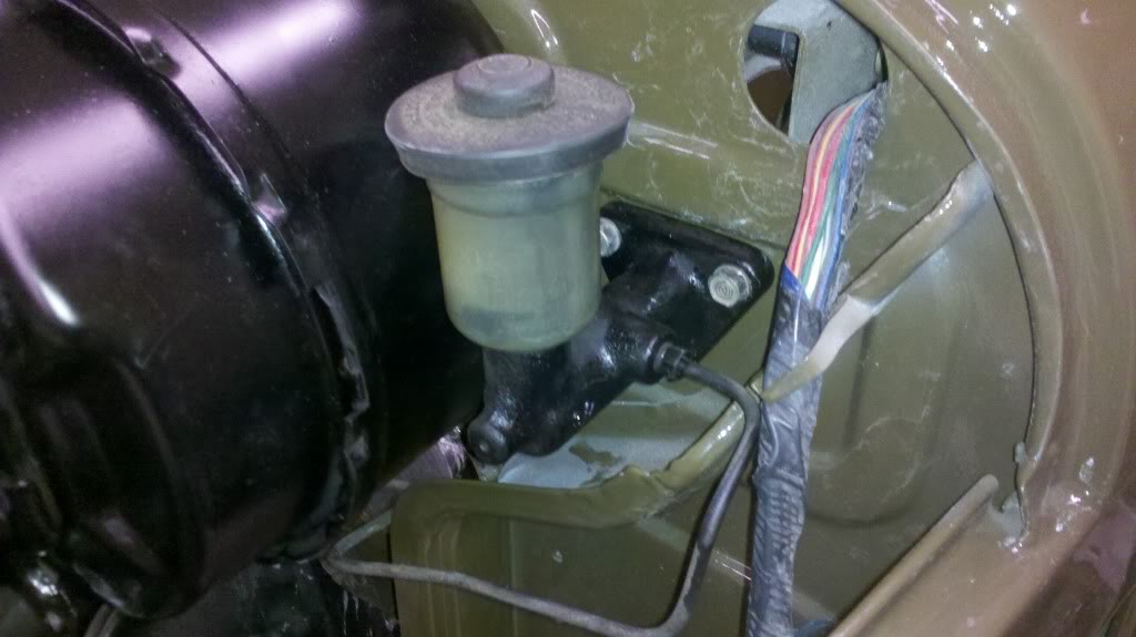

Quick update on what I was able to accomplish yesterday....wich is my day off. When you work in sales you have to work strange schedules. Anyway I was able to accomplish alot.
1. I was able to spray feather fill on the rear doors, hood and roof. (Clarence lets me shoot those because there is no way you can mess up feather fill)
2. Welded the holes and removed the rust on the rear window seals.
3. Finished the rim on the roof and removed the rust off it as well and again feather filled it.
4. I was able to mount and run the master cylinder/booster and brake lines and also the master cylinder and lines for the clutch.
5. I was able to mount doors on and get them adjusted so that I can mount the hardware and latches. I also can now seam seal the jams and also paint and clear those.
