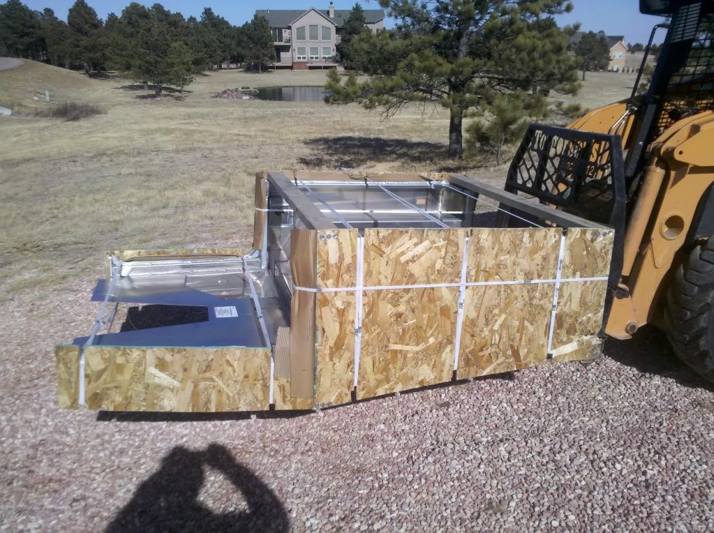

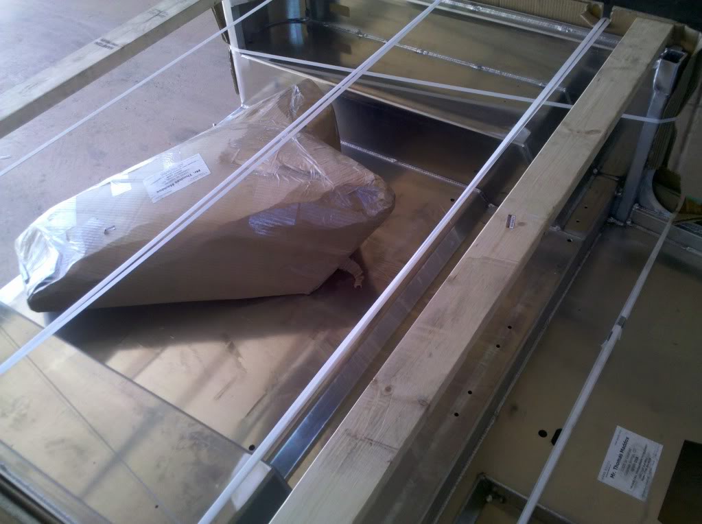

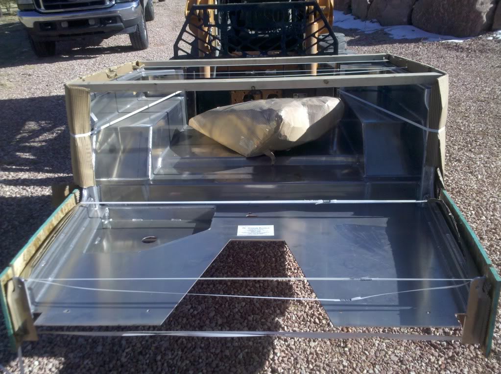

Well finally after many days of researching and asking many people (mainly bugging the heck out of my brother) on wich tub to go with I finally decided to go with the Aqualu tub. It is pretty sweet and they were awsome to deal with. So after a week and a half of waiting look what showed up!!!:)
So with a little help from dad's fork lift I was able to get it up into my garage. Now I just have to sand blast the frame and move on to getting the tub ready for paint. One step closer.

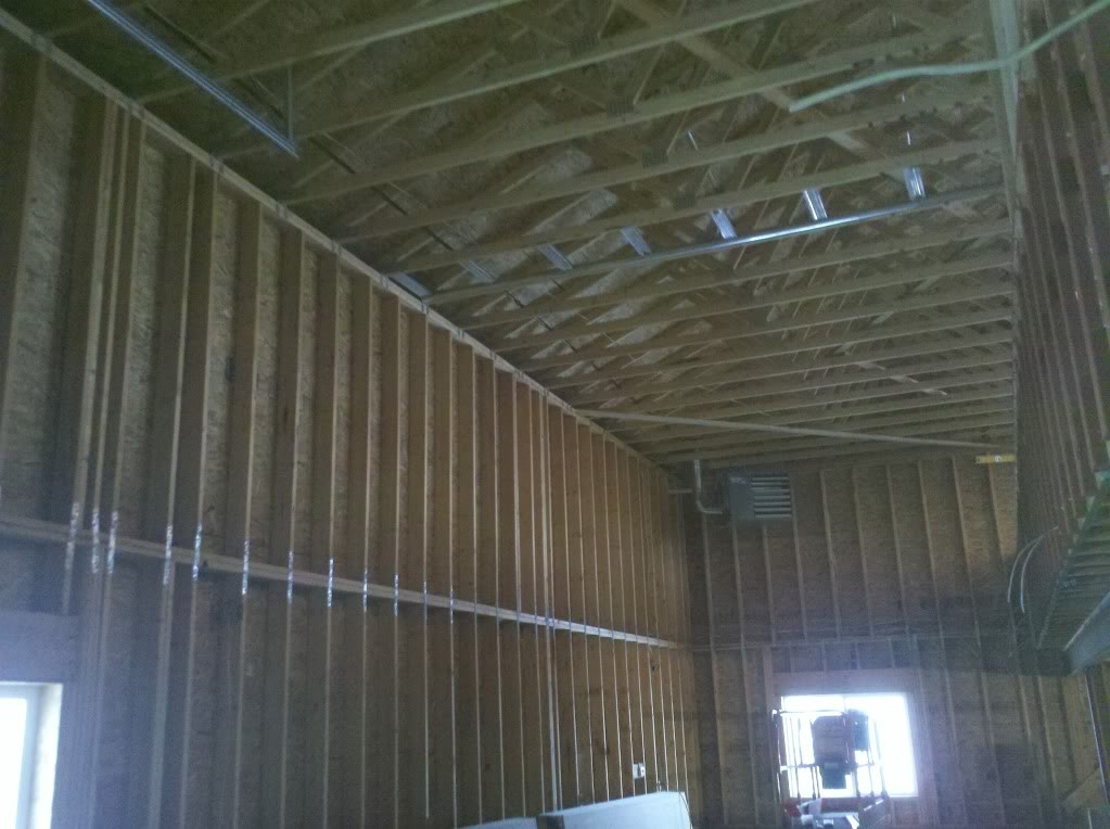

Well I was FINALLY able to finish the insulation and dry wall in the garage so back to work on the FJ. Some before and after pictures though.
Before
After

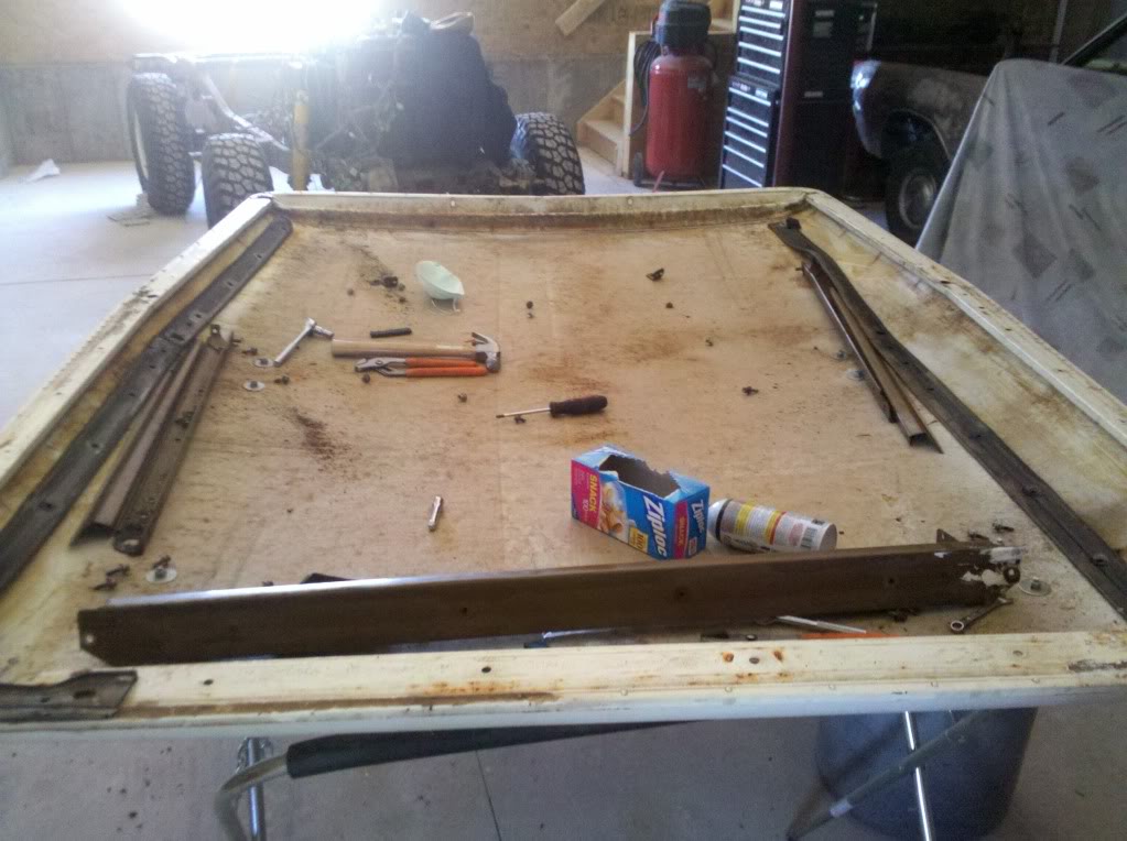

I started pulling a part the top of the crusier.....what is the best way to pull out the striped out rusted screws that holed the rails in?....I just dont want to have to go back and drill them out and then tap and dye the new ones in. Thanks for the help.
I was able to get the top side panels off with a LOT of help from some PB blaster and a big hammer.
That was a much bigger pain then what I thought.

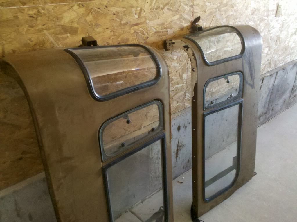

Looks like I need to do some bending and remove some rust form the rain gutter on the top and some on the sides.....I need some help on removing the side and corner windows? Any tips or techniques are welcome.
Thanks again for the help and being patient with the build.
I used soapy water and bike tire levers (plastic, set of 3, sold at any bike shop for $6). The tire levers are indispensable for removing fixed 'cruiser windows. Always be careful not to scarf up the rubber and use plenty of soapy water. Once you get one window out (start with the larger side glass), it'll seem like a snap.

Hello everybody....Again time has gotten from me. I have been
super busy at work and also trying to finish diffrent things on the
crusier. Anyway just for a quick update, also pictures will soon
follow, I was able to get my windows out thanks to your help
along with a few phone calls to my brother in SLC. No damage
was done. Did discover some new rust under the window seals
but nothin that cant be fixed. I also was able to get the engine,

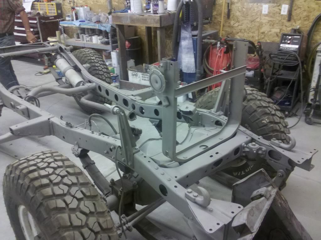

Hey guys,

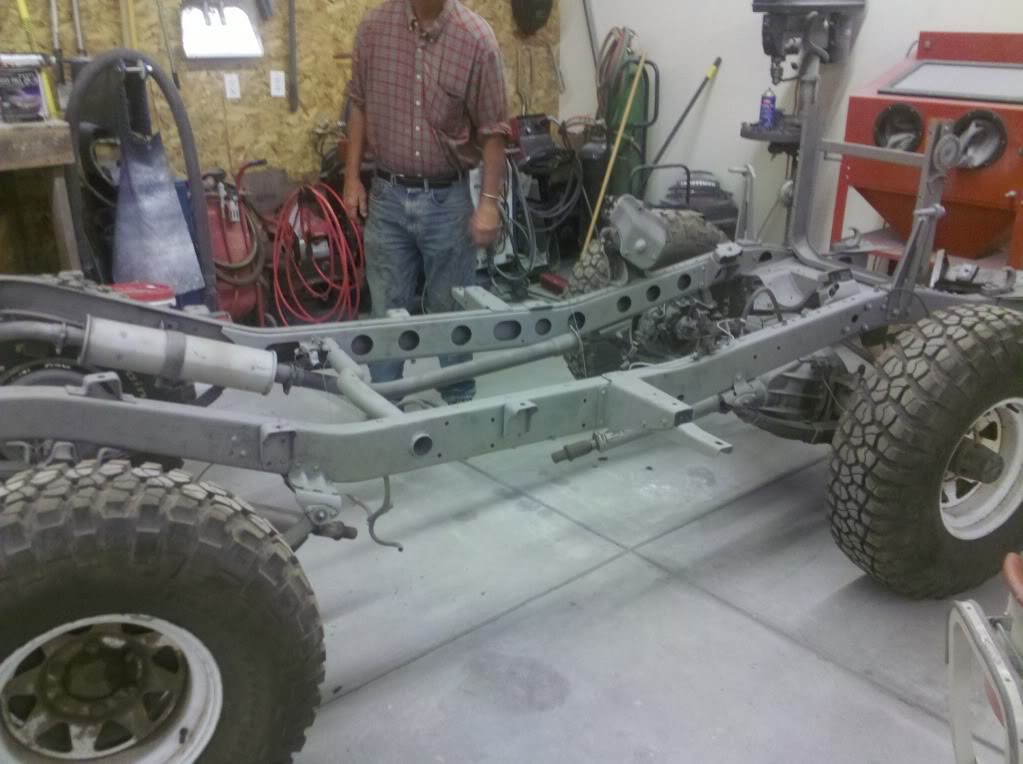

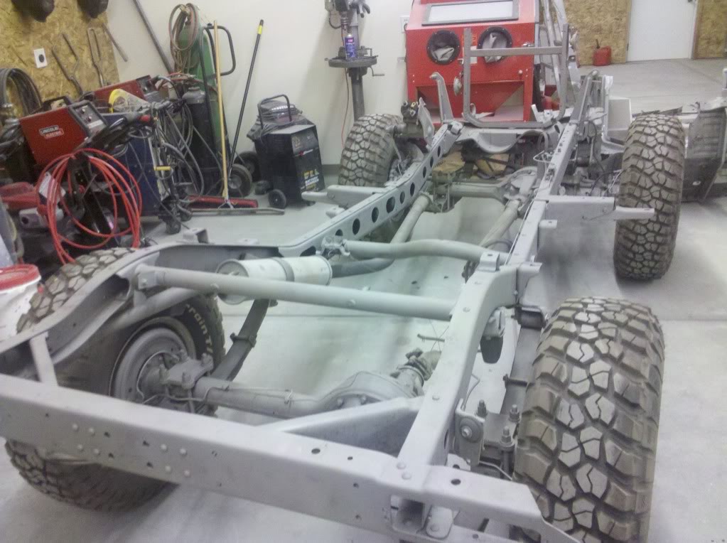

some quick pics of the sandblast job. It looks great and paint will
start at the end of this week with on the frame. I will send pics
when I get them as well.

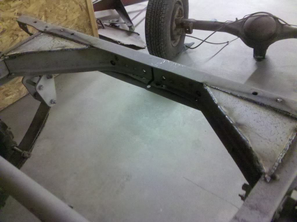

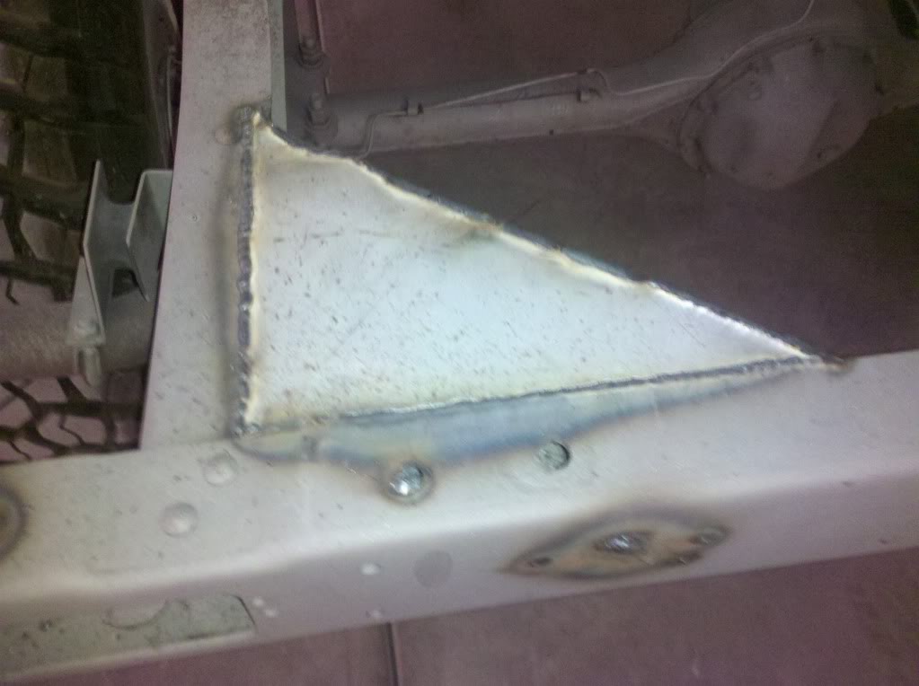

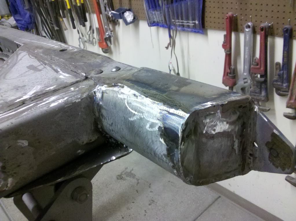

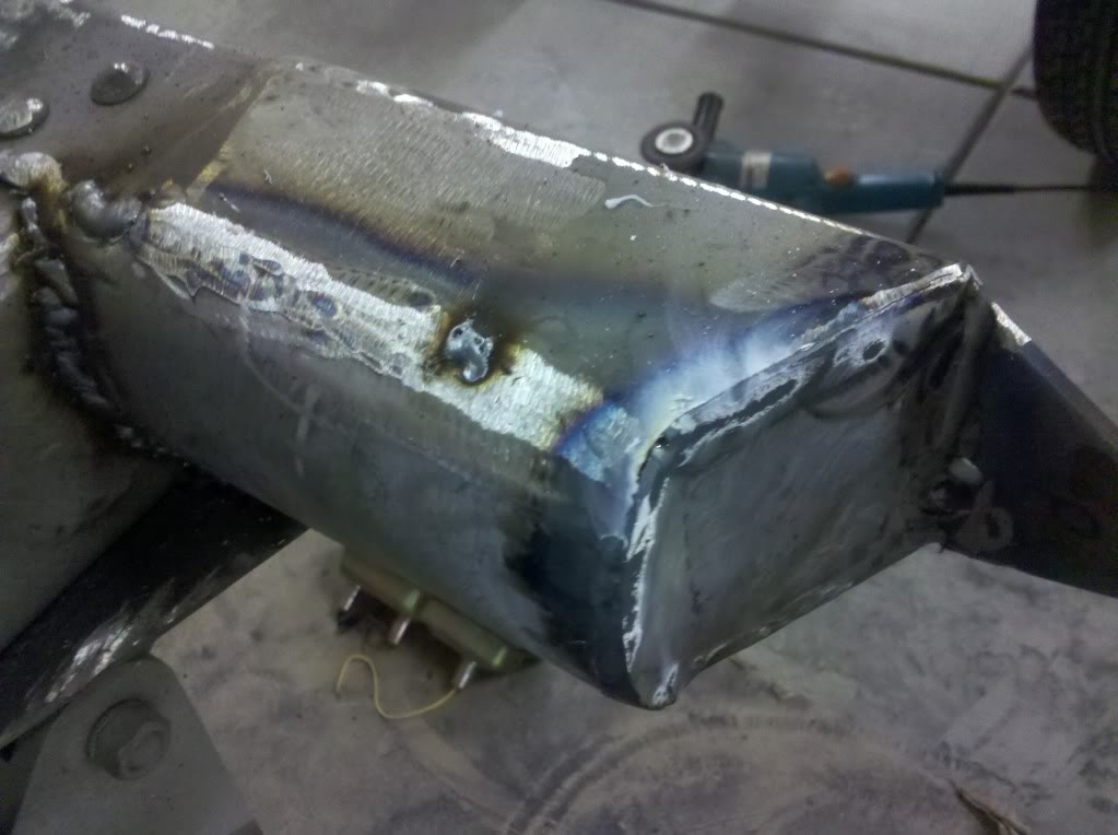

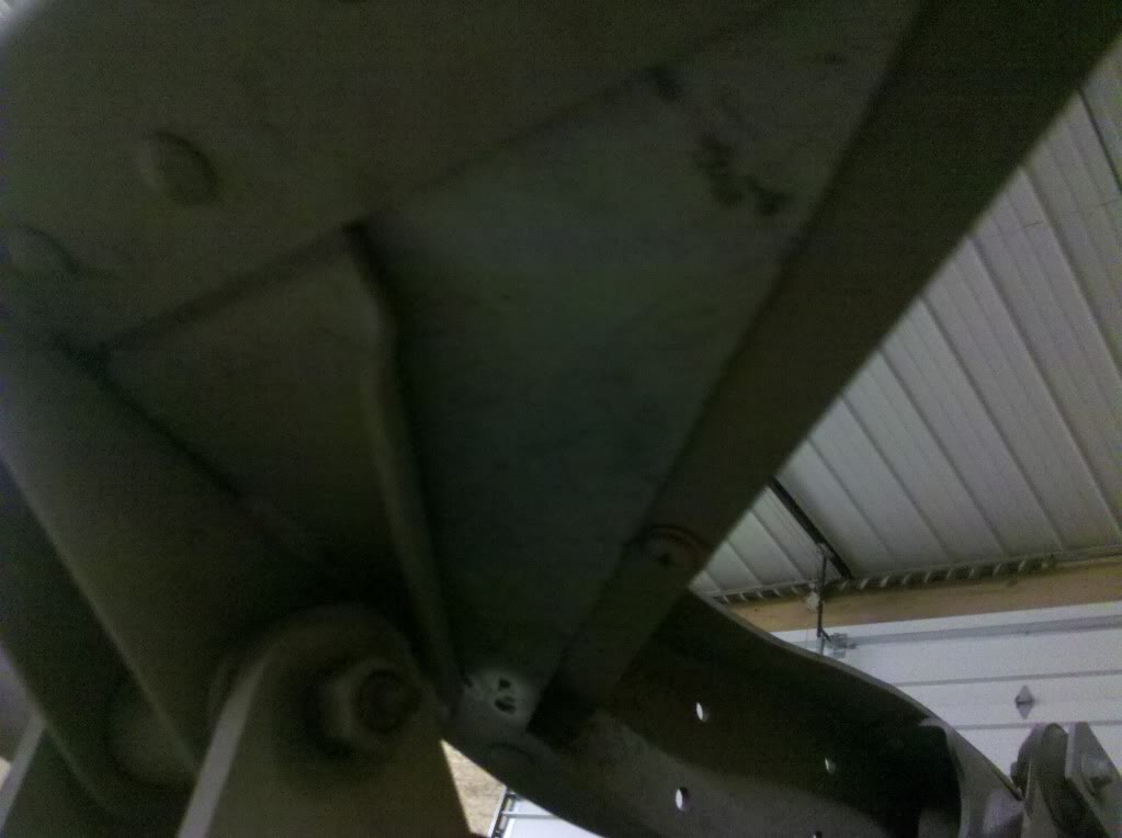

Just finished welding in covers over the taillights so that no dirt or water can get in and rust them out any more. I will also wire in pigtails for the connections so that they are easy to remove and replace.
A shot form underneath.
A couple more pictures of the home made tail light covers. :hhmm:

I would make sure you have some drain holes in those light things or they will rust out. why didnt you just put the original covers over them?
I would spray some lithium aerosol grease into those cavities, after painting the exterior. There is no such thing as a 'sealed cavity' on a Land Cruiser - and when water gets in there, evil things will happen.
After finishing all the welds and grinding them smooth I went back over the seems/welds with a two part seem sealer made by 3M. My dads body guy Clarence swears by the stuff and says that it is impenetrable once it drys wich takes about 10 minutes. I didnt use the factory covers for exactly that reason.....the rust does far to much damage not only to the cover but to the taillight and the bumper itself. My welds will out last and out seal those cheap covers all day long. Now that I have it seald both with the weld and the seem sealer there is NO way water or dirt will get in. I will post a picture of it with the sealent on there as well just so you guys can see what it looks like and how tight it actually is. Thanks for watching the build guys!!! :cheers:
