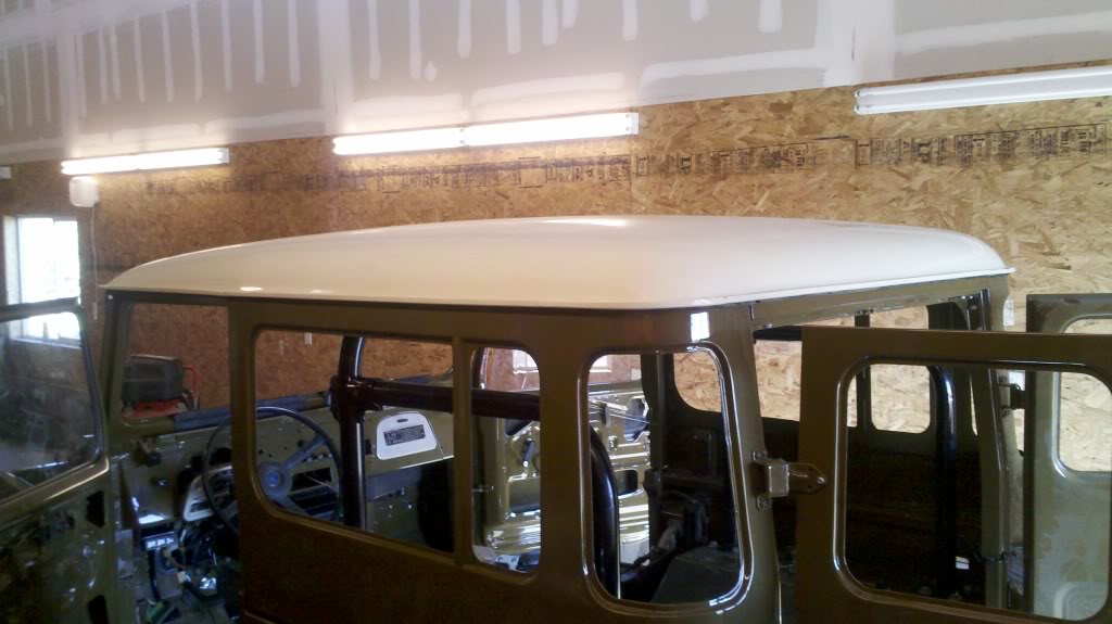

Well just to give everbody an update on what I have been able to get done on the cruiser.
I was able to get the top put on after a LOT of tweaking to get all the holes to line up. But after a clever ratchiting mechanism with a tow strap I got it all together.
I was also able to get the ambulance doors on. They need some adjustment yet but they are hanging there and are ready to get bolted down.
The hardest part was getting the top on to the side rails and lined up with the windshield. I recomend to anybody doing a full top resto as well to get a buddy or somebody to help not only to lift it off but to put it back on and line up the holes to. It will save you a big headache and also a lot of time.
