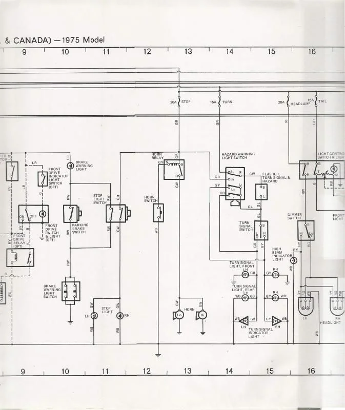

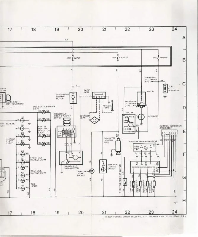

Check out SOR Thomas, they have diagrams
Hi Big T,
These are pics for the '75 and later for USA and Canada.
Hope these help.
I have also a pdf file if you want. Let me know
Rudi
Nice Rudi to the rescue again.......that should work perfect I will let you know if I need the PDF.

Thomas, Rudi's diagram is close, but not 100% accurate for '77. Emissions and turn signal/hazard circuit being a couple areas of difference that are easy to point out. The Haynes manual is the best resource for the wiring diagram, you have one right?

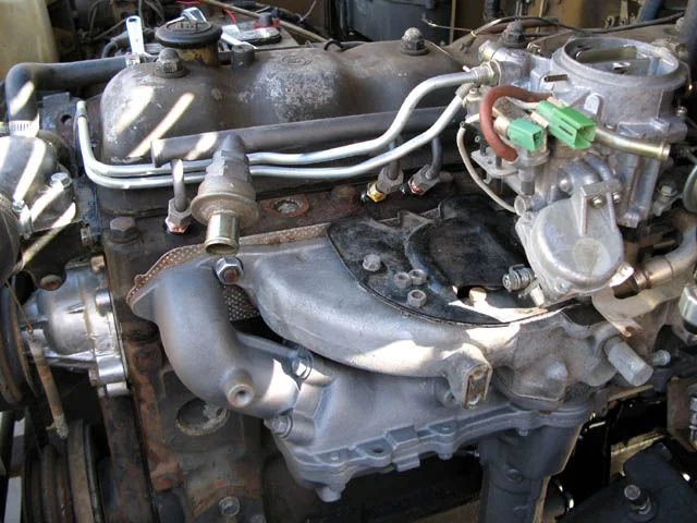

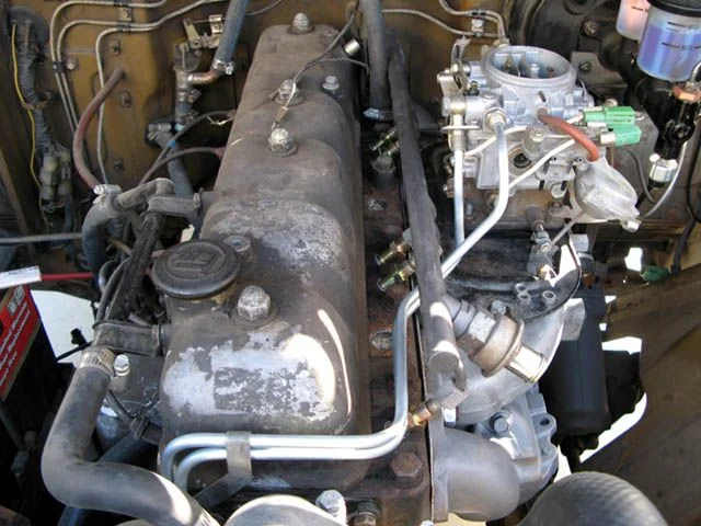

Fuel lines are hardlines from the fuel pump to the carb in a stock setup, pretty self-explanatory once you get your hands on them. Picture from SOR, I don't know why they threw in the vacuum line for added confusion :rolleyes:
And this is an F155, but the line routing is basically the same on a 2F:
Here's a 2F from the front, the lines enter the carb slightly different:

Matt thanks for the heads up on the diagram from Rudi. I do have a hanes manual so I will compare those setups.....also thanks for those pics of the fuel lines those are a huge help. I'm going to try and bend my own lines so I just needed to see how the went around the motor.

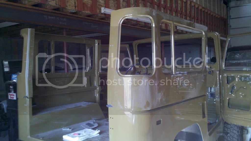

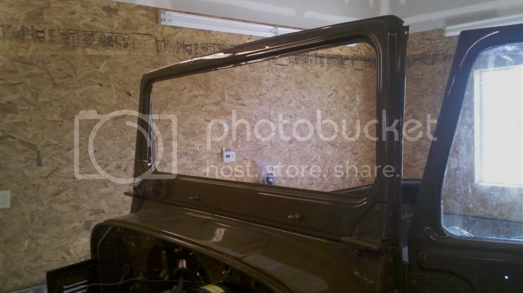

Well I was able to accomplish quite a bit on the cruiser today.....It always helps to have a good solid day off to do things. First off obviously I was able to fix the transfer case. That was the biggest challenge of the day. I was also able to mount the windshild frame and finish the wiring for the wiper motor.
Along with mounting the front grill and also mounting the winch plate and bumper with some help from the best little helper ever!!!!
I currently have the roof over at an apolsters shop having the head liner installed wich he said would be finished tomorrow. I will have pictures of that if I have time to run over and pick it up before I head into work. All in all a good day.
So I got the roof from the apolsters and it looks awesome I forgot to take pictures of it but I will and post them later. Over the last couple of days I was able to do a few things like put the stearing wheel in and also put the two rear side rails on. I did run into a few problems doing that as well becuase it seems that the new tub is a little thiner then the original one so I had to do some modifications to get them in. Looks good though.
