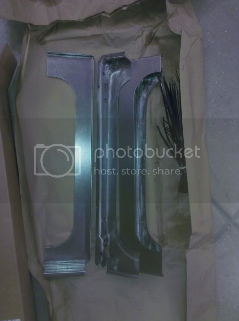

Is the middle picture rockers?
I thought I remember you buying rockers for this!
What did you end up doing with these?
Those are the bottom of the driver passenger doors.....mine were all rusted out. So I had Clarence go through and cut those off and weld the new skins in. Came out realy well. That and the new skins the channels will let water out the bottom if it ever gets in.

What are these pieces?
They look like they could be rockers, or amby door bottoms...
Thanks!
Ya sorry those are the rear doors....again they came out great.
