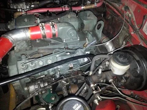

I guess I'm due for an update. Had an expensive week getting Big Red back to functional. I had a buddy redo the oil pan gasket, build me a bracket for the remote oil filter, install the governor springs with a new fuel line and while he was at it, he changed out both clutch cylinders and the oil in my transmission. It started with, "hey can you build me a second battery tray real fast" and it snow balled into all the other things. Didn't get the second battery tray done though, that will be a project for later I guess.

I guess when you complain things finally start working. Here's a picture with the broken fuel line removed.

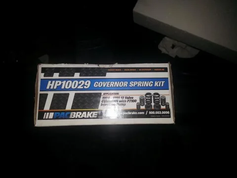

This is the kit that the new springs came in
I must add that Big Red is now a real beast. I was impressed with the way he performed before, but the 4000 RPM springs really bring him to life.

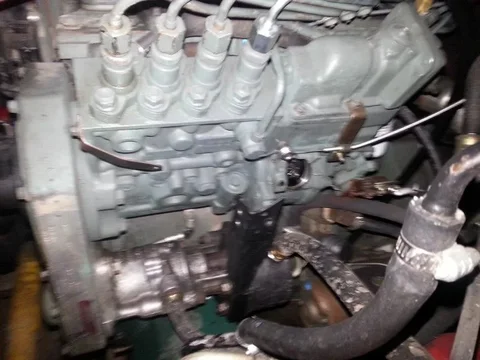

this is where the governor spring goes, I actually thought we'd have to take the fuel pump apart to get to them.
This is a better picture. You need to turn the crank shaft to get it to line up just right so you can pull the old ones out and put the new ones in.

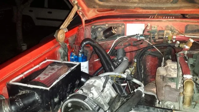

and now for the remote filter.
here is the bracket that Jacob made that was not included in the $200 remote kit.
here it is with the filter mounted
almost done
Done

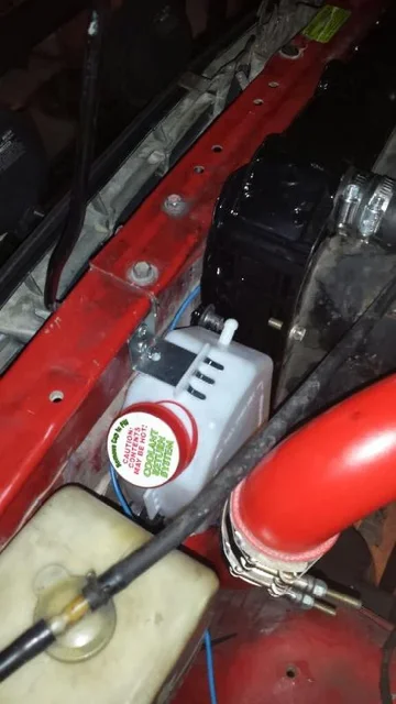

and the new washer fluid bottle

Might want to get some 90 degrees fittings for the oil filter head. The hoses look like they are just barely long enough.
Sent from my SPH-L720
Yea I was thinking about that yesterday. I'm just tired of spending money right now. I also have to zip tie the hoses to prevent them from touching the turbo or exhaust
