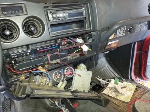

So I had to take fix the cigarette lighter which had a loose wire in order to charge my phone and to use the GPS. Took the dash apart with the help of a friend and reconnected it. I also pressure tested the cooling system and there seems to be a small leak somewhere, but I didn't have time to address it.

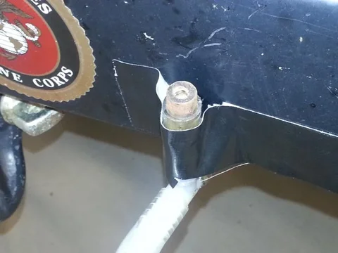

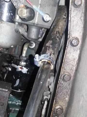

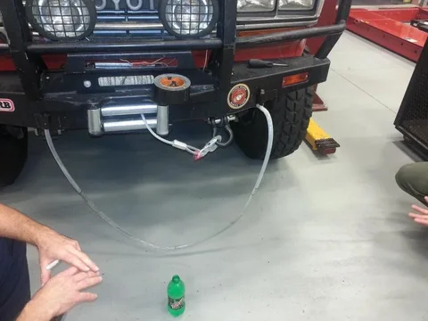

this post is more for the 4bt crowd, it shows how to gauge the health of the engine by measuring the blow by it produces. It's easy to do and gives peace of mind. first you need a 6 ft. clear tube that's 3/8 in. wide on the inner diameter. Hook up a T valve with a cork in it and bore that cork to 15/64 in. Next fill it with water and hang it on your bumper in an even U shape. The take another tube and hook it up to your blow by tube and to the T valve. Make sure to mark the water point before turning it on

The mark the tube at idle, at 2200, 2500 and 2800 rpms. My 4bt doesn't go higher than 2600 so that's where I measured it to. Take a tape measure and measure the drop in water then multiply that by 2, that's the total water it moved. write down your results and compare them to a spec sheet.

This shows how much it dropped from when the engine is off to when it's at idle.

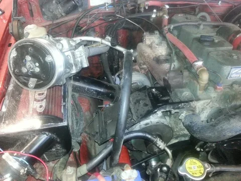

I guess it's time for an update. I've been busy with life and the other car that I've not done much to Big Red lately. There was one issue plaguing me from the beginning that I needed to address but just got around to it this morning. The pulley on the alternator was too small and the belt didn't have enough wrap around it which caused it to slip under load. So when I turned on the AC or any accessory you can see a significant drop in voltage. My alternator is rated at 150 amps, so nothing should be sucking that much juice. Anyway I went down and got a bigger pulley and drove to the local community college to use their tools and expertise.

Took off the entire bracket since the alternator couldn't slip out the back

Here it is reassembled, I know it's hard to tell the difference, but trust me it works great and there's no more voltage drops. The alternator is able to supply the battery and the accessories as needed. My next project is to add another battery in parallel. I don't plan on using a relay solenoid or anything, just hook it up directly to the main battery so that both are used simultaneously. If anyone knows of any drawbacks to the way I'm planning on installing it please let me know. Thanks in advance.
The problem of hooking the battery up in straight parallel is that you can accidentally overcharge a battery and undercharge the other. also, If one battery goes bad, it will draw down the good battery too, best to be able to isolate them. All you really need is a big diode. Boats or RV places will carry the isolator/diode you need.
Thanks SmartyPants. I was thinking of that earlier. What amperage rating do you suggest for the isolator switch?
