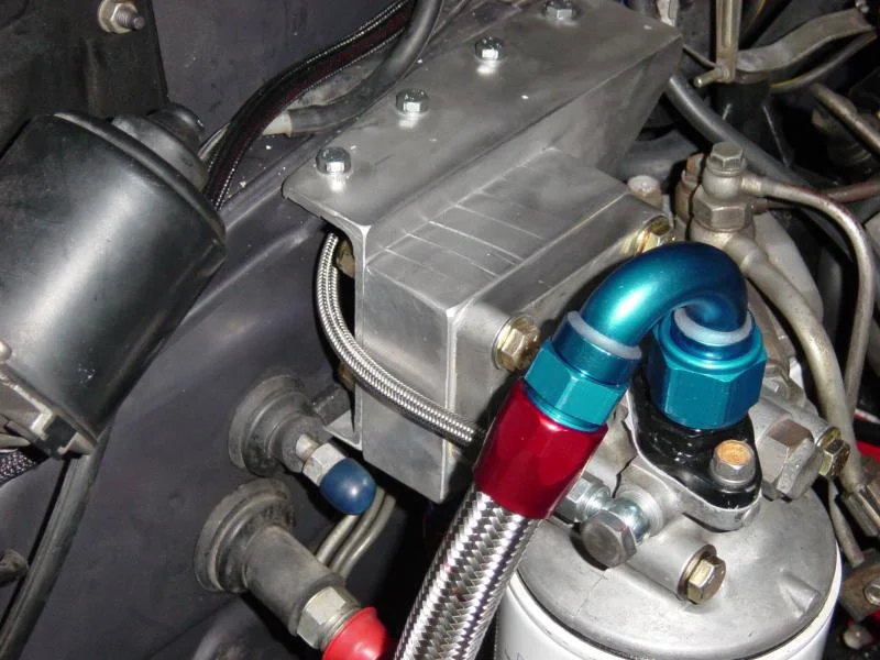

I'll get off it after this, but here is what Doug did with his remote oil filter:
Looks like he had to put some $ up to make it all work too...

That looks really nice. Thanks for the link and the concern.
Out of curiosity, what damage would it do if it stayed the way it is? Does it just drop oil pressure and take a little longer to return to the block or is there something I'm completely missing here?
Dang good looking 60 you have there. How do you like the snorkel that you have on there? Where did you get the sliders? Once again, very nice. Can't wait to get mine all together and running.
There may be still plenty of pressure to get oil up to the top end and through the turbo, but as you start to turn things up on this old mill, I would not want to restrict flow in any way. Bearings do love oil!
Adding fittings to your filter housing may not change a thing on the gauge either, the restriction may be in the remote filter assembly it self.
But it would relieve the stress on the lines and prevent a kink in the line later on.
YMMV
YMMV
The truck you have built looks awesome! Just go easy till your sure :steer:
Pacer,
Thanks for your input, info like this is how I learn and is always welcomed. The oil pumps into the filter right away, you can feel it in the lines, it just takes a second for the gauge to register. I'm wondering if I need to add a bit more oil for there to be no lag. I went to look for fittings today and didn't find any at the local auto store. I swung by tractor supply and the ones I need ( two male ends with a 90* angle ) were out of stock. I'll try to swing by that store Davegonz linked me to sometime next week.

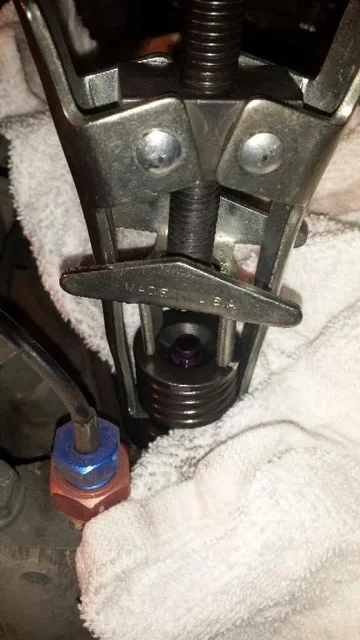

Here they are, I tried compressing them with my hands, apparently 60# is too strong for my weak arms.

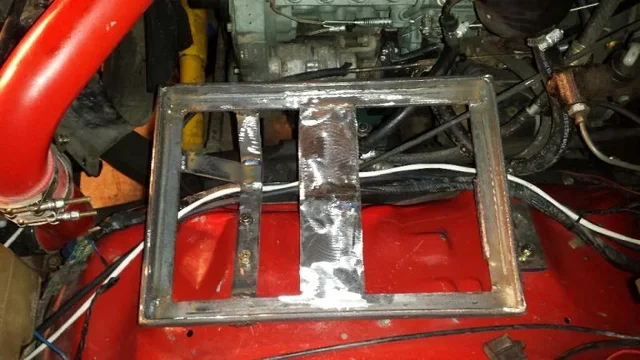

it's too cold to type so here are some pics.
a buddy's good at fabing anything so this was easy for him.
We were worried that the batteries won't fit, but it looks like it's gonna be just perfect. It's not done yet so there's room for some obstacle to pop up.
Damn fine battery placement! Can you not send one of the yellow tops back and get a red one? (i saw that was your ideal bat setup)
**** fine battery placement! Can you not send one of the yellow tops back and get a red one? (i saw that was your ideal bat setup)
Thanks, I was gonna do that, but upon further research I decided to keep them the same.Two Yellows will have more than enough amps to crank Big Red to life and can handle several complete drain and recharge cycles better than the red tops. I don't intend to have a separator between them and since they would have unequal cranking power, one battery would be drawing from the other.
This keeps it simple and even.
yeah that makes sense. although i am still a dual battery dumbass hahaha.
Don't worry man, I spent weeks researching it and I still feel like i'm a dumbass. I'm sure if you ask 4 other dudes you'll get 5 different opinions. For my applications this should work fine, at least in theory. Time will tell.
yep, thats usually how it goes for me :lol:
As long as you can start the engine off the main battery, even with the lower CCA, seems all should be well.
:cheers:
:cheers:
with this setup, they are both the main battery and the auxiliary battery. I just have to remember not to run them for too long without turning the rig back on.

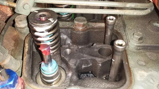

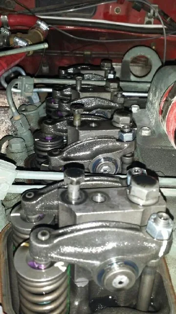

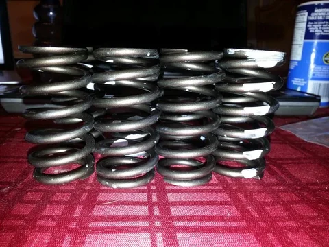

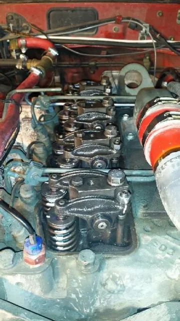

Here's what a friend has done today, despite the freezing weather. I'm having him replace the old valve springs with heavier duty ones. I was thinking of doing it myself, but that would mean waiting till the middle of next week before I can get to it. Here's the quick and dirty, sorry too tired to type in detail
Take off covers
compress the spring to take out
compare old springs to new heavy duty ones.. feel better about this decision
Replace valve seals while in there
Done
One less thing to obsess about.
How did he keep the valves from falling down into the cylinders?
Some people get pen magnets and clip the pen to the side of the head to hold the valve up.
You can also take spark plugs out and either put a large wooden dowel rod inside so the valve rests on the rod, or you can buy an adapter for an air compressor to screw into the spark plug hole and hold pressure in the cylinder to keep the valve up.
I've also heard of people putting rope down in the combustion chamber. However, this is a Cummins, so no spark plug holes, only injector holes, and I can see in his pics that the injectors were not removed, hence my question :D
