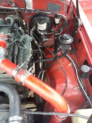

Since I have your attention, I need your input. I've been debating on whether or not to relocate the power steering reservoir and moving the primary battery and co-locating it with the secondary one that I'm planning to install.

This would allow more space for a larger deeper and slightly wider air box.

The main reason I want a larger box is to protect the filter from the rain. As it is now under heavy rain some water gets in from the snorkel and pools up under the filter which sucks up some of it.I've mitigated that issue by turning the snorkel head around, but I don't like having to do that just because it's gonna rain. My plan is to have a deep enough box where the filter is higher and won't be affected as easily. I'll of course have to dry out the box once in a while or more regularly.
Is my thinking flawed? let me know what I'm missing.
I'd move it. It's just taking up a ton of space there. Maybe Jacob can make you a custom two batter tray with a bracket attachment for the reservoir?
that's kinda what we were talking about yesterday. Man being on this forum is so much better than cleaning up the house. If anyone asks I was doing research :grinpimp:
