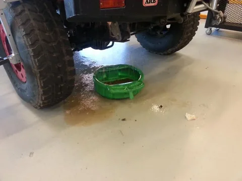

So I tried the old fashioned way of unplugging it from the bottom. It worked well until it started hitting the leaf springs and axle.
The shop foreman was not too happy about the mess, but retired sailors never are. Next we took off the shroud and thought we could unbolt the radiator and pull it out from there.

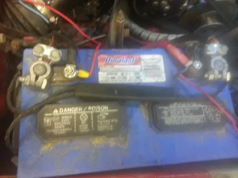

We realized we needed to get to the bottom bolt and the only way to reach it comfortably was to take the battery tray out. So i took a picture of the battery connections to remember what goes where.

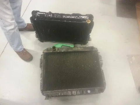

Now we were finally able to get the old radiator pulled out. here's a side by side.
Can you tell which is which?

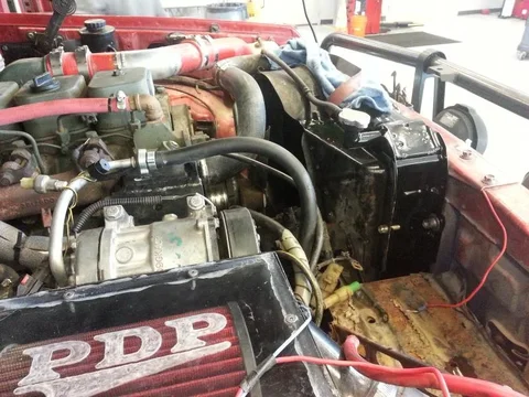

Here's what the engine bay looks like without a radiator in it.
Right around here we only had 20 minutes till closing. So we rushed to put the new one in and button everything back up. I mixed the coolant and began adding it when the campus police asked us to stop. Though I didn't get to finish it, I did learn a lot about what not to do. In 25 years when this needs to be changed again I hope I remember these lessons.

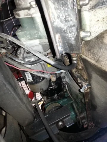

Soo here is where I left off Wednesday night. Had the radiator in, but not the battery or tray.
I have to go back and change out the battery tray, this one is too corroded, as were the wires and fusible links.
