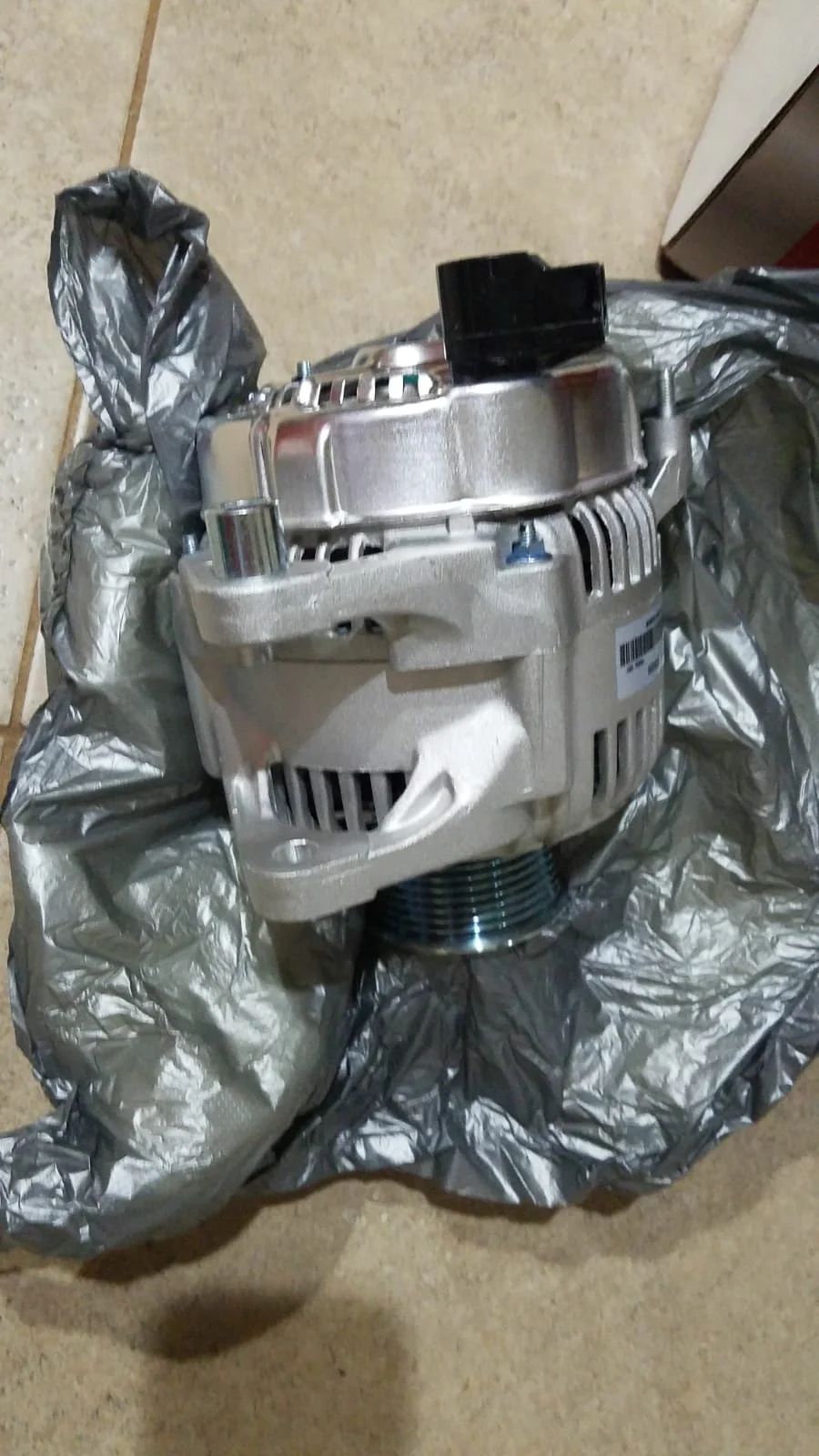

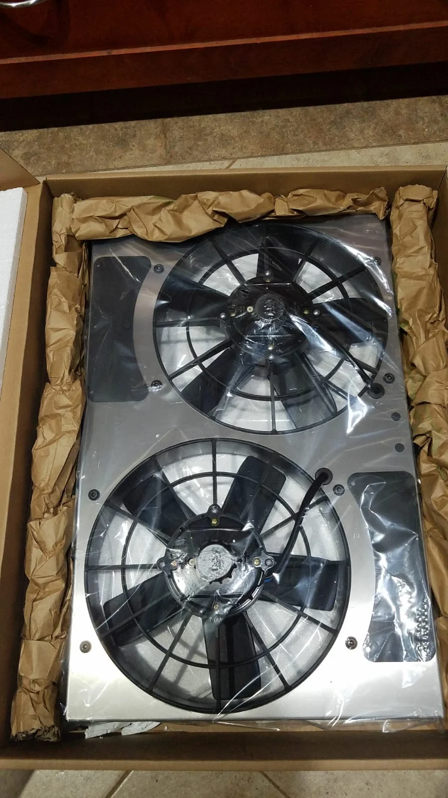

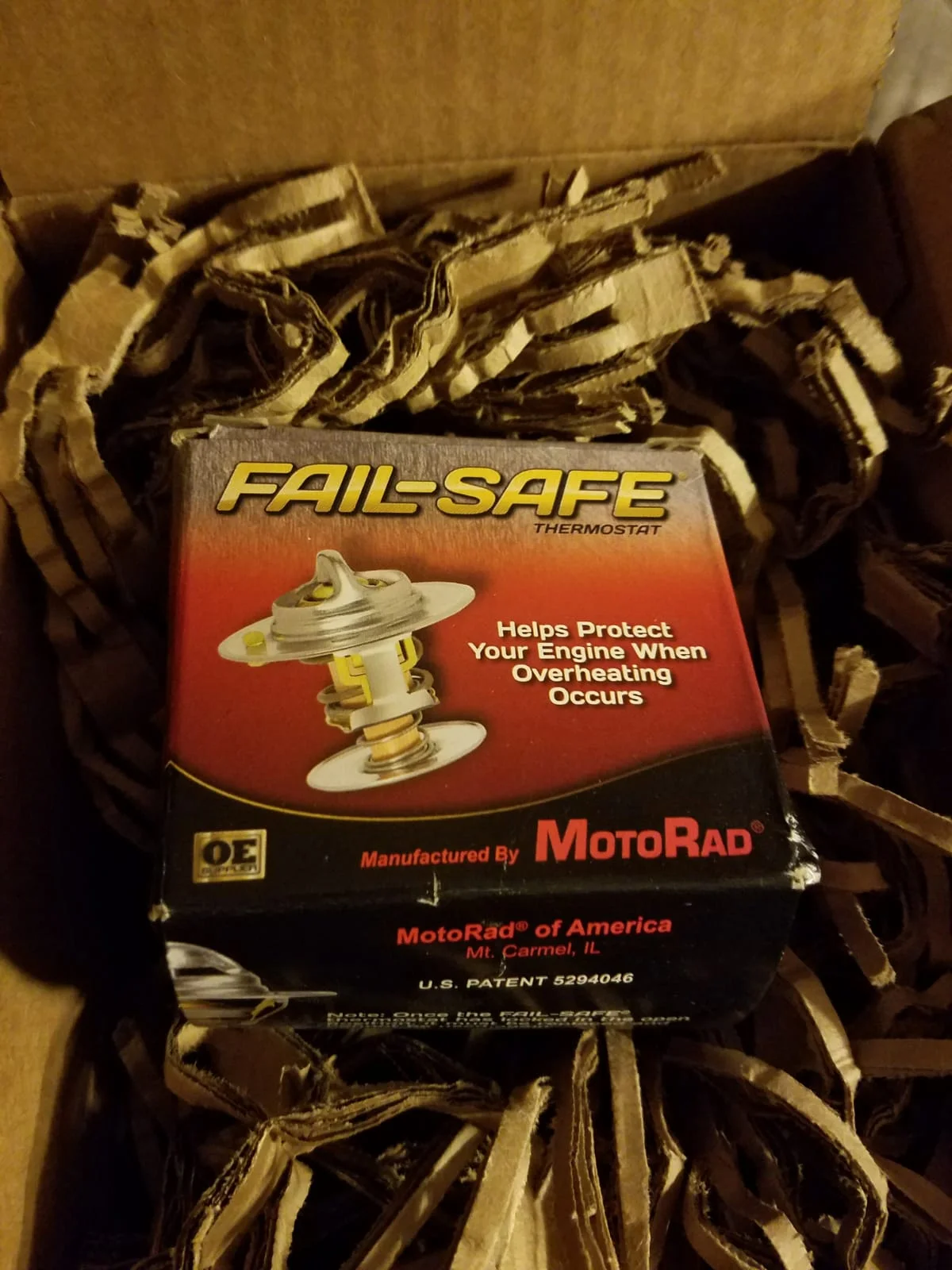

The parts came in, but im still away for another 10 days or so. I really hope this shroud and 180* thermometer fix my heating issues. I plan to relocate the current electric fan from the radiator to the ac condenser once I install the new fans and shroud. I also got a new 120 amp alternator to help run everything. I might have to use the old pulley if the belt doesn't have enough wrap.

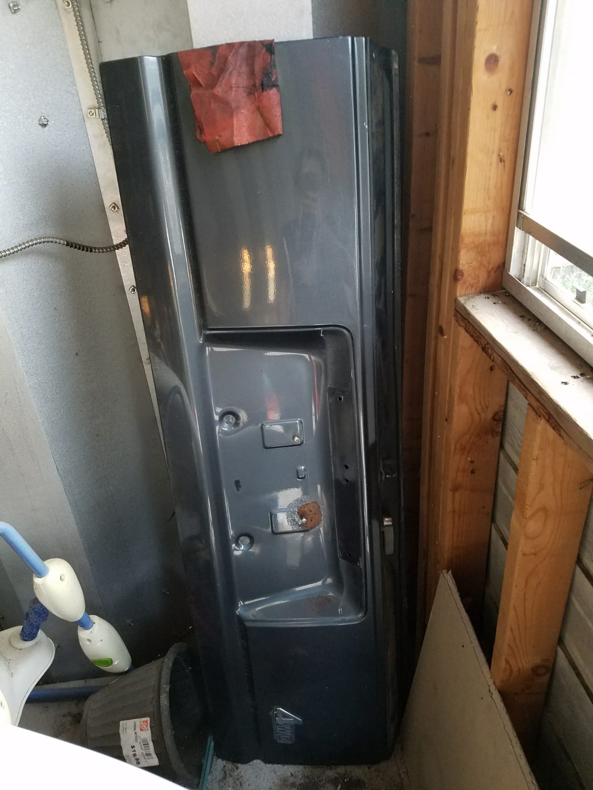

This picture doesn't show it. But I have a large surface rust bubble on the other side of the tail gate . Someone needs to show me how tip get rid of it and we can paying it to match.
Here's the tailgate. Some bubbles, all the rust is on the surface.
Mike, there is usually something on the underside when it’s doing that on the surface. Have you been able to inspect it closely from both sides. If the underside is good and there are no holes etc. then it can be ground down, treated, floated and then painted. Otherwise you’ll want to patch it. Also curious with the color. Was this previously on your truck or is it a new tailgate? Would be glad to help you fix it as well. Thanks. Jim.
Jim,
I got this tailgate from Edwin, it's from a rig (what's left of it) that is behind his shop. We looked at it, it seems to be the only place that has rust. The underside of it looks new, unlike my current tailgate which has a few rust areas that need the rust cut out. I'll be back in town by Monday and will start putting the new parts on, after that I guess it's ready for the cosmetic work. I just to need to know what supplies to get and see who all is interested in learning about painting. Thanks Jim.
