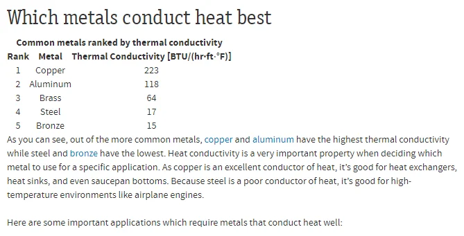

https://www.metalsupermarkets.com/which-metals-conduct-heat-best/
I'd try out one of those aluminum radiators. Cheap enough to try.

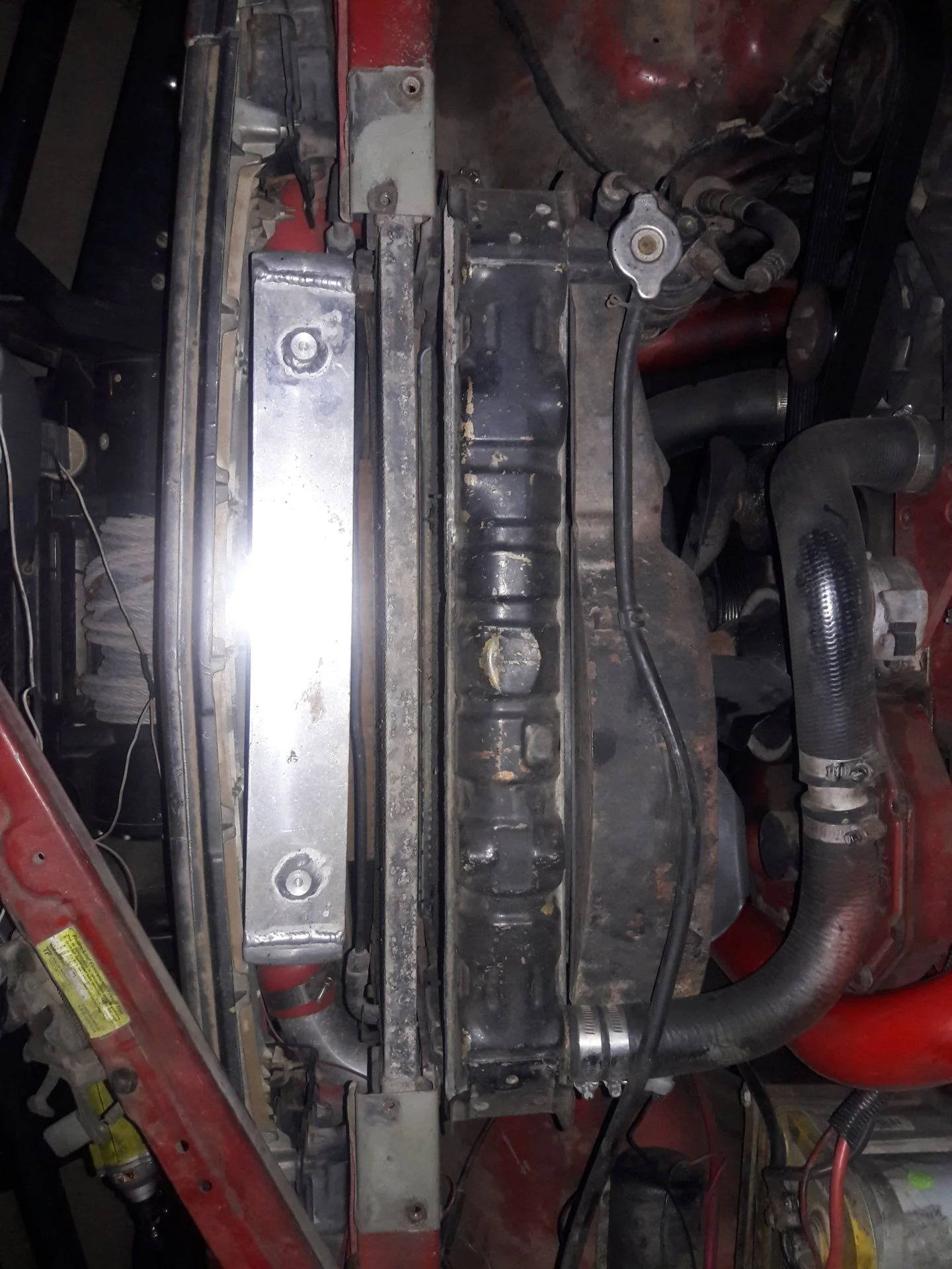

I think I will add two 12 in fans on the other side of the radiator first. If that doesn't fix it then I'll look into a different radiator. Just drove it back from Ft Worth. Looks like 210 is the new norm for now.
Just measured it, maybe two 10 inch fans between the radiator and condenser to push air thru. Figured with the louvers it should help. Definitely won't go above 210.

That's just it, I'm not sure aluminum is an upgrade. The radiator I have is only a few years old. Plus two fans for less than $40 may end up fixing it. If not, then I'll upgrade.
It'll climb if I go above 75mph. I'm not sure if it's bad, I'm just not used to it. I'm not sure what a 4bt's normal temp range is.

Running the 4bt at 210F is a little warm but not in any danger zone. The bummer is that there isn't much heat capacity left for pulling a trailer or charging up hills. If it were a constant 220F then I'd be worried. Along with better electric fans that move more air (can't remember what you are using now) you could do some flaps on the fan shroud to allow highway air to bypass the fans and provide more flow through the cooling row.
I'm going to start a slow process of elimination. I saw some electric fans with shrouds that fit the 62 radiator, but first I'm going to get a thermostat that opens at 180*. This is just to make sure that current one I have isn't partially shut and it's the cheapest route. If that doesn't work I'm adding the fans and then the louvers, just to have that extra heat capacity in case I drive up a mountain with a trailer.
