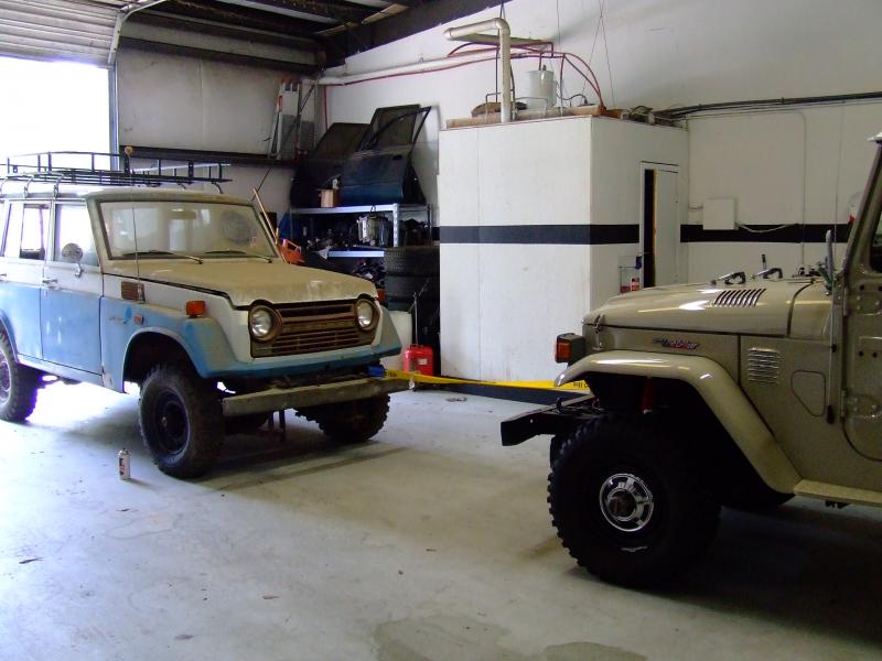

The piggy arrived today, i had to drag it off of the trailer and into the shop with my 40, as the rear wheels were lockd up tight.
I've got the rear wheels turning, removed the plugs and filled cylinders with penetrating oil, cleaned the plugs, turned engine over by hand, then turned engine over with it's own power, Bdenke stopped by and lent a hand, removed points, cleaned and adjusted by sight for now, disconected electric fule pump from tank and pinched off the line, sprayed a little carb clean and she fired right up, engine is quiet and idles perfectly, not bad for sitting 8 plus years.

All I see is surface rust, you guys must see more in person than I a can see in the pics. That pig is sweet and he got a great deal. It is very rare to find a deal like that is not already torn apart and missing parts. He will appreciate it being all together from the start. Ask me how I know.

For a unrestored pig it is in pretty good shape. A steal of a deal. Especially now you have the engine turning.
