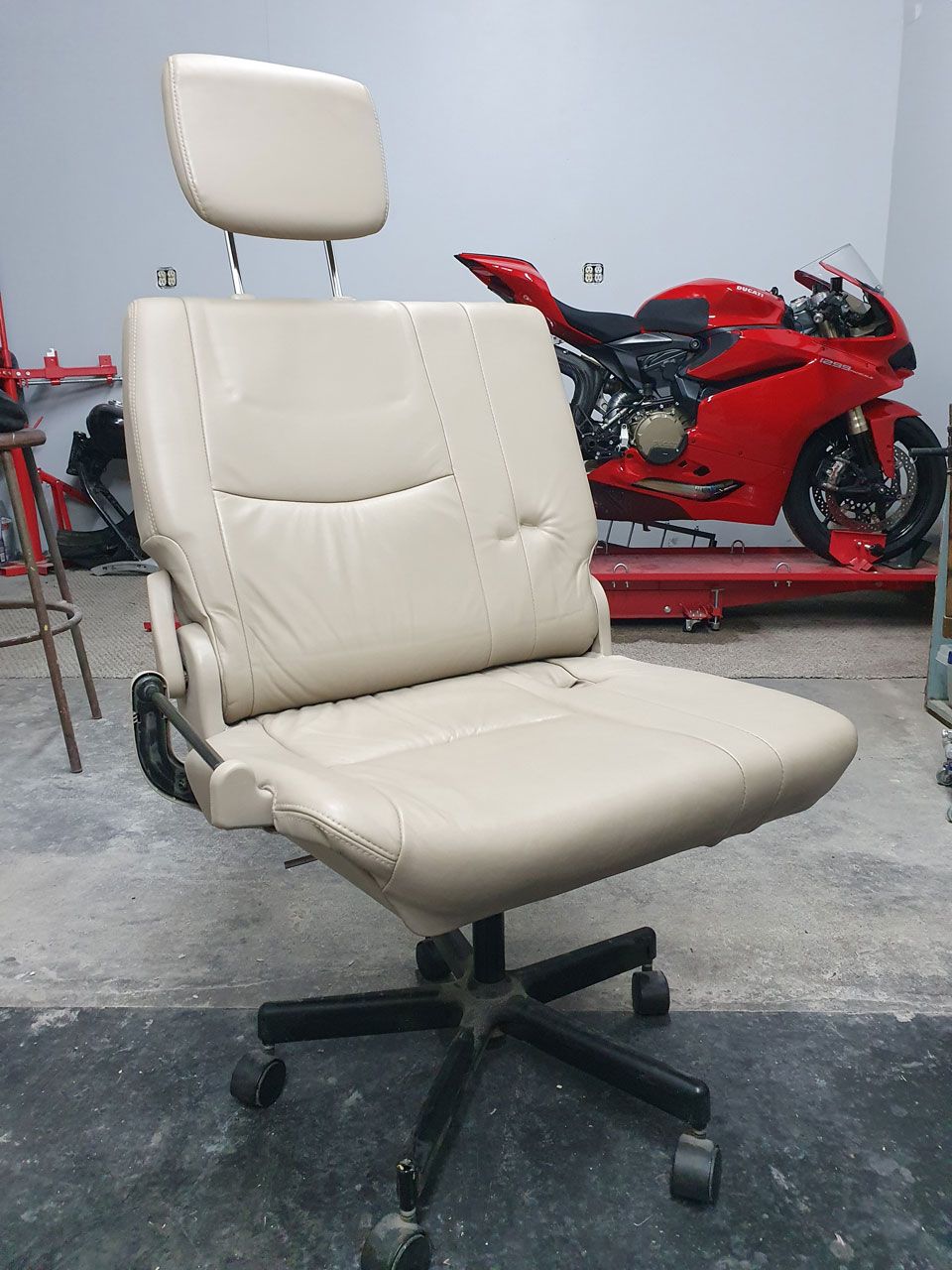

Upgraded an old office chair for free :p

Im traveling right now so don't have a way to snap a pic, but it was very simple -
I just cut a piece of 3/4" plywood to about 90% of the size of the underside and glued it (a whole lot of glue) and drove a handful of screws into the thin plastic of the seat to hold it in place. Let it set for 24hrs and then screwed the chair base into the plywood. It's super solid and stable.

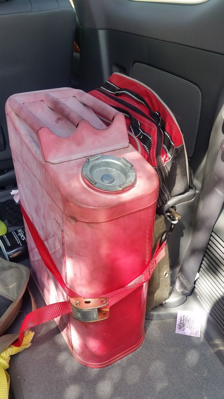

Link for can toolbox?
A few auto zone or Amazon goodies iv added ....
This jerry can tool box I used to have mounted in the rear of my pick from Ramage
I use the tools out of this box more than my 5.5 ft snap on box in my garage ... and the drawer are removable which is convenient ... I welded two chain links on the ends of a pcs of round rod , then snapped it in where the 3rd row seat goes as a tie down point

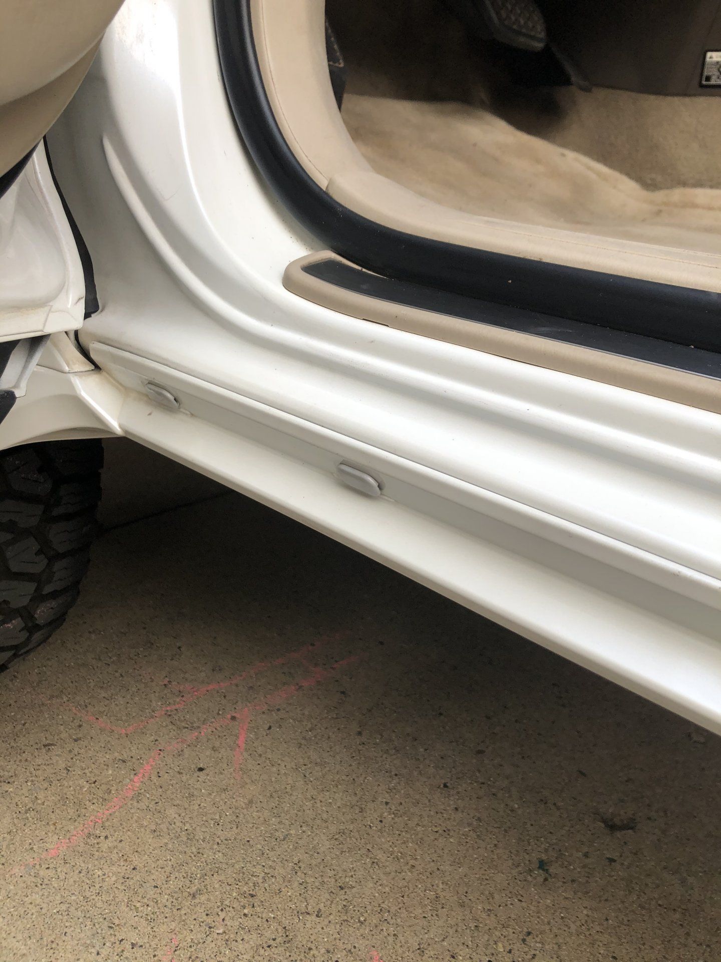

My top 3:
Running board delete (free)
TPMS delete (free)
Rear cargo net fix (free)
