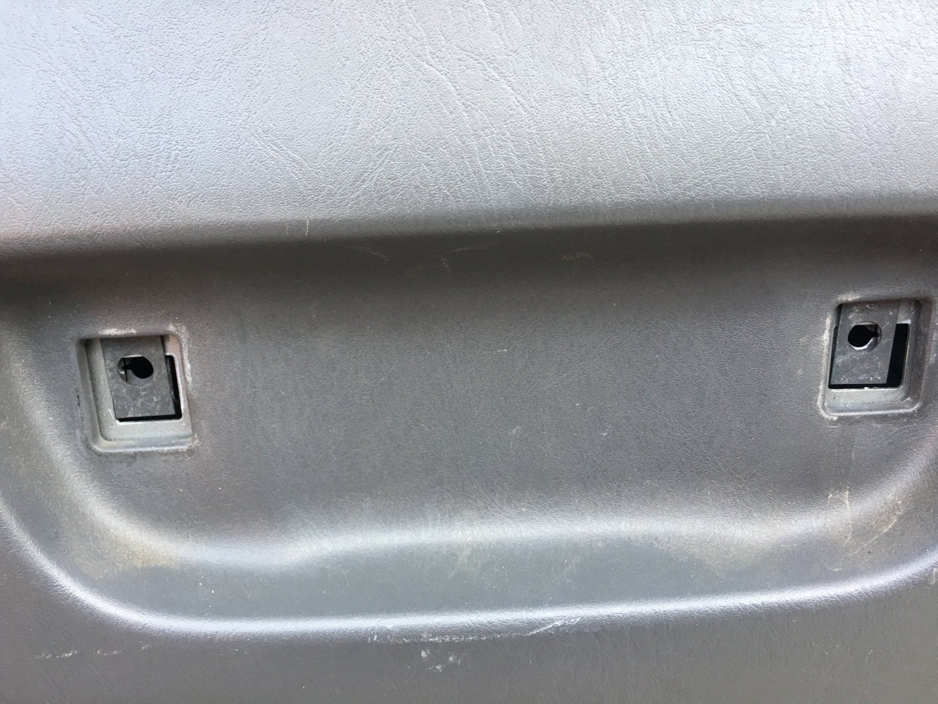

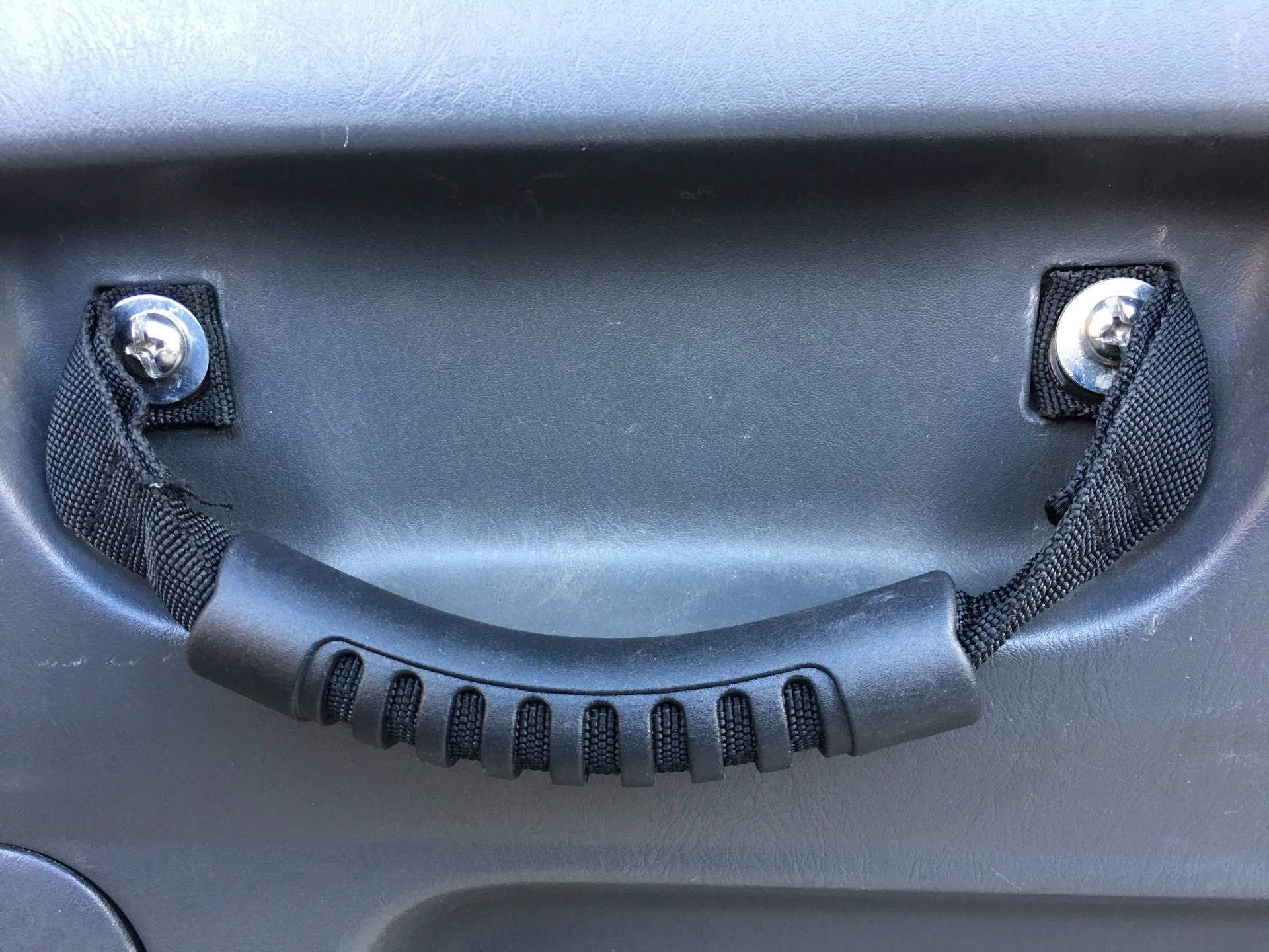

It’s never as easy as it looks. I had to buy special u-type fastener clips at Home Depot and matching screws and washers. Only spent $3.12 in hardware but it’s the time it took me to figure out what to do. Also, washers were too big for screw and luckily I had a pair of smaller washers that worked.
So what are the special U type fastener clips?
I have a handle sitting in my garage waiting for when I install my prep table and figured it could be attached with washers although I have NutCerts that will probably work too.
I think nutcerts will be a better solution than my u-type clips and you won’t even need to remove the rear door panel.
You cannot use washers by themselves because there is no threading/nut anywhere to screw in the new bolts.

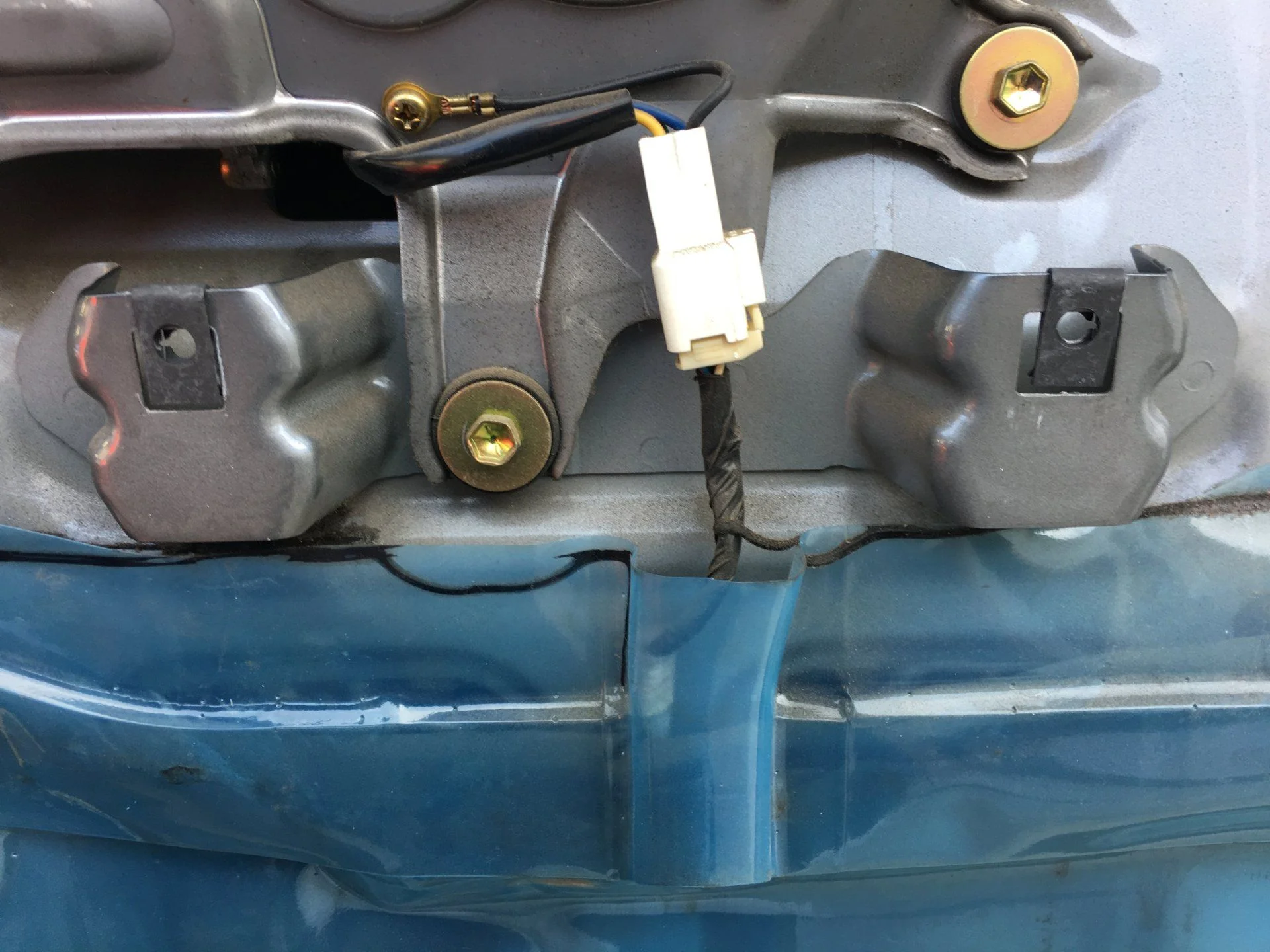

The u-type fastener clips that I used are in the above photo in plastic bags labeled speed nuts. These speednuts or u-type fastener clips provide the threading/nut to screw in the bolt.
I couldn’t figure out how to hold in place the regular nuts while trying to put back the door panel, attach the new handle, and screw in the bolt. Moreover, I don’t have nutcerts and don’t know how to use them. So, I hung the u-type speed nuts in place, reattached the rear door panel, and installed the new handle with washers and matching bolt.
The metal that holds the handle seems thin, so make sure the nurcerts are a good fit for that type of sheet metal.

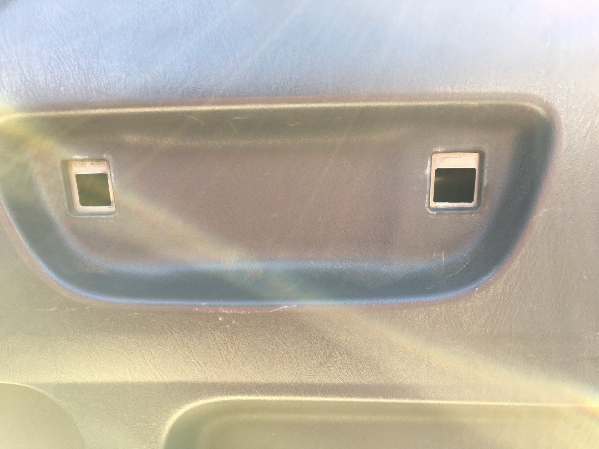

Here’s what the square holes look like without the handle. Door panel still in place. Notice hole is big, wide and square and nowhere to hold a bolt.
Oh cool, now I get it seeing it much larger on my computer compared to my phone. It's the black metal clip in your second & third photos.
Looks like if you were willing to trim the plastic a little bit at the top then you could install them without removing the panel as well. Going to try to do the nut certs this week without removing the plastic panel.
Hoping nut-certs work well, looking forward to the update. Good project!
Tried the NutCerts yesterday and the hole is just too large and would use a 1/2” NutCerts like is used on the OPOR sliders. Far too big of a bolt for any pre-made handle. Plus with the hole being square it is not ideal for a NutCerts because in order for them not to spin once installed the whole needs to be tight around them and almost hammered into the hole.
Check my post on page 9. I used a metal backing plate behind the door along with washers/nuts/bolts of your choice.
So for yours the metal plate is just behind the plastic panel it’s not actually attached to the two metal tabs of the door.

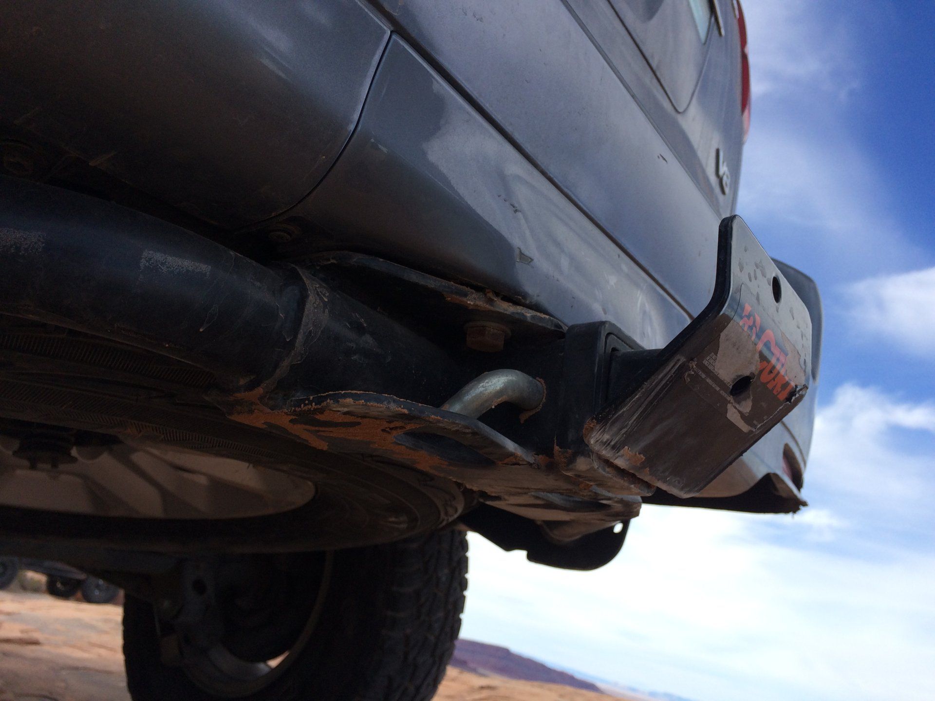

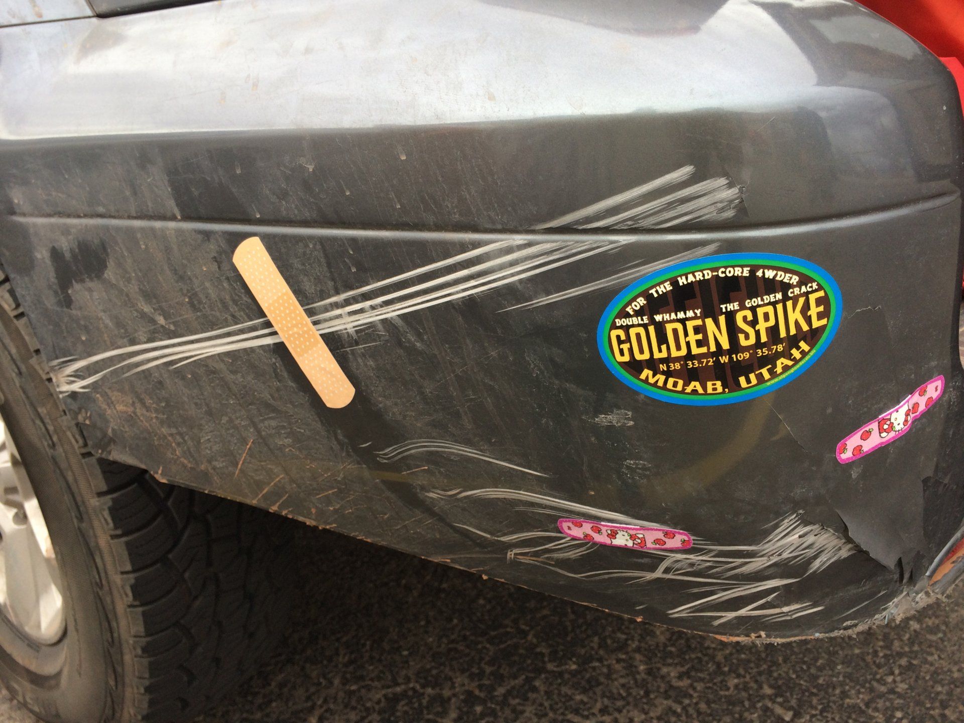

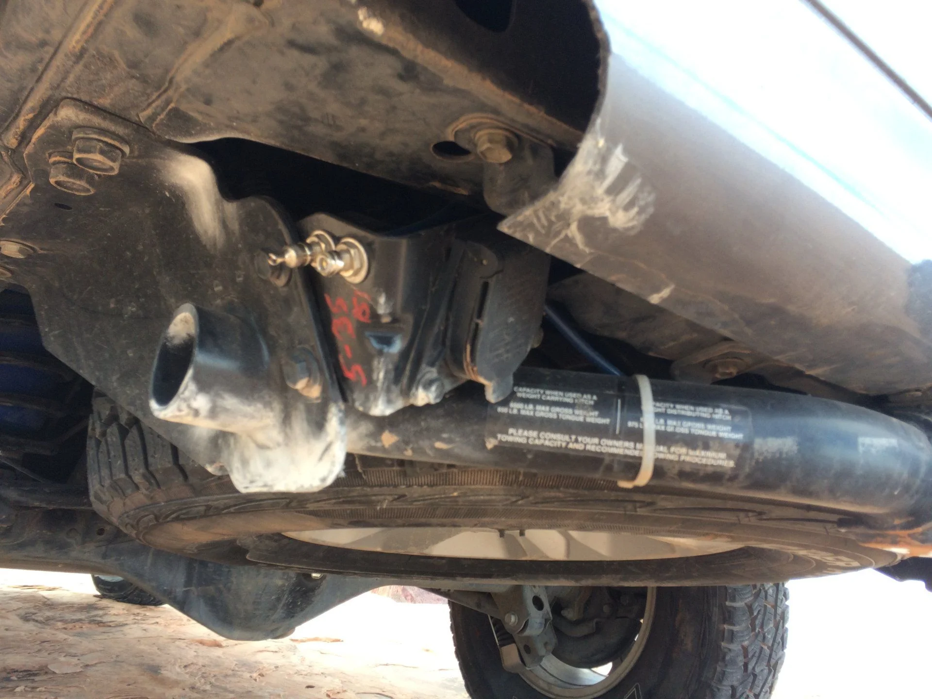

I wanted to share this last minute purchase before my Moab trip that really helped me out until I had to drop off of a bolder on one corner and completely removed the corner of my bumper. :meh:
CURT 31007 Hitch-Mounted Skid Shield https://www.amazon.com/dp/B0009YFNXQ/?tag=ihco-20
There is a company that offers a larger one that actually protects under the hitch too but it was too expensive for my cheap A$$. But for you Ballers looking to blow the $100 budget or make your own here are the other models.

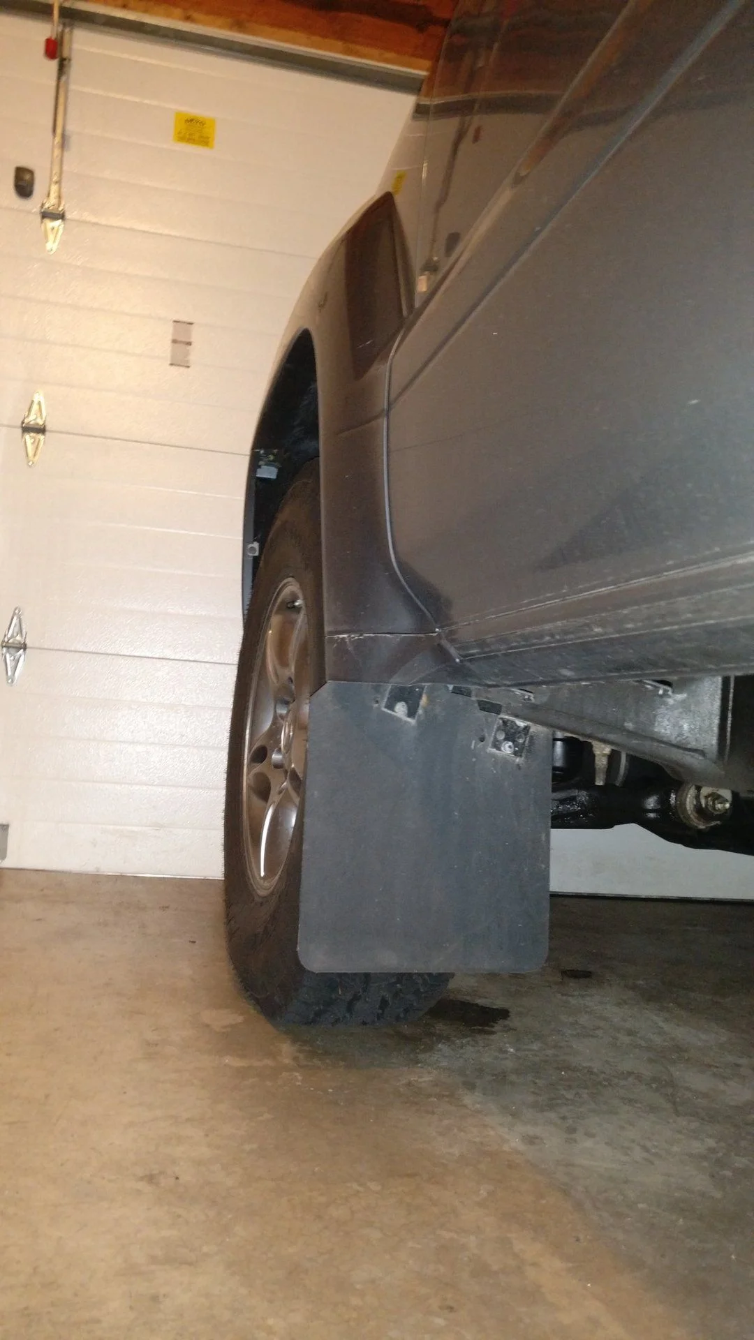

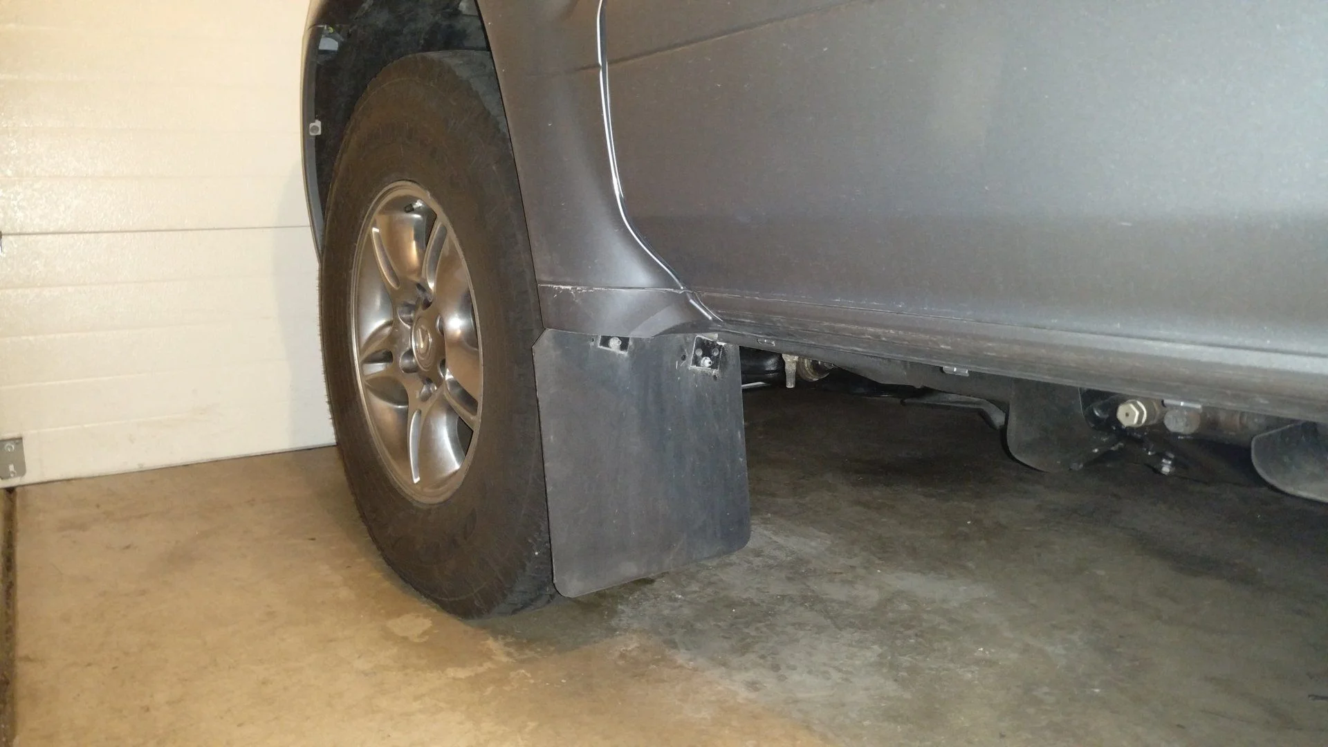

I found out after removing the running board that the snow accumulate really bad under the door. So I got a 30X24 truck mud flap from Pilot truck stop for $20. Buy some angle bracket, a piece of 1.25X30X0.062 aluminum strip and some 1/4" screws. Total cost about $40.

That's awesome! I've been curious about those, compared tot he big one for a bit.
My buddy who just got an '18 TRD off-road runner was showing me that but moreso the $164 skidmark one (which you linked to)... I may fab him one, but i'm psyched to see the curt one in action. So, for the way le$$ than $164 I've been wondering about it
did you redrill the pin hole for a more snug fit? looks good.
