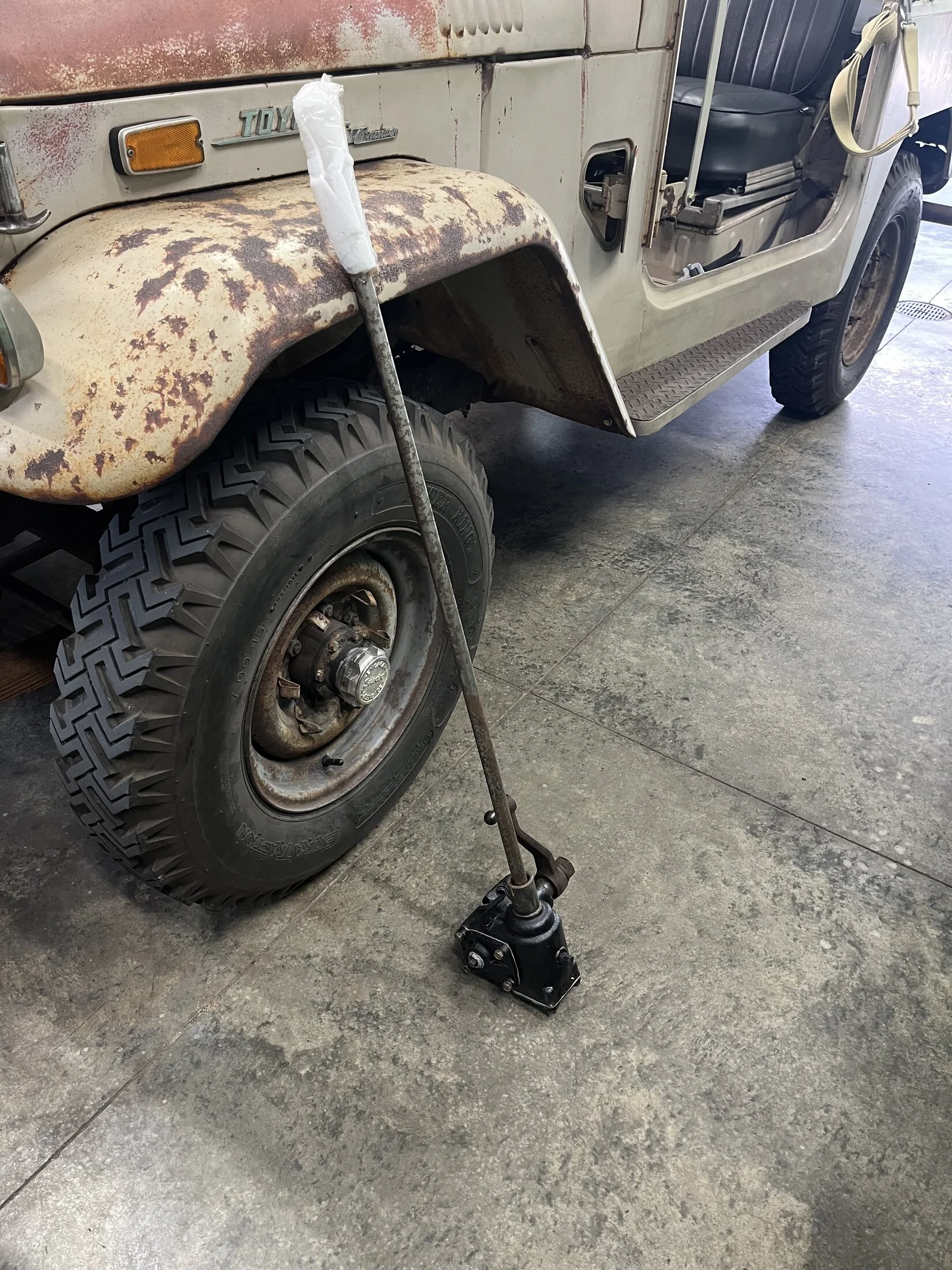

Because of input here in this thread, this weekend I want to remove my steering column and column shifter so I can do an electric power steering conversion and I'm converting to a 4 on the floor. Keep in mind that my rig is a 1971 so there is no rag joint, just a straight shot column going to the steering gear box. I just watched a YouTube video of a gentleman removing his, and even after removing the bolt that held the column to the steering box, he tried and tried to pull and get the column loose and pull it and the column shifter out through the dash but he could not. He ended up unbolting the steering gear box, and pulling everything through the firewall (steering box still attached to the end of the column) and out by the front driver's wheel. What was he missing? There has to be an easier way than unbolting the steering box. And, I need to be careful when removing the column / shaft from the steering box because I have to re-use them. What is the best way to separate the column / shaft from the steering box?
Suggestions, tips, and/or thoughts?
Thank you

Good idea. Here is the video I mentioned. There has GOT to be a better / easier way than this. Anyone have any tips, suggestions, or thoughts?
When I did it on my ( 9/69 ), 1970 I was switch from a previous P.O. conversion to 3 on the floor.
I swapped in a drive train, steering column and othe parts from a 1/79 I had that was getting bad in the frame.
If I remember correctly, I had to pull the 70 box off the frame and pull it out through the firewall with the shaft still attached.
This was better than 15 years ago. I ended up scapping the 70 steering not knowing it was worth something, especially if the gear box is in good shape.
Don't toss it like I did.

U don't its one piece.
Well that stinks! I guess I will have to figure out where to cut it, and then get to cutting. Maybe I will try to document and Video the process in case someone else wants to do this in the future. Hope my face doesn't break the camera!

So, here is the BIG QUESTION... is there ANYONE here on iH8MUD that has taken one of these early FJ40's with the straight solid shaft (no rag joint) and converted it to EPS (Electric Power Steering)??? And, if so, do you care to share exactly where did you cut the shaft and put on couplers/adapters?
"IF" it turns out that of all the countless early FJ40 owners that are out there, NONE of them have done it, then I will try to document it and possibly video it in order to help anyone in the future that decides to do it.

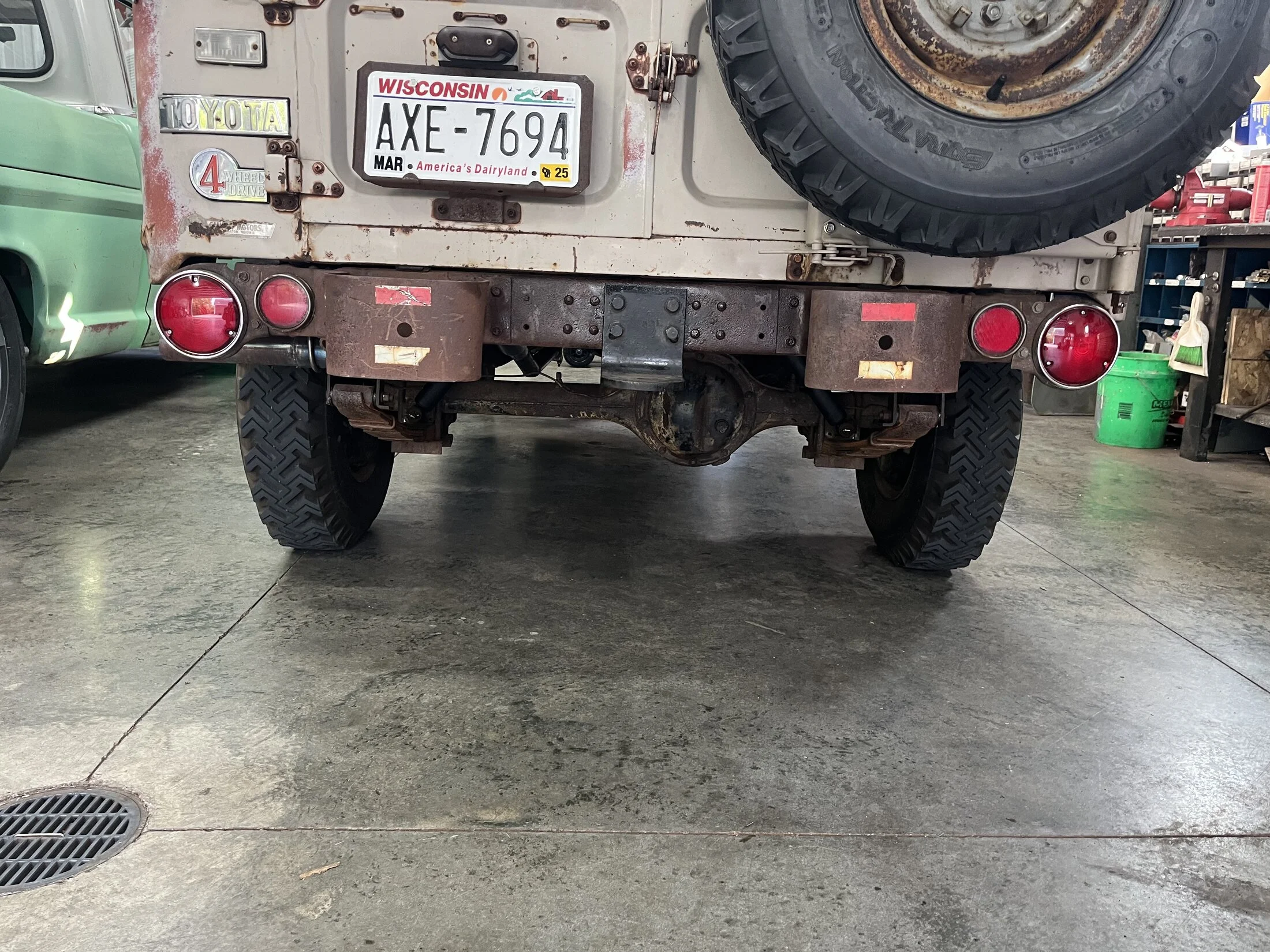

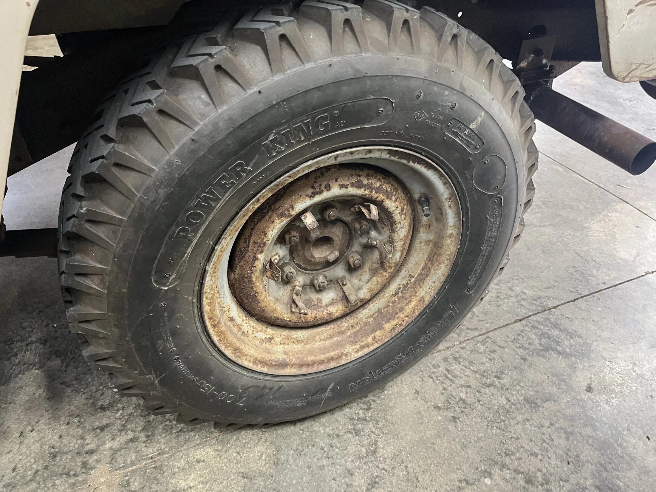

If your not putting big tires on it wont need it. This truck easy to steer with these skinnys. I get it not the look for everyone but easy to steer.
3 things:
1. Thank you.
2. What size are those tires? I can see that they are 15", and I think maybe 7" wide, but nothing else.
3. Wish I had seen your message 24 hours ago before I purchased the Electric Power Steering Conversion Kit. I'm committed now, so here we go. And, if the clutching / shifting becomes too painful because of all my surgeries, then I'll end up probably doing a SBC & automatic transmission swap, so the power steering would come in handy.
