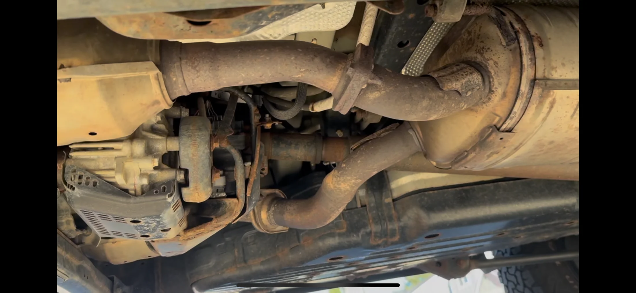

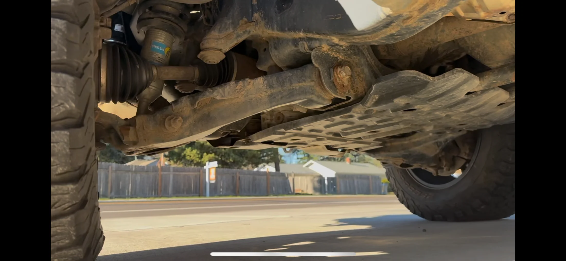

Been a lurker for awhile. Started with wanting a fj62, then a lc100, and after hours/days/months of reading, research, etc… I’ve landed on a lc200 and I think I found one! I have a couple of photos of the undercarriage and am a little concerned about the rust. It’s a 2013 lc200 with 110k miles on it. Lived in NY for the first 5 years and then Oregon.
For what it’s worth, I live in north Idaho and we salt the roads here so I’m assuming anything I get is going to rust. Just wondering if I should worry or anything I can do to remove the rust and/or prevent more rust. Thanks guys and looking forward to joining the crew.
If only people cared to rust proof their trucks we would not be looking at these sad looking frames. And **** salt, by the way.
Re this truck - it is perhaps not the worst. I think there is a lot of dirt, too.
looks good to me, thats 3 years rust on a new truck where i live
thats within fluid film range, youll hardly notice it after
thanks guys. Makes me feel better about getting it. Honestly I just looked under my tundra and it looks the same. Haha. Salt roads suck.. need to do some research and ask some shops to figure out what to do about the rust and how to prevent it.
