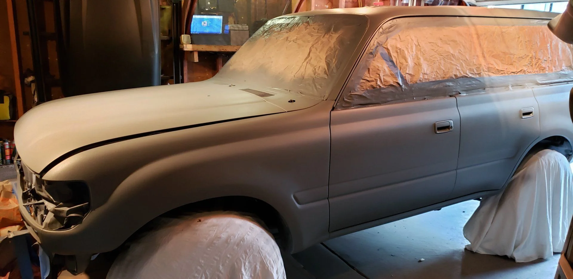

We removed mirrors, wipers, lights and grill. I left the bumpers on to make sanding easier. Then I removed them and suspended them for painting. Taking the mirrors apart was a pain and, because there are no outlets to protect the leads, I ended up shorting my battery. My bad. I had removed the window sill pieces (not sure what they’re called) and a number of the mounting clips had to be replaced, but it made masking a lot easier under around the windows.
A lot of time was spent on masking before sanding. I have to give credit to my wife who was meticulous. We were sanding and patching little dents for a few days. There was a lot of history to hide.
I didn’t want to remove the hood, but I did want to block the air intakes below the wind shield, so I just lifted the hood and removed the six screws to lift the plate enough to slide a couple of paper bags in there. Worked perfectly.

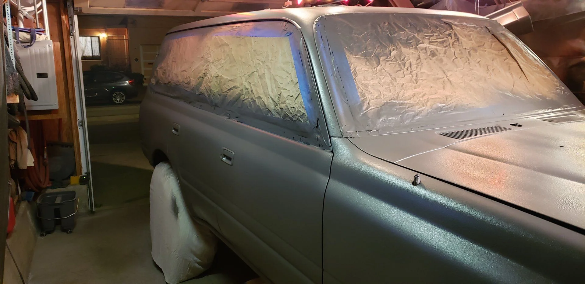

The first coat was sprayed at half-strength for a wet relatively lumpy coat.
Each coat was sprayed with a progressively lighter setting until I almost couldn’t tell paint was coming out of the gun.

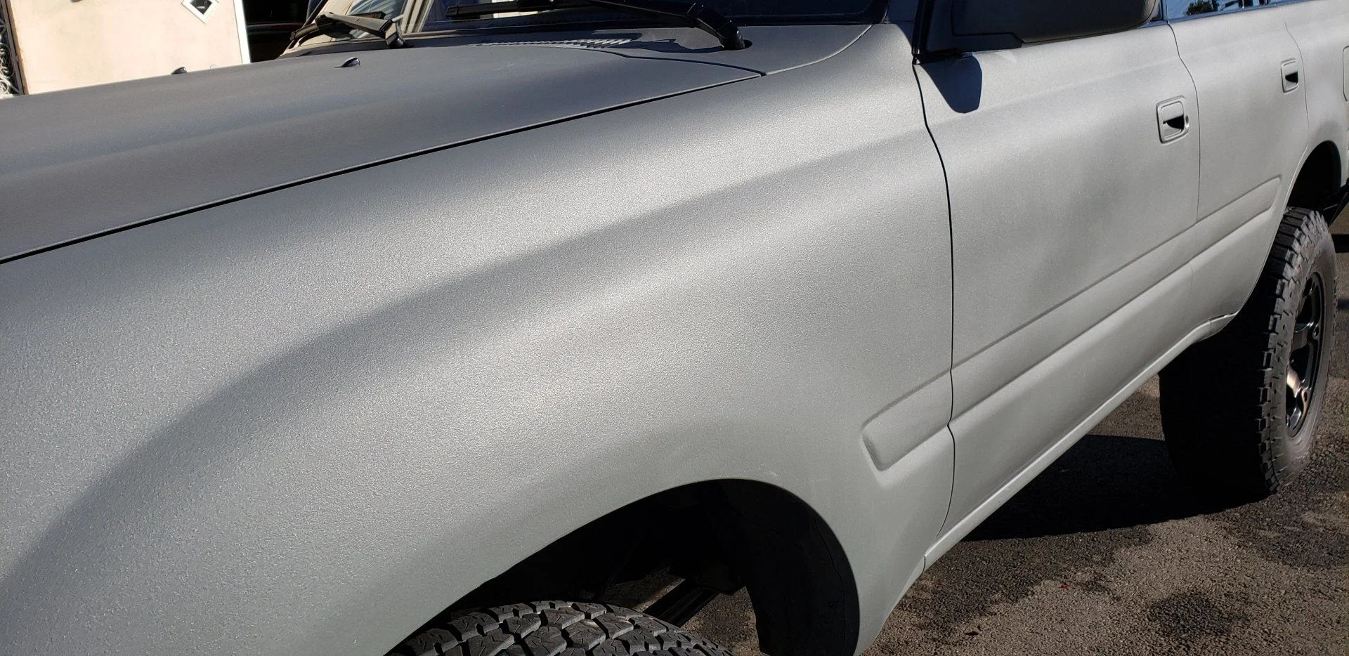

The final product feels like sandpaper. As you can see, the surface is mat and seems to absorb light.
In total, I put about four to five coats on the entire truck with only 8 bottles. I bought 12 bottles, so it's nice to have spares in case I roll the truck (again).

After thirty days, I love it. We've only put on the usual street miles. Though, we took a drive up to Calistoga. It never looks dirty! None of the usual road grime shows up. This was an unexpected bonus.

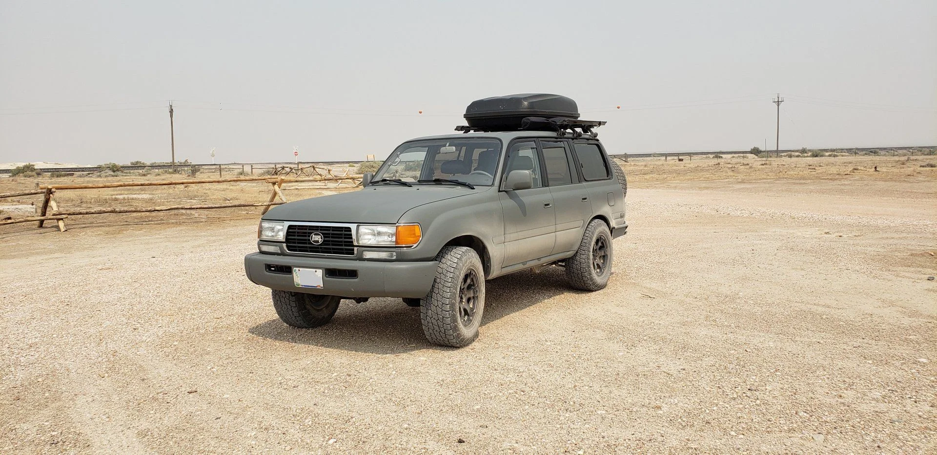

You might have noticed how low I'm running fully loaded. I recently added a 15 gallon reservoir to the roof box and a heavy fridge/freezer along with the new bumper and tire carrier. So, last week I installed a lift kit including front control arms for caster correction. The trail I'm doing this weekend requires a lot of articulation so this was a must. Here is another shot showing the lift and Raptor liner...

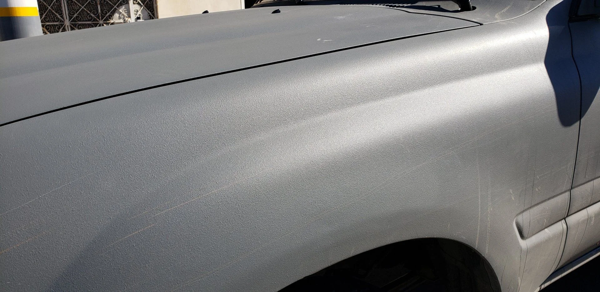

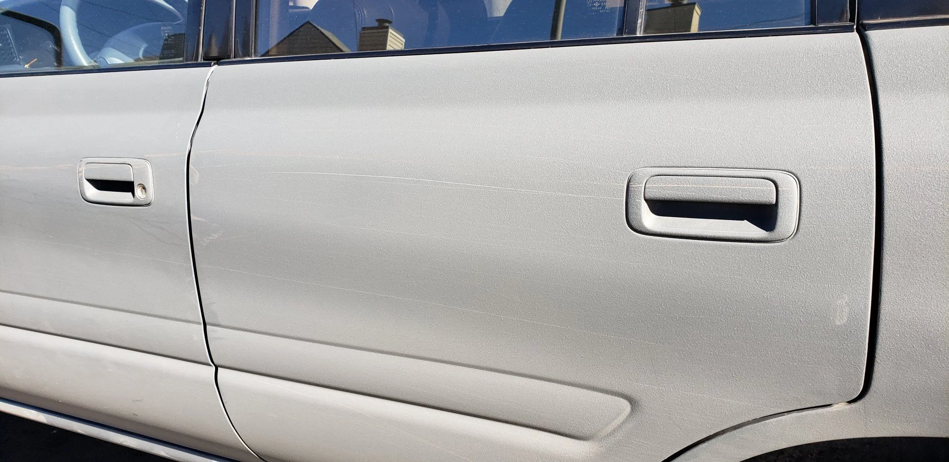

Note the 'before' pictures where the Raptor was like sand paper and actually pulled brown bark off the pines, as the scratches were brown in color. Cool! Giving the brush the what-for! In the 'after' pictures, I merely washed the truck and then rubbed the scratches in a circular motion with a wet towel to remove the lines.

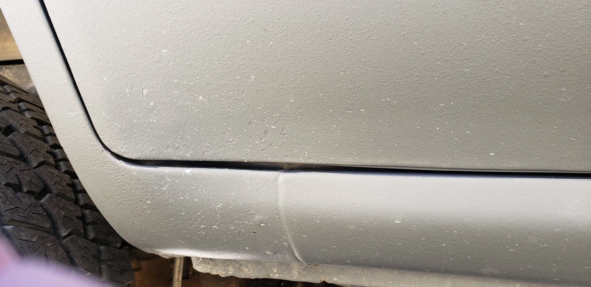

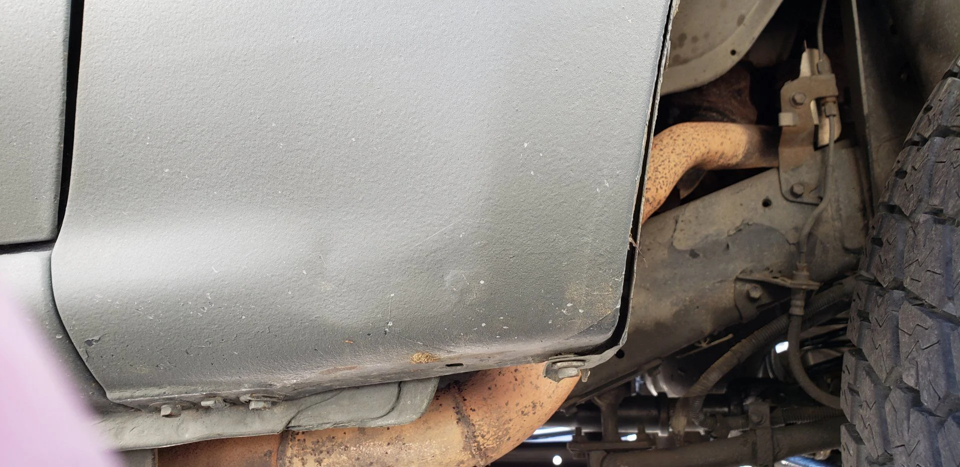

Here are some pictures of the underside areas behind the front wheel and in front of the rear wheel to show that this stuff isn't indestructible. After about 1500 miles, including highway, washboard, gravel, sand, show and ice there are some nicks at these spots. However, the hood, which for years was a star field of chips, is flawless! As is the rest of the truck. All hail the Raptor!
