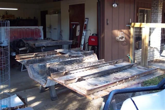

Well, I made a little progress this weekend breaking the bed down to its individual components. I'm thinking about going back with 1/8" diamond plate for the floor and wheel wells because the rust there is fairly extensive and I cannot think of a reasonable way to duplicate the original contours for making patch panels. Has anybody else used diamond plate when you fixed your bed? I can't seem to find any diamond plate wider than 5 feet and the original bed is 63 3/4" wide. How did you make up the extra 1 7/8" on each side, angle iron?

I will be using 1/8” diamond plate to replace the bed on my truck to but I will be making it as a flat bed, but I will install the side panels to try and keep it looking stock from the road. I will cut the 5’ x 8’ plate to the length that I need and use the rest to make up the tail end of it and then use some 3” x 3” angle iron to fill in the sides and give me some thing to attach the side panels to.
