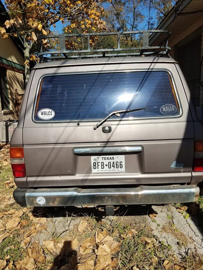

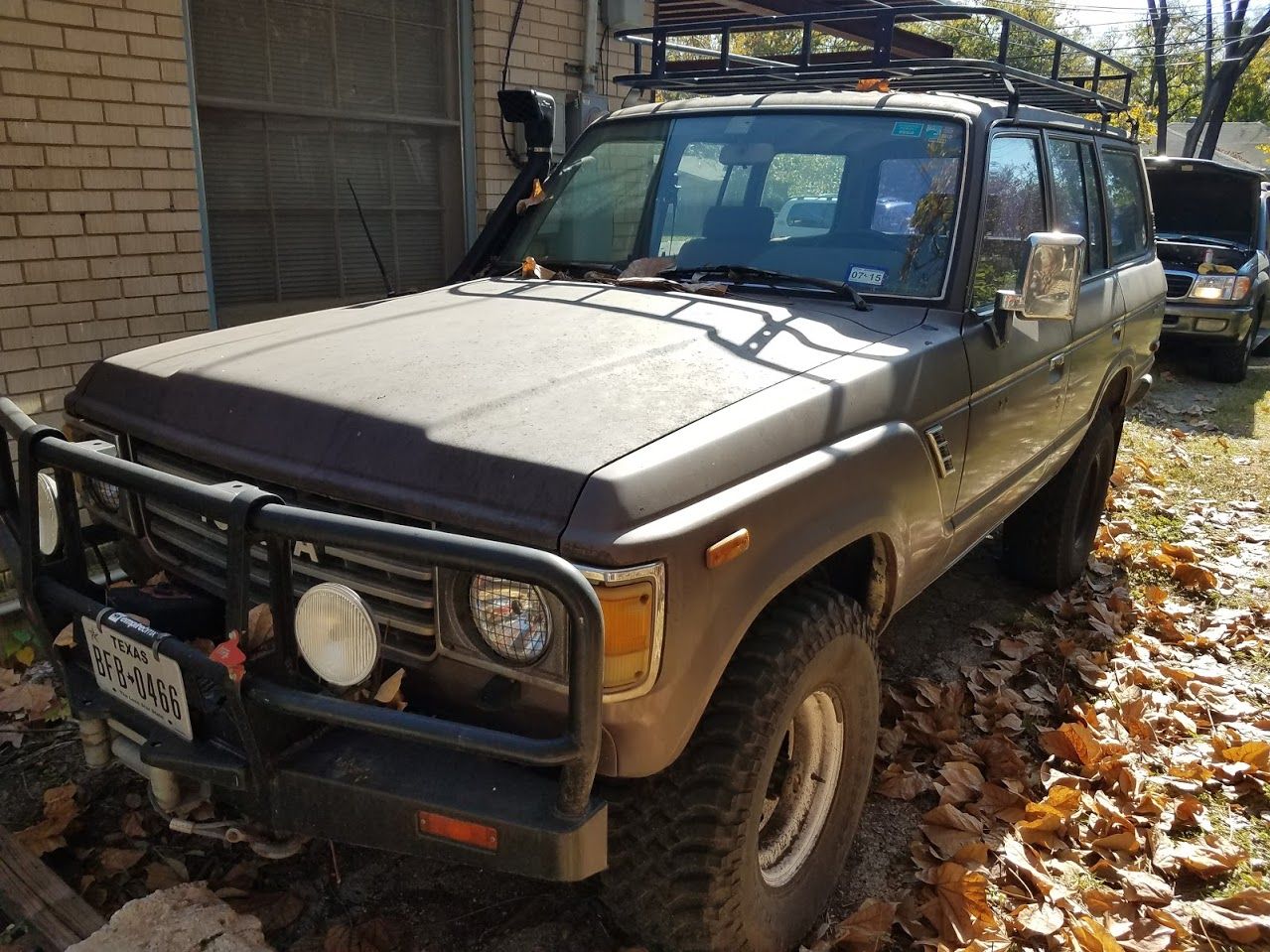

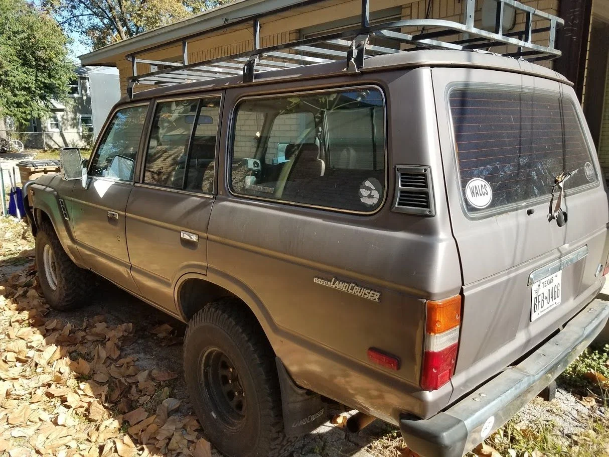

I've wanted a 60 series for a while now. I really dig the round headlights and the overall look of them. Recently, my buddy Heath offered to sell me his 1987 FJ60. It has a lift, 33's, front ARB bumper, roof rack and an H55F tranny. The bad part is that the engine has a bad rod knock and the paint is in bad shape. I really couldn't pass this up for the price I got it for and also the fact that it has been my group of friends for a long time.
The plan is to repower her with a diesel. I really want a Toyota power plant, so that's what I'm going to aim for. I'll ultimately paint her, but I just want to get it 100% mechanically solid before that.
