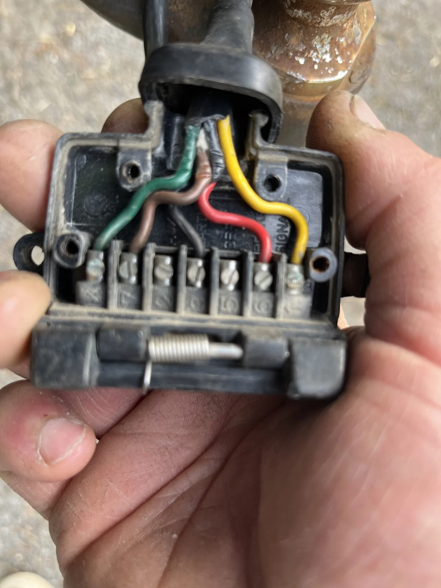

So I have a bj73 from NZ and it has the 7pin flat trailer and my trailer has a four pin. We’ll, I didn’t even look at what trailer plug until I needed to use the trailer… so the 7pin actually only has 5 wires :
Green-right
Yellow-left
Brown-marker
Black-earth
Red-brake/stop lamps
So my question is: how do I wire this to a 4-way plug? I called e-trailer and the nice guy in the phone couldn’t help me… I don’t care about keeping the 7pin plug-I actually want to replace it with a four way just have no idea how to get the brake lights working. Thanks again!

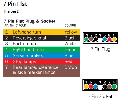

Hah! Well trailer plugs in oz is a bit of a circus, we have 7 pin flat , 5 pin round, 7 pin round and some others and the shops sell about umpteen connectors for each way, male male, female female, female male etc... At least the packaging has what wires go where on some of them. But it depends on pvo, the bugger.
Best bet is use a test globe probe lamp and earth the alligator end. Touch the probe say with your green wire for example whilst your left indicator is flashing on your vehicle, if the probe flashs then that 's the one. Process of elimination. Use a brick on your pedal for your brake light.
Guessing from here red is power, black is earth, green left, yellow right, brown stop. But best do your test first.

Yes, but that’s the issue I’m having. So
I’ll do this:
Australian to USA
Green-right turn : Green-right and brake light
Yellow-left turn : yellow - left and brake light
Brown-marker: brown-marker
Black-ground: white-ground
Red-brake lights: no red wire on a USA 4 pin.
So that’s the question. How do I power the brake lights to my trailer. I want to use the four way just don’t know to wire the red(brake lights) I did use a rear light. And red does power brake lights when brakes applied

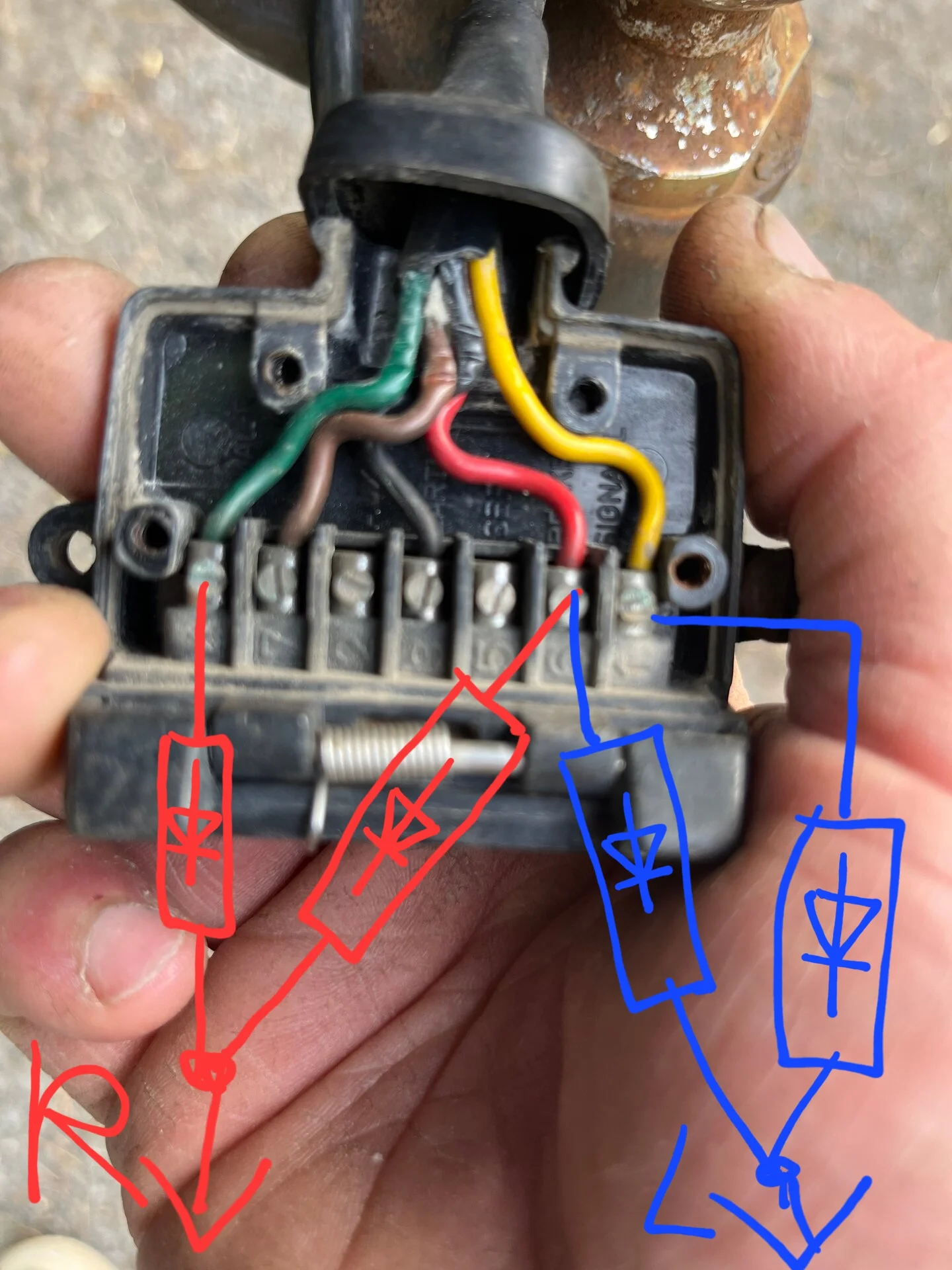

Maybe I misunderstood, but I think you're trying to wire an international truck with orange rear turn signals to an American trailer with only red stop lights?
If this is the case then you'll need diodes, otherwise when you hit the brake then your front turn signals will come on. I guess the bulbs are 21w each which is about 1A at 24V (2A at 12v).
The red brake line drives two bulbs, so that's a total of 2A at 24V, while the turn lines drive only one bulb.
A simple rectifier diode such as a 1N5408 should suffice. You'll need a higher current rating if you're running at 12V.
You'll need four of them as below - sorry for the rough sketch.
