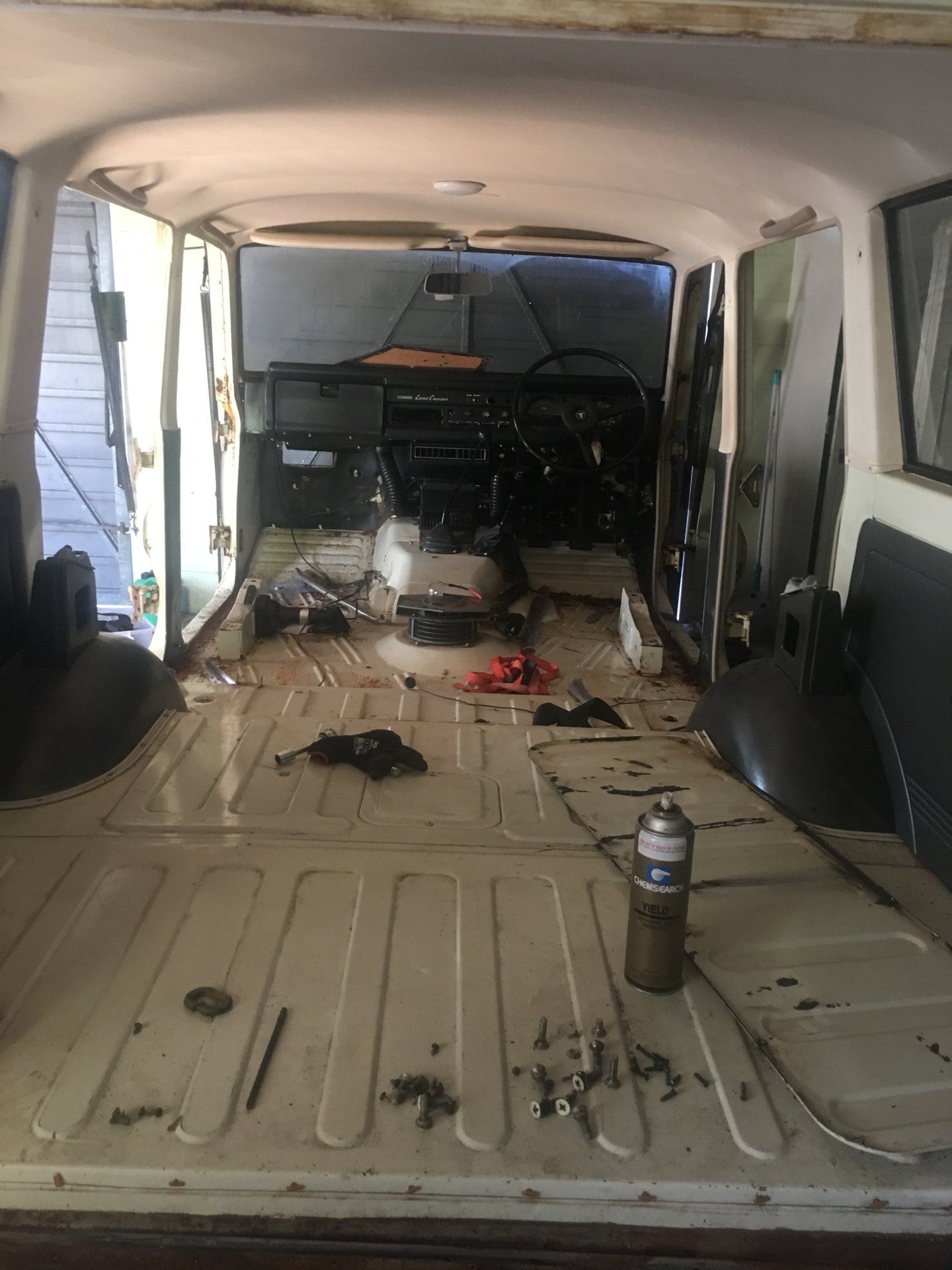

Got some done the last few days, I’m impressed with condition of the interior body panels. I’m going to completely strip the body and repair it first. Then bring each door and panel in one at a time to fix and attach them.

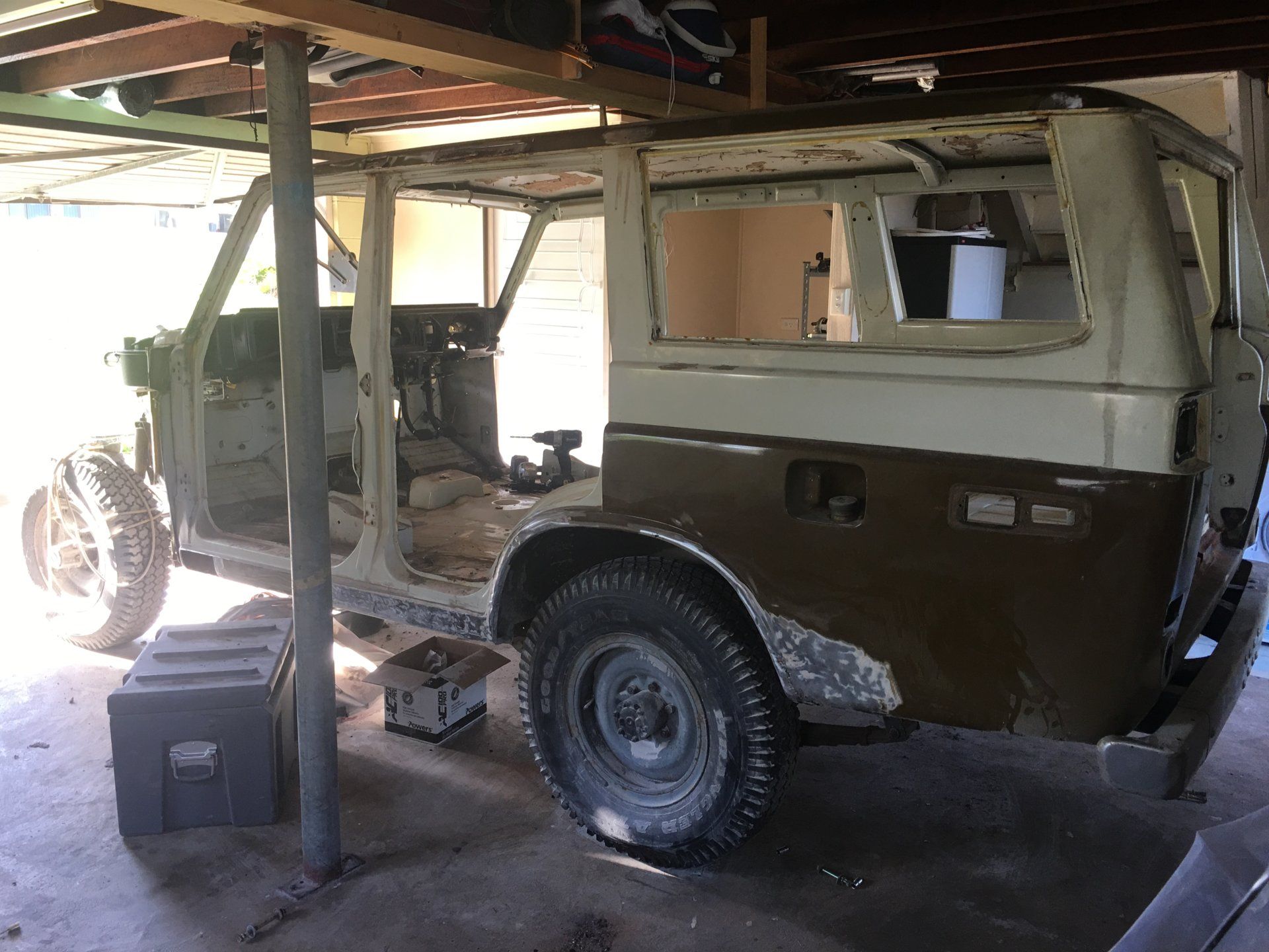

Got the body stripped and ready for welding so there was nothing I could set on fire.

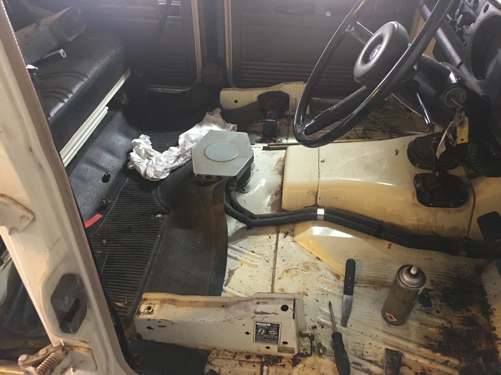

Started cleaning up the floor, it is in great condition.

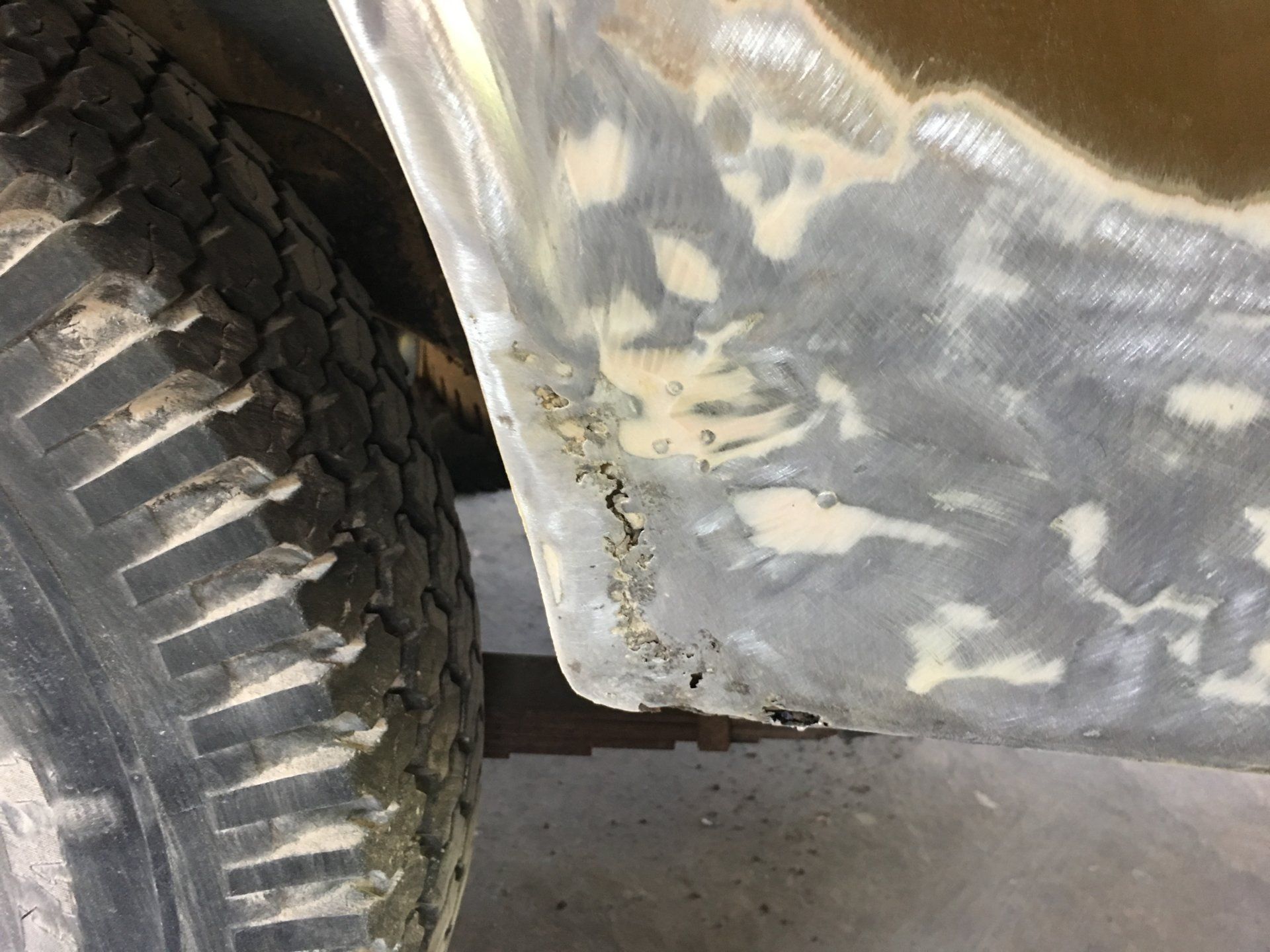

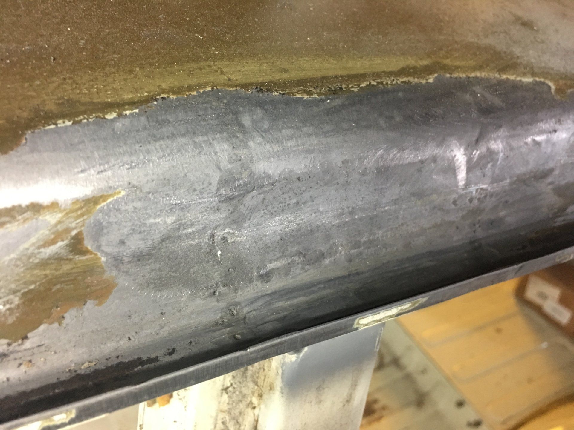

The rear quarter panels aren’t so good.
I’m guessing there was a bit of a run in with a tree or something at some point. There was a lot of bog in there!

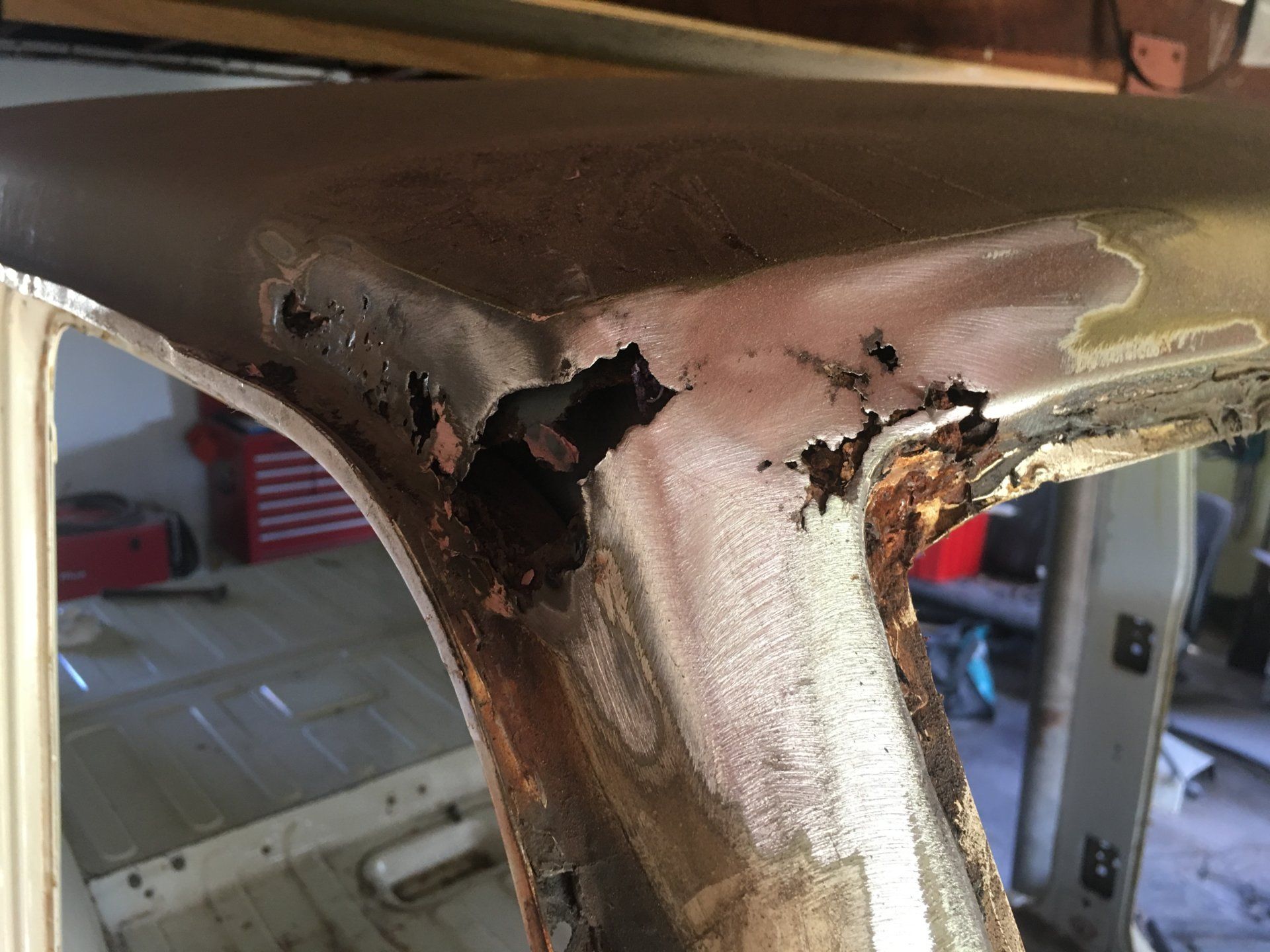

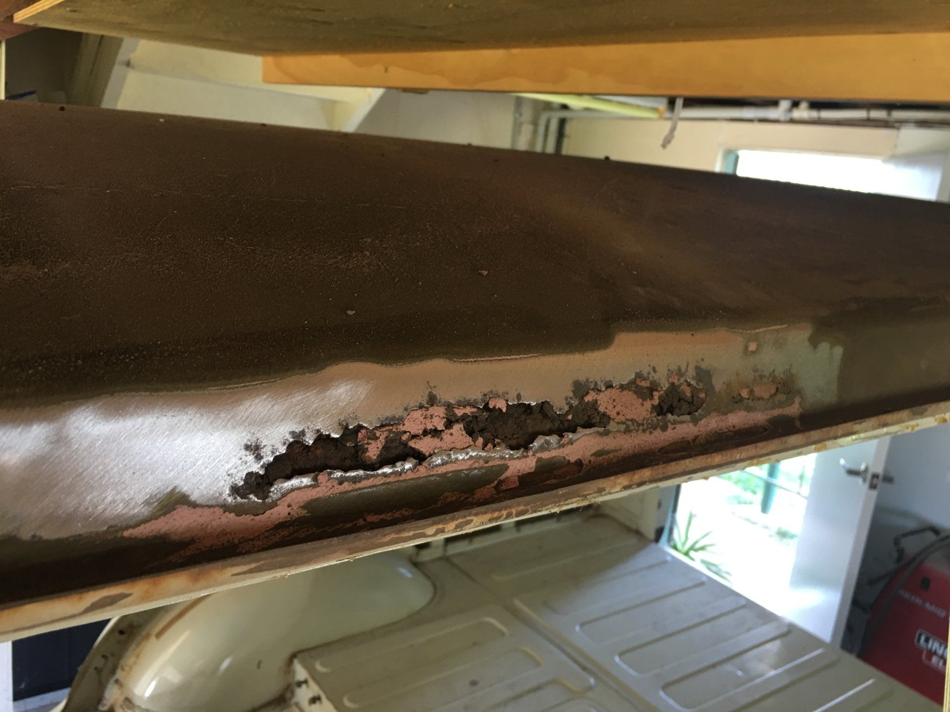

Typical rust in the roof.
And what is probably the most complicated section to repair, the apex of the A pillar and roof.
Yeah everything underneath is in really good shape. I’m thinking about making a rig to lift the body off the frame so I can get in and clean and paint both the frame and body.

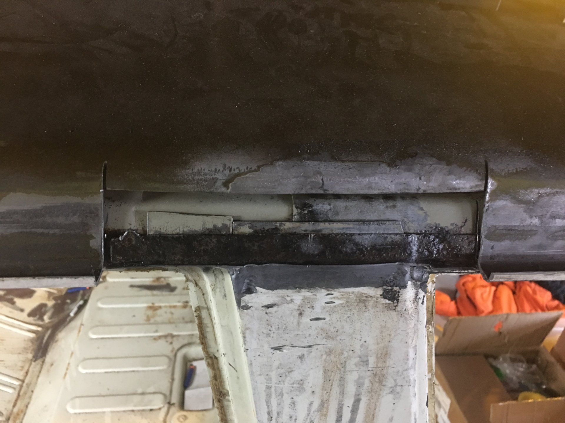

Well I’m back after disappearing for 6 months. And I’ve started making some headway.
Cut, weld, grind, repeat.
