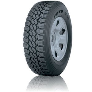

So far I’ve found 2 choices that I like. One is the Toyo M55f in a 235/85r16.

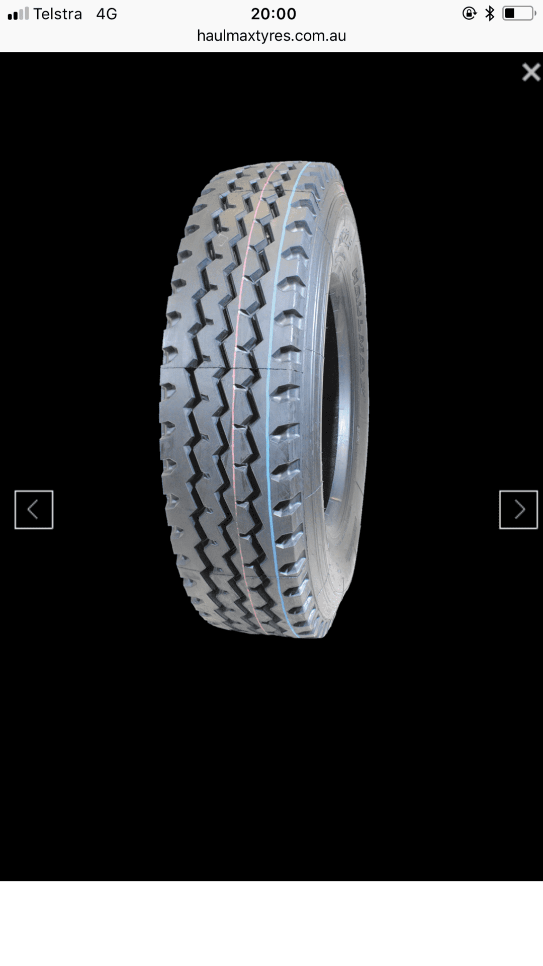

The other is a truck tire made by Haulmax, an ATT202 in an 8.25r16.

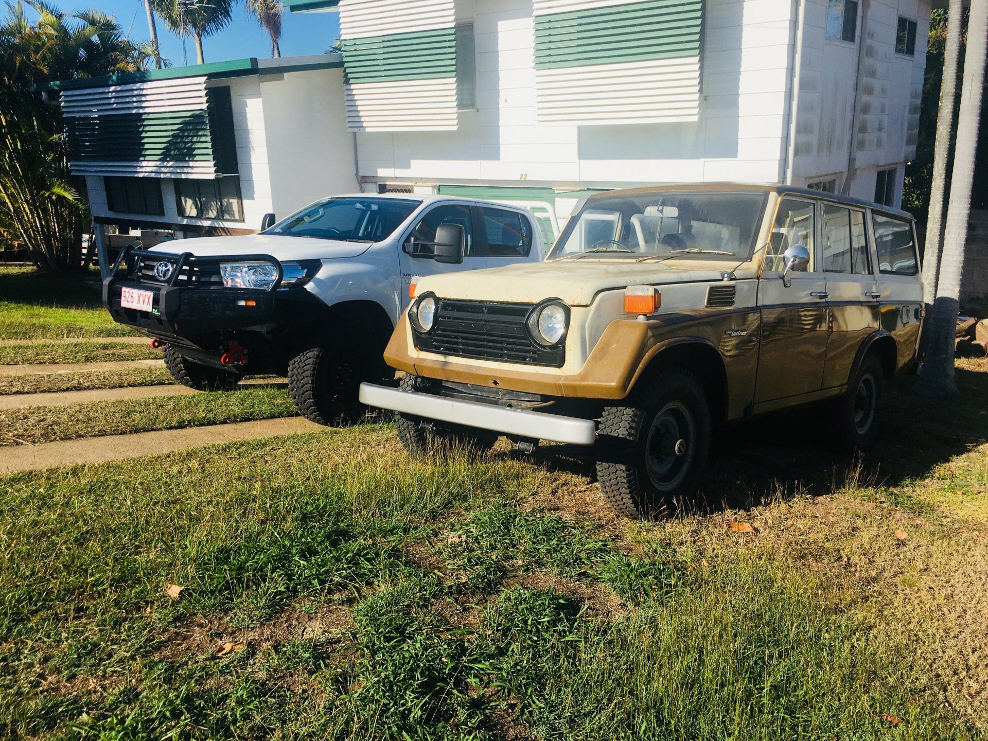

Im running haulmax att304s in 8.25r16s on split rims.. heavy tyre combo at 50kg corner..
That looks awesome! Are those factory splitties?
yep just 5.5x16 split rims painted black.. note i've got a custom lift in there giving it about 3" more height. I ran them on my 40 with the 15B-F which didnt have any issues pushing them along but felt my brakes could do with an upgrade to stop them better..

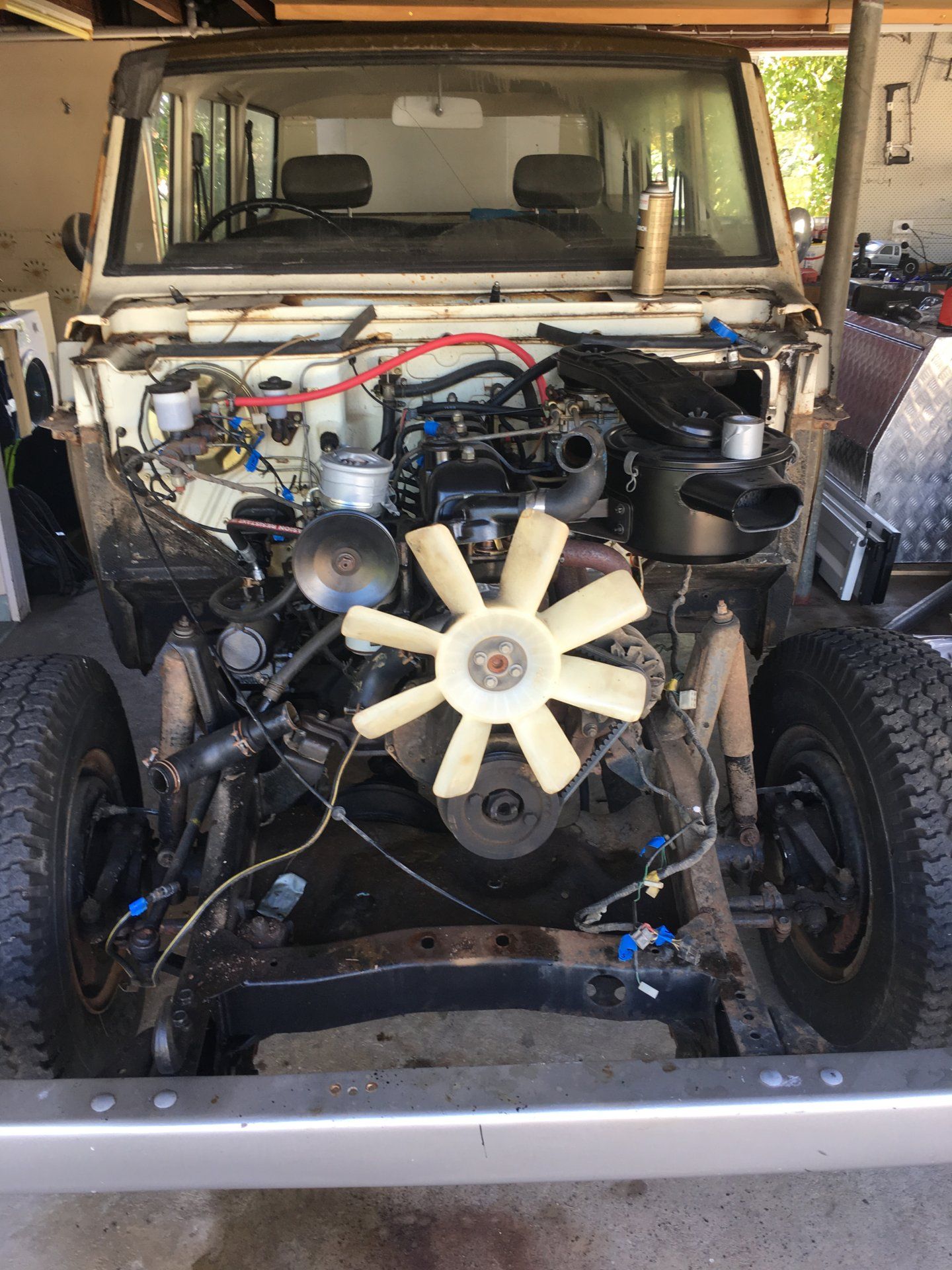

All the front body panels are off, every bolt and part attached to them is labelled and stored away for later. Next up I’ll start removing doors and gutting the interior.
