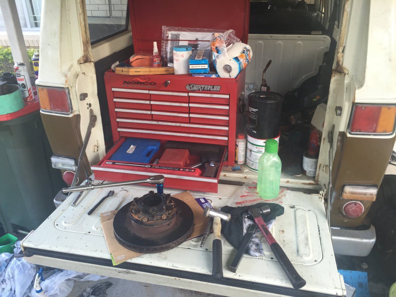

The old bushes can be tapped out but I have a hydraulic bearing puller so I did it that way.
Your bushing looks the same as my old ones with the oil grooves, but mine have way less wear. I still have around 75% coverage of white metal on mine.
It will be interesting to see how well the new ones go without the oil grooves, hopefully I don't end up with a system full of ground up brass!

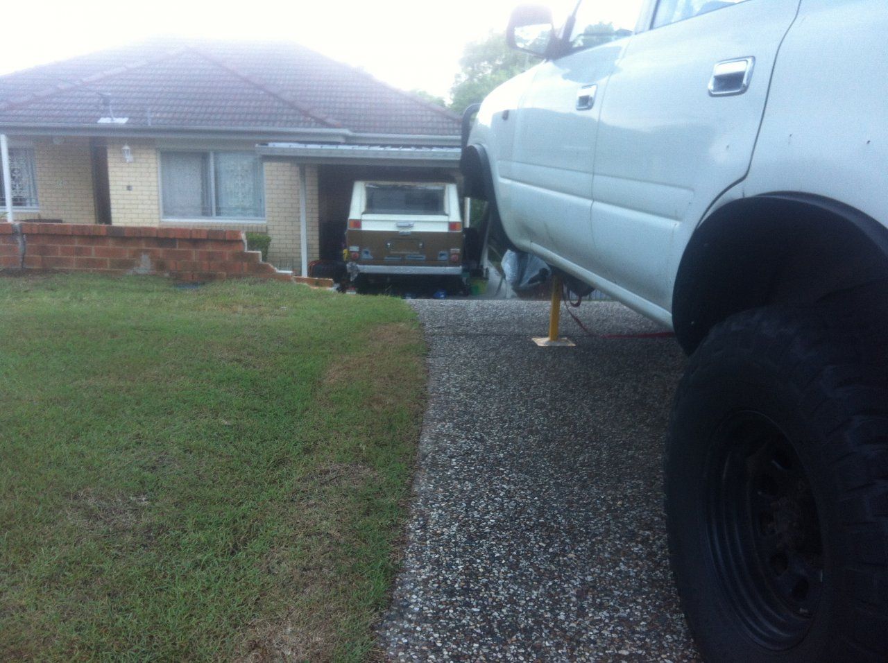

Well isn't life crazy! As mentioned I am packing up and moving the family so my wife can continue and improve her career. Moving day is about a week away now. Just to add to the fun my wife fractured a vertebrae and compressed several others about 2 weeks ago so she is laid up sore and cranky!
To move I need to have the 55 running which I only got done yesterday. I also have a lawn ornament 80, a yaris and a Camry to move too. So I thought, cool I'll put the cruisers on a truck and my dad and I can drive the cars down.
Then I get a phone call this morning asking if I can do 3 weeks work 150km inland from where we are. Normally this would be no big deal but of course there is the move going on. Also I have to take a heap of tools for work plus gear to camp for 3 weeks then drive to brisbane. Which means that the damn lawn ornament needs to run before Sunday!

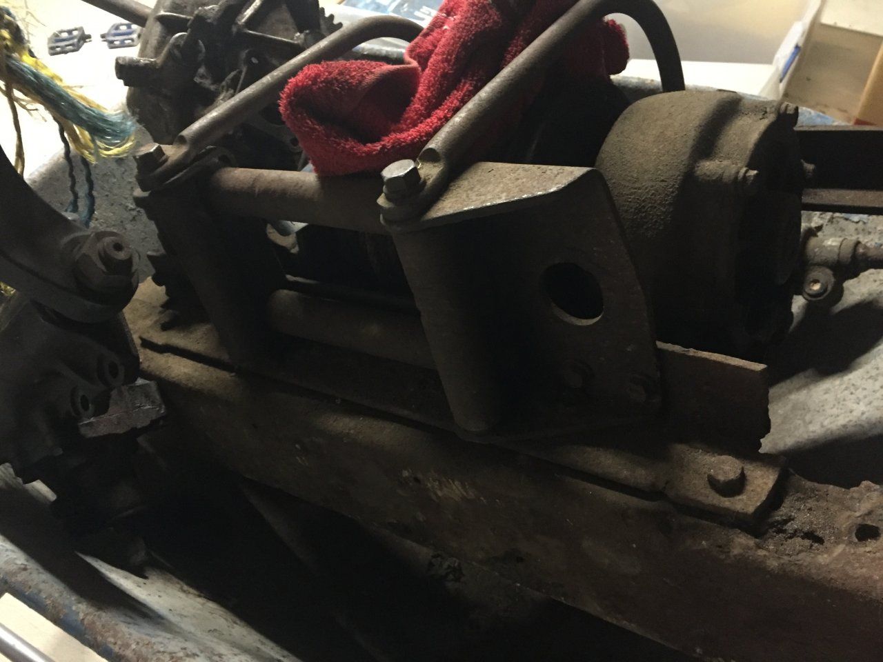

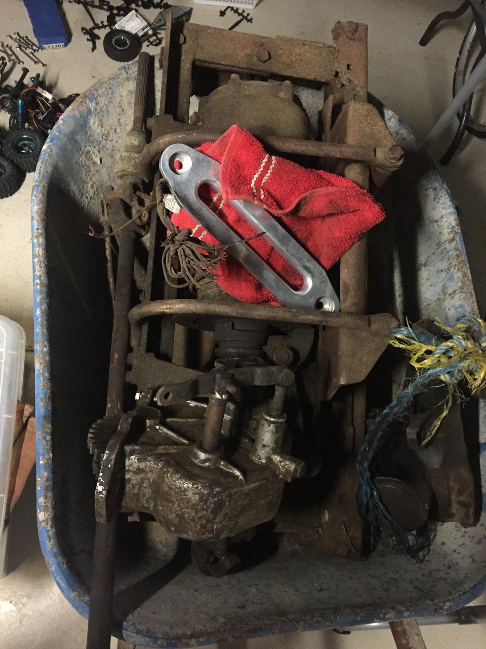

I found this when I was visiting my parents on the weekend. A little front end bling for the old girl. The fitter turner in my couldn't resist, there is some bad rust on the support frame but I will replace all that. It won't stay stock though, the fairlead support frame will be replaced with a big bit of box section so that I can run an ally fairlead for synthetic rope. I would have kept it original but the fairlead rollers and frame are toast.
It's a slight deviation from getting the 80 done but I couldn't help myself.

Nice find on the PTO winch! Are the roller farileads seized? If not, I would love to take them off your hands...
Well and truly seized unfortunately, hence my decision to go with synthetic rope and replace the whole fairlead system. They are bad enough that on some of them there are big gouges in them from the rope. I can see if some of them are salvageable but I think the 2 vertical ones are beyond repair.
My issue was that I had a horizontal roller seize on me, and then I buggered up the threads trying to separate the roller from the shoulder bolt. If you had 1 good horizontal roller, bolt and nut, that would be the ticket!
I'll see what I can do for you my friend, hopefully I can find some salvageable parts in amongst the rust. I'll try get a spanner to it tonight for you.
