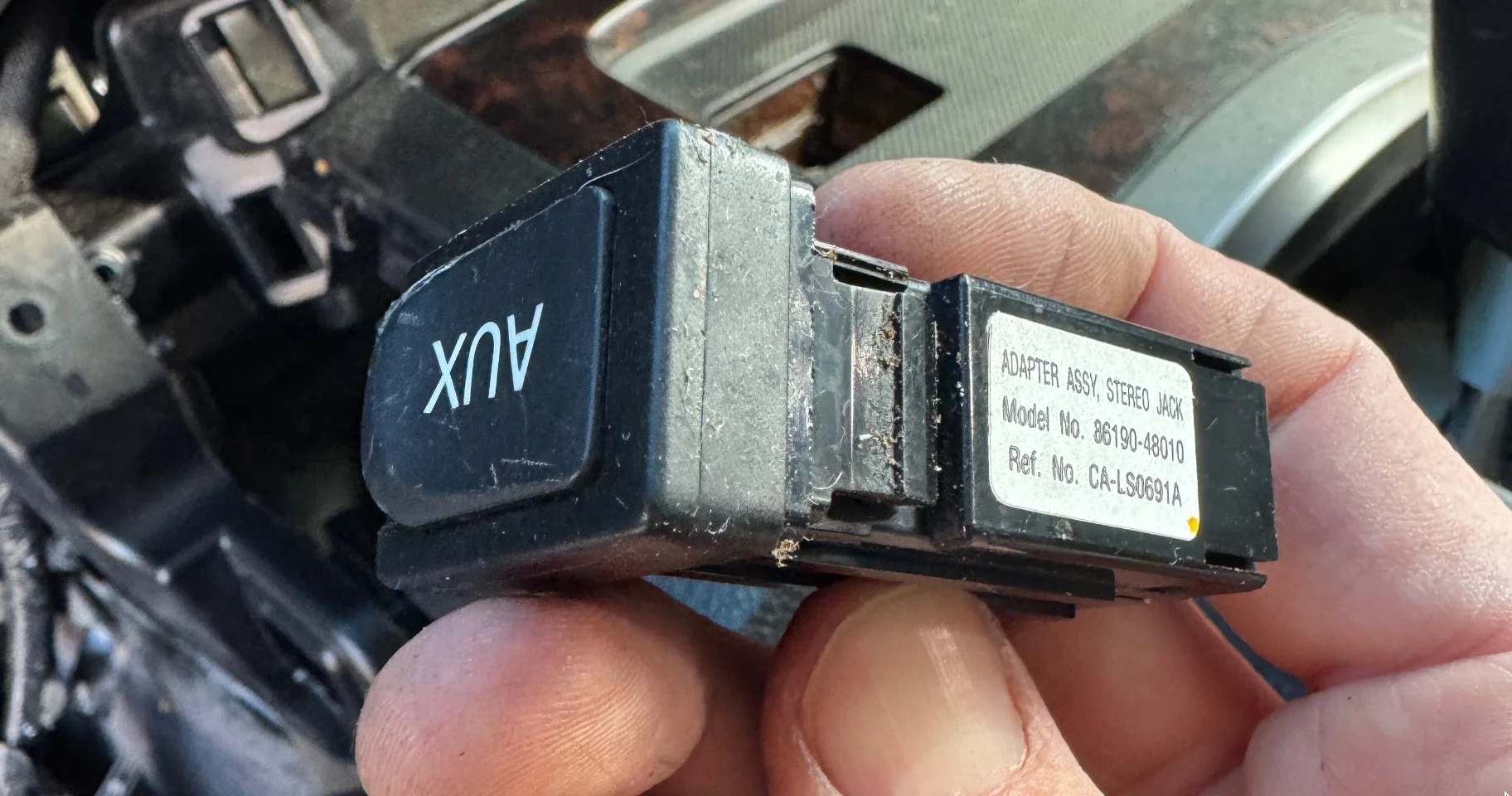

I've got a new to me 200 series 2009 Land Cruiser, when I push the DISC AUX button, regardless of how many times I push the button, it stays on DVD. My cruiser has rear entertainment DVD screen. I was reading that the Aux Input itself can sometimes fail and then won't be detected and cause this to happen. Today I replaced the aux input with the same part but new, still nothing.
