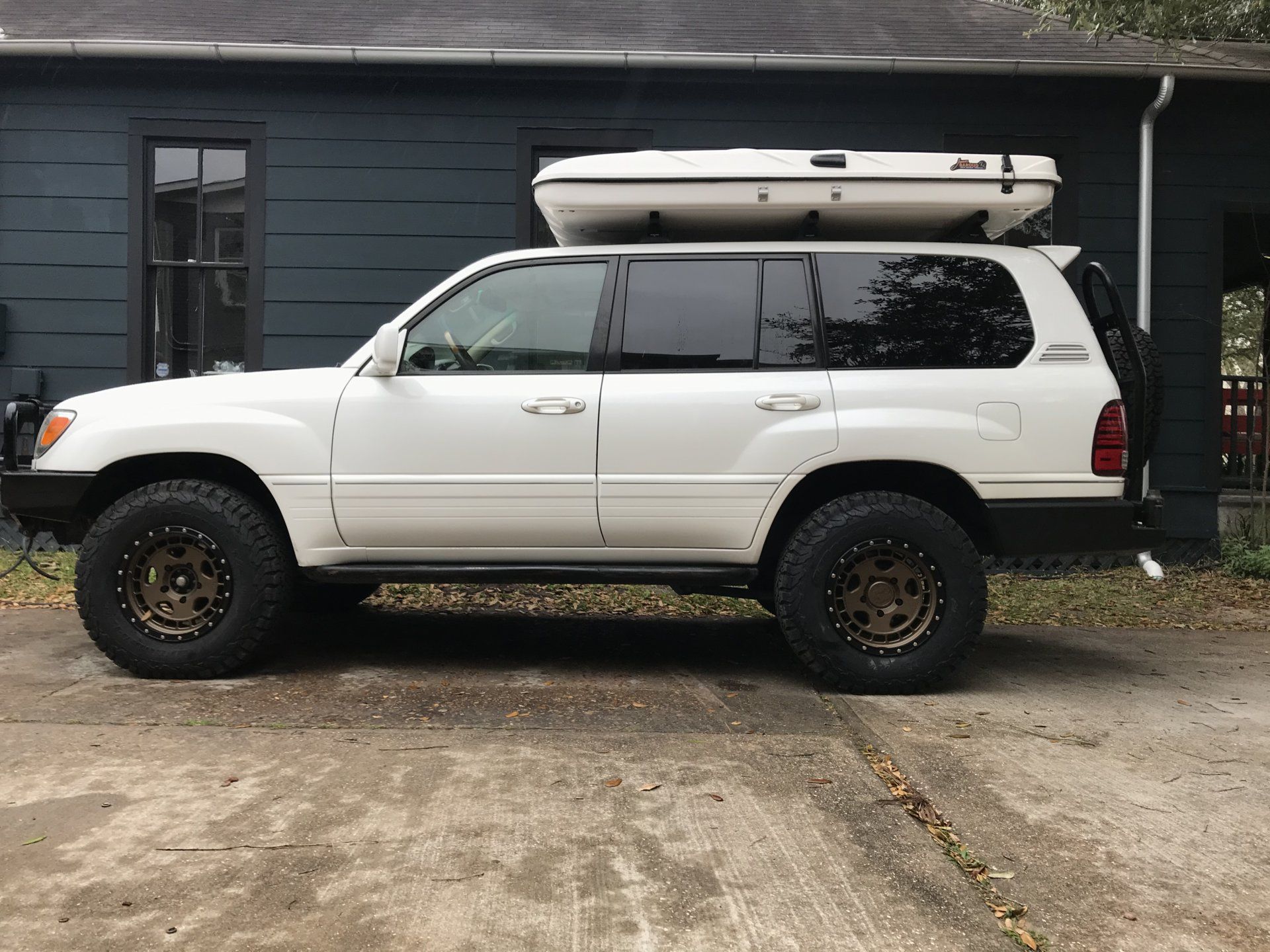

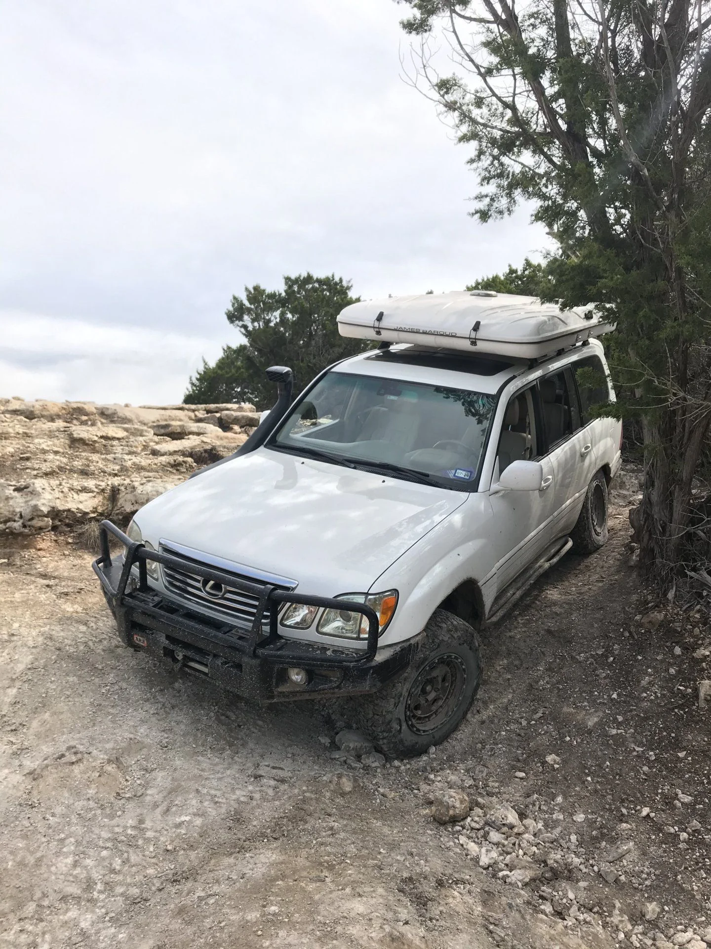

Fifteen52 17s zero offset on 33s
No spacer, hammered the pinch weld is all. No rubbing.
