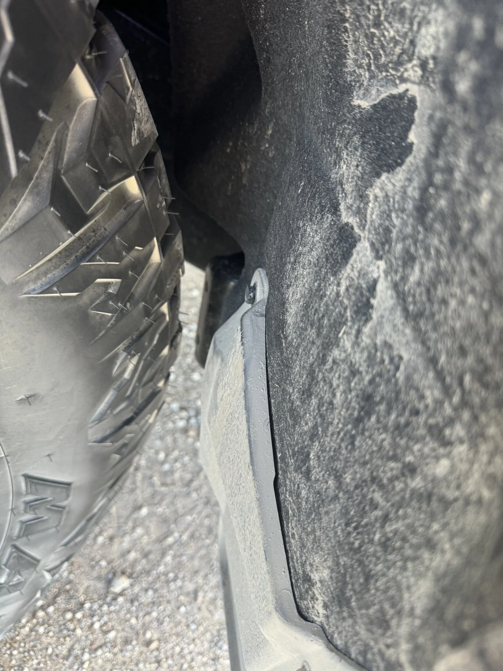

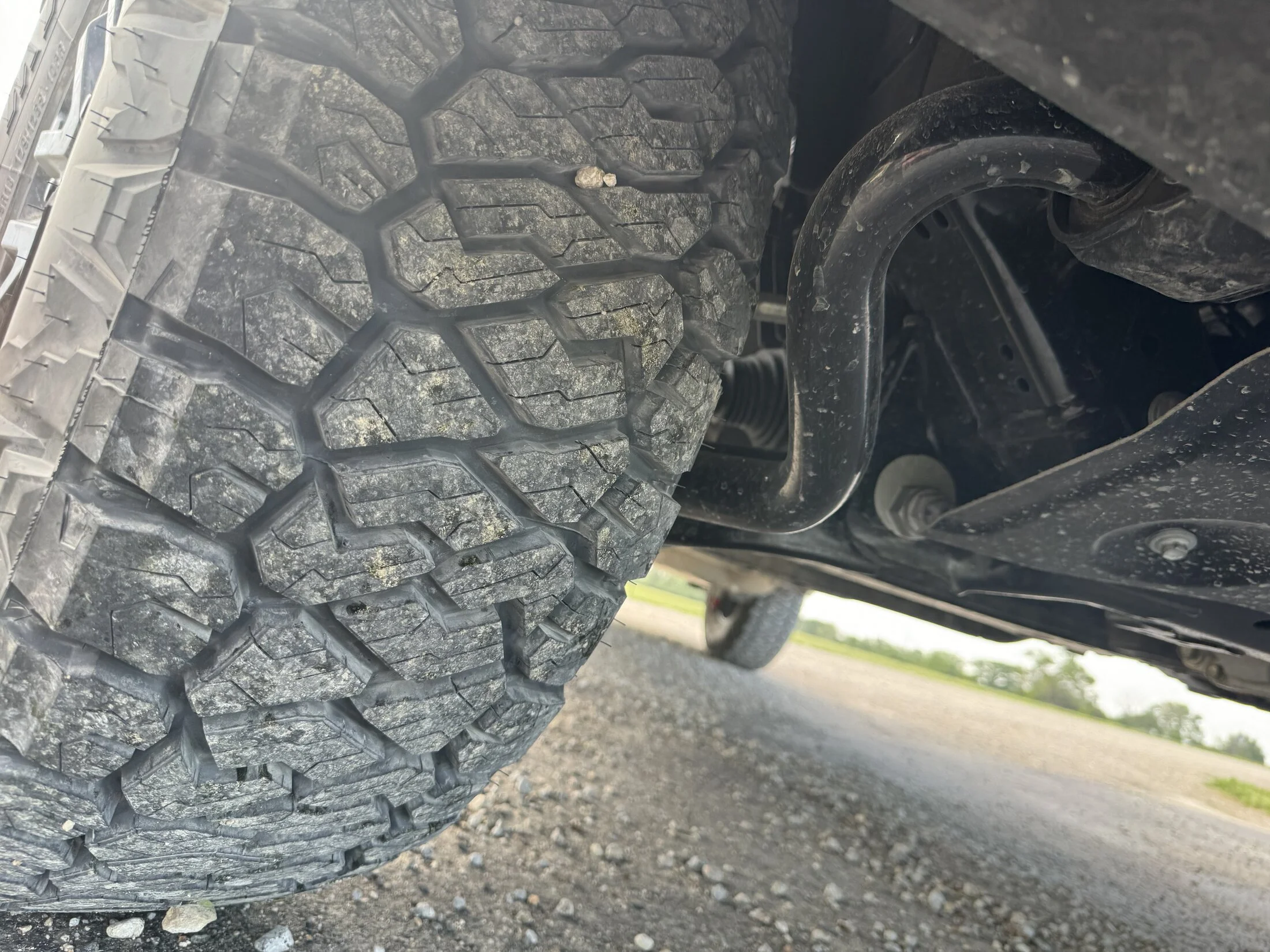

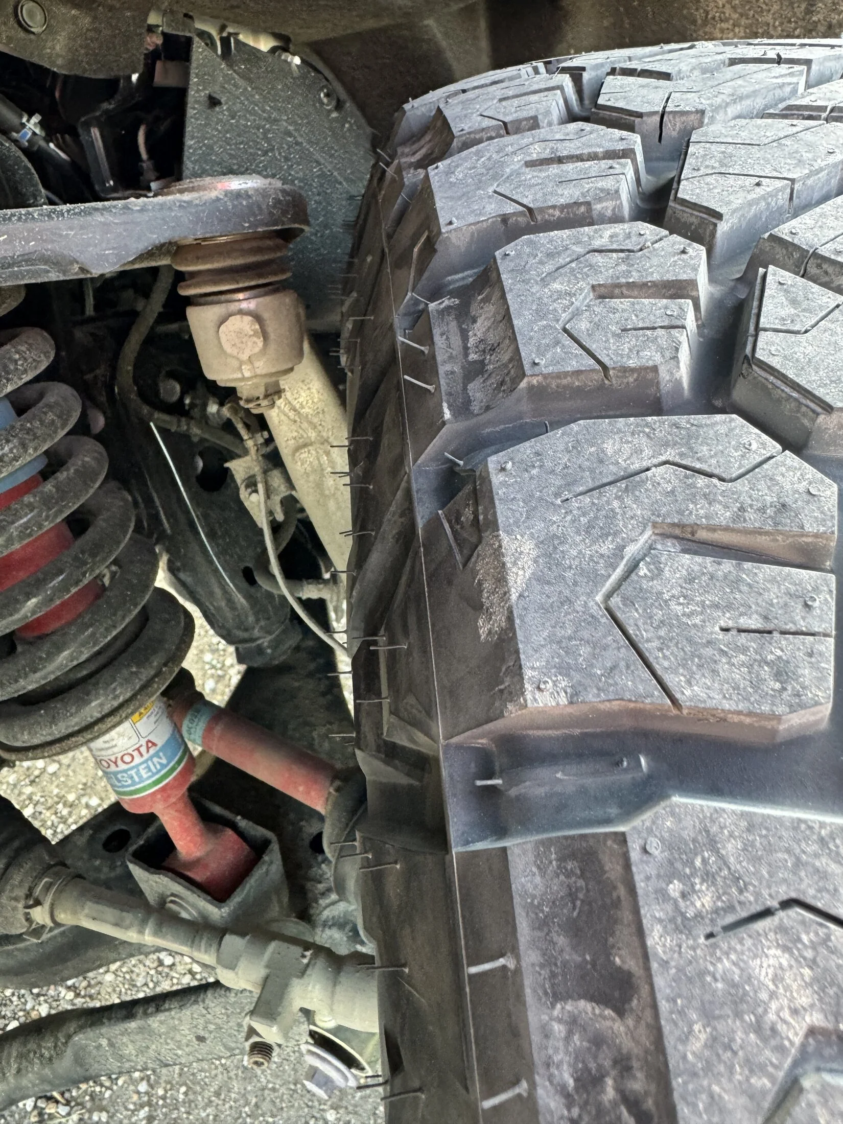

Just got a flat and was going to replace the tires down the road anyway. The vehicle is a completely stock Trd off road 18” wheel. Has anyone run the 285/75r18 with no rubbing on or off road on the 3rd gen? I would want to ensure the spare tire would fit as well.
FYI if people search in the future. Bone stock Trd off road for 18” wheel offset and no lift etc. fits with plenty of room on street and what compression I have tried/is easily done right now. This is with a Maxxis AT so fairly aggressive all terrain in terms of true to size and side wall lugs. Pictures are worst case on flat ground. Roughly an inch to uca and about 2” to tire safety bar thing in rear. Sway bar full lock around 1-1.5”. Spare tire is quite tight though most likely ok with 20psi and angling/pulling towards tow hitch.
