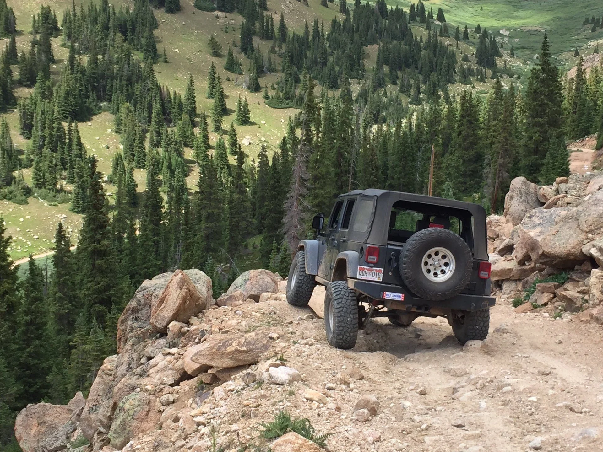

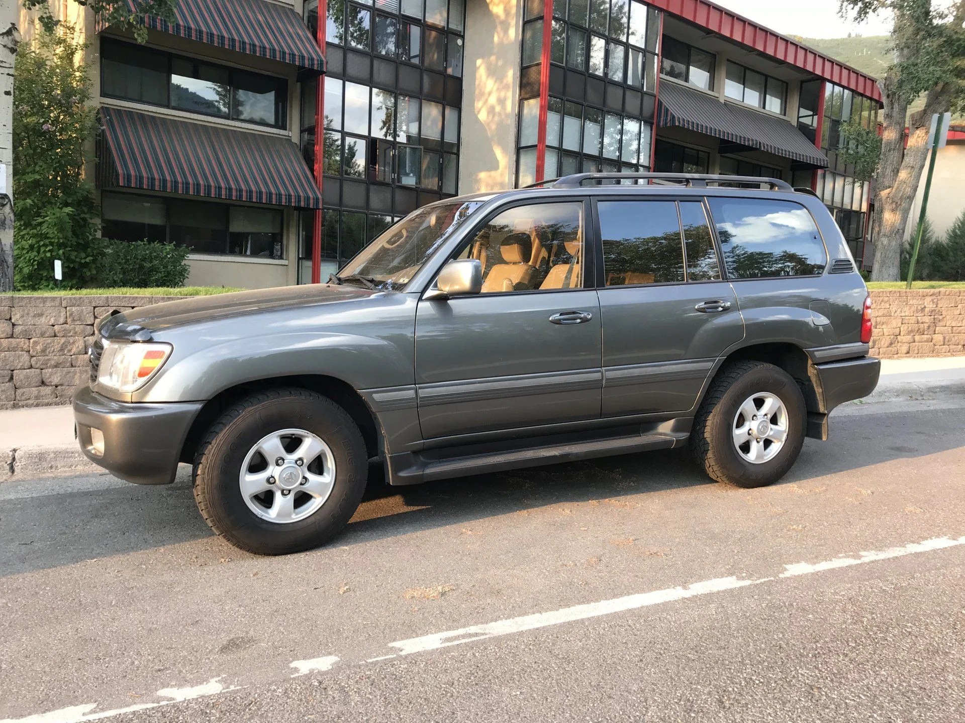

I’m new to the LC100 family after having a ‘98 Montero on 31s with a rear locker, a ‘97 TJ on 33s, and an ‘08 JKUR on 35s.
I bought in from the original owner with 220k miles. I'm not at all concerned about the mileage. I've already done a full t-belt job and all transmission/t-case/diff fluids.
The '08 JKUR was awesome off-road but suffered from December through April when we're buried in snow. Those huge, wide tires aren't great when you're trying to get around town in a blizzard.
The LC should be able to take me on some of the "easier" roads while still offering a good platform for a winter mountain car.
I’ve read a lot of the threads on here about some people loving and some people hating the OME 2.5 inch lift.
I won’t be adding any heavy bumpers, but I am looking for a little extra clearance for the 255/85/16 Cooper ST Maxx tires that I just added.
Based on some of the negative info that I’ve read, I was leaning toward Tough Dog or Iron Man lift kits.
Has anyone had any negative experiences with either brand?
I’ll be installing myself as I’ve done a body lift and susepension lift on my buddy’s TJ and I’ve done a suspension lift on an ‘01 WJ that I just got rid of.
I was thinking of a lift kit from one of those manufacturers and buying a diff drop separately.
I’m at 8000 feet in Colorado and know that I have Slee and Bior about 3 hours away.
Thanks for listening.
