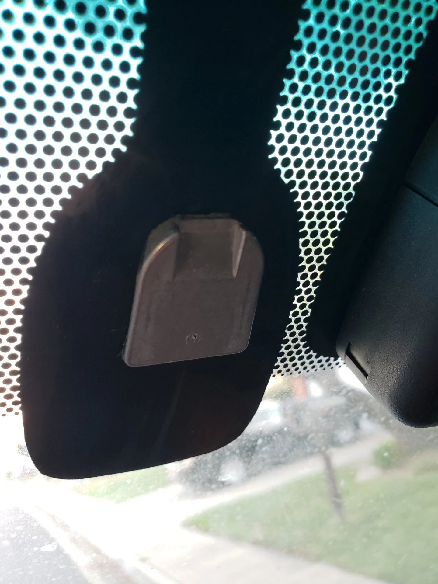

Stepped off a week long cruise ship in Long Beach. Apparently it was pretty hot while I was away. Anyone been down this path that can offer tips?

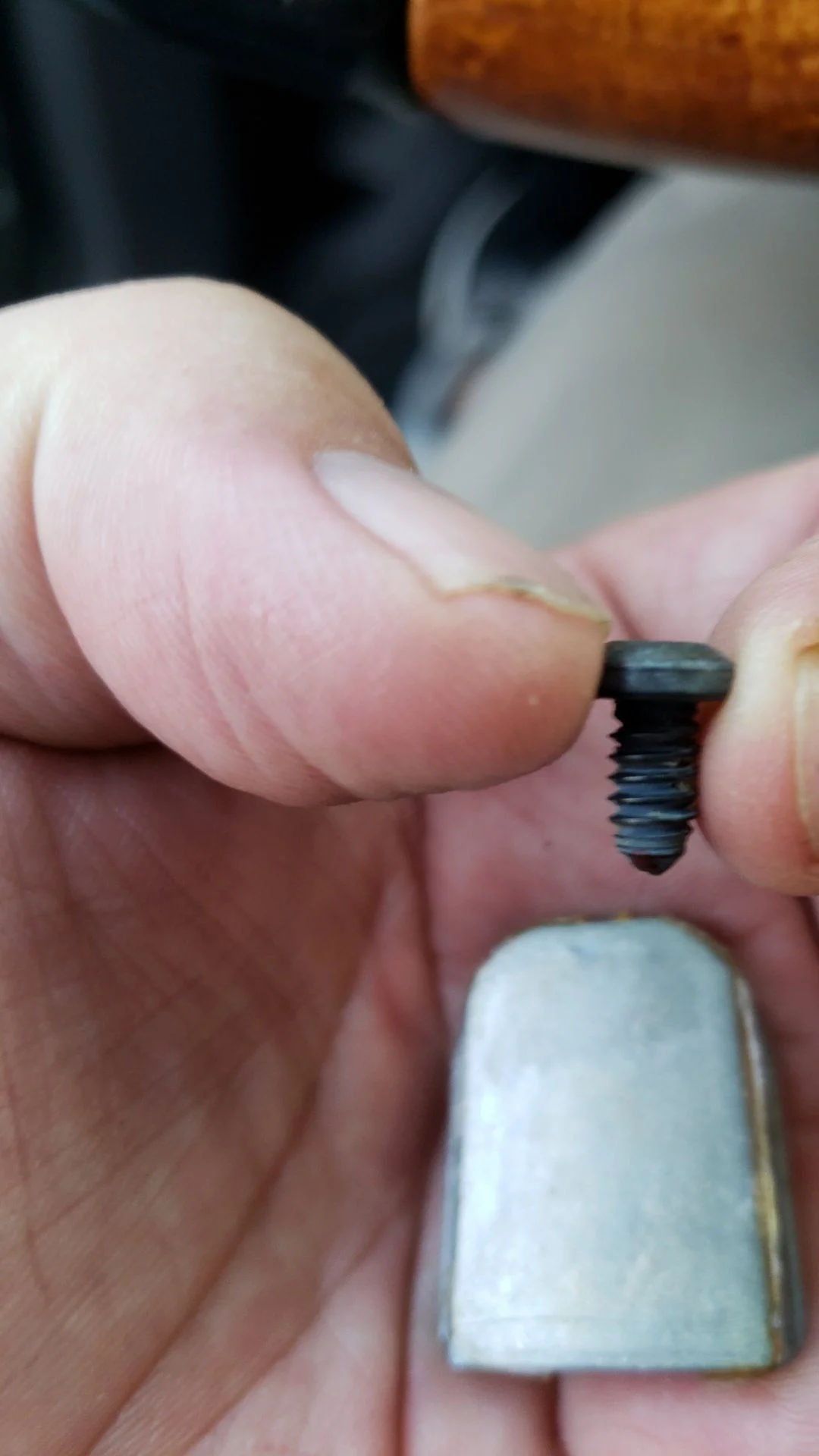

Well you have to remove the mirror button by unscrewing a torx #20 on the bottom of the mirror.

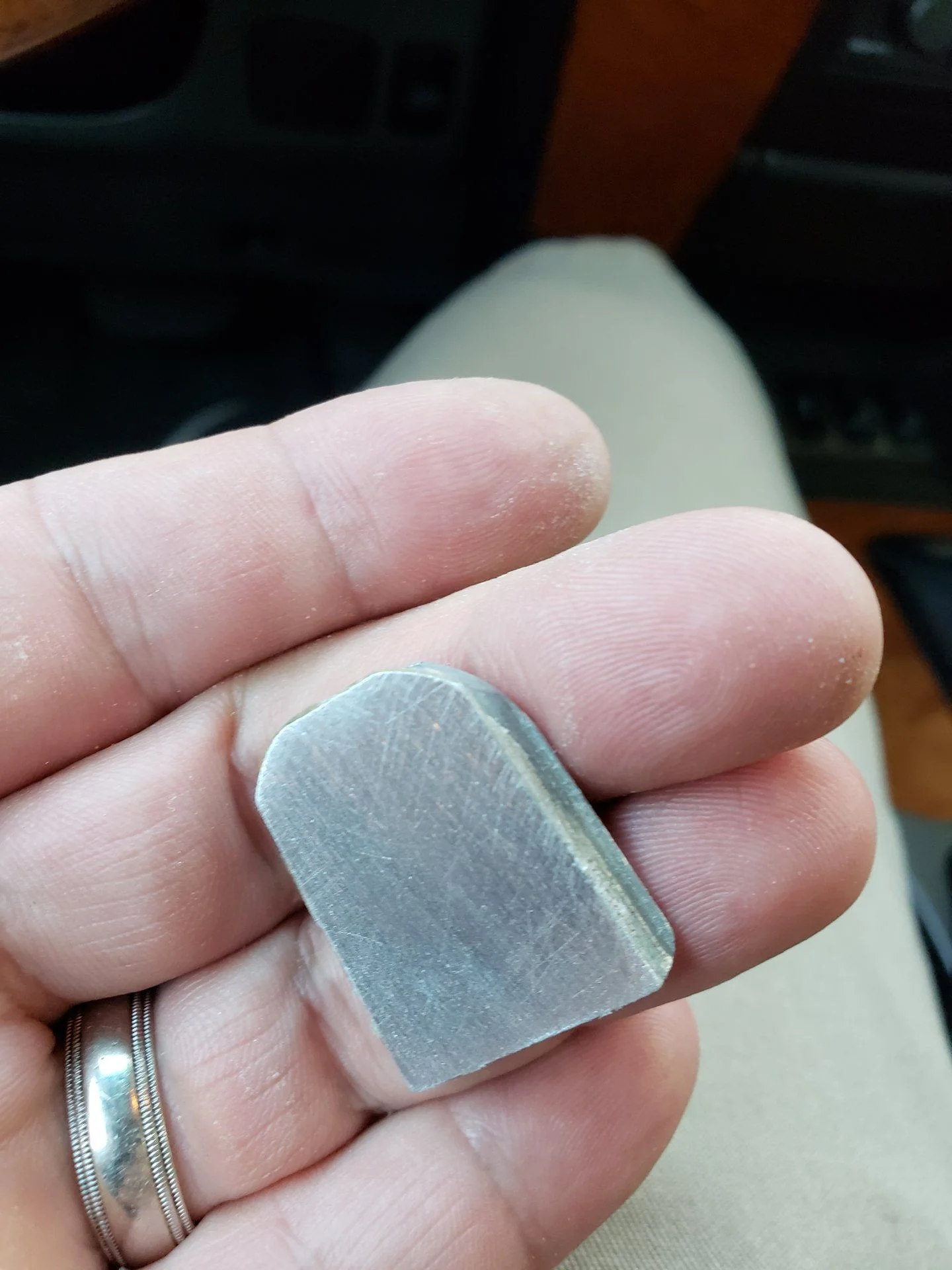

Sand off the old adhesive from the button with 120 grit...

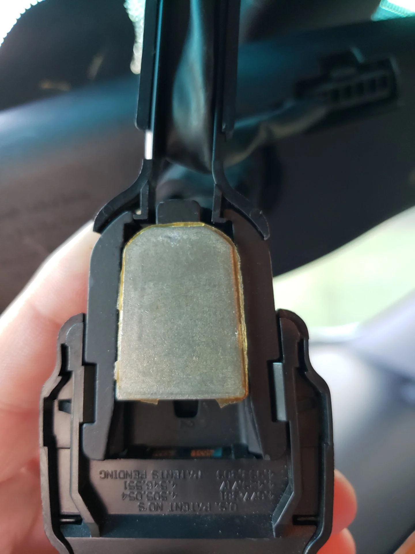

Don't use a razor blade on the inside of the windshield as the black stuff is plastic. I scraped the adhesive with my fingernail and hit it a bit with sandpaper. Clean everything with rubbing alcohol. Glue the button on bevel edge up and let cure overnight...
Don't use a razor blade on the inside of the windshield as the black stuff is plastic. I scraped the adhesive with my fingernail and hit it a bit with sandpaper. Clean everything with rubbing alcohol. Glue the button on bevel edge up and let cure overnight...View attachment 1746807

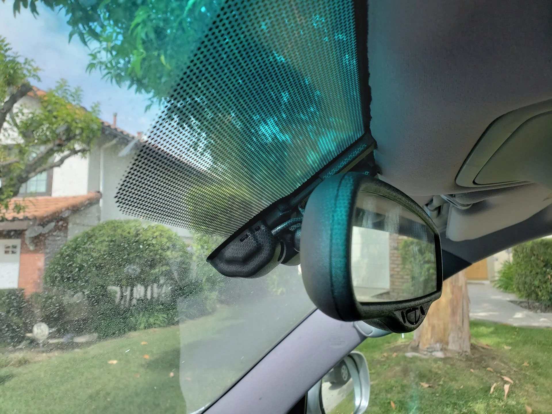

Reattached this morning...all is good again in the GX470 world.
