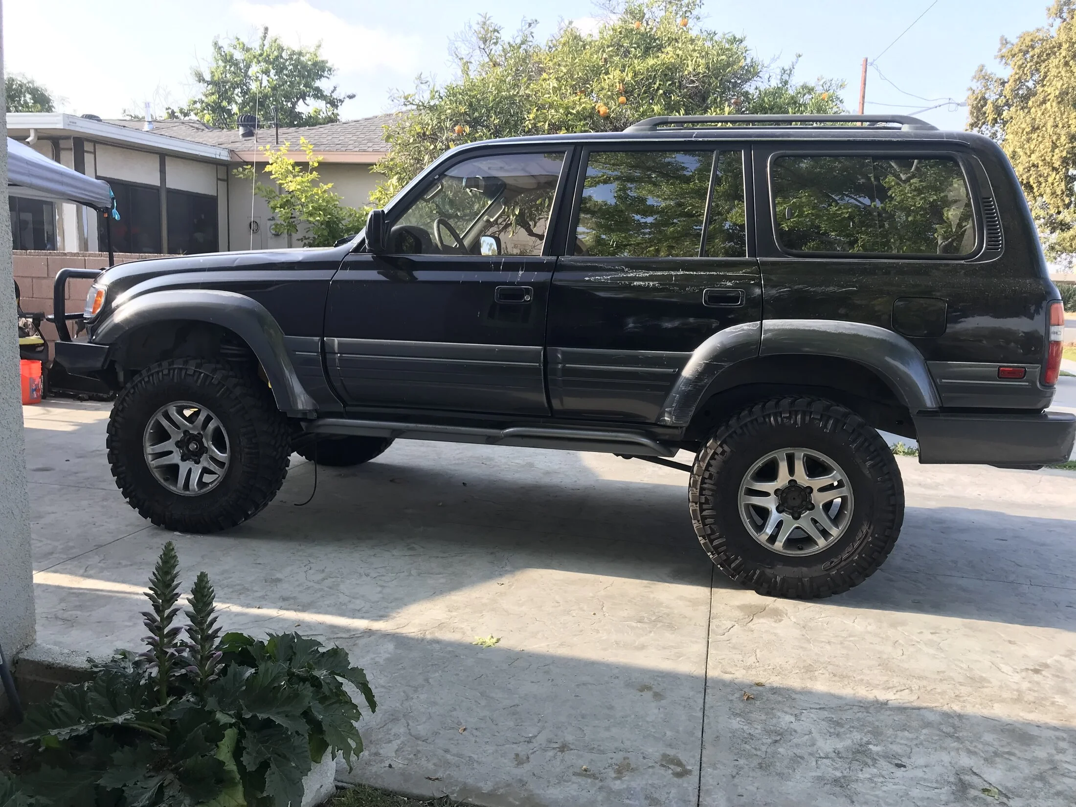

Just wondering if anyone is running 37x11.50r17. I think nitto ridge grappler is the only tire with this size. Anyone have personal experience? Any significant difference with 37x12.50r17? Im trying to see if i can run it with 17x8 -20 rims without much modifications like body lifts and moving the front axle forward.

35x11.5r17. I’ve got a 4” Slee lift, no rubbing.
Running them on the 5-spoke Sequioa 17” wheels.
I am also running them with Slee’s 1.5” SpyderTrac wheel spacers.
With the wheel spacers, it brings the track width back to stock specs.

I believe you mean the Nitto Recon Grappler, as thats the only 37x11.5r17 they make. If anything it would probably require less massaging to get to work, less frame rub and potentially a better profile if your using narrow rims like the tundra 5-spokes. too bad they aren't severe snow rated...

Yes you are correct. Those are all my reasons too why I want that size. Snow rating is another issue too. Just want to see if anyone has experience with that set up.
