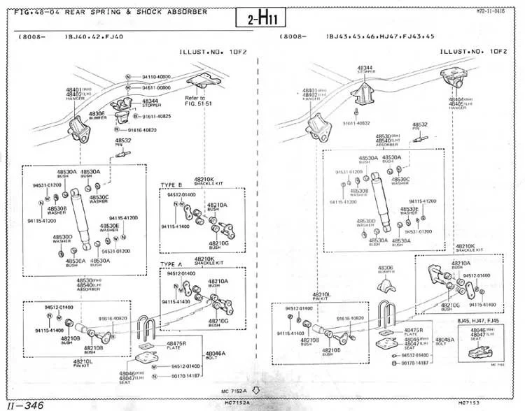

Hello all. I'm thinking about some anti-inversion shackles for my 40. I have a guy that does spring rearching, and has done two 60 series for me with good results. I will have him rearch them with a lift to gain 2-3" then I'd like to do anti-inversions with a bit of a lift as well. So my question is does anybody have any blueprints of anti-inversion shackles that they wish to share.

Anyways, no blueprint, but here's pics of 2 types of Toyota anti-inversion shackles that look simple enough to make from scratch or from your existing shackles if you have a good welder who knows what he's doing.
