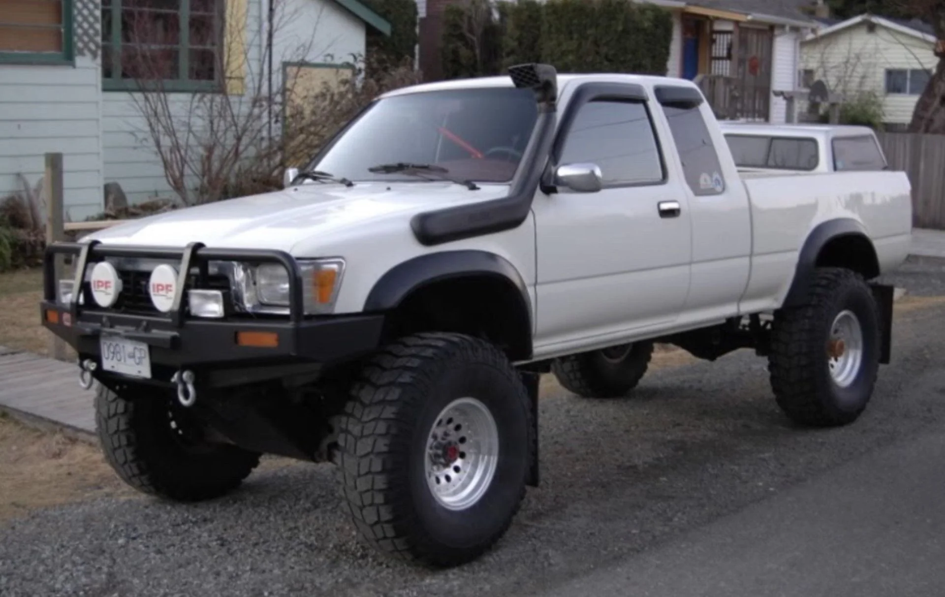

5.29s and 35s on mine below with 22RE and W56. It was a good set up. I live in mountain country too.
