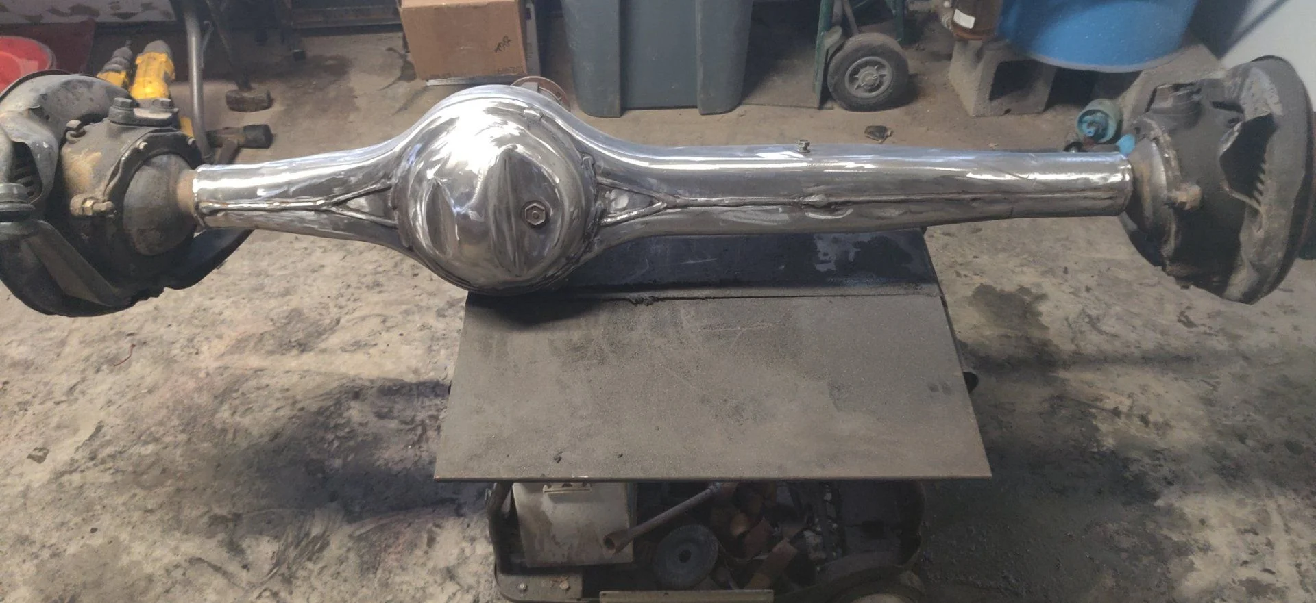

can do! Here's a pick of what I got done this weekend, got all the coilspring mounts cut off and got the houseing prepped for trusses. Working on doing the same to the rear axle now. Should I look into getting new axle shafts? I haven't gotten to "dig into" the actual housing yet but assuming they are in good shape should I just run em?
Sounds can do! Here's a pick of what I got done this weekend, got all the coilspring mounts cut off and got the houseing prepped for trusses. Working on doing the same to the rear axle now. Should I look into getting new axle shafts? I haven't gotten to "dig into" the actual housing yet but assuming they are in good shape should I just run em?
I wouldn't get new shafts if the ones in there are in good shape - I have an 80 on 37s with a stock front end. I don't wheel it like a buggy, but I certainly don't baby it. The stock birfields are pretty stout.
80s are full time fwd though so the front birfields and shafts CAN wear out depending on how they were maintained and how many miles are on them. Make sure the sealing surface on the inner shaft doesn't have a groove in it from the seal. If it does you can over/underdrive the seal in the housing so it rides on a fresh part of the sealing surface. Disassemble the birfields and check the star and the bell for wear. I would also swap the birfields side to side.
