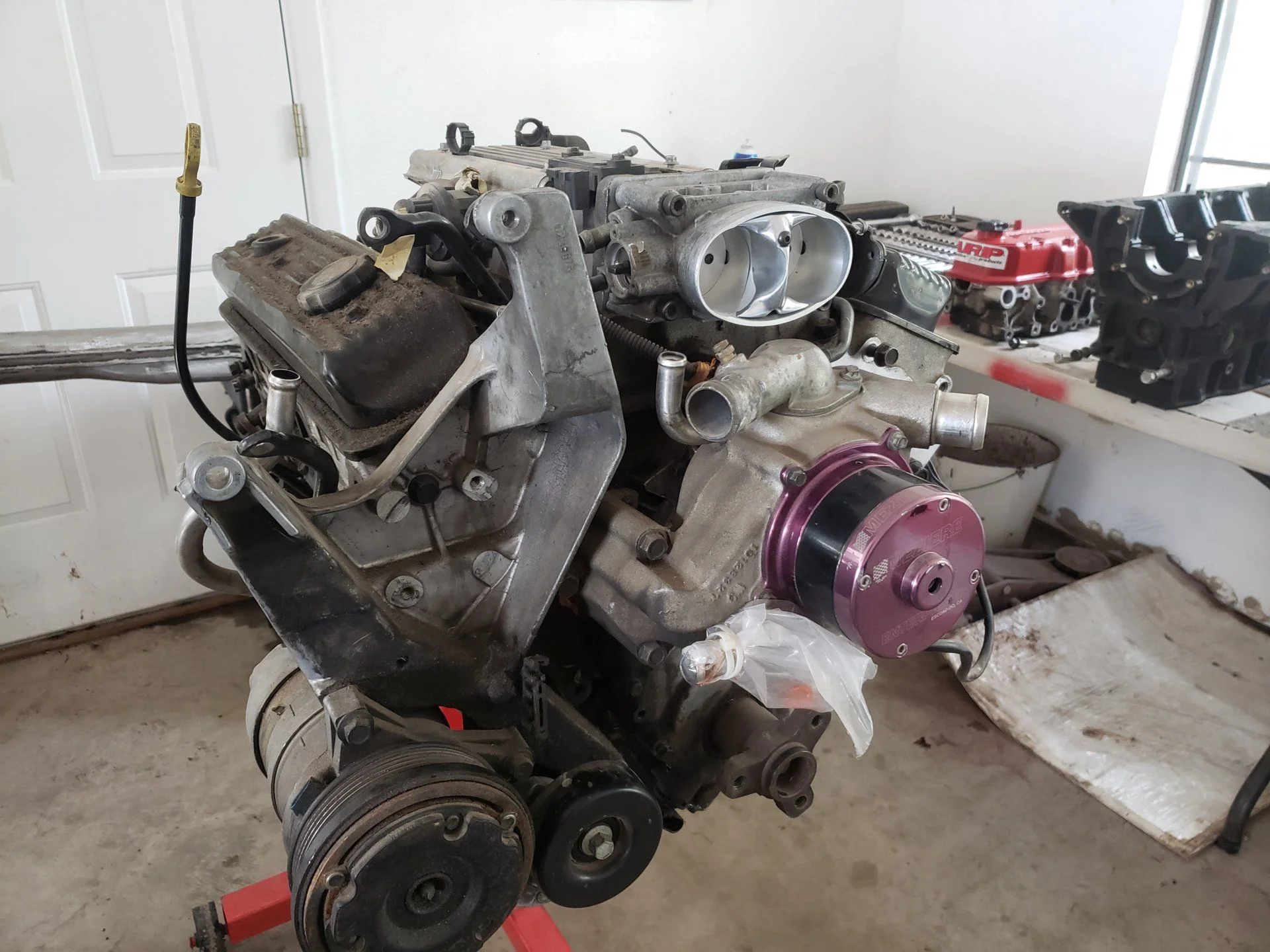

Here's a pic of the LT1 motor, I have already started pulling it down, it only had 20,000 miles on it but I figured I might as well put new piston rings, seals and gaskets while its its out

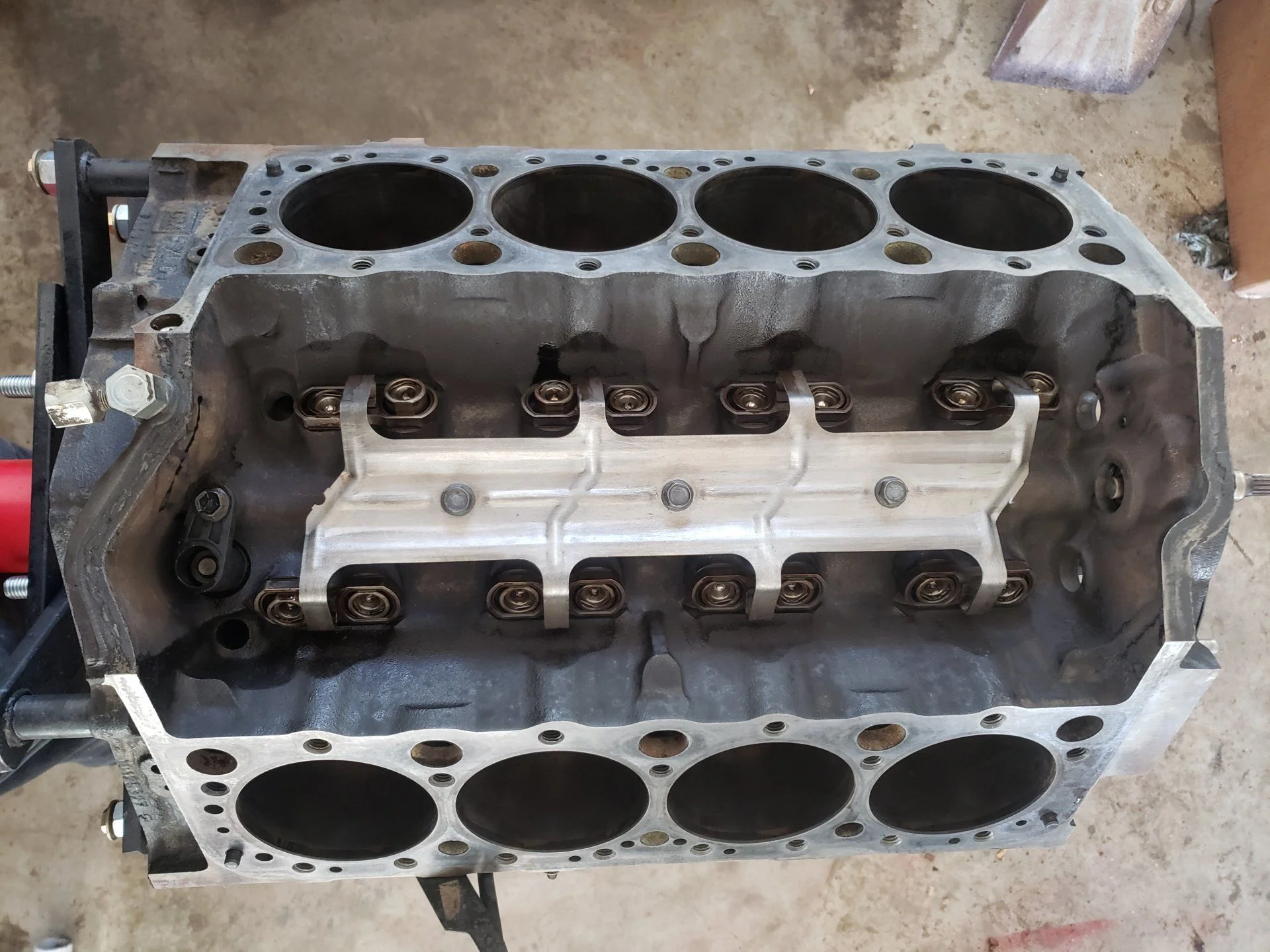

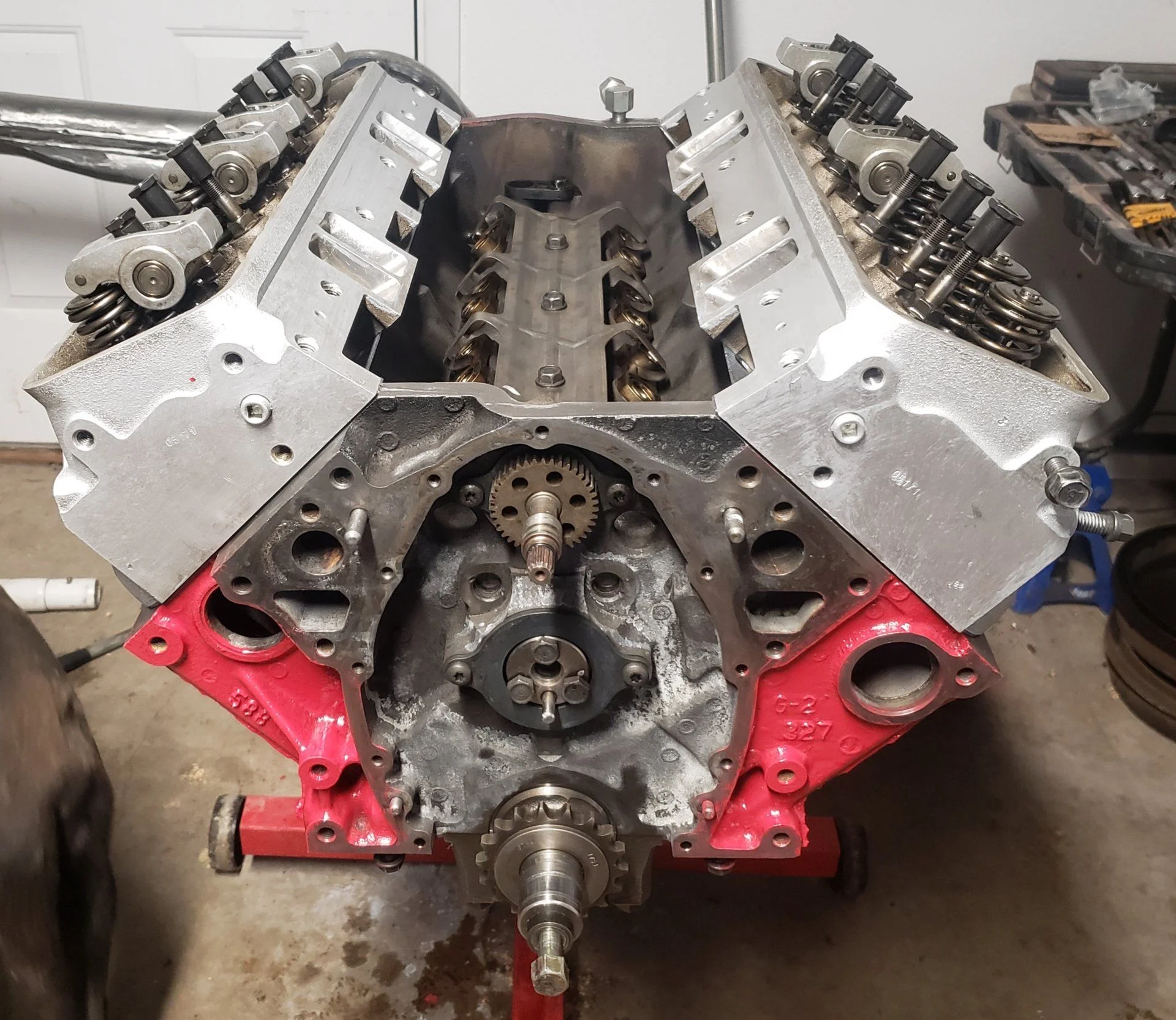

100% pulled down and cleaned, I'll be re- assembling this week with all new internals and painting the block. I contacted Monster Transmissions and they are building me a 4l60E that should be here in a few weeks. Rough stuff also finally sent me a email saying my highsteer kit will be on it's way. My Dana 300 will be here Tuesday as well so I'll have pics up on the Twin stick conversion. FINALLY GETTING THE BALL ROLLING!!!
Also tossed in a High performance camshaft just for a little extra bump in power, excited to see the difference between a 115hp 22re Toyota engine to a 380hp Corvette motor haha!!

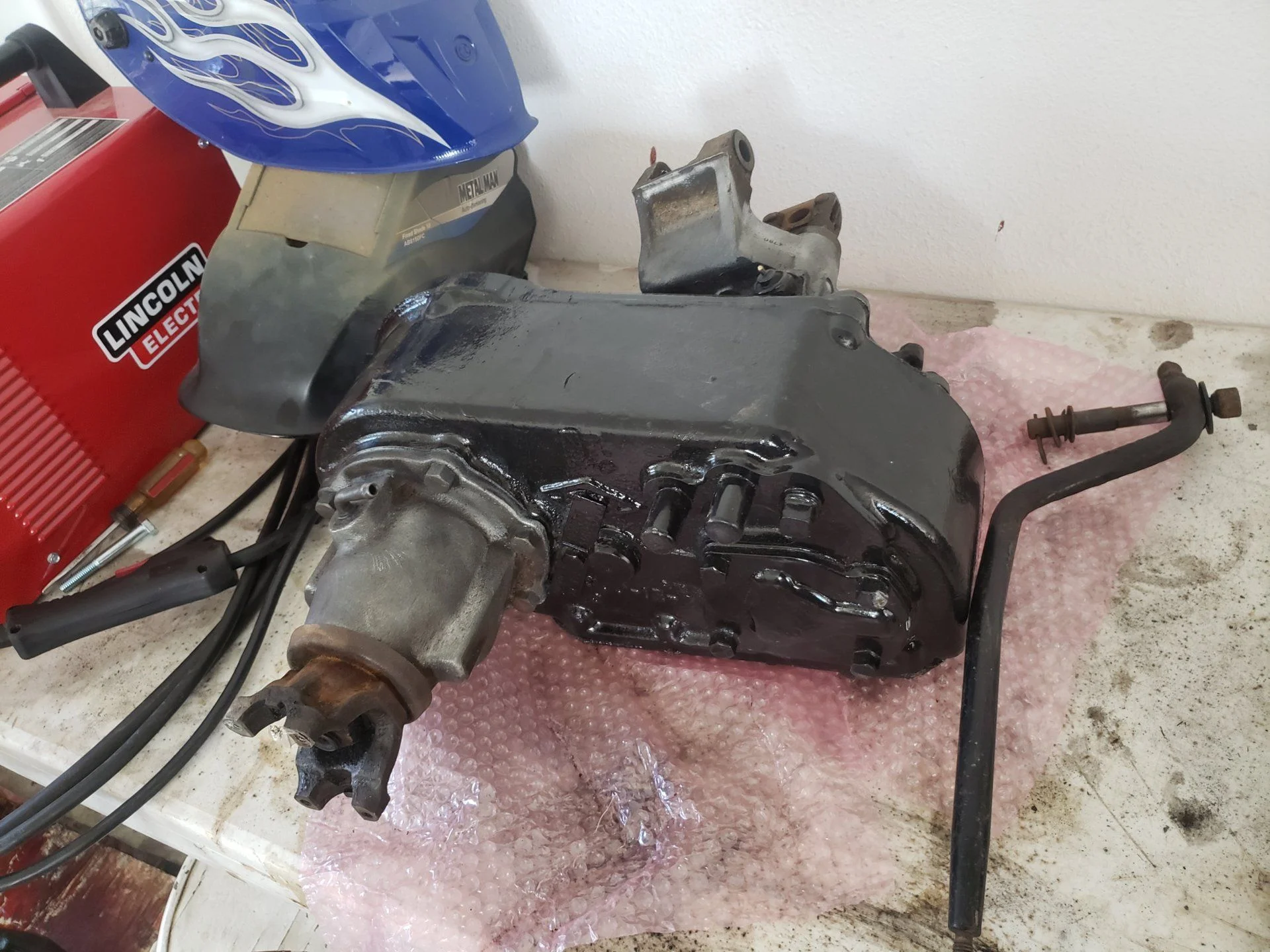

The Reason why I went with a Dana 300 is because It was the most cost friendly and Strong T-case I could come up with. I could not find a Toyota T-case that would be strong enough for what I will be doing (other than a Atlas for $2,000!) I was contemplating a RF1-A however behind a 350hp+ motor that would have definitely been the weak point. As for the drive shafts having to be custom made I was already heading that way being that I am putting a FJ80 rear axle in, I was going to try to use the original drive shaft in the rear but it was looking like it just wasn't going to happen with out some sort of modifications
Those in the FJ60 were custom too, but in length only. I went out of my way to keep the superior Toyota U-J's and companion flanges with my V8 conversion. Perhaps if Jesse has HAD back up and running he can supply flanges for the D300.

I know nothing about those in particular, but I do have some experience with the t/c's behind the 3.0L. There are two versions of it and only one can be replaced with an RF1 assuming you have the adapter. The other, of course the one that I have, is too integrated into the trans to be replaceable with anything except another like t/c.
Then there's the issue of an adapter. Marlin seems to stay within the Mini-truck relm and doesn't seem to offer much for the bigger trucks. No idea what AA offers, but it seems unlikely. Novak Adapters appear to focus on domestic brands only. Maybe Marks out of OZ?
The D300 isn't a bad t/c, has a decent 2.6:1 low range though it is an old design and shifting it may be wonky - no experience there. There are better options - regardless of how you define "better", but most all at a bigger price. I believe there are doublers made for them and I know that there's 4:1 gear set out there for them.

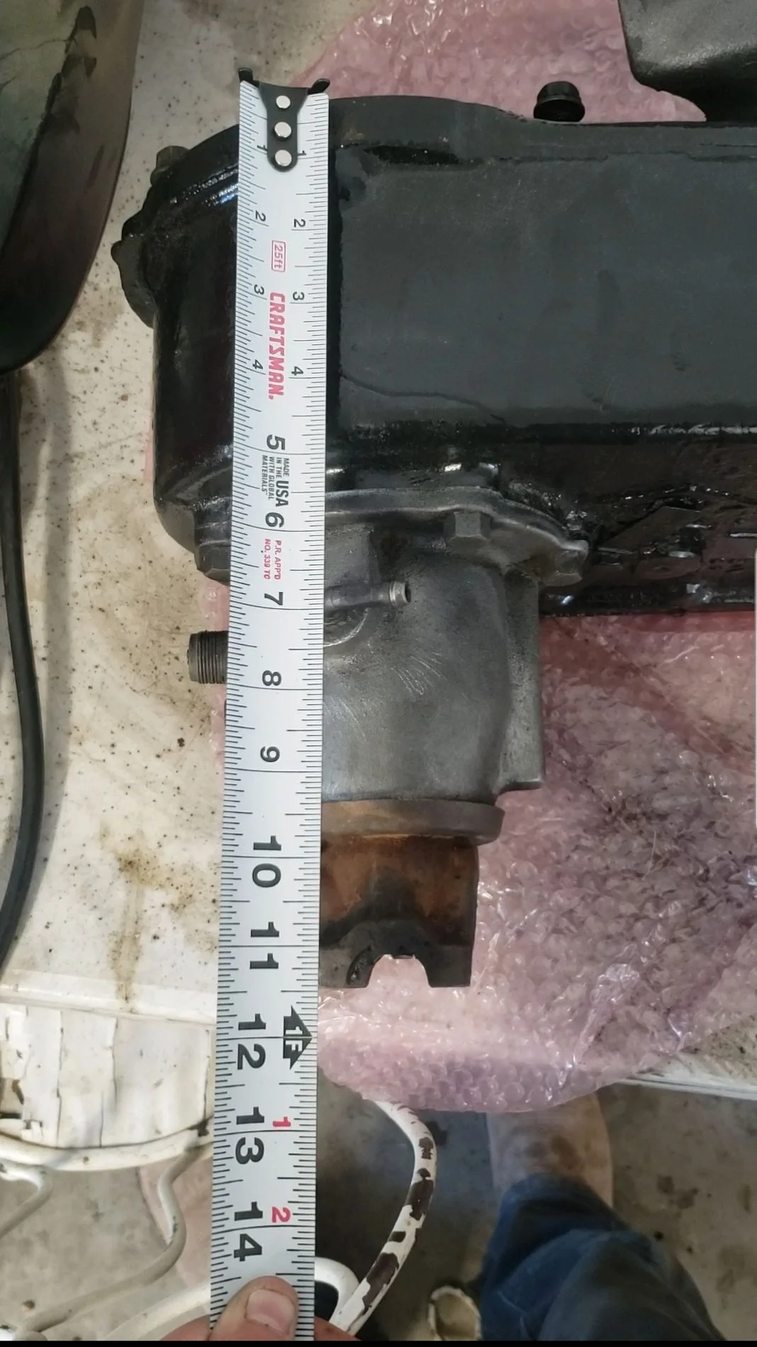

Well my Dana 300 just arrived, I am under the impression that there are 2 different styles, one being slightly longer than the other. From what I have read it says to measure from the front input face to the rear yoke face. Just wanted to be a 100% sure so i posted a pick what you all think Is this the big one or smaller one?
