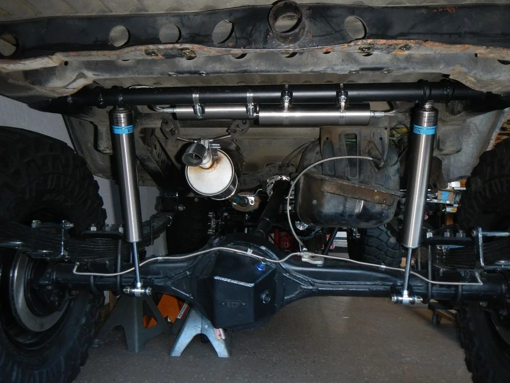

I flipped a FF LX450 axle in the rear of my '87 4Runner. It works fine. Cut off old diff cover, weld on beefy replacement in correct orientation.
Looks great, I was thinking about fliping mine upside down but I was worried about lubrication issues, figured spinning it 180 would be the best thing to do, as stated above I also thought about cutting down a Full floater 80 but the whole reason why I'm swapping the rear axle is so I do not need to run spacers to match the front so that would make my swap pointless.
