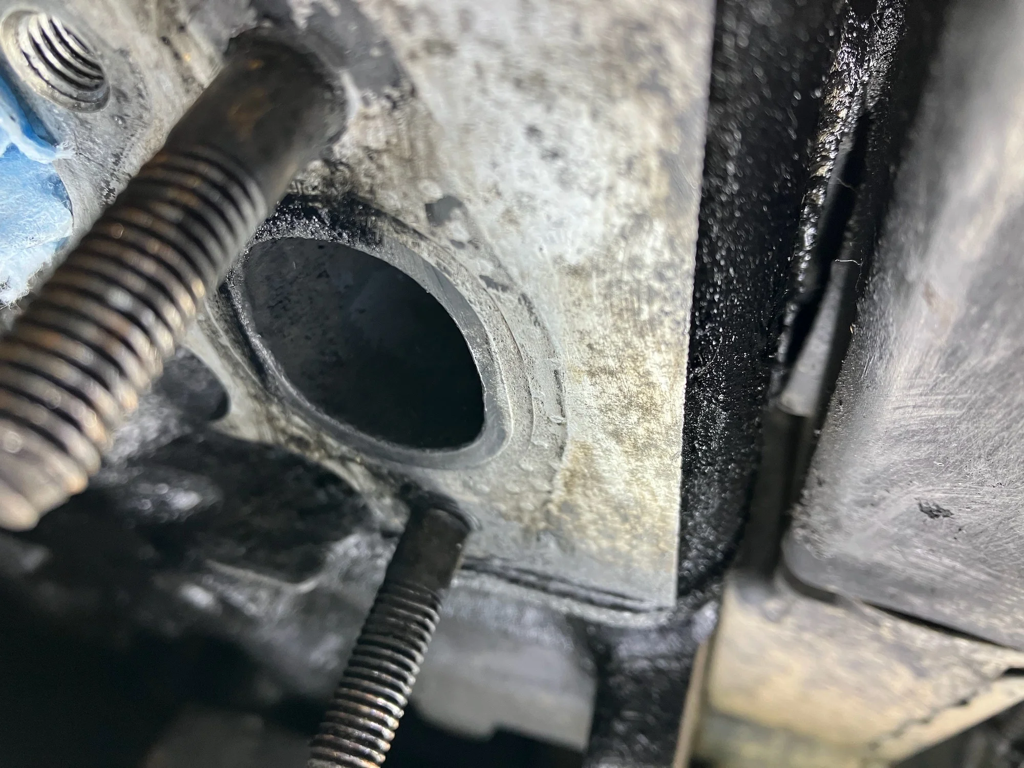

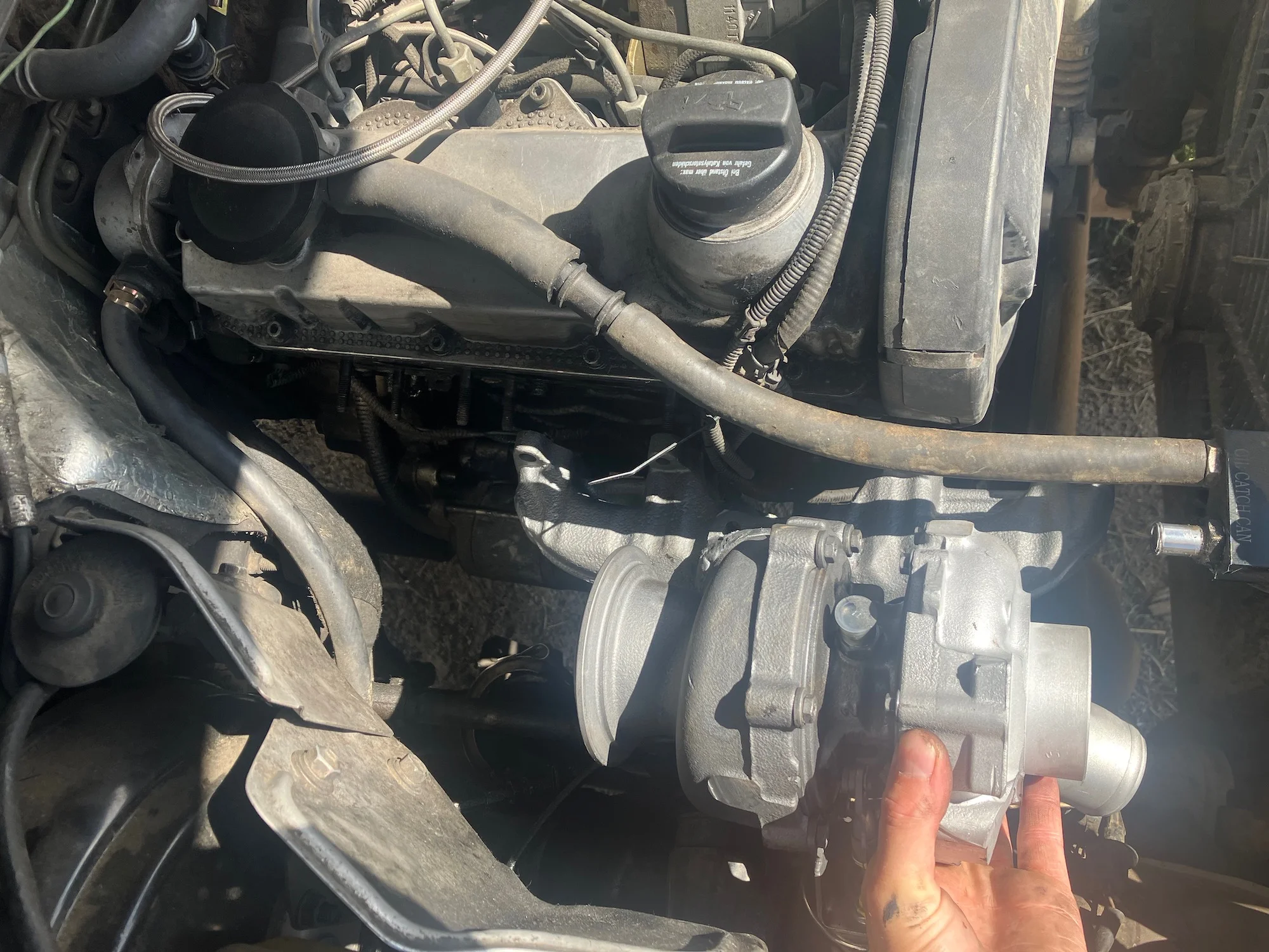

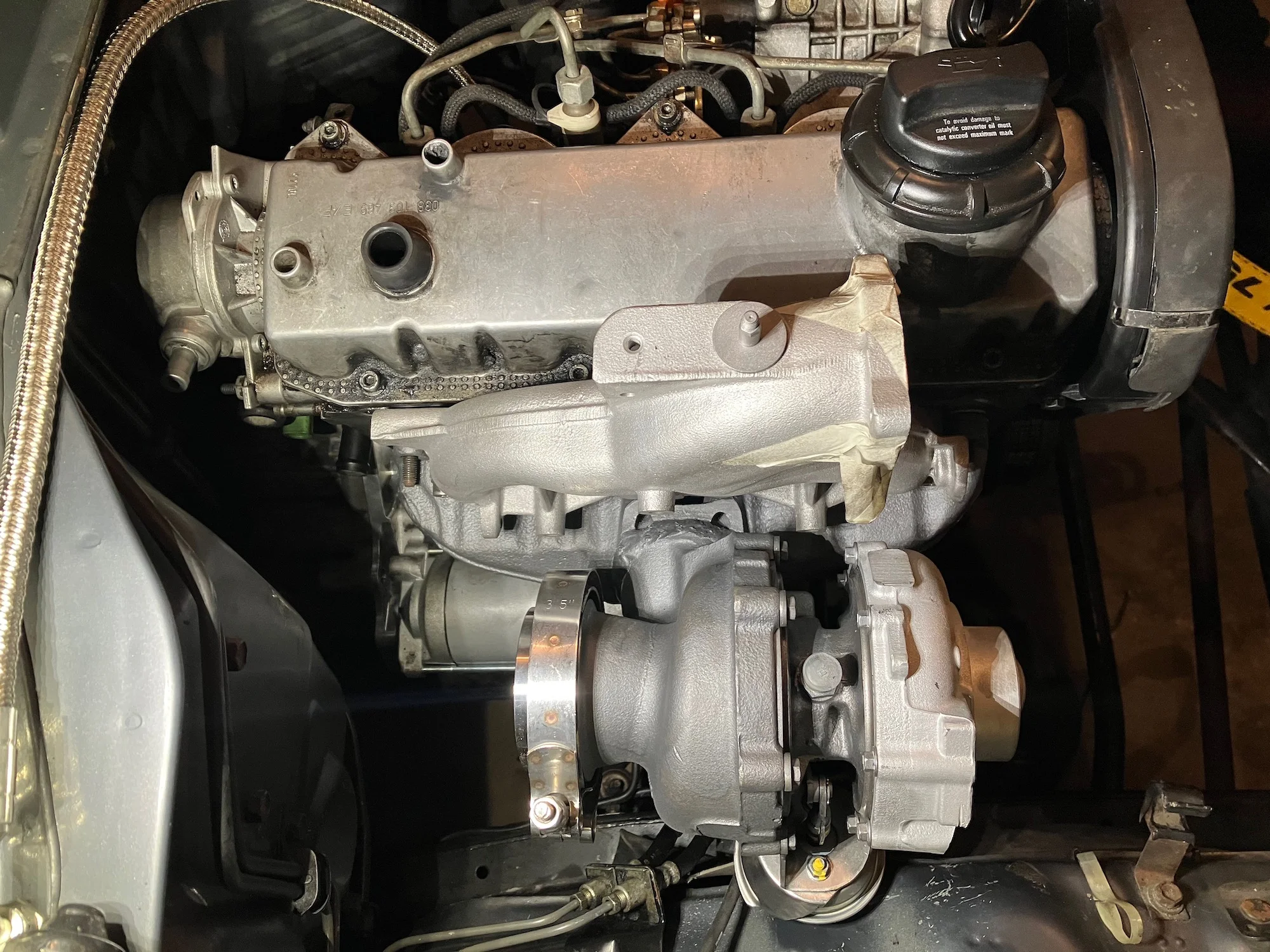

Spent a little time playing around with various manifolds and positioning for the turbo, at first I thought I might be better off using the 1Y manifold but that pushes the turbo too far away from the engine (runs into the clutch and brake MC heat shield). The JX manifold puts the compressor inlet quite far forward, but I think it will still be workable with a custom air filter box. I won't be able to weld the turbo directly to the manifold since it would sit too low and the actuator would run into the inner fender, so its back to Plan A: weld on a stainless v-band flange and make a short riser/adapter from the manifold.
It will still be a bit tight getting a 3" downpipe off there, but it's way better than before. I'll have to get an extension on the oil drain line, since it is too short to reach the drain port in the block now.

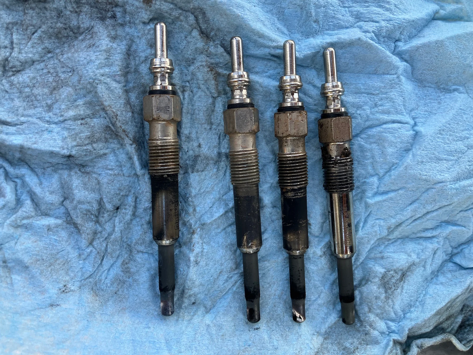

I pulled the glow plugs just to see what they looked like, nothing unusual to my eye:

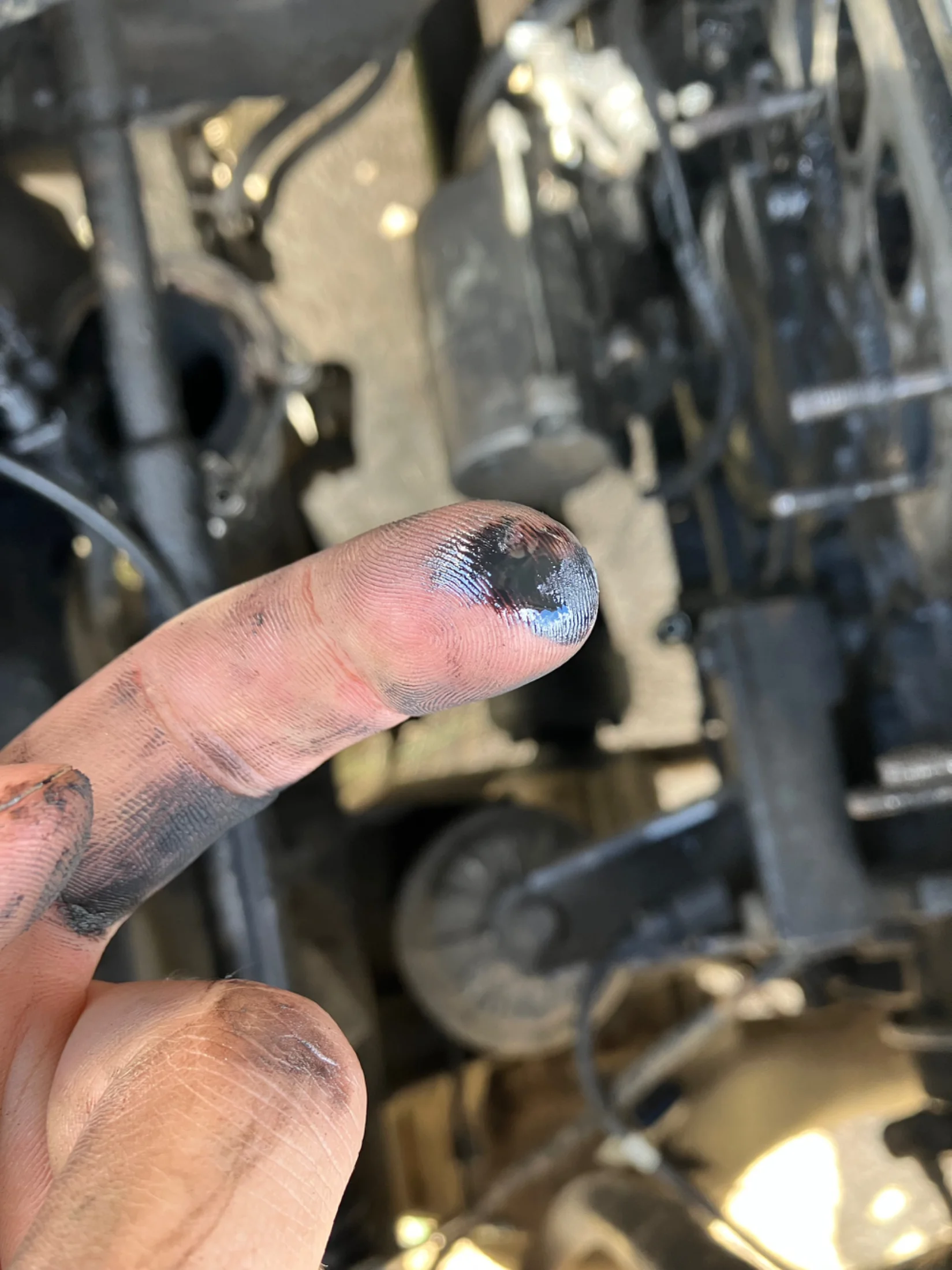

Reaching up the exhaust ports with a finger I can feel the oil on each exhaust valve stem, this is what I get just touching each valve stem:

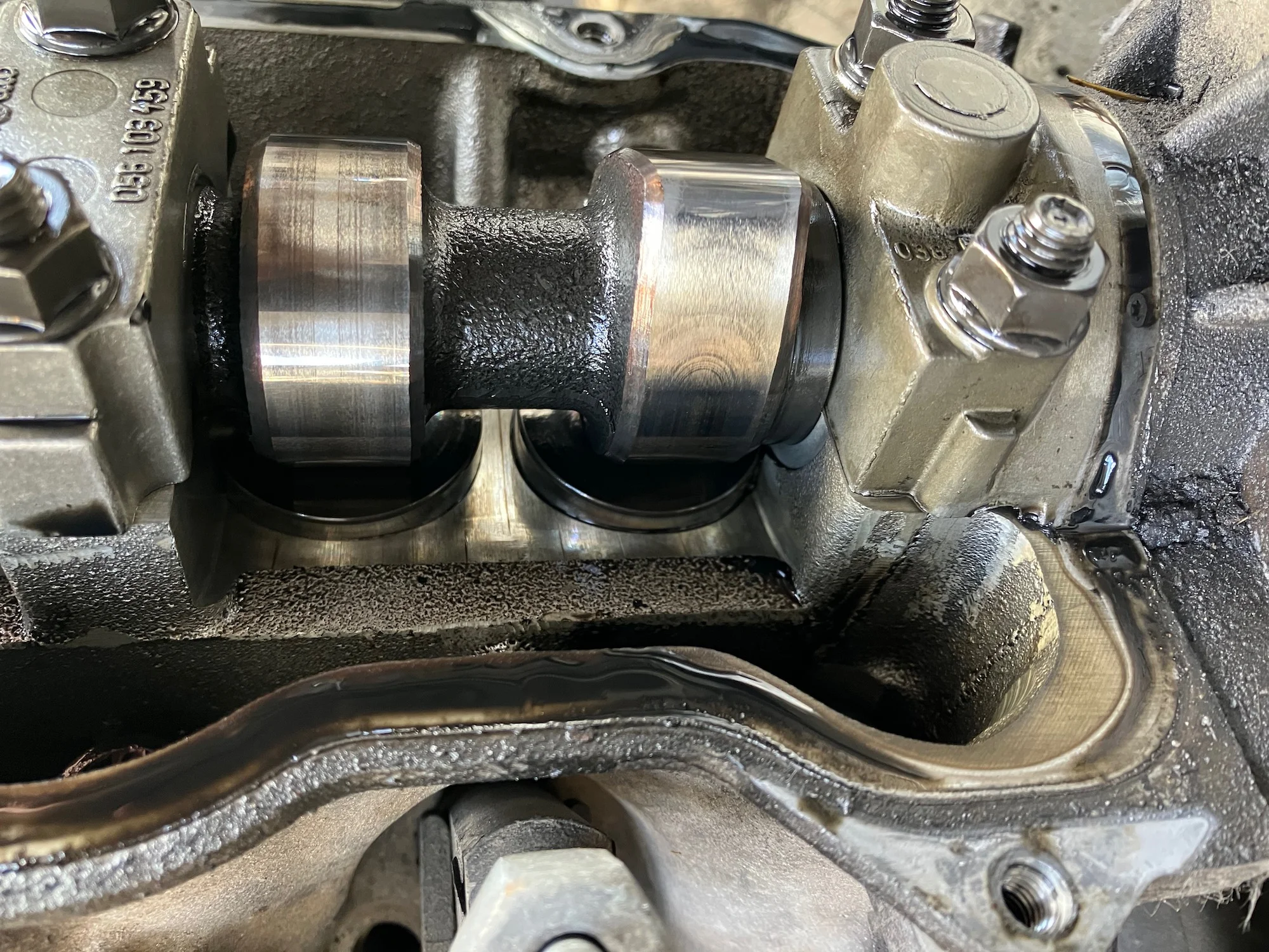

Just to satisfy my curiosity I popped the valve cover off, things looked pretty normal under there, cam lobes still look nice and crisp, nothing untoward on the lifter surfaces:

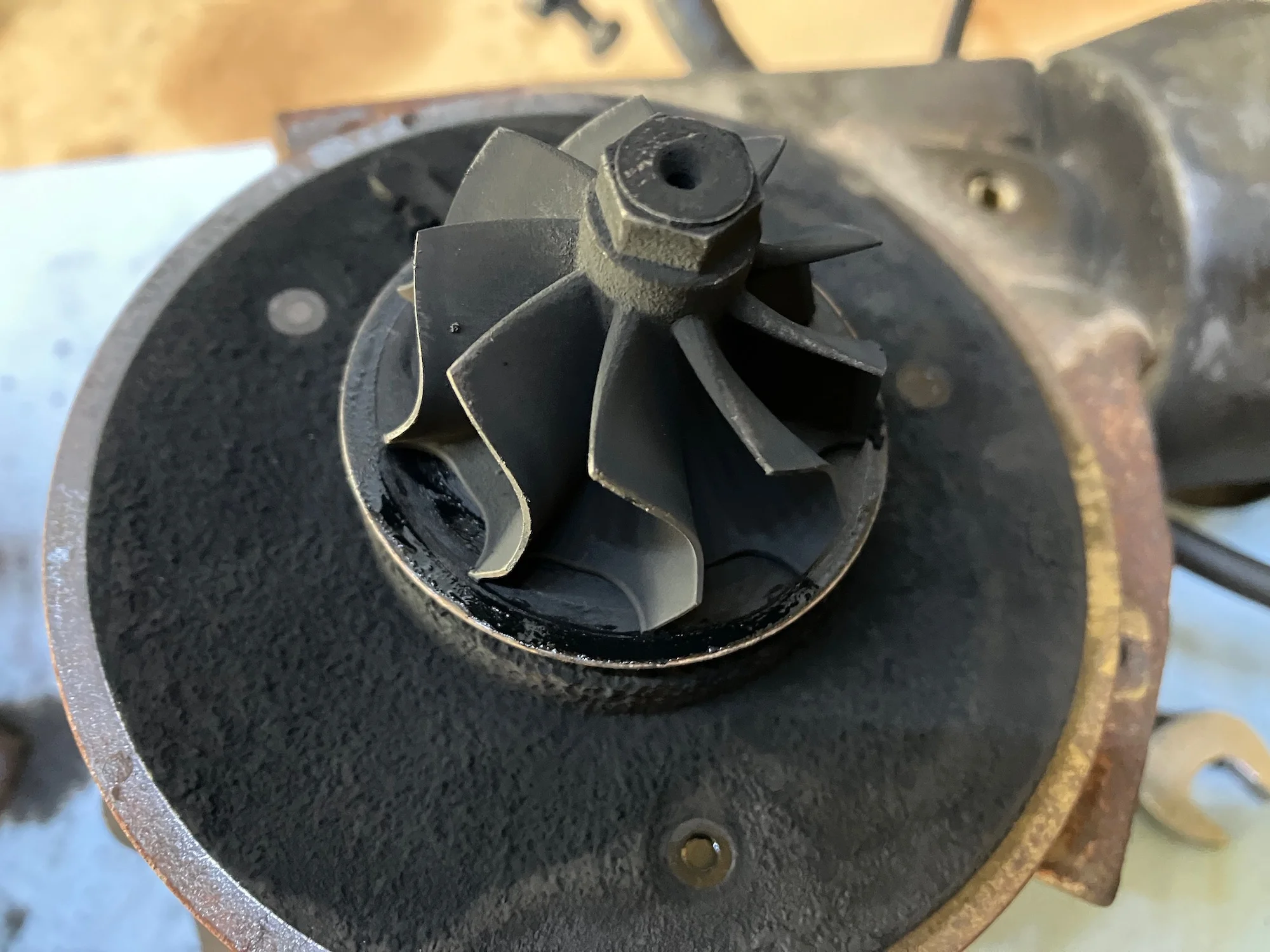

It is looking like just getting a new head will be the best option for getting this on the road before winter. I don't see where else oil could be coming from; the machinist seemed to think rings would better explain oil consumption but that wouldn't spray oil out the exhaust on a cold start unless something was seriously wrong, like a hole in a piston.
I've gotten some input from a TDI expert and cylinder head/engine rebuilder, he seems to think that all my symptoms point toward oil control rings rather than valve stem seals. He also noticed that there are some wear and heat marks on my cam, indicating it has suffered some in the past. Going to attempt to get a compression with my cheap Harbor Freight compression tester, but it is looking like I'm going to be needing a replacement engine soon. Swapping engines will be cheaper and easier than rebuilding mine right now.

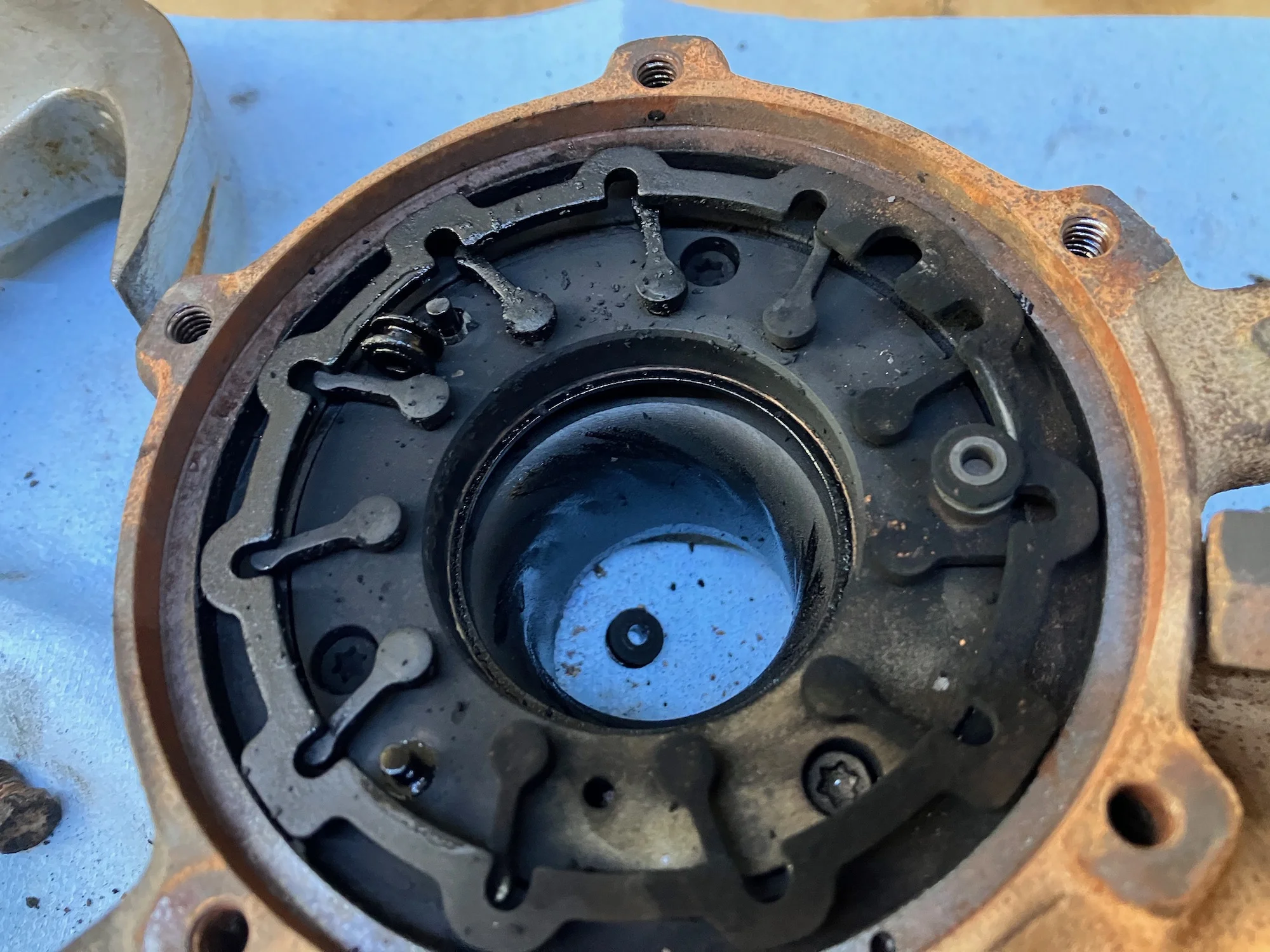

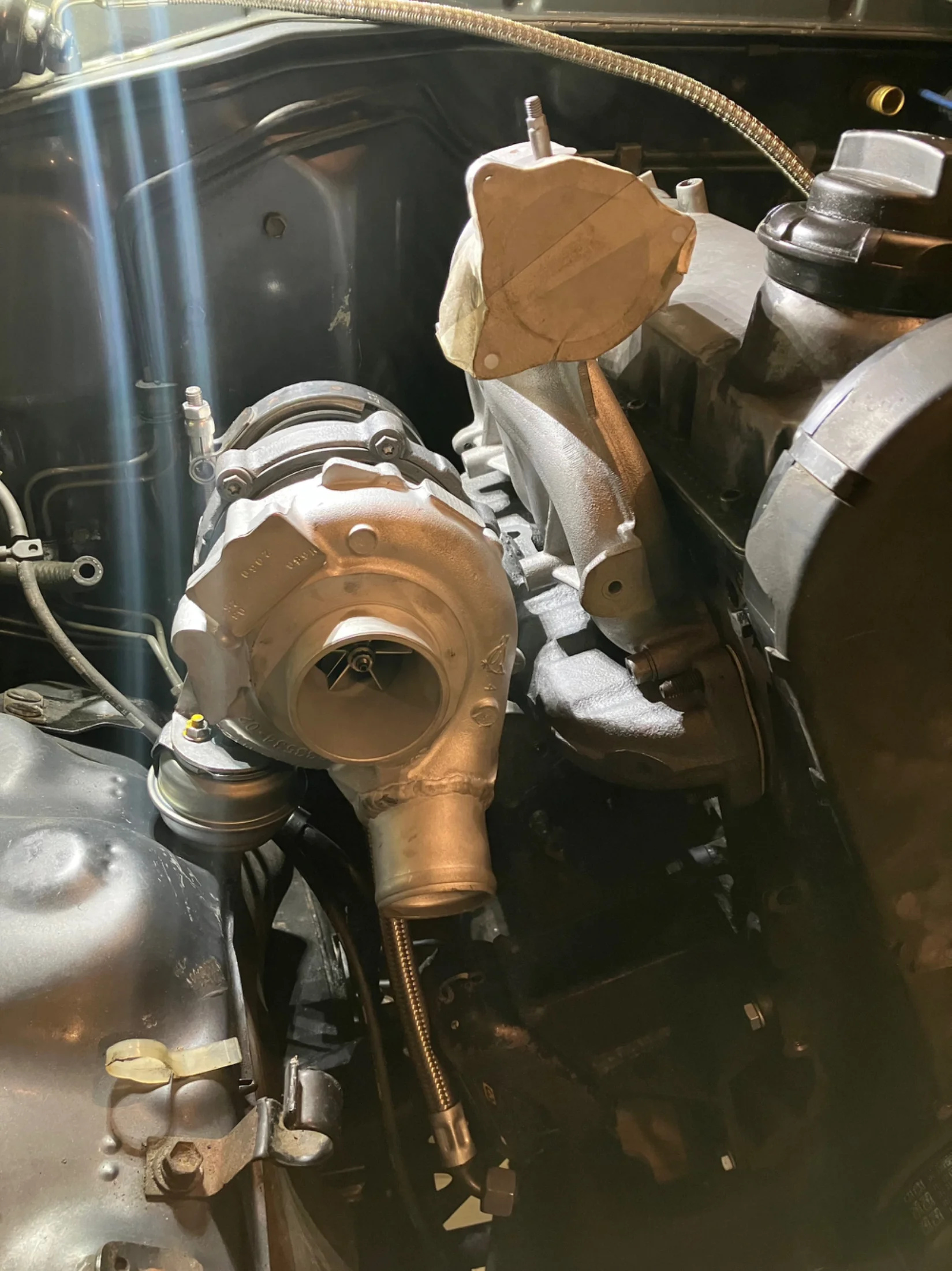

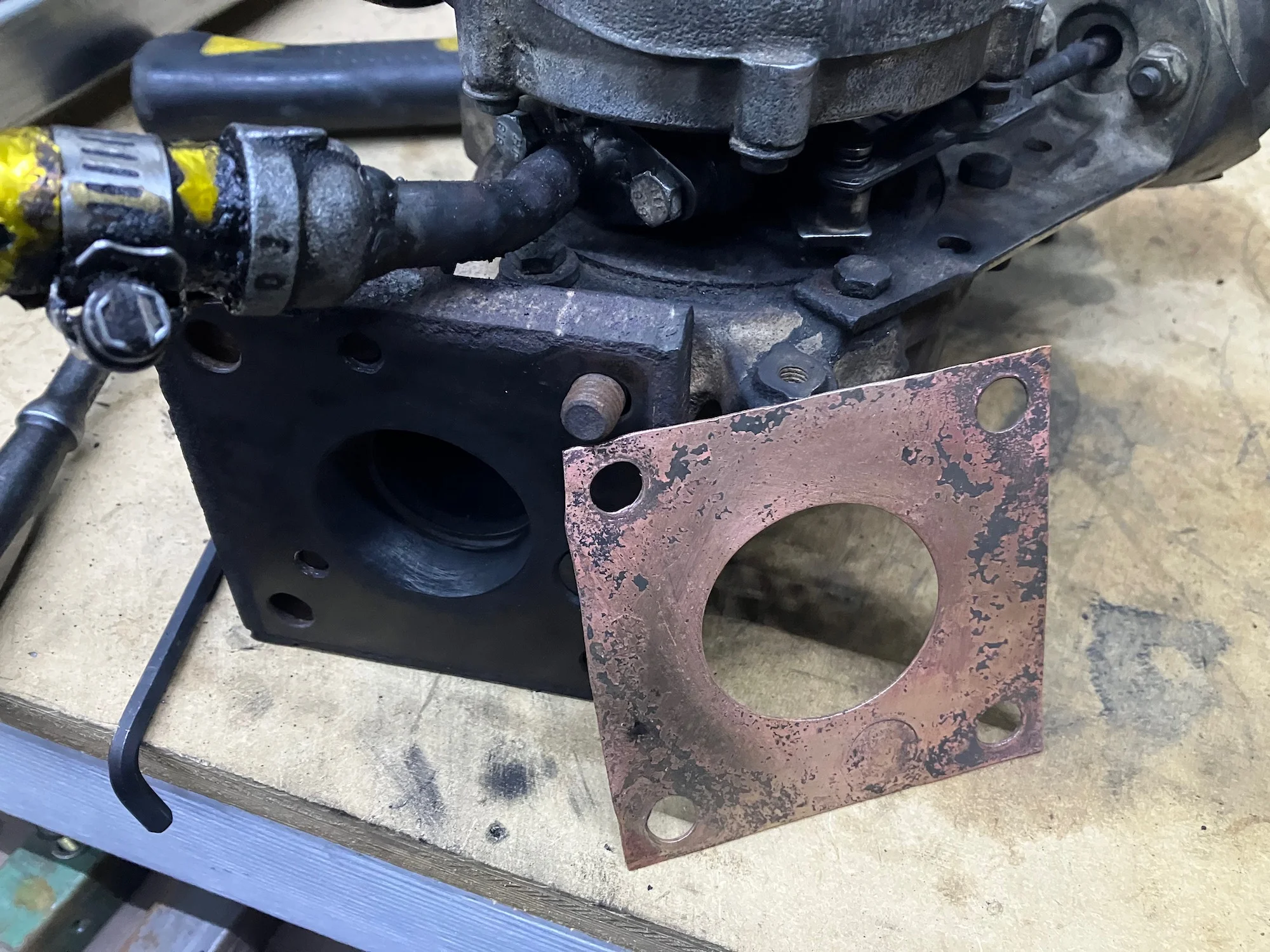

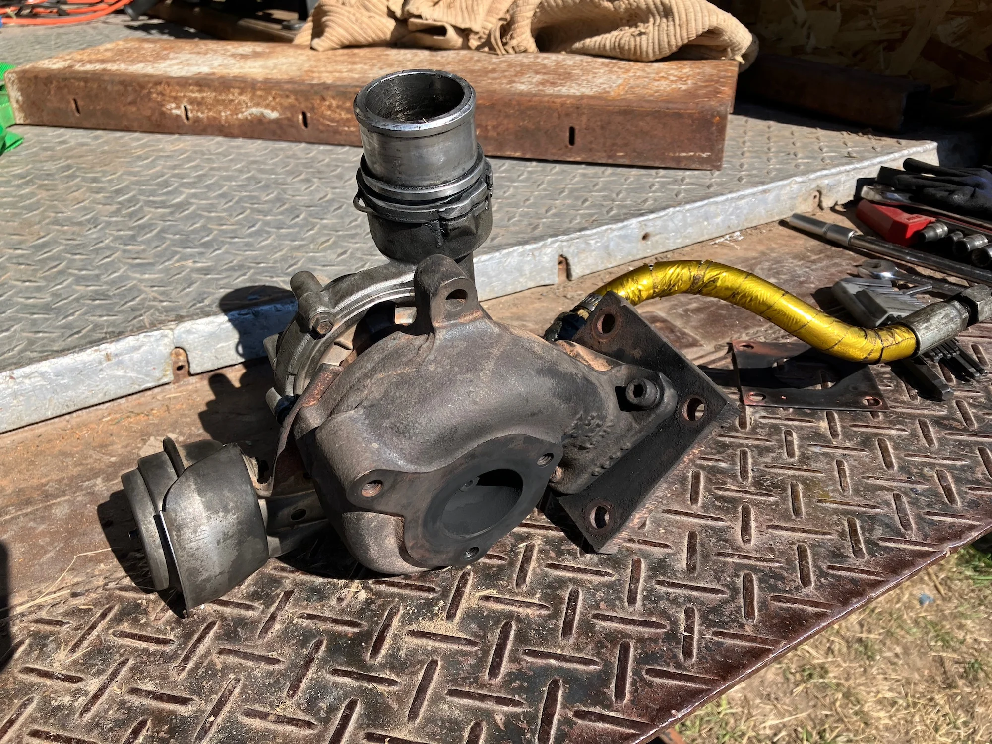

Got the turbo reinstalled and went for a short test drive. There was an exhaust from the turbo/manifold adapter interface, so I tore everything back apart. Getting quicker at this, only took my about 45 minutes to get the turbo off the manifold this time around.
I added a new gasket between the turbo and the adapter, cleaned up the copper gasket and its mating surfaces, and stuck everything back together.
Unfortunately it now leaks much worse than before, won't build more than about 4-5psi of boost. In addition, the turbo drain line is now leaking oil at both ends, despite a new gasket and some sealant. At this point I'm done putting effort into this turbo setup, I need to decide how to deal with the new turbo from Poland. There are a few ways I could do this:

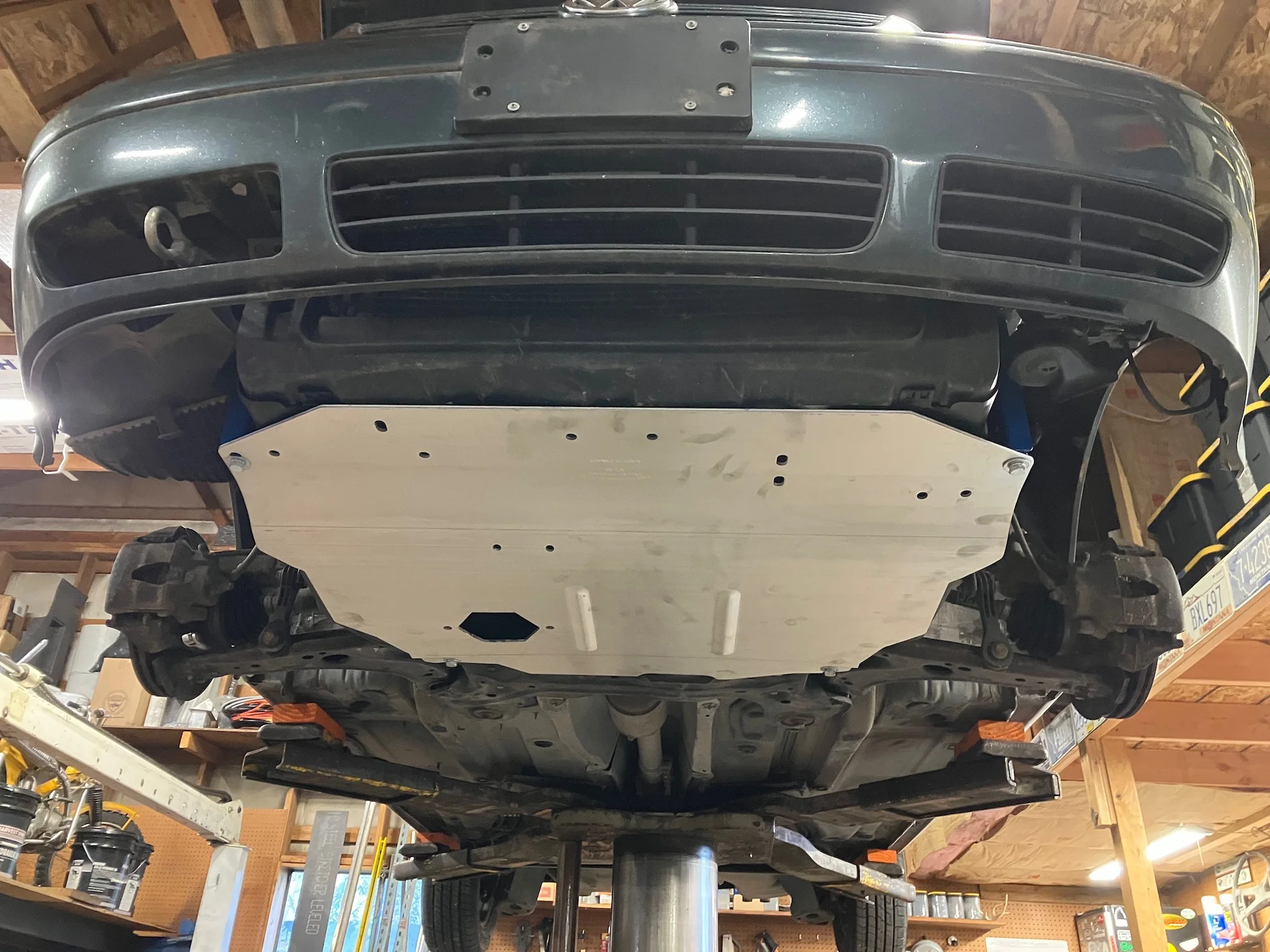

Fortunately @SnowVersion snagged a 2003 Jetta TDI sedan for me a couple of weeks ago, its only got 167k on the clock and was for sale by the original owner. Planning to put a new timing belt and a skid plate on it next weekend, that will take the pressure off getting the Prado running for a winter vehicle. The old 450SEL would not cope well with the terrible snow plowing they do here in Bozeman. I may end up sticking the DLC1019 injectors from the Prado in it sometime in the future...
Nice score on the 03! Low miles for sure on that year.
I just put my skid plate on a couple weeks ago and feel a little better about it now. Dlc1019 were great on my Jetta, I’m thinking about those or pp764, not sure yet.

Stuck a new timing belt and an aluminum skid plate in the Jetta last weekend, replaced a couple of plastic engine cover pieces and drove it home. It has been a while since I've driven a stock ALH, it could definitely use more power but I've never driven a tighter MK4. There are no interior squeaks and rattles, no front suspension clunks, it feels like a new car compared to what I'm used to! Eventually it will get the DLC1019 injectors that are currently in the Prado and possibly a mild turbo upgrade.

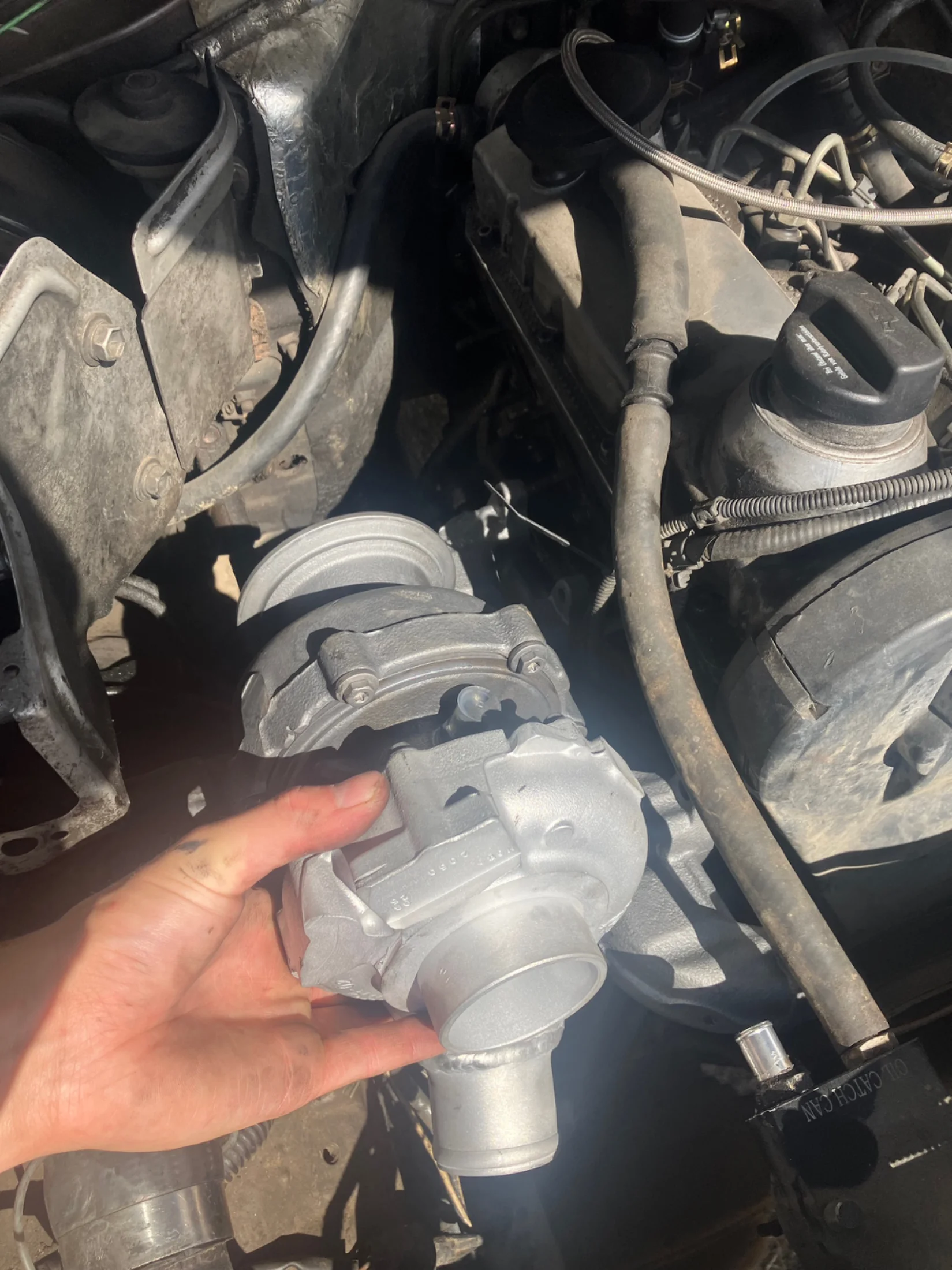

Got to test fit my GTD2060 turbo to the ALH in @2gbFlashDrive's LJ73. His engine is at a 10º tilt compared to my 15º adapter. The turbo just fit on the manifold studs, but the actuator was hard up against the inner fender. The turbo would also interfere with the clutch and brake master cylinders in my Prado. Several adapter plates on the market are offered with 0º mounting, which would bring the turbo further up and away from both the inner fender and the master cylinders, but the ALH power steering pump would run into the battery and battery tray. Looking at photos of the BHW engine, the accessories are mounted quite differently, with the alternator mounted close to the cylinder head at the top and the power steering pump down low. This would likely work quite well with a 0º adapter. The BHW is looking like a better option all the time.
