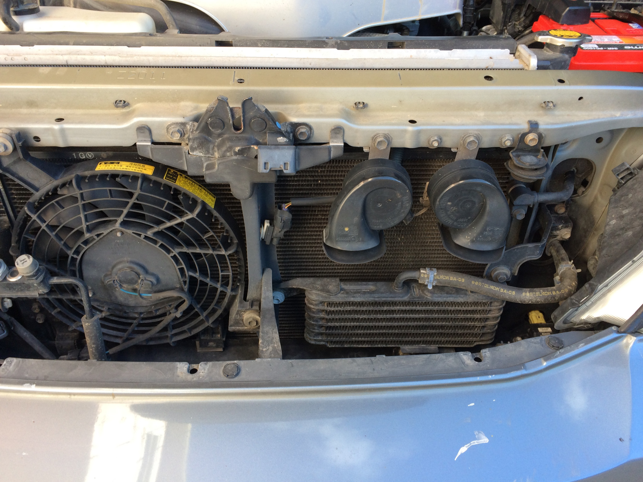

But it does appear that I have the Trans cooler under the horn?

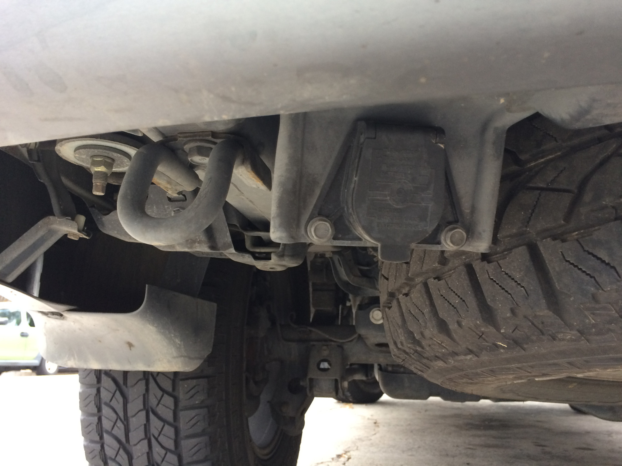

And I do have the trailer pin plug.
