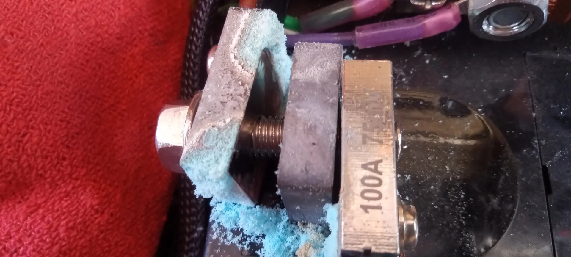

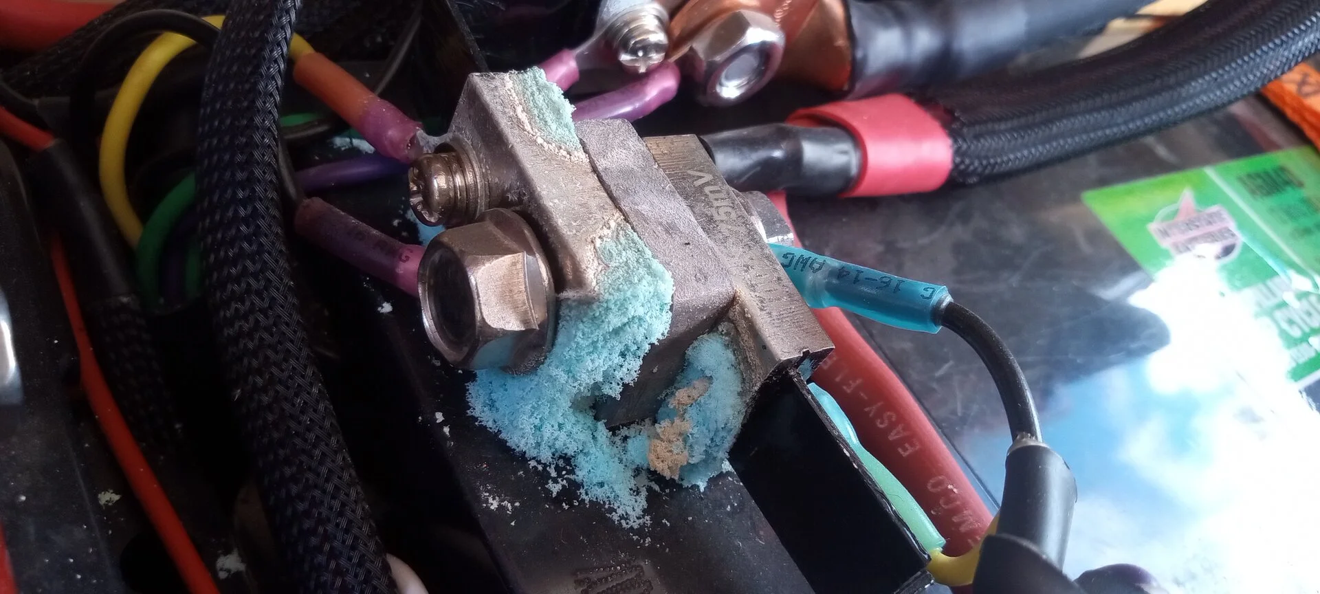

Initial condition.
Pulled the contacts apart and noted that none of the corrosion made it between the shunts and the terminal, which is good and why charge and discharge readings didn't change from the baseline readings of 'nominal'.
One side:

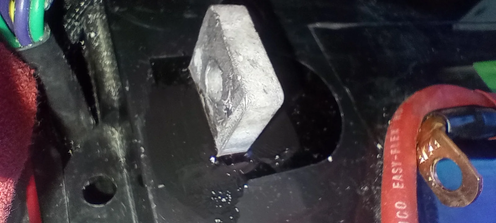

The other side. Didn't get a pic of the terminal itself, but it was clean.

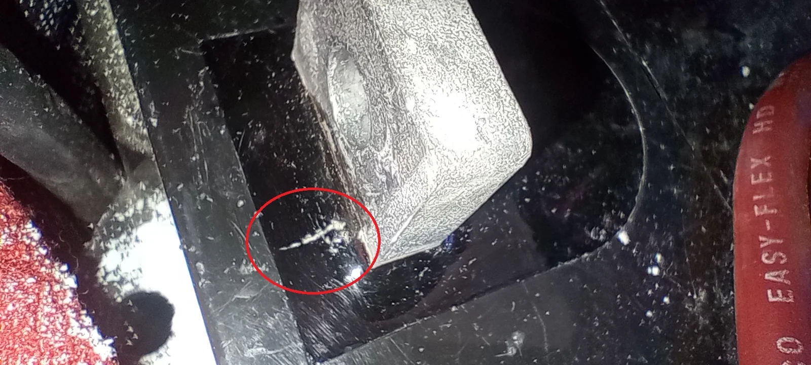

After cleaning up the gunk, noticed this (red circle). It can be felt with a fingernail, and I cleaned it out a little with a pick. This area also corresponds with the largest buildup of corrosion in the first pic. Did I find the culprit? At least on this side of the terminal anyway.
On the other side of the terminal, found this (red circle). Again, it can be felt with a fingernail and again cleaned it out a little with a pick. The green area - the top mark not sure how that got there. The bottom mark is just surface scratches. Covered them both as well, regardless (see below).
Applied RTV by just smearing it on in a thin layer and let dry overnight. Left and right sides of the terminal:
Vacuumed up all the crud and put back together:
