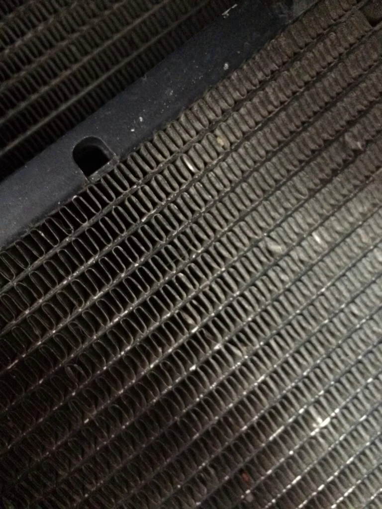

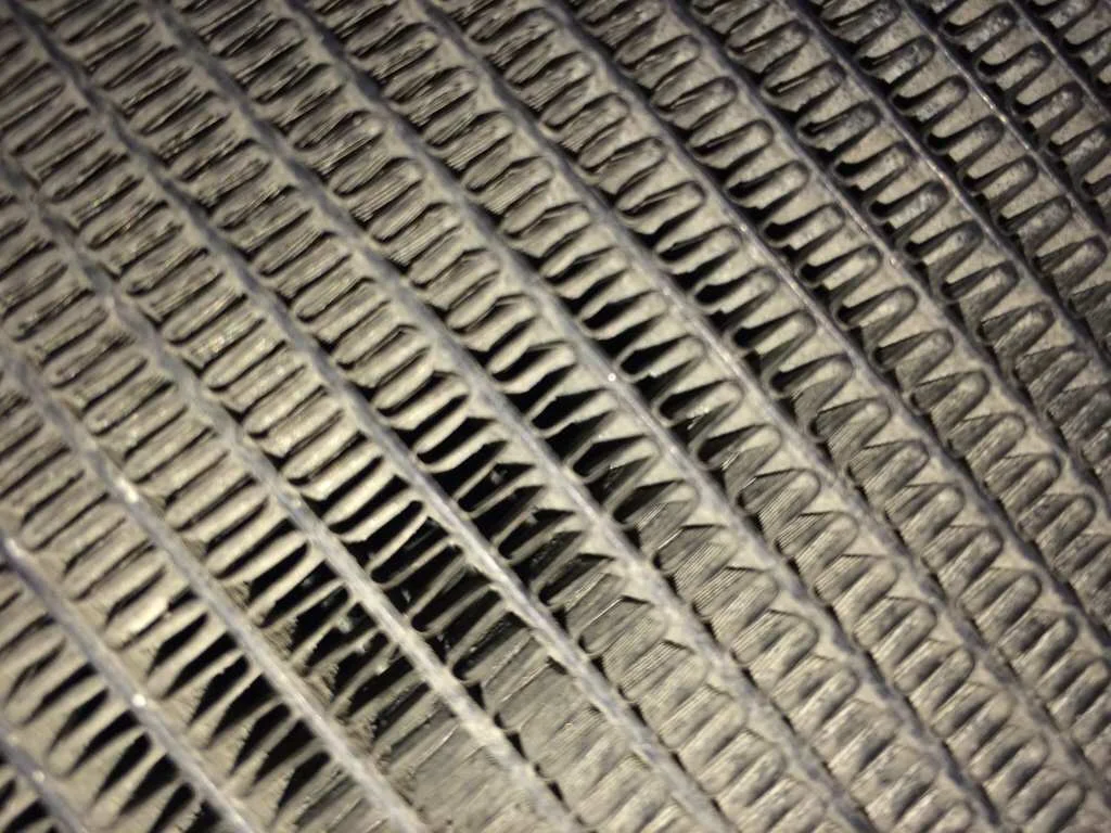

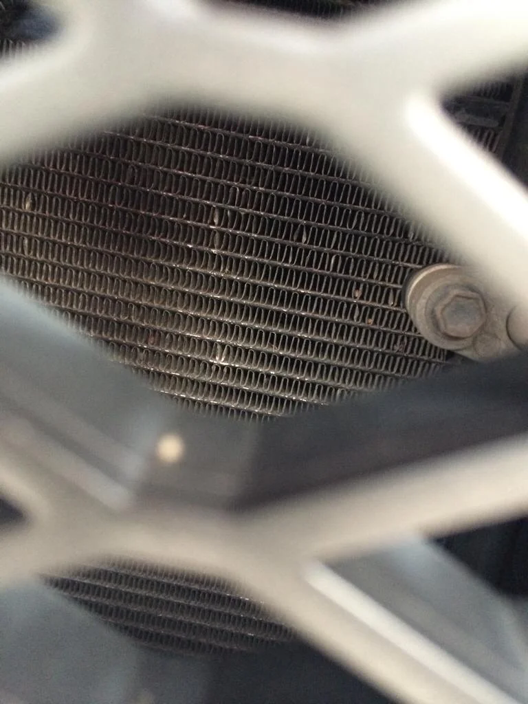

I did have a look at the condenser yes it s bit dusty but not a lot.
The grill can be taken off two screws and two plastic pin.
I m afraid with a low pressure hose to make matters worse.
Would i point the water hose at the fins ?
Again AC works but not cold enough as it used to be.

Yep point the hose right at it at low pressure and wash it out really good. If that does not fix it have your system tested to see if you have any leaks or are low on gas. Good luck
